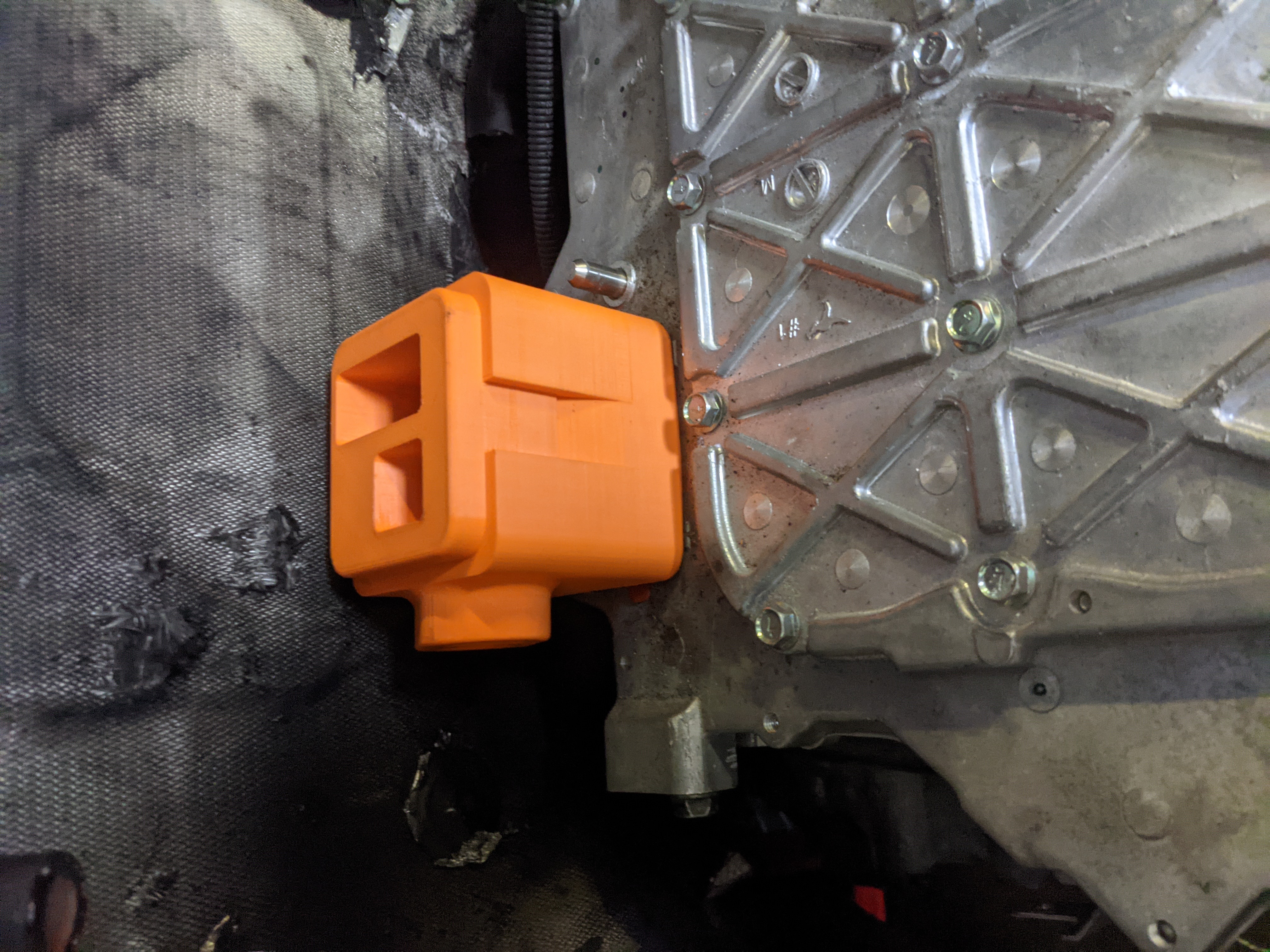

Re: em57 inverter dc connection cover
Post by janosch »
Bratitude wrote: Tue Apr 20, 2021 2:44 pm
janosch wrote: Tue Apr 20, 2021 7:39 am This is glorious, we will put one in our printer today!
you’ll be the first testing the current design! Things are a bit tight, definitely recommend a fast print for initial trail
Very neat so far, the lid is printing now. Tight fit with the seal at the bottom is also good! Thank you very much for sharing.
Only thing we were thinking about this morning was, how are you going to tighten the nuts in there properly. We will struggle to get a spanner in there, might amend the design either in CAD or with a rasp!
Wow looks great in HV orange! yes that was my concern aswell. Was going to continue to add in features for nuts to lock into. Then bolts just screw in. The hardware for locking the the entire assembly to the Inverter is designed as such. As well as the larger opening for the dc connection.
maybe have to just change the entry point for the cables, and use the larger hole opening on both dc inputs.
