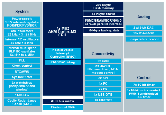

The F107VC also has 2 DACs and 2 CANs. That said, for mysterious reasons the STM32F411VET6 is only $3.70 as opposed to $17 for the F107

Plus with the 107 and it's dac's Damian has the possibility of macking some tunes on the inverter 🤪

Yep thats the plan. Found the DACS on the f107. Under "Analog". Duuhhh. I'll feed em into a dual audio amp.

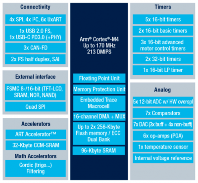

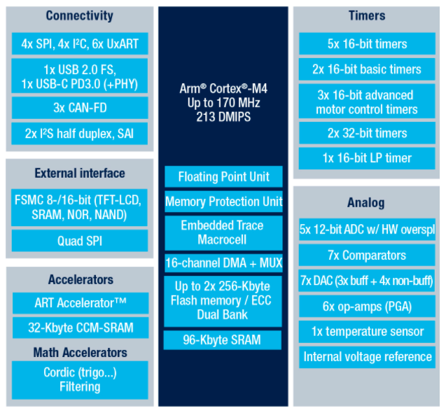

I just read a thread about a nice board.
And if we would go one CPU bigger then that board it would be: STM32G473VBT6
Its a JCL part, its in stock. Costs $10,- has 3x Native CAN's, many timers. PWM signals with dead time etc. it comes from the same series as the STM32F107
We should check the libraries. I do agree this will be a V2 cpu.

Ok, i checked the libraries and the G4 is not very much supported. Saying that i don't think its allot of work plenty of examples to get the hang of it.
Comparison:

I've not used the "G" series before. They look very interesting, but their CAN is FDCAN whereas the "F" series use BXCAN. Multiple 16 bit ADC looks pretty cool. I wonder if it may be too much of a departure from the F series as an early consideration.
I of course agree with Damien that the F107 (F105V) is perfectly suited, as long as stock is available.

Alrighty, First full day on the design. Got the f107 and peripherials drawn out. We'll have :
2x HS CAN
1x HS/SW/FT CAN via MCP2562 / NCV7356 / TJA1055
1x LIN optionals master/slave via TJA1020
