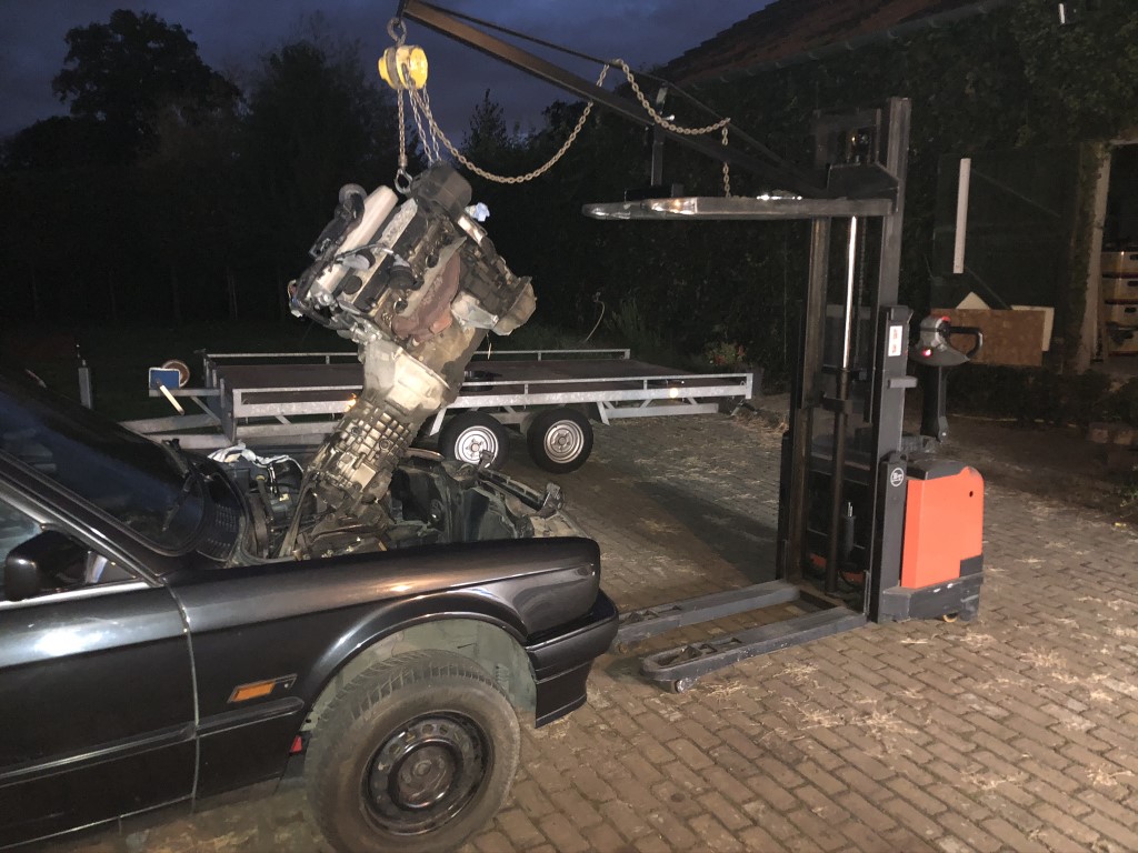

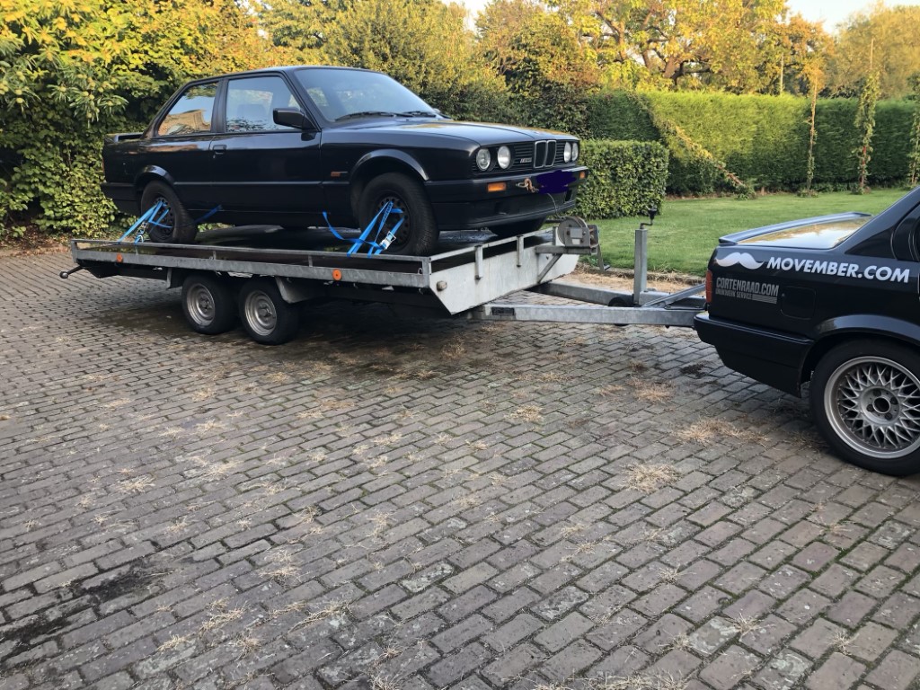

Started this project around 2 months ago, when I found an affordable 2-door E30 in good condition. The E30 model is not unknown to me; my first car was an E30 325i which is since a couple of years back my daily during summer with meanwhile at around 600.000kms. (at the right in the picture)

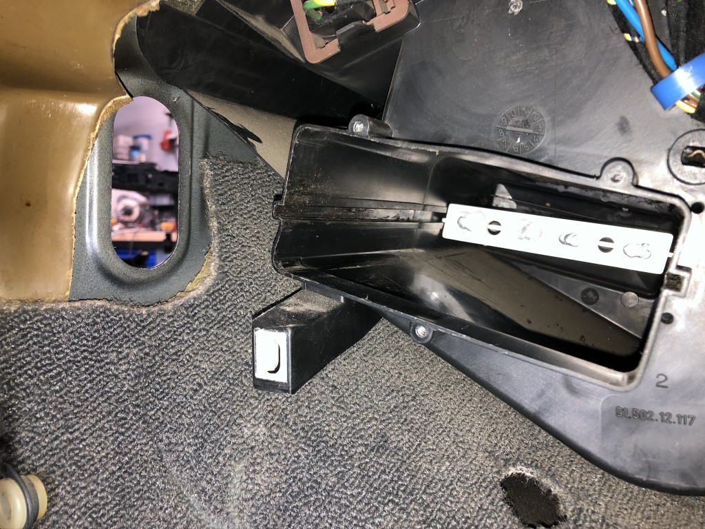

Get the old shit out:

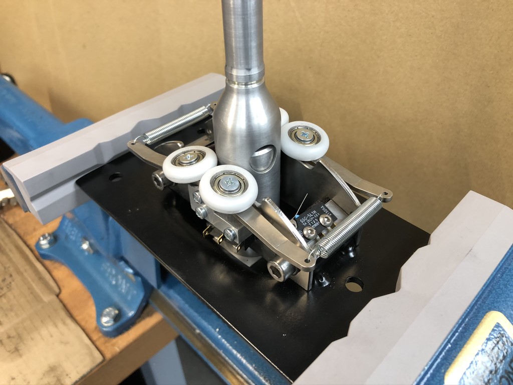

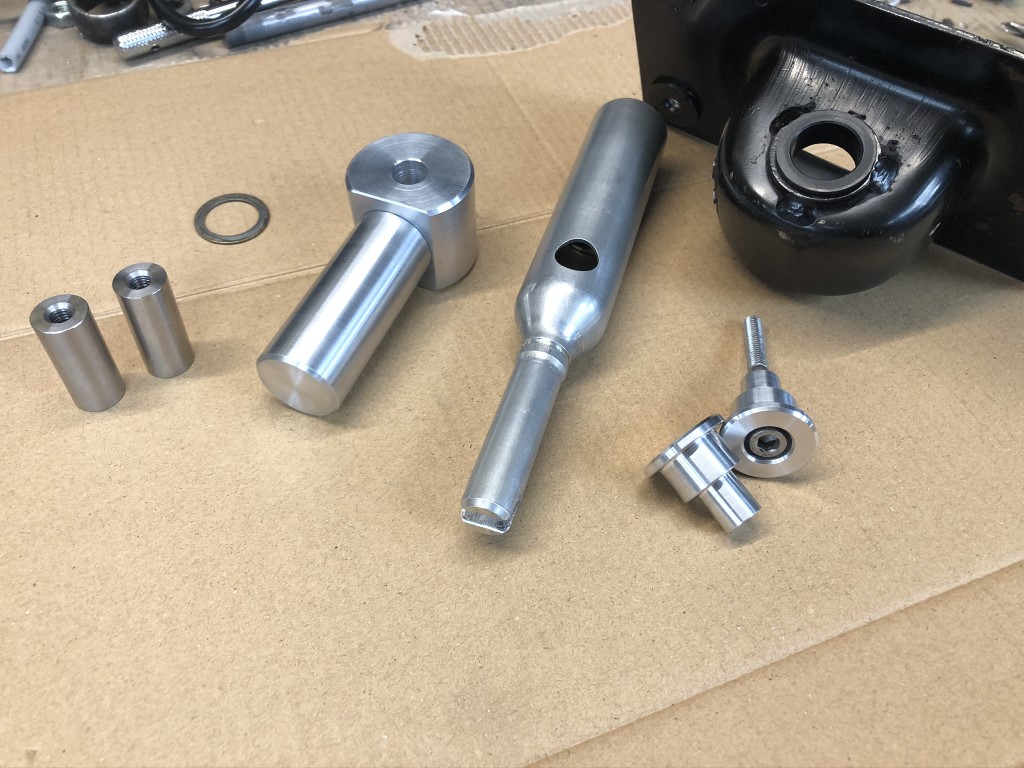

Make a solid 'gear' lever:

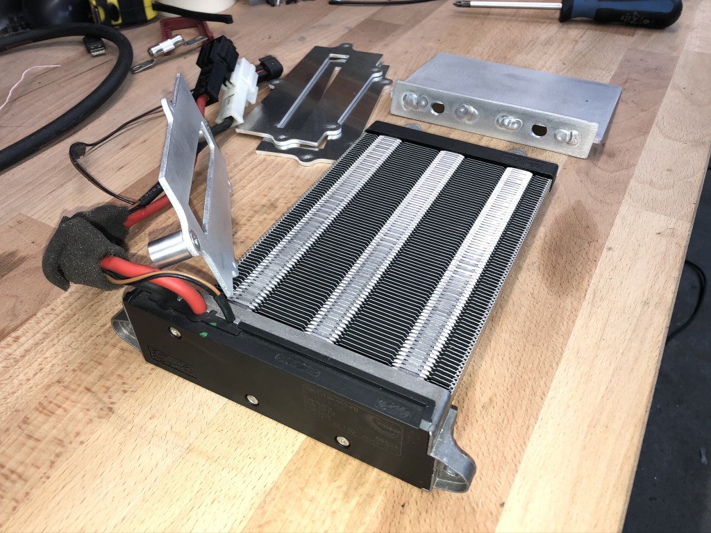

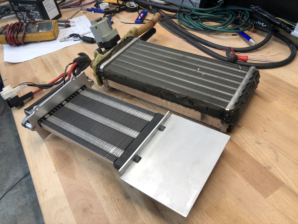

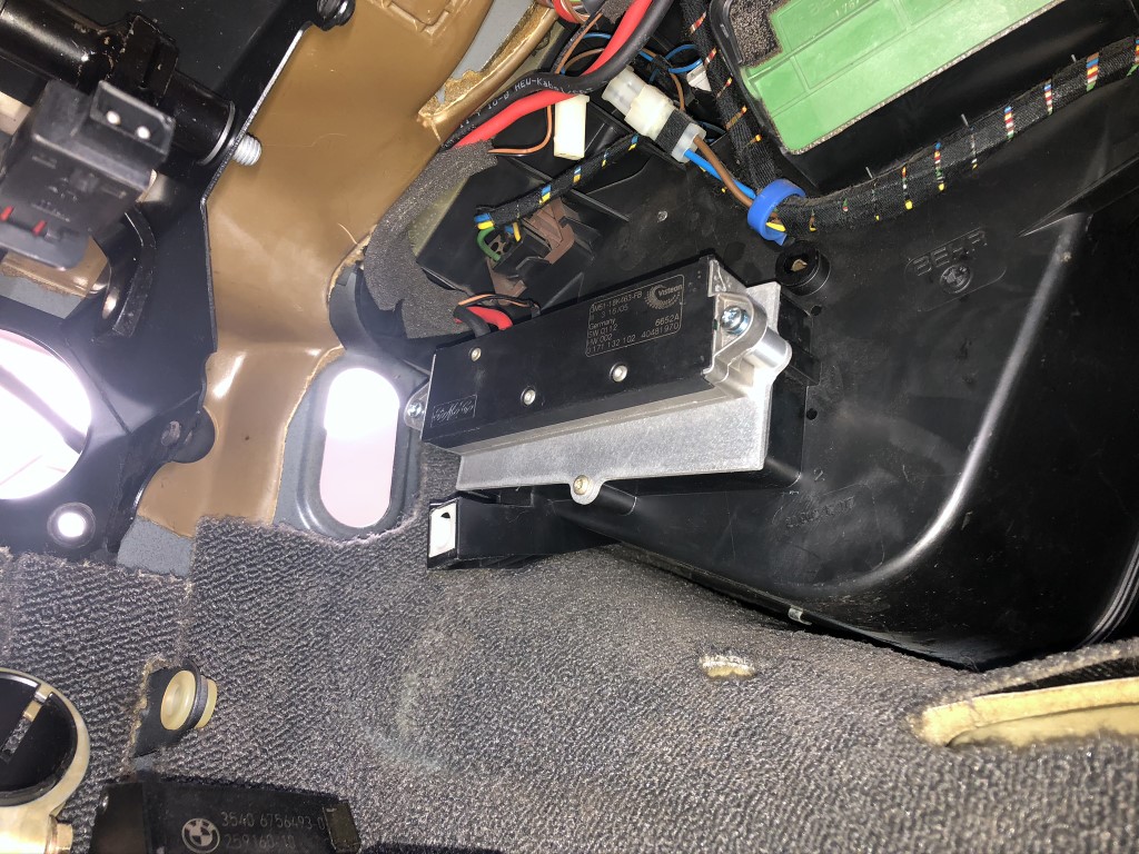

Fit a PTC heater:

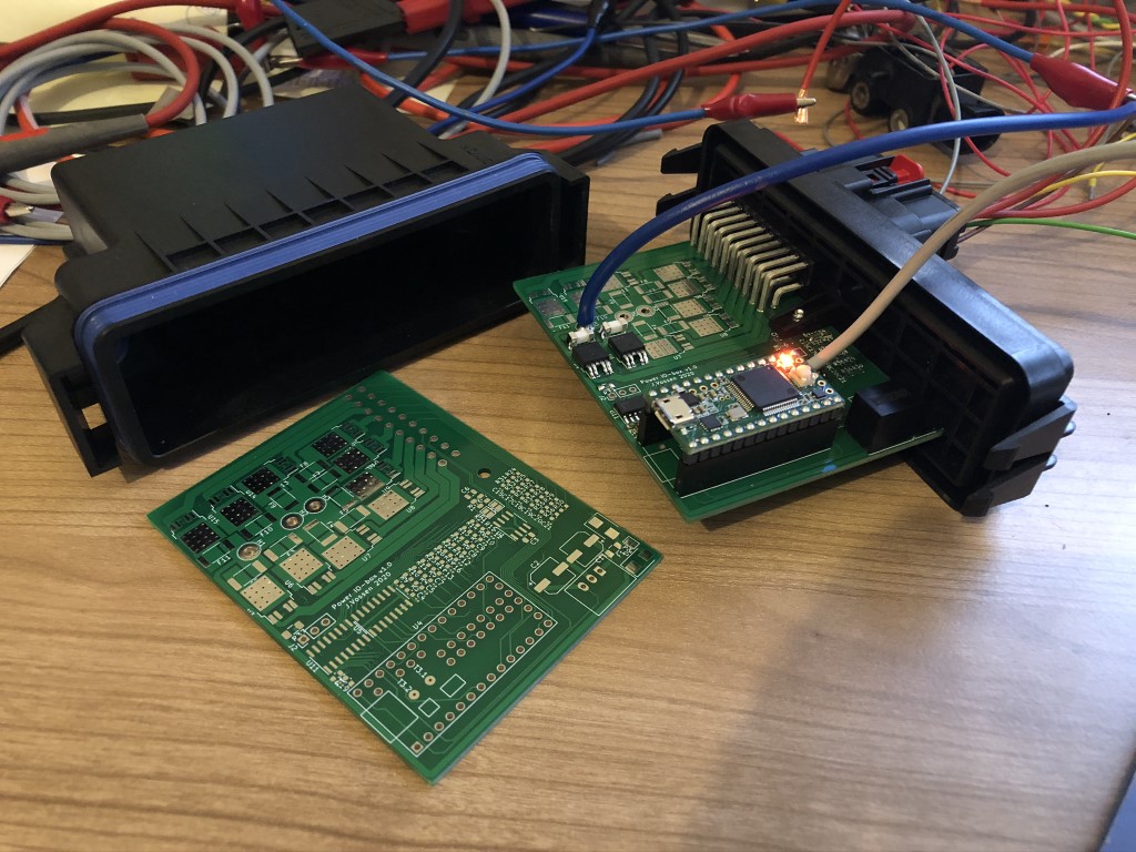

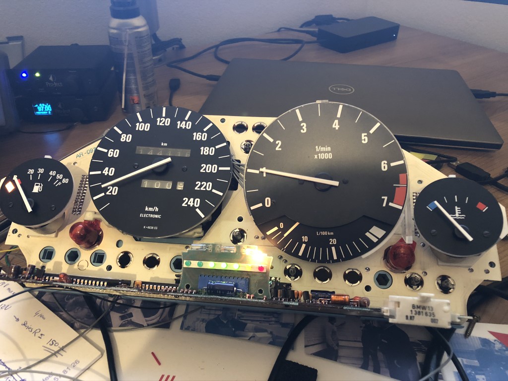

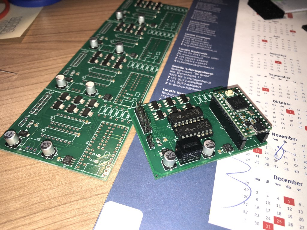

Convert the original dash to CAN. All the gauges are controllable by PWM/Frequency signals. Just the RPM-meter (will become an Amp-meter) reaction was not dynamic enough to me. First try was controlling it with a CS8190 but that became to complicated. Now controlling the moving-coil meters directly with a Sine-Cosine signal generated by the arduino. Since designing & etching a PCB was 20-25 years ago for me (in a bucket with FeCl3 8-) ), gave the modern way a try (Kicad). First proto:

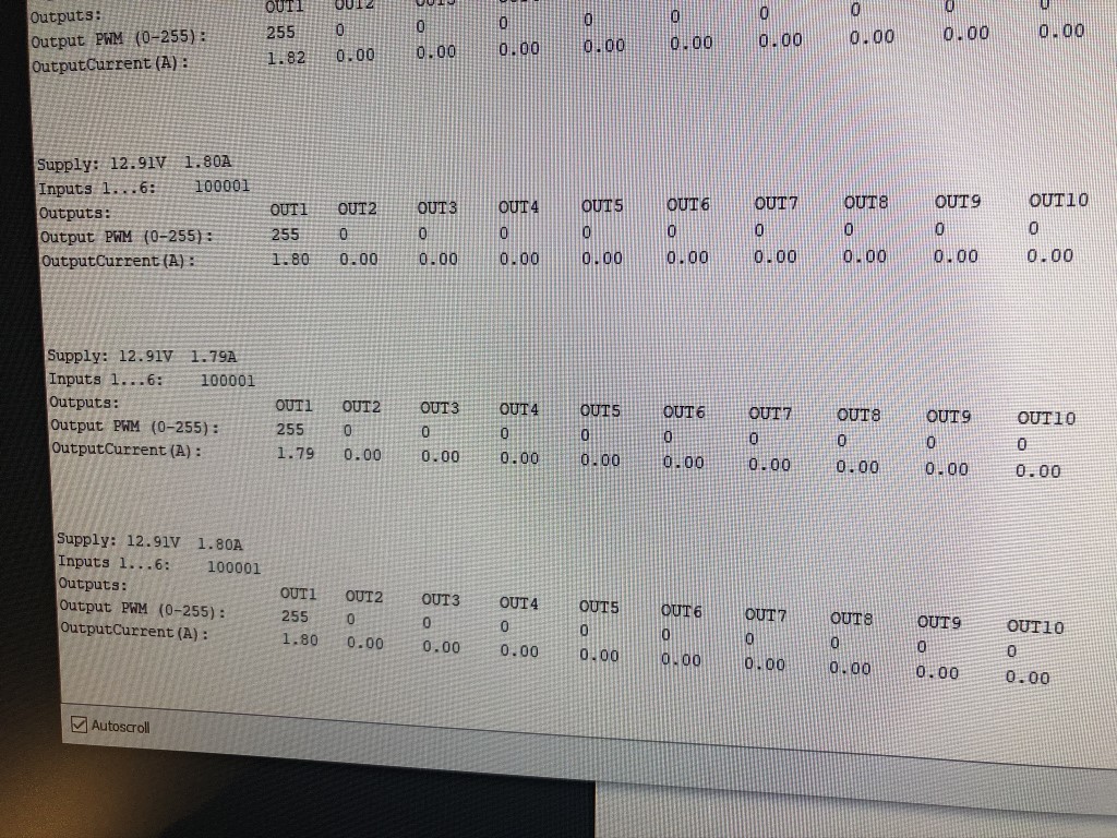

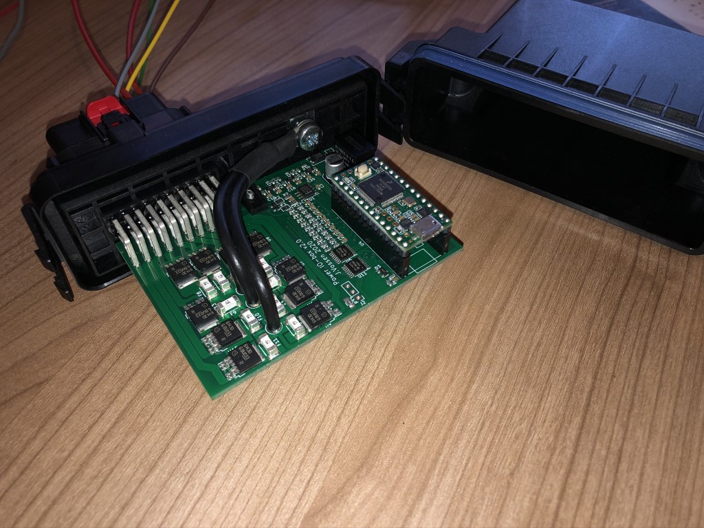

... Decided on a rainy sunday to make a basic VCU with some high-power outputs to distribute the 12V. Do already have some further purposes for this thing in mind.
1x CAN-bus, 6x digital input, 10x high-side 8A output, all with current measurement. Switchoff-curves are per channel programmed in the arduino, as well as limiting the total current at about 50-60A.
First proto:
Improved & fully working version:

Hello there, nice progress :D
May I ask what ptc heater you were using? Is it something that will be controlled with pwm?
Posts: 6969
Has thanked: 455 times
Been thanked: 1771 times
Re: BMW E30 / Tesla LDU
Looks like the Volvo unit viewtopic.php?f=9&t=1147

Post by FJ3422 »
Exactly !
FJ3422 wrote: Tue Nov 10, 2020 9:14 pm Search Ebay for "3M51-18K463-FB". Starting at € 10,- :)

Post by fredd90 »
Thanks for quick reply :D
Very good price, just bought one from an volvo v50, 20euro. very cheap to experiment with,
My idea is to skip tesla 400vdc ptc heater for now, trying to get the Hvdc as minimal as possible.
