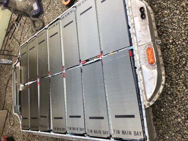

Got the pack open and removed all the modules over the weekend
Firstly removed the fire-resistant cover to expose the bolts
Unbolted, pryed-up and removed the end cover, where the 2 extra modules for an 85-pack would be
Drained elon elixir by firing air in one end and coolant came out the other. Then unbolted the rest and peeled up the cover to expose the modules Noticed the top module us only a 5s not a 6s like all of the other modules, after some Googling it appears all 75-packs made after sometime in 2017 are like this, cant think why. Going to reuse as many as i can of the original rails which pretty much bolt up to the modules to mount them in place, then weld those to a battery box.
If anyone knows the screw bit name at the end of the pack covering the contactors then it would be appreciated.

Spent some time doing professional CAD - think I can only fit 3 modules under the boot at the back, but fortunately 11 fit under the bonnet so I get a full 75kWh, weight distribution will be a bit upset but shouldn’t be too bad
Also took apart the back of the Tesla pack and retrieved the contractors, 23ohm precharge resistor, Main BMS board and pyrofuse (which was at the front)
