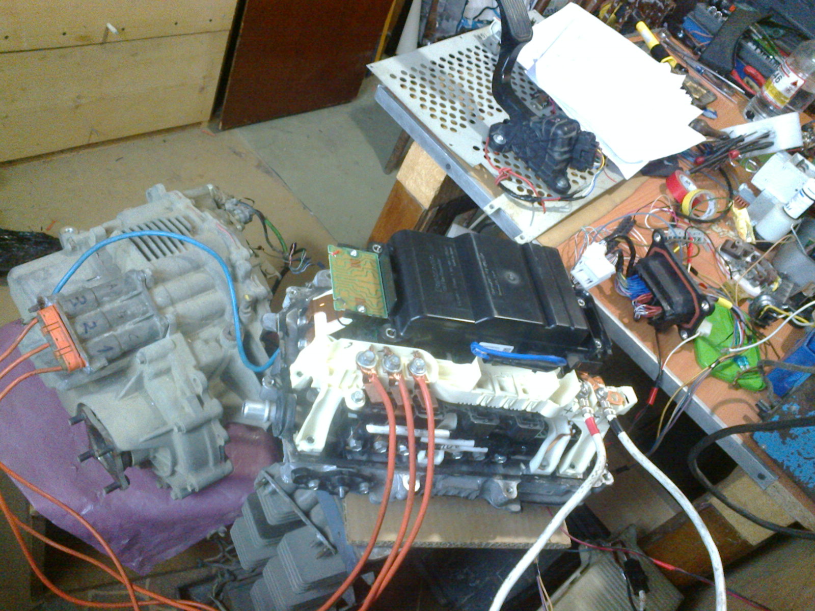

m.art.y wrote: Wed Mar 17, 2021 4:59 am Yes I would be interested in that too. By the way has anybody run MG1 and MG2 in parallel for more power on a single motor on V1c board? How do we wire the motor and which jumpers we need to solder up - just the 6 by the 50 way connector or also the one next to R81? Thanks 🙂
Yes. I`ve soldered 6 jampers and move busbars from MG1 power stage to MG2 with parallel, and made jampers from MG1 power stage to MG2 power stage. Now both currents go through MG2 current sensors.
It is works:

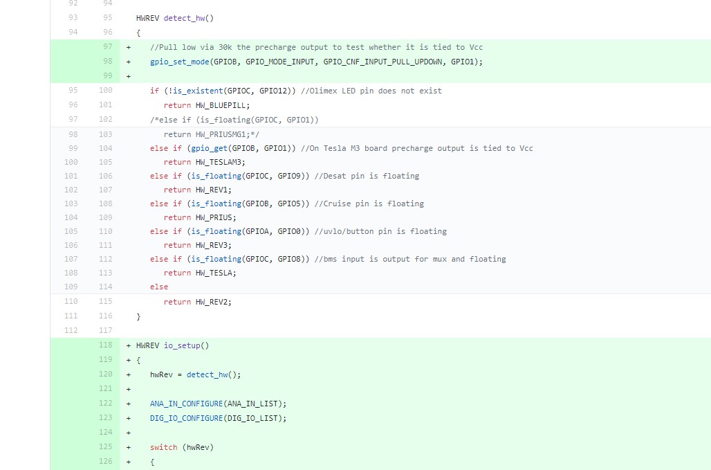

I found four useless lines per chip:
MGx_DESAT
MGx_BMS
MGx_MPROT_IN
MGx_UVLO_IN
I'm gonna delete them in my design, but I wonder what was their purpose before?

Jack Bauer wrote: Tue Mar 23, 2021 7:42 am Desat = desat error input from an igbt driver
bms=bms input
mprot= nc motor protection switch.
uvlo=under voltage lockout error from an igbt driver.
Yes, but they have no use in Toyota inverters, so they are obsolete(?).

Jack Bauer wrote: Thu Mar 25, 2021 10:51 am basically yes. I linked the toyota driver error signals to the brkin pin on the stm32 so when Mr.toyota gets angry the Johannes brain stops making pwm:)
OK, as I understand, you connected MGX_FAULT signals from IGBT board as PWM stop condition in software.
But what I mean is this four signals (mentioned above) are physically connected to GND or 3.3V through resistors and do nothing but wasting pins on STM's.
IMO they are reminescence of earlier iterations to be wiped. :)

zilion wrote: Thu Mar 25, 2021 12:10 pm IMO they are reminescence of earlier iterations to be wiped. :)

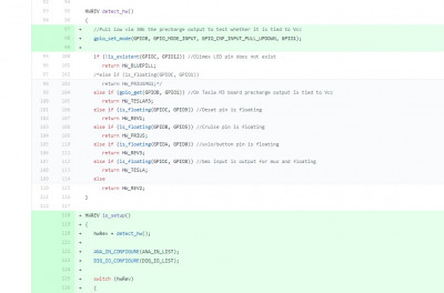

Not necessarily earlier iteration, remember that the firmware and general design is used in several other inverter logic boards as well, some of which use those inputs. Detection of the board version is implemented in the firmware to some extent but at the moment I think when loaded on the prius board some of those are still being checked despite them being tied high or low as required.
Further still, the state of those pins is what is used to detect the board variant:
(taken from rev5, which I haven't downloaded yet)
Not saying you shouldn't remove/reallocate the pins, just pointing out you will need to make a few firmware changes as well.

180jacob wrote: Sat Mar 27, 2021 11:21 am
This is gonna be a mess. And sooner then later. It can be contained to some degree for boards with one IC, but now Toyota has two IC's, and mine has three IC's to be programmed with one software.
Besides if you want to add another HW version, you have to revise all other boards that are using this software.
And I see, that Damien can't stop to stripe another inverters and chargers :)
Well, it works for now.
And to say something constructive at the end, I suggest to add some header file, like: HW_conf.h where you can uncomment HW version for specific board, and abstract their pins configuration.

But then each user has to make sure they download and flash the correct firmware.
The current method of the firmware IDing the board its' running on is only difficult when designing a new board - the designer just has to work out a unique combination of pins high and low. No need to do anything for old boards - they're already in the firmware. And it's only 'official' boards that need that - if you're just doing your own 'one off', then do your own firmware edits too!

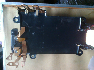

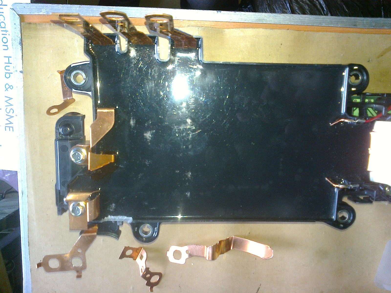

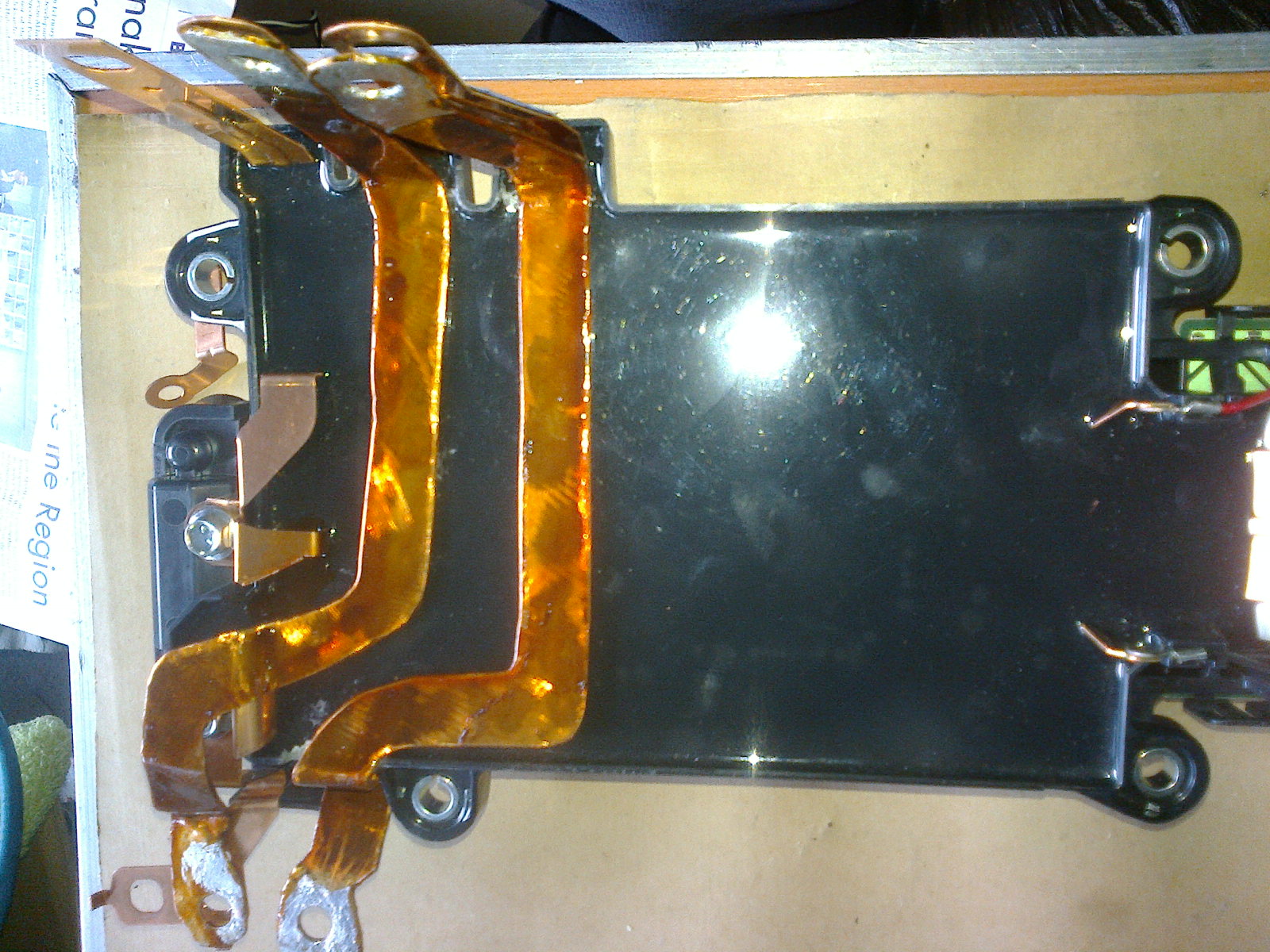

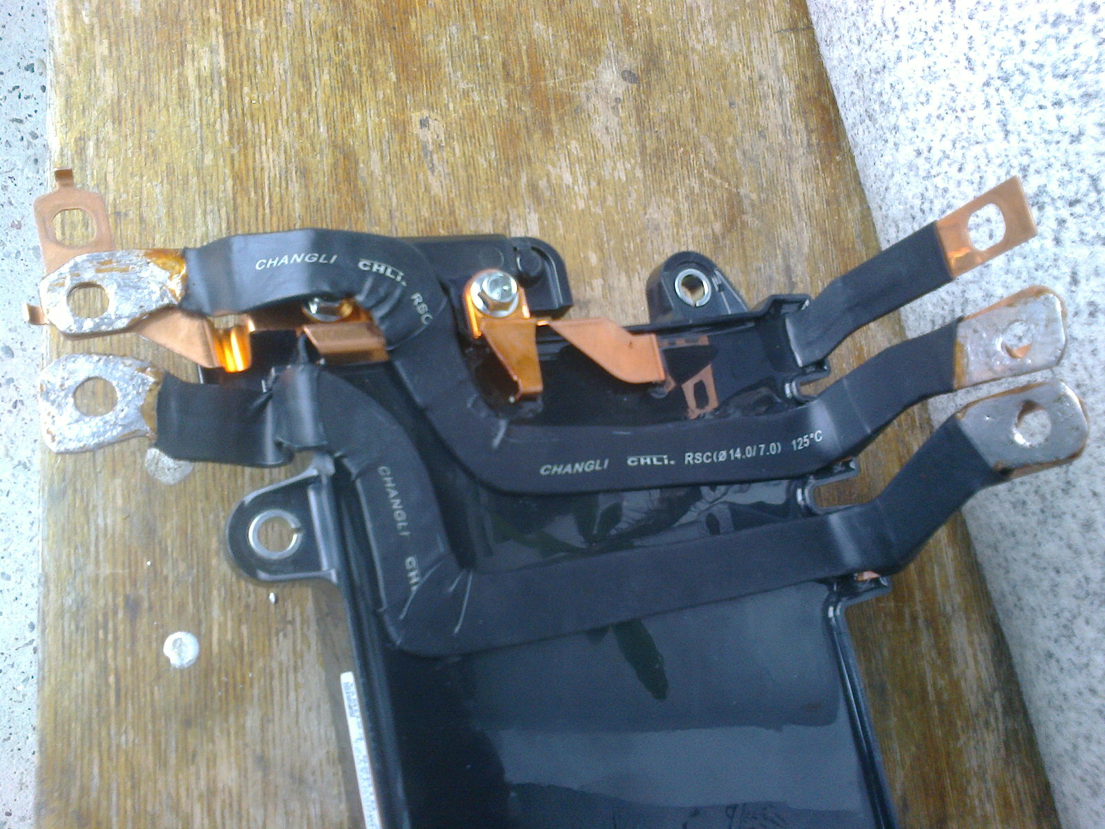

привет всем. для тех кто падает на инвертор высокое напряжение свыше 300 вольт с другой стороны, я подал там где подается 202 вольт. но после небольшими доработками.
на фотках видно все.
на конденсаторном блоке отрезали не нужны шины и добавили нужные нам самодельные медные шины.
теперь я смело подаю 350 вольт место 202 вольт.
Hello everybody. for those who drop a high voltage over 300 volts on the inverter on the other hand, I applied where 202 volts are supplied. but after minor modifications.
the pictures show everything.
on the capacitor block, we cut off the busbars and added the homemade copper busbars we needed.
now I boldly feed 350 volts place 202 volts.

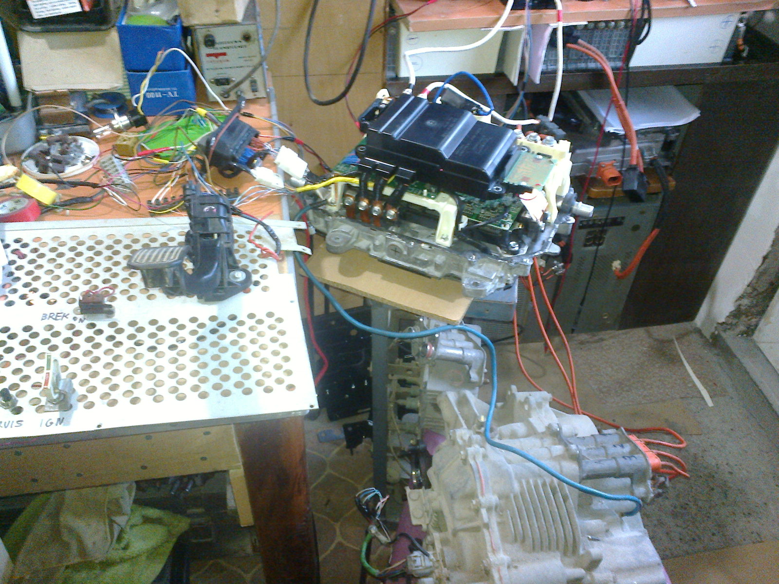

Post by mikmur »
вот так выглядит установка
this is how the installation looks like
