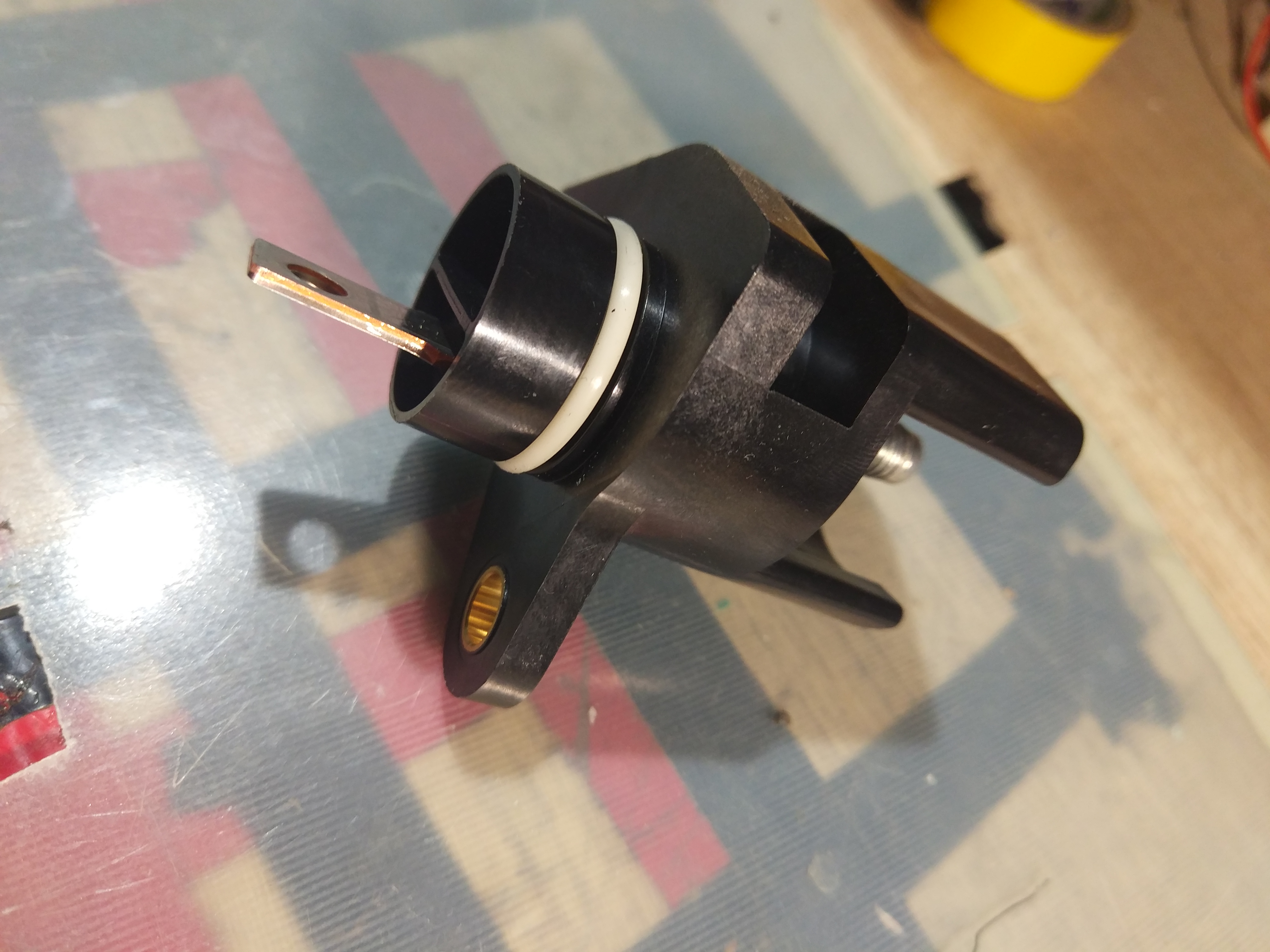

Yes but still i cant get it to start!
I have 12V battery connected. I connect 370Vdc to main connector. Then i verify LV connector pin3 is at 70% PWM. Then i use my signal generator and connect it to IRF510 Mosfet and i use 330R pullup to signal 75% PWM on Pin1. Nothing...!
Next i went and took apart DCDC. I found a small control board and connector where PWM signal enters the board. If i trace PWM along i eventually come to a transistor. There signal goes into its base/gate and it seems nothing of value is transmitted out of transistor.
Would it be possible for you to send me a photo of your PWM signal and signal generator setup?
Also do you think you could take the cover plate off and measure what kind of signal comes out of that transistor?
EDIT: Schratch that! I went by the 12V power route and immediately i found out that directly behind the main power stud there was no 13V and it was immediately behind the plastic separator. And i thought it was separator. Probably it is a fused link and in my case it burned out!
Now that i went on and connected 12V battery directly to output link behind the casing and feed 110Hz 120Hz 50% duty PWM DCDC came alive. I got 13.6Vdc. It works from 110Hz 120Hz to 140Hz.
Also i noticed that if i would remove the signal at that point DCDC would keep providing power regardless the signal.
Then i tried to provide various PWM duty at 110Hz 120Hz. Those values are under light load with 12V battery attached.
70% ........14.2V
67% ........14V
63% ........13.8V
I will try to provide more load when i solve the problem with the fuse...
EDIT: I just couldnt resist and i quickly connected my 1kW load of 9 H4 light bulbs directly to the output. I could measure 14V at 74A = 1kW!
EDIT2: Well ill be...!! :twisted: That plug has base plate that is connected to internal contact but M8 stud itself is NOT! Since i did not connect this directly to the plate my contact was weak or no contact at all. Of course DCDC sensed there was no 12V battery connected and it wouldnt work.
