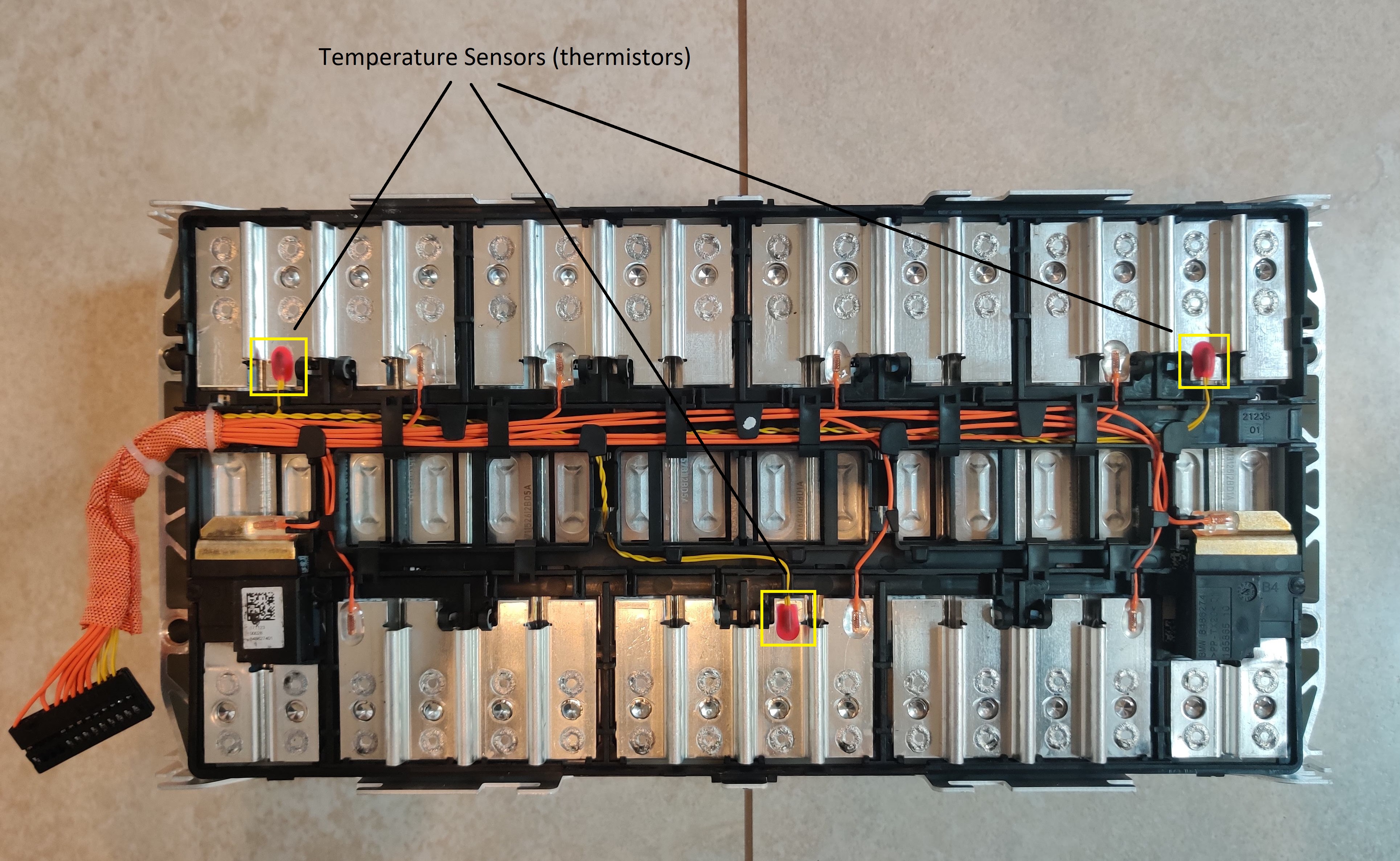

Re: 4-channel BMS with daisychain bus
Johannes, thank for quick response.
I think internal sensor is fine in most cases however for my application I would like to use sensors which are built into battery modules.
I will be using it with BMW modules for which I do not have OEM BMS. In my case those are 8s modules with 3 thermistor type sensors built in (see attached photo).
Because of the size, orientation, wire harness and other factors using of the internal sensors is problematic. The best I could do is to attach board on the side ensuring some good thermal connection but I could only do it on one short end of the battery which would not be accurate representation of the module temperature.
I would like to leverage one or all battery sensors and do it ideally with minimal development effort so here are two ideas I came up with:
1) If we could use one of the pins in creative way to feed signal from external sensors into ATtiny it would be one option. This is why I was thinking about PA3, could you use VCC 3.3V as reference instead? I understand that some external circuit would have to be designed to accomplish that and I can take care of it. Just focusing on interface with your system for now.
2) Design new cell module which would be dedicated to measure temperatures. It would be very similar to your current module sharing core architecture but with redesigned battery side interface to use ADC to measure temperatures from 1 to 3 or even more sensors. These modules could be placed on the serial (1-Wire) bus between "regular" cell modules and they would just report temperatures. I could design hardware for this and probably most of the software for the module (with little help perhaps). I think your master module software could easily accommodate this new Temp Module similar way you handle Cell Modules with less then 4 cells connected, in this case it would show as cell module with no batteries. For simplicity it could only show single temperature that would be figured out by Temp Module based on design or internal algorithm. For example if module detected bigger than usual difference between three sensors in case of problem with one or group of cells then it could report the highest temp for entire battery module rather than average. Or it could report all temp and have Master Module figure out what to do with it. There would be a lot of flexibility here.
While #1 would be relatively simple "hack" to get it working, #2 seems like more elegant solution with much more flexibility to accommodate different scenarios. Perhaps there will be need for other types of "specialized" modules on your 1-Wire bus like controlling contactors or monitor other parameters.
The way I like to implement it is by designing battery module "base" board into which I would plug in your v5.2 (or newer) Cell Modules and newly designed Temperature module. Base board would link all of them together and provide interface to connect original battery balancing leads and temperature sensors as well as connections to daisy-chain for additional battery modules.
In my build I will have total of 24 battery modules each with dedicated BMS module composed of 2 regular Cell Modules and one Temp Module.
Well, let me know your thought, I am willing to put necessary effort into it but will definitely need support. In the end I think that others will be able to benefit as well.

About the temp sensors. Like said I'm currently struggling already, so I really don't want to spend time in auxiliary tasks and I do not deem accurate temperature sensing very important. If you want you can open a new thread on a temperature sense module and I might occasionally pass by.

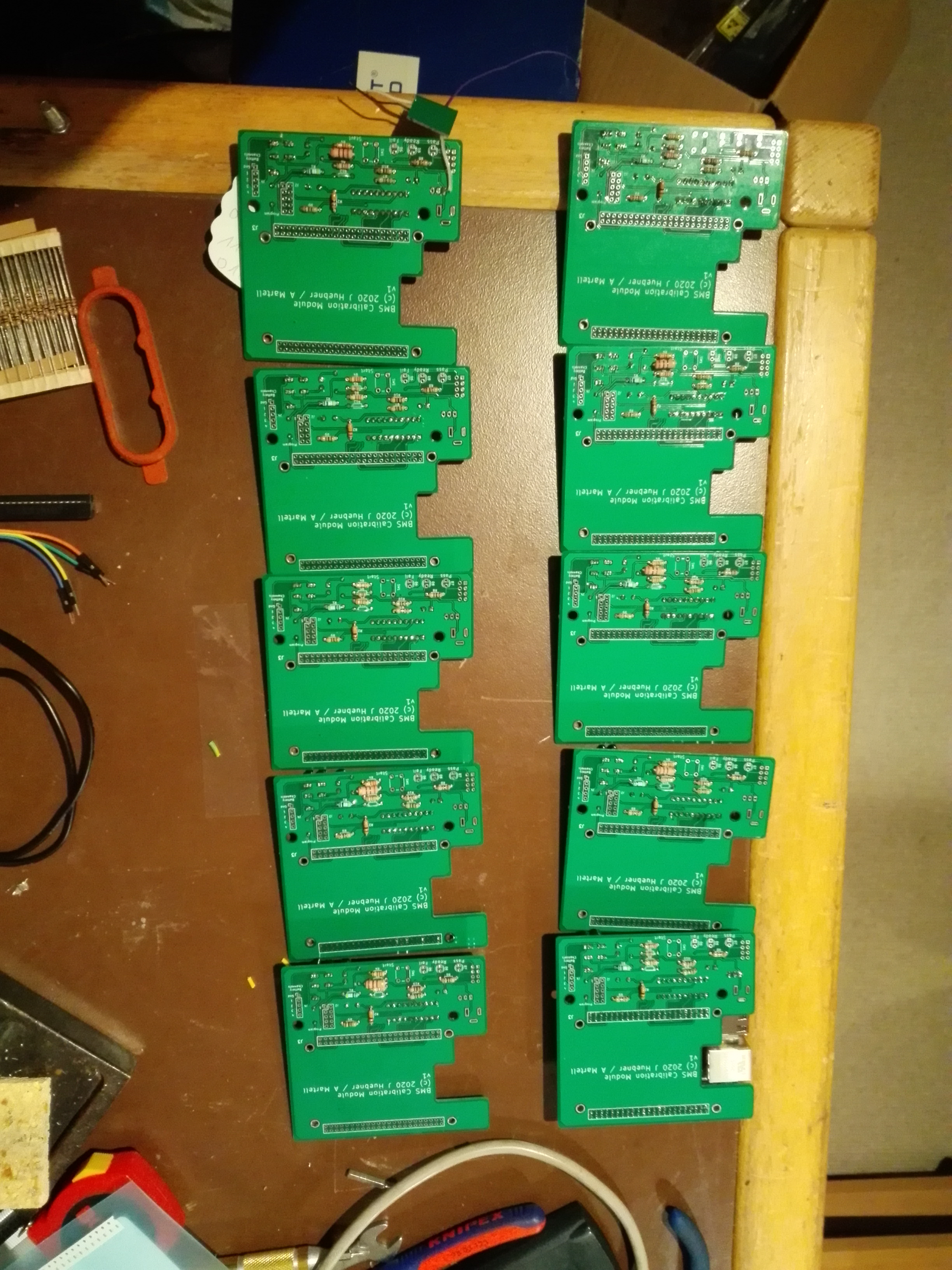

Johannes, I am trying to get my calibrator with sequencer working properly and I was wondering if you could clarify how it should operate.
From documentation I gathered that signals: 2kHz clock and 100mV reference are applied to PA6, which one is determined by state of PA5.
By looking at the calibration code I see that after everything is setup and initial values are read from EEPROM then:
1) PA5 is set to LOW to initiate clock calibration and 2kHz clock should be applied to PA6 at this time
2) Once clock is calibrated, PA5 is set to HIGH to apply 100mV reference on PA6
4) 10s delay is initiated (to quiet things down before ADC calibration?)
3) After 10s delay things are getting ready for ADC calibration but then PA5 is pulled down again to LOW!? which turns sequencer back into clock calibration mode. This means 100mV reference to calibrate "differential gain correction" is not present when it is needed as PA5 is not changed back to HIGH until the very end, right before flashing LED2-LED4 to signal completion of the process. I am little bit puzzled by this because calibration could not be completed this way.
How does your sequencer operate?

I'm using a shell script for calibration, so that goes to the next step whenever PA5 toggles. You can modify the code if that doesn't suit your sequencer. Data may be sent out on PA7, but that is disabled. You need to uncomment TX_DDR |= TX_PIN; down at the bottom for it to work.
It is a strange format, I used to interpret it with my logic analyzer: 9600 16N2

Johannes, thanks for very helpful the tips. I am making good progress on calibration. Now that I got sequencer fully figured out it appears that calibration sort of getting stuck on "differential_gain_corr" and/or "differential_gains". But from looking at the code I start to suspect that this process may actually take a while since increments are very small (+/-1) and we are taking decent number of samples every time and this is multiplied by number of channels.
Based on your experience, what are the expect calibration times for those boards?
It can take up to 30s.
Of course it is possible to speed up by taking just one measurement and calculating new gain. But somehow that never came out right and I stuck with the small increments.
