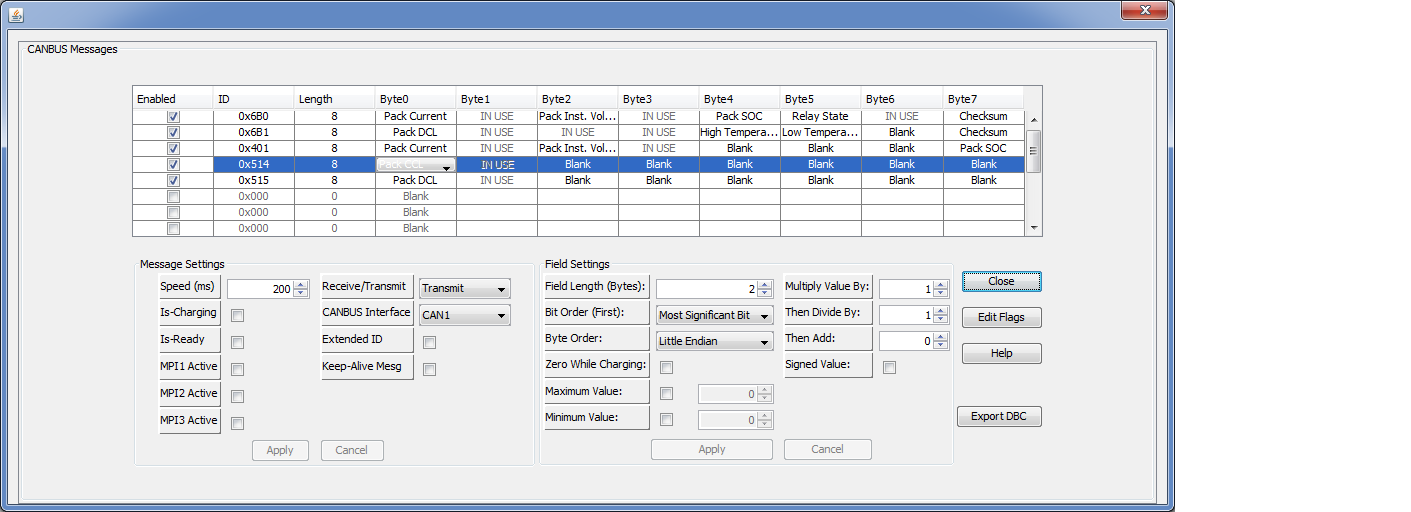

I'm looking to set IDC min and IDC max via a canbus message sent by my BMS, that way BMS is happy and not opening the contactor when under load because it sees too much power going in or out of the battery pack.
I'm using a SDU logic board V6 runing the 4.97R firmware.
How do i setup these can messages using the web interface ?

You have to use custom command because parameters don't have the CAN facilities. So
can rx idcmin a b c
a, b, c being bit offset, bitt length, gain (usually 32)

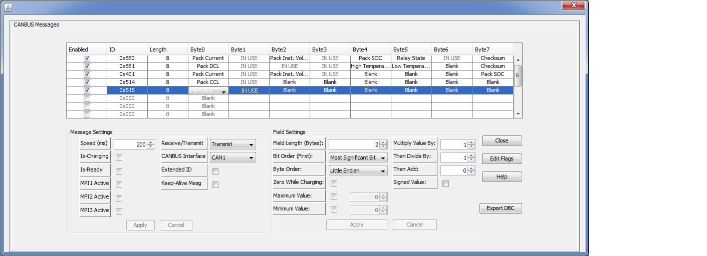

I got arround to doing it (finally), i seems that the command to send was missing a parameter before a concerning ID.
So the commands i used are :
can rx idcmax 1301 0 16 32
1301 being the id in decimal (0x515),0 being the bit position, 16 being bit length (2 byte) and 32 the ofset.
can rx idcmin 1300 0 16 -32
1300 being the id in decimal (0x514),0 being the bit position, 16 being bit length (2 byte) and -32 the ofset as we want idcmin to be negative.
Since i'm using orion 2 bms the data sent is some what diffrent, as you can see in the pictures attached.
Biggest difference is the byte order on the bms side.
After a little testing when going over the max limit is like when the inverter goes overtemp. I can't really do more testing as my car is not road worthy yet (no doors, roof or body panels) and we are in lockdown again..
