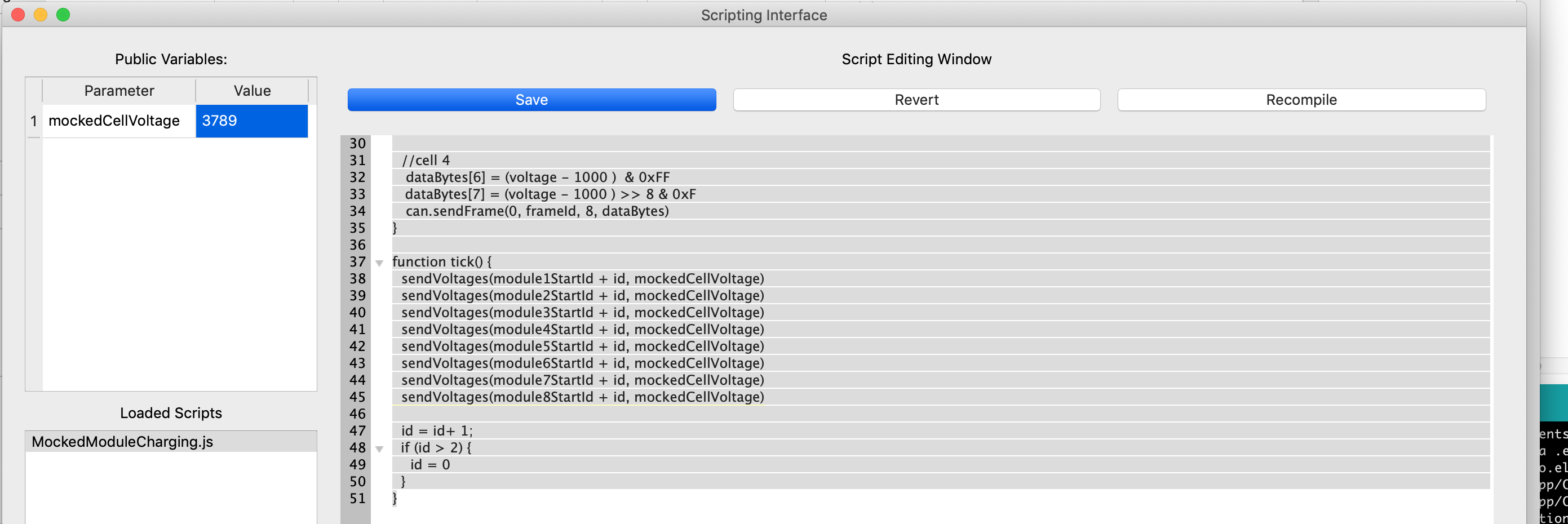

The voltages are there for the VW modules, there's also a SavvyCan script in the same repo to send out frames for the modules at a chosen voltage.
Anyone got an explanation of how the temperature frames work for the VW modules so I can add those to the DBC also
