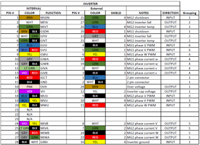

Questions concerning "how it all wires up" (post 14 above)
1. If I wire all three output phases of MG1 together and wire all three output phases of MG2 together and wire both those bundles to the positive terminal of my Warp 9 DC motor, will this interfear with the operation of the inverter to provide power to the DC motor? If it does, what additional diodes/parts/wiring are necessary in order to make this scenario work properly?
2. The DC controller has two PWM outputs: for MG1 and MG2. If the output PWM for MG1 is connected to multiple MG1 Speed signal Wave pins (pin 4 GUU, pin 5 GVU and pin 6 GWU) to activate the three associated IGBTs simultaneously, will this have an adverse effect on the system to provide power to the DC Motor? Same question for output to MG2? If the simultaneous initiation of the PWM is a problem, what is the solution to providing the full potential to the motor?
3. Is it true that MG1 and MG2 shutdown pins 14 and 25 must be connected to 12 positive in order to use the MG1 and MG2 inverters?
4. What are the voltage values that MG1 inverter fail (pin 22) and MG2 inverter fail (pin 27) have for success and failure?
5. The C5 six pin connector, pin 1 needs 12v+ in order to activate the DC/DC converter. Does this have any affect on the MG1 and MG2 inverter functions? Does the B+ wide blade Connection need to be connected to the 12 volt Battery + terminal in order to have C5 pin 1 to be effective?
6. Are the MG1 and MG2 inverters independent of the DC/DC converter (C5 pin 1 connection)?
7. Does the DC motor negative terminal connect to the inverter high voltage negative bus along with the high voltage battery negative?
8. Does the Inverter Ground (pin 16) need to be grounded to chassis at all times?
9. The two pin connector (12 volt plus and minus) separate from the 32 pin connector in the inverter is assumed to have negative grounded to chassis at all times and have positive connected to 12 volt battery when the key for the vehicle is turned on and after the pre-charge sequence has completed, then 12 volt positive disconnected when the key is turned off? Is this correct?
10. The inverter case should be grounded to the chassis. Is this correct?
11. Starting Sequence
Check:
Inverter case is grounded to chassis
Inverter ground, pin 16 is connected to chassis ground
High Voltage + Battery Pack (167 volts) is available to inverter
High Voltage - Battery Pack connected to Inverter - and motor -
Accelerator input (5 volt, signal, ground) connected to DC card.
MG1 pwm and MG2 pwm connected to dc card.
MG1 pwm connected to pins 4, 5 and 6 on 32 pin connector
MG2 pwm connected to pins 9, 10 and 11 on 32 pin connector
Wide blade B+ connected to 12 volt battery positive.
Key turned on
2 pin 12 volt+ connection turns high
C5 pin 1 (DC/DC) turns high simultaneously
Pre charge completes, 167 volts connected to inverter
Check transmission is in neutral
Press accelerator
Accelerator signal rises
This is as far as I get, nothing else happens.

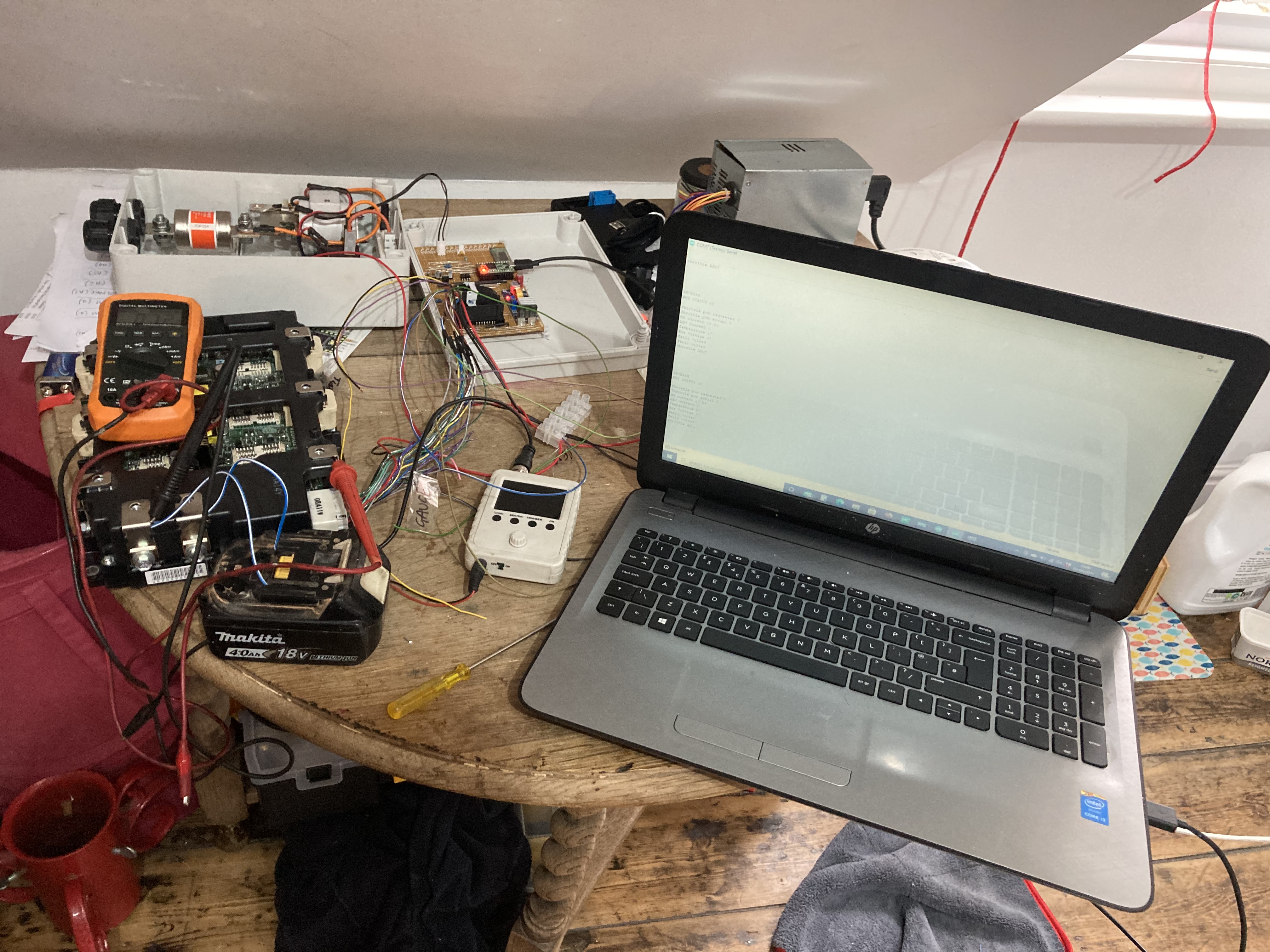

Have you checked output with a scope to see if you are getting pwm? This is one of the first steps setting up these systems since it allows you to test for inverter function without needing to fully power on. If you aren't getting pwm out then we shouldn't even be talking about any high voltage.
Re: Prius Gen2 Inverter DC Motor Controller
I just got a single channel hand held scope. I'll see what I can find on the output of the DC controller (pwm generator).
Eric

Ok I have a spare gen2 kicking around so I will try and make a dc controller and test it on my RX8 to see how it compares to my own, does anyone have the info on phase current sensor outputs and and other useful values to hand as I’ll port over my arduino control to do it, I presume to drive the igbts high I just need to send a +12v pwm

Oh and with that scope, connect the red clip to 12v+ and the black clip to one of the outputs of the Damien card.
I've got the same scope, quite a value for the price!
You are almost there!

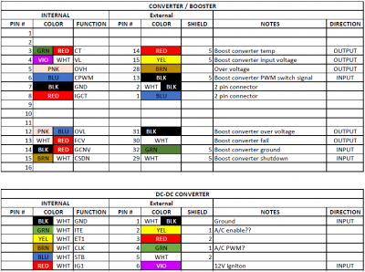

Eric looks lie there is a typo in the wiki MG1 shutdown is listed as pin 14 but i believe this is wrong and mg1 shutdown is pin 20 pin 14 actually goes off to the boost converter and i believe its the boost converter temp signal,
this pinout from the gen2 development thread is lifted from the workshop manual i believe
- dcandboostpinout.PNG (84.46 KiB) Viewed 13306 times
- Inverterpinout.PNG (103.53 KiB) Viewed 13306 times

I think that was me, and I think it was based on Damien's notes. It's possible I made a typo, I definitely didn't figure any of this stuff out, I just tried to help document it.

I can confirm that the wiki is wrong for mg1 enable as I mentioned above, I had to resort to bench testing on the kitchen table as my wife has taken over the man lab to work from home!
