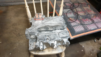

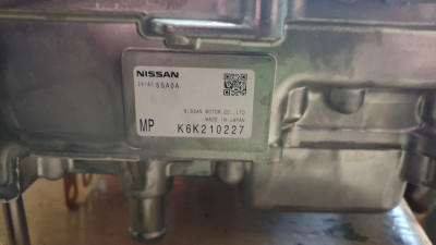

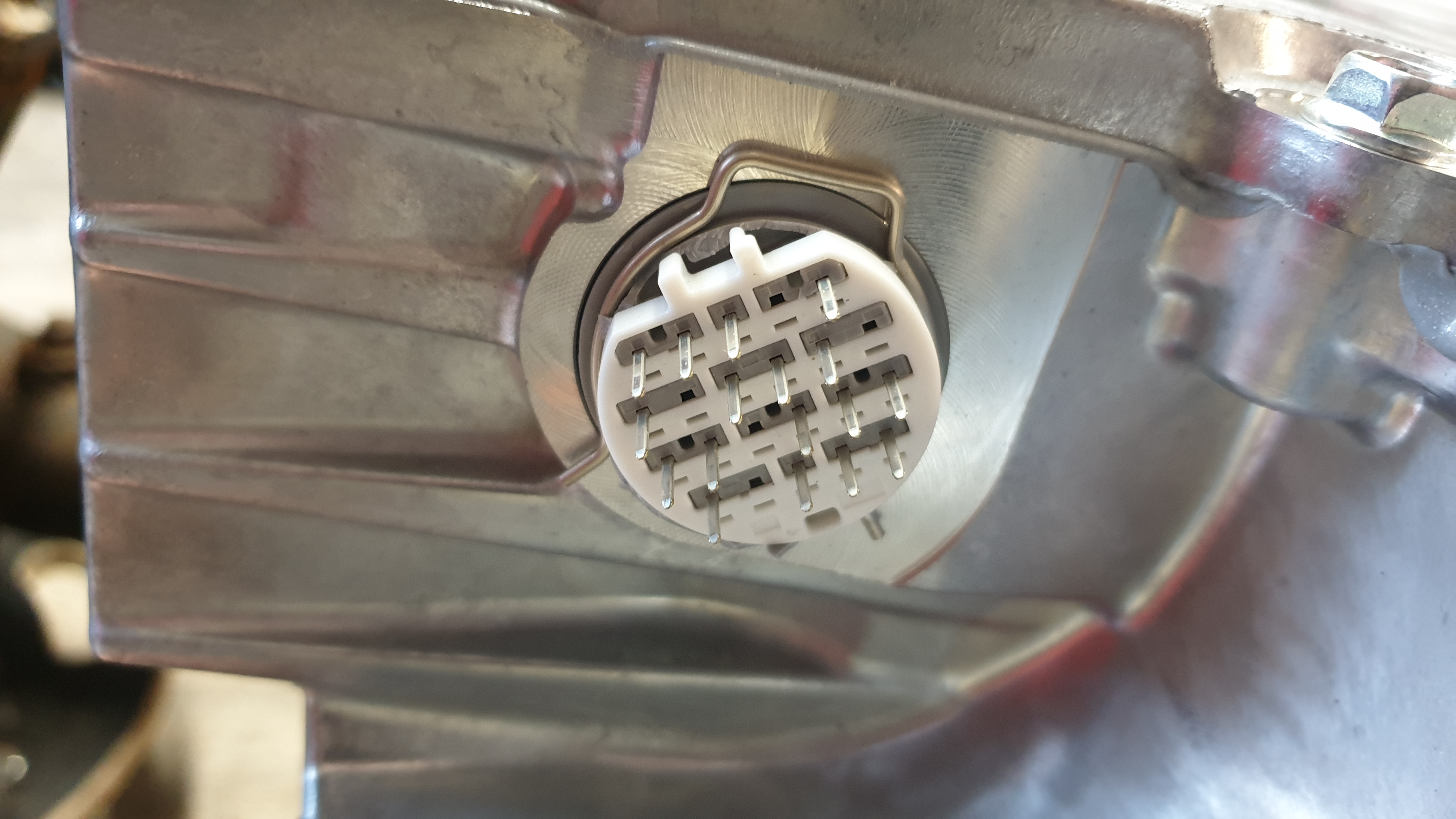

Gen 3 leaf inverter arrived today so will be trying to give this the zombie module treatment. Right now its too cold for me to work on the cars to test the regen code so going to work on the charger module for the next few days and get it running with a volt charger to get the bugs out. That and I need to charge the E46 soon and the pcs won't happen straight away. annndd I need to charge and balance the front pack for the E65......soo many cars....

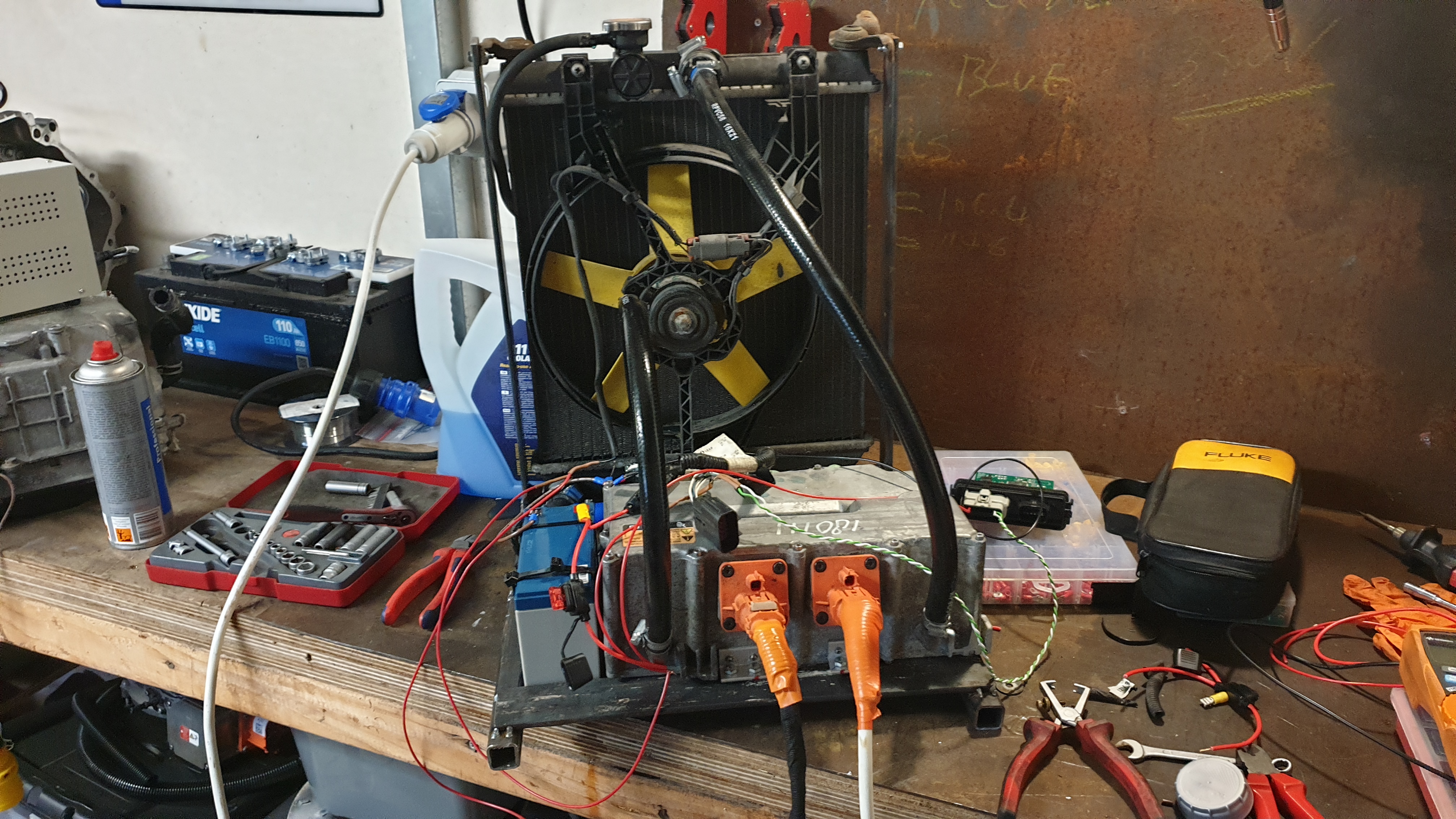

Just got my "middle class man's charger" up and running with a spare leaf vcu. Now on to charge enable via can for the zombieverter.

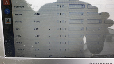

Yeah the coda is a different beast. Used one in the Range Rover build. Anyway, connected up the V2 and V3 taps from the isa shunt to the battery in the E46. Bugs! I think this is a left over from the evtv code I ripped off. So fix this and move to floats on the voltage display. What could go wrong:)
mdrobnak
Posts: 692
Post by mdrobnak »
Yeah they were doing some weird stuff with voltage differences...
Do note (I assume you know this...but you know what assuming does) - Power and such is calculated from V1 - so that should be the highest voltage!
