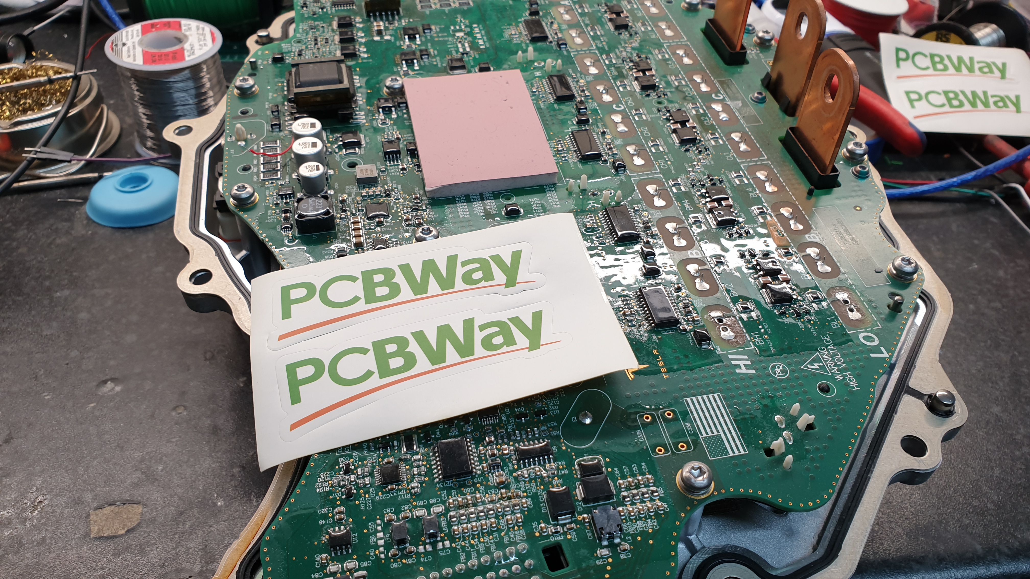

Ok folks long time no update. Thanks to PCBWay I think we have a neat solution. Won't be cheap (bare boards a little over $100USD each!) but I think this is going to work. Basically taking the provious design, shrinking slightly to allow more overlap of the adapter board and main board pads and going to a flexi pcb material with gold fingered ffc connections on all 4 sides to solder to the pads. Need to do some back and forth with their engineering people but should have boards very soon. I should also note that PCBWay are sponsoring these boards for me. If it works out I'll get them to populate the next batch so wish me luck:)

Boards are now in production at PCBWay.

Just got a shipping notification from PCBWAY. Boards are on the way:)

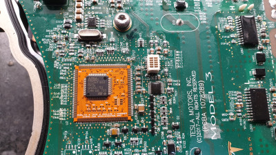

Got a little present from PCBWay:) I think we have a winner. Video and reveal soon.

I'd call that more than a hint.
In a way this is the best of the both worlds - massively engineered acquisition / power supply circuits, with a just-as-complex-as-needed motor control firmware.
Nice job!

Internet : You can't run a Musk motor with a measly little Stm32.
Johannes : Hold my beer.
This is an amazing job. While I'm sure someone will figure out how to flash the OEM chip over CAN like Tesla does, this is a great alternative.
Combine this with a BMS, CCS Charging and a VCU and you could run a whole car.
