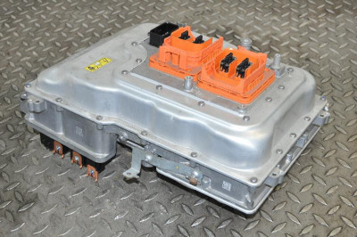

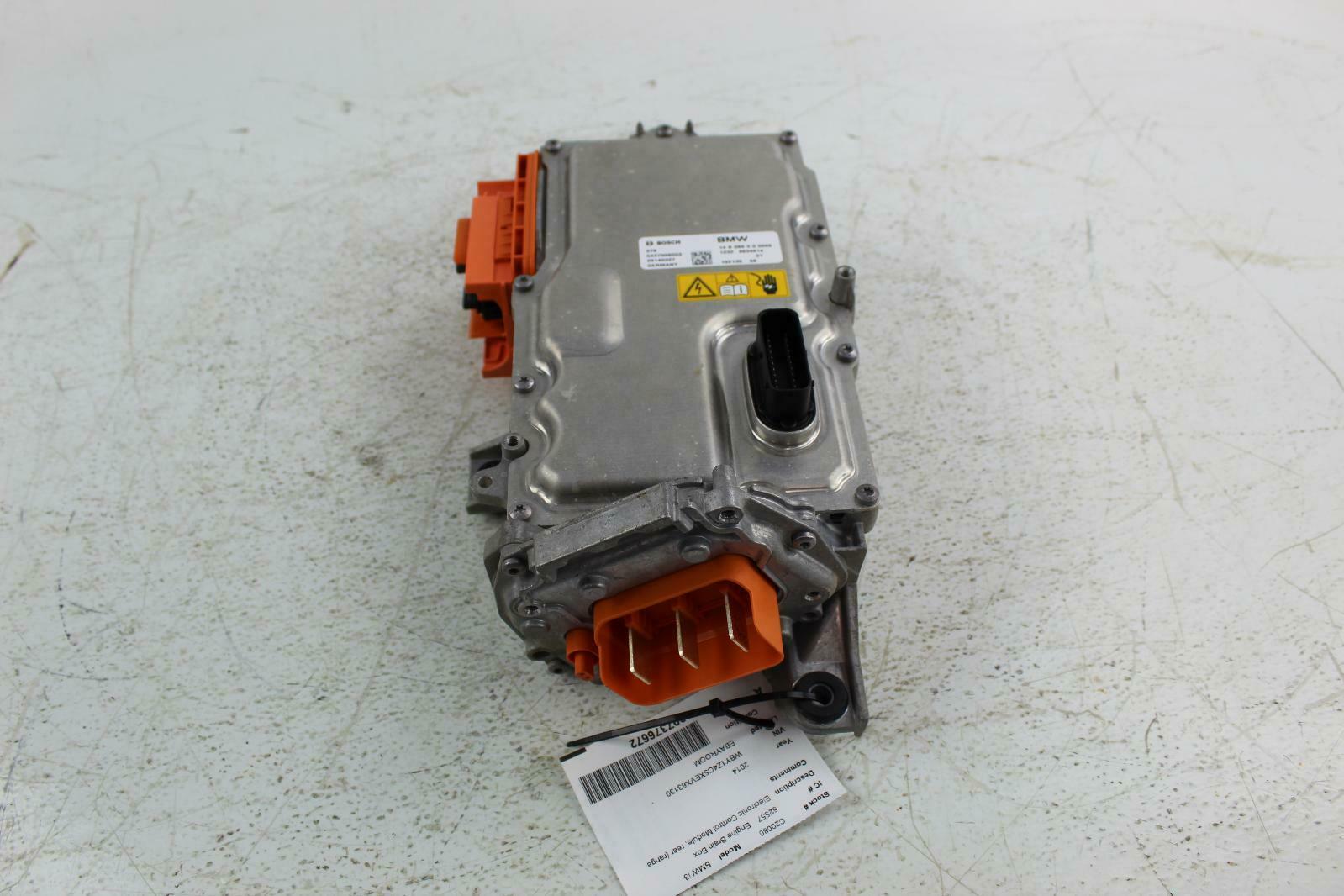

AFAIK - There are two parts.
REME - Small inverter for the optional range-extender (650cc gasoline with 25kW generator). Used to charge the battery with up to 25kW and to start the engine. Disassembly video:
The inverter is this part. I don't know if the hardware is different for versions with / without REX, at least the partnumbers are different.

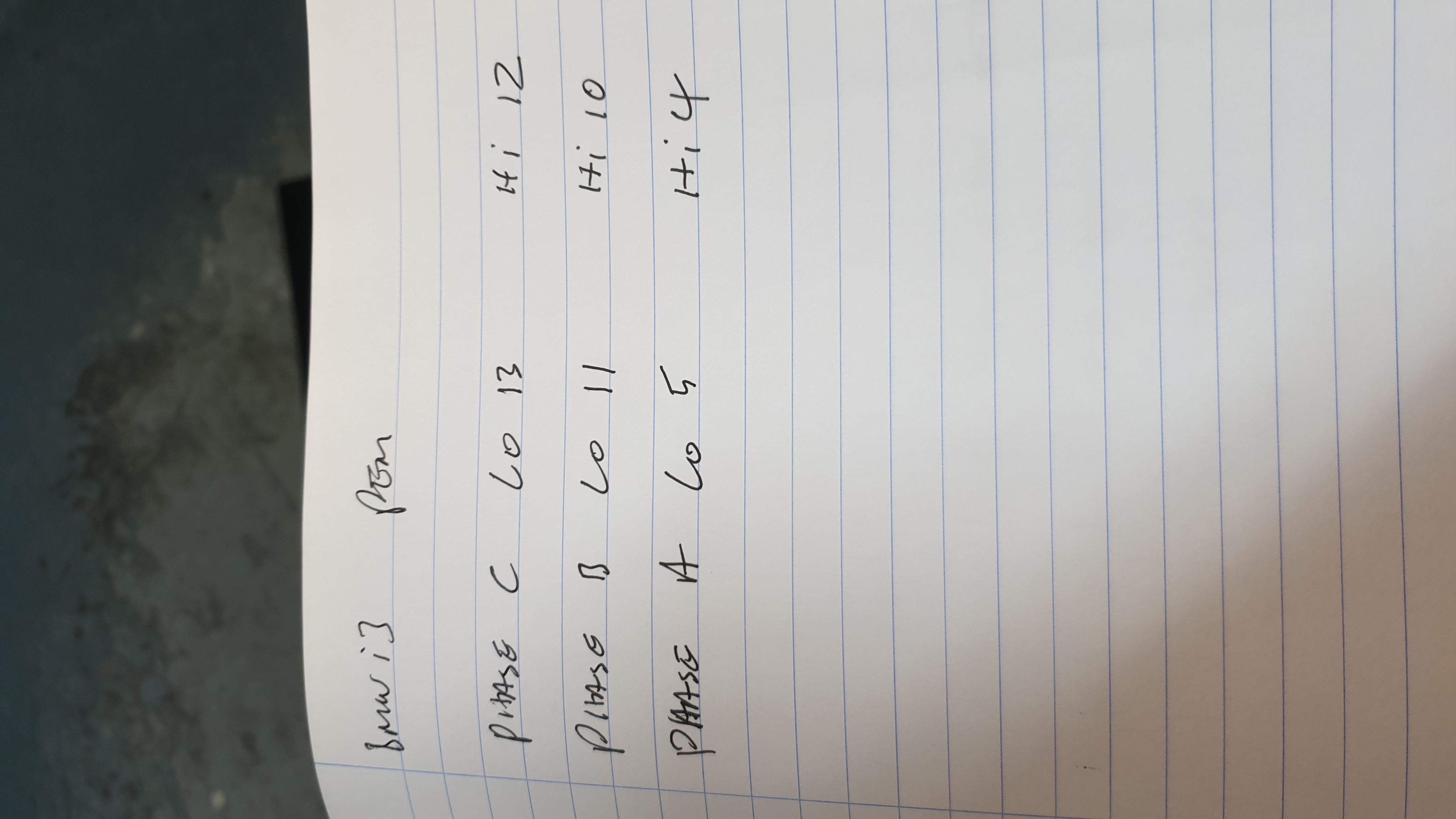

Hi Can i just check this is correct to your notes. and can i confirm what LEM is?
sorry its hard to sometimes read other peoples notes and i rather not blow up the IGBTS

Thanks unfortunately i think this is the charging unit not the inverter.jnsaff wrote: ↑Sat Jan 30, 2021 11:21 am Theres this one here for about 62 euros with obvious damage but maybe a cheap place to start https://www.xdalys.lt/en/bmw-i3-inverte ... 350_others

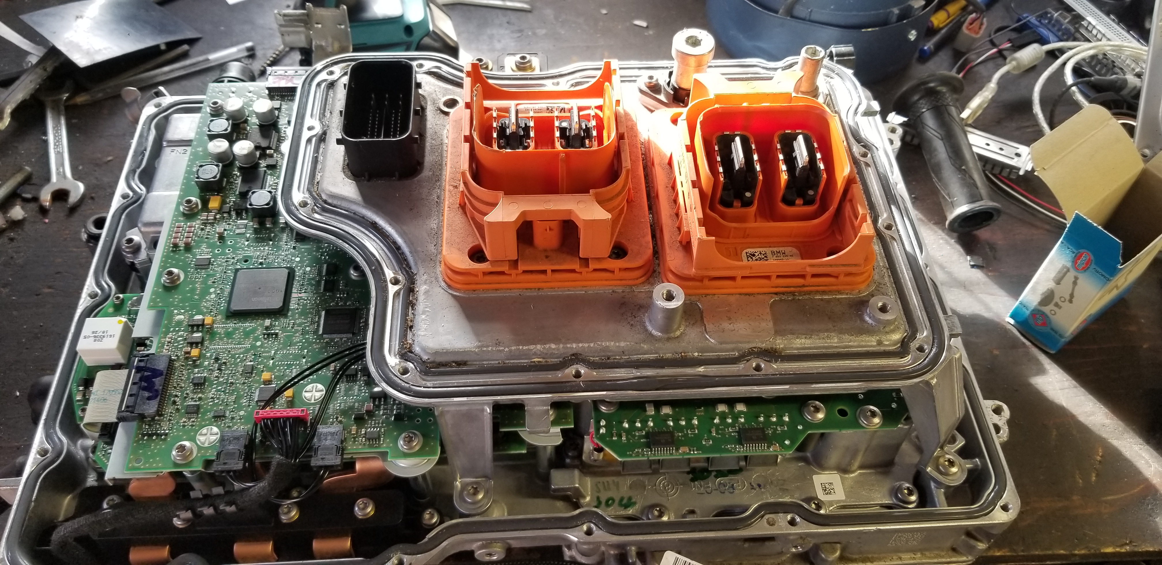

Bmw went about the design of the i3 high voltage system in an interesting manner.
having a charging unit, main inverter, and mini inverter (for REX)

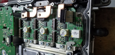

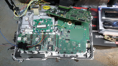

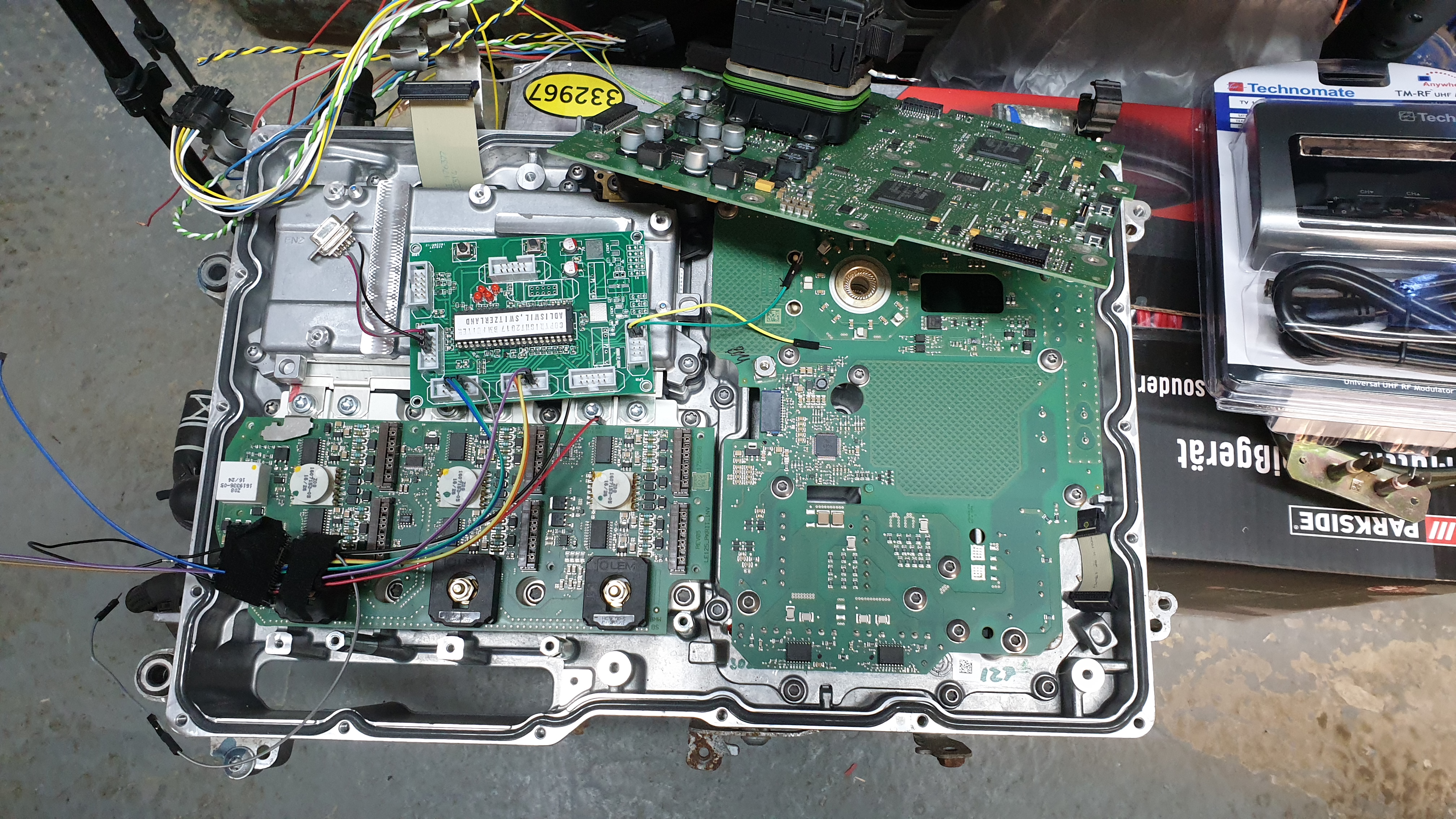

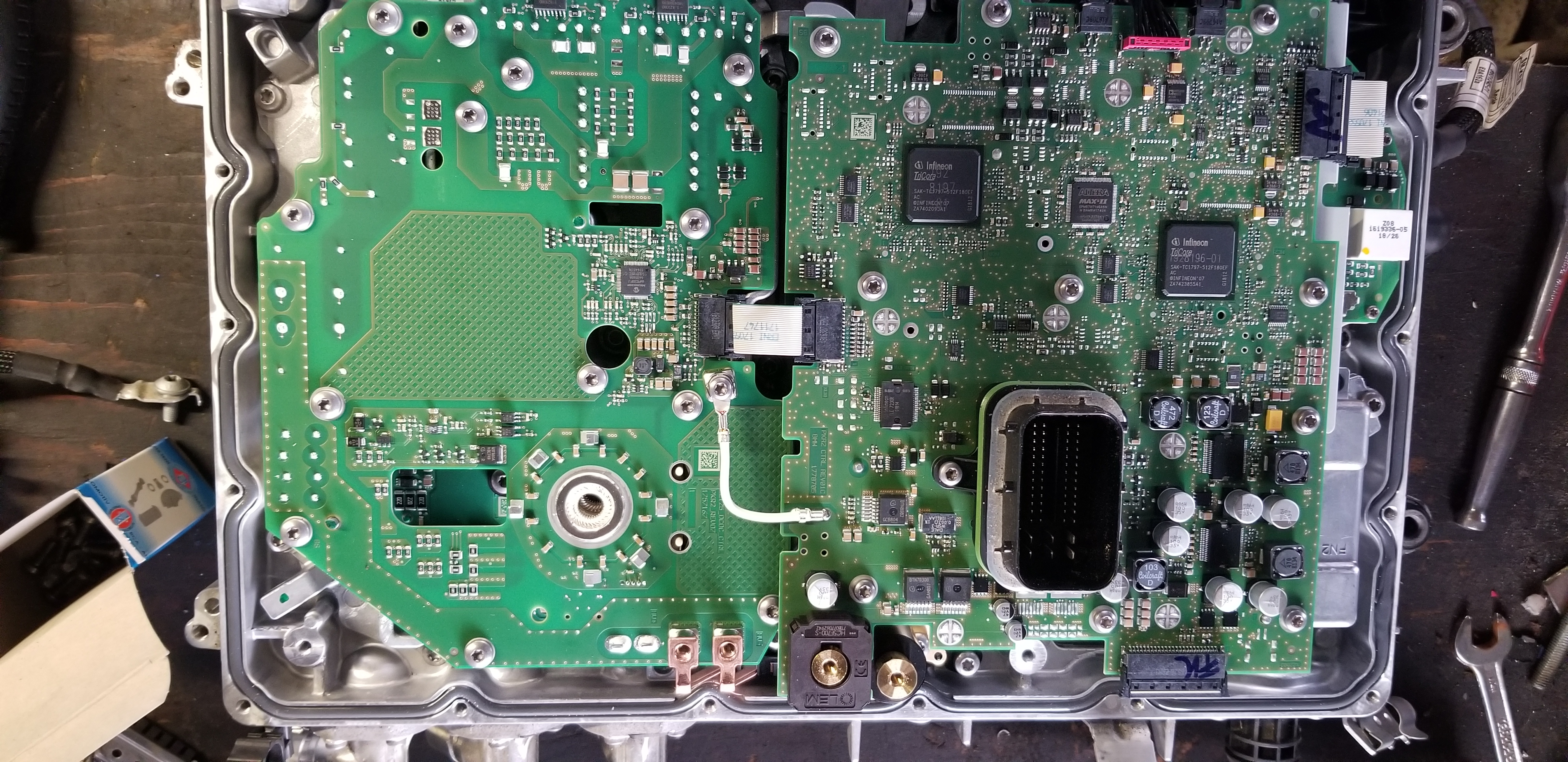

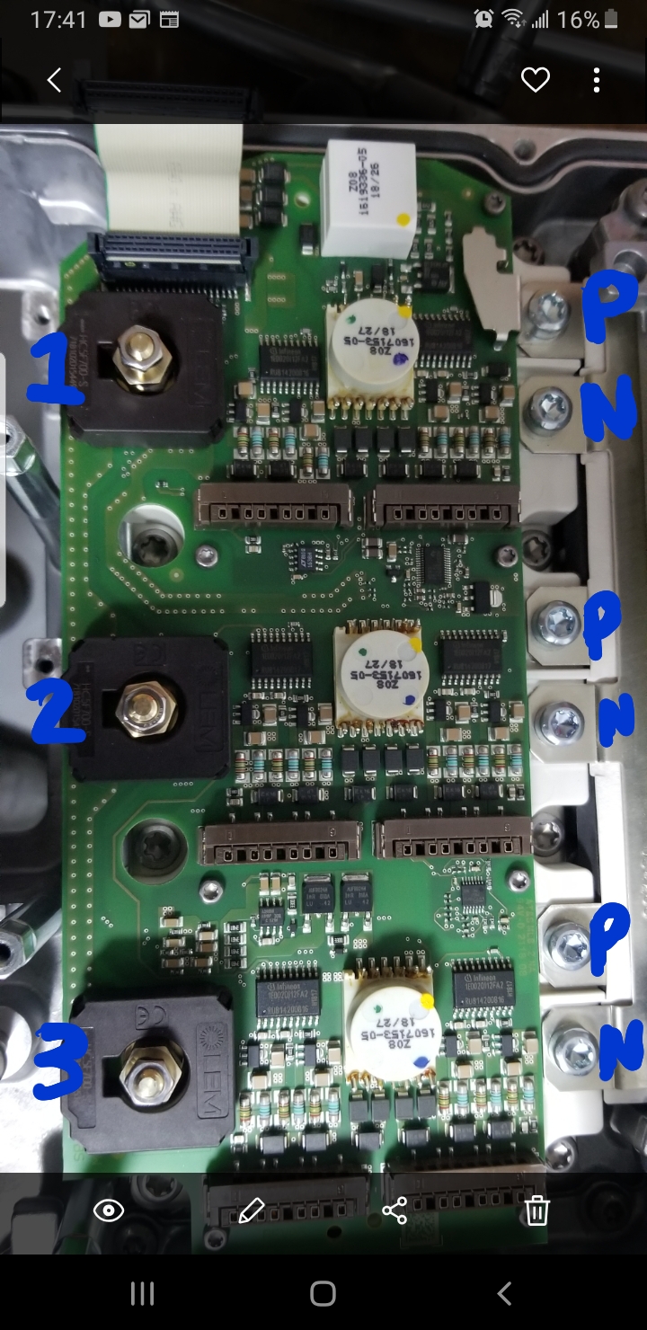

Got my inverter today and started the teardown
got to the IGBT board and started probing the lines, figured out a few more pins. the IGBT has 3 temp sensors but couldnt seem to find where that signal leads to.
looking at the connector on the board looks like
https://www.mouser.co.uk/ProductDetail/ ... YDcw%3D%3D
still need to give it a proper measure but hopefully its correct
Pin No I/O Description Notes
1
2 i 32V in
3 i 32V in
4 i IGBT A HI
5 i IGBT A LOW
6
7
8
9
10 i IGBT B HI
11 i IGBT B LOW
12 i IGBT C HI
13 i IGBT C LOW
14
15
16 O IGBT DRIVER UVW Upper Ready
17 O IGBT DRIVER UVW Lower Ready
18 O Current Sense C Signal
19 O Current Sense B Signal
20 O Current Sense A Signal
21 GND Switching Mosfets ?
22 GND Switching Mosfets ?
23
24
25
26 GND IGBT Driver ground
27 GND IGBT Driver ground
28 GND IGBT Driver ground
29 GND IGBT Driver ground
30 GND IGBT Driver ground
31 GND IGBT Driver ground
32 GND IGBT Driver ground
33 5V IGBT Driver Power
34 5V IGBT Driver Power
35 I IGBT PSU 12V on
36 O IGBT Driver Fault
37 i 5V LEM Current sensor Power
38 GND Current sensor Ground
39 GND Current sensor Ground
40 GND Current sensor Ground
21 22 23 24 25 26 27 28 29 30 31 32 33 34 35 36 37 38 39 40
1 2 3 4 5 6 7 8 9 10 11 12 13 14 15 16 17 18 19 20

Here is a description of inverter for those interested. If you use "Google translate", it is easy to read, for non Hungarians. Written by Péter Varsányi,

Got mail from Damien
With the existing notes and the jumper cables he sent along it took me 10 minutes to fire up the inverter.
It draws 2.3W from the 32V line in idle and 10.7W when running at 8.8 kHz. 5V for openinverter board and BMW logic are provided by my USB hub, so apparently not much draw there.
Despite this being the same power module as in the Leaf 3 inverter (Infineon FS800R07) the deadtime requirement seems much lower. When run with 800 ns it draws 70 mA from 50V and with 2.5us it draws 66 mA. Will investigate further, maybe they use smaller gate resistors. There is certainly no electronic dead time guard, because setting deadtime 0 sends the lab supply into current limit.
The openinverter board almost bolts onto the 4 screw holes on the capacitor cover
According to Damien the cover is pretty bulky so there should be enough room for an adapter board and a mainboard on top.

Oh, forgot to ask. Whats the purpose of pin 35? When trying to feed it 12V it seems to be pretty much a short. Just leaving it open allows operating the inverter though, so might not be important.
- Posts: 6713
- Has thanked: 368 times
- Been thanked: 1542 times
Re: i3 controller hacking from diyelectriccar.com
Now, I tried to find a nice analog bus voltage and temperature signal. Not so, they chose to digitally isolate in form of a ADS7955 ADC and ISO7241 digital isolator. Bus voltage sensing itself is 1V/100V resistor chain.
So now I can attempt to use it or just put some analog isolator on the adapter board.
- Posts: 6713
So UDC is on CH5 and 3 temperatures are on channels CH0-CH2
Using the ADC is pretty simple, It is just sent 16 bits with instructions and returns the value resulting from the second-to-last instruction. I could just resort to bit-banging SPI via udc/tmphs and some general output pin. Or I could place an attiny or something on the adapter board to convert the digital data stream back to analog.
EDIT: will just add to the existing pinmap:
1
2 i 32V in
3 i 32V in
4 i IGBT A HI
5 i IGBT A LOW
6 /CS (ADC)
7 SDI
8 SDO
9 SCK
10 i IGBT B HI
11 i IGBT B LOW
12 i IGBT C HI
13 i IGBT C LOW
14
15
23
24
25
There is also another isolator coupled to some mystery ST chip (it says 78387).
1
2 i 32V in
3 i 32V in
4 i IGBT A HI
5 i IGBT A LOW
6 /CS (ADC)
7 SDI
8 SDO
9 SCK
10 i IGBT B HI
11 i IGBT B LOW
12 i IGBT C HI
13 i IGBT C LOW
14
15
23
24
25
- Posts: 3661
- Has thanked: 10 times
- Been thanked: 334 times
Nice find. Obviously this is why they needed the tricore mcu:)
edit: my mistake, it has 2 tricore mcus.
