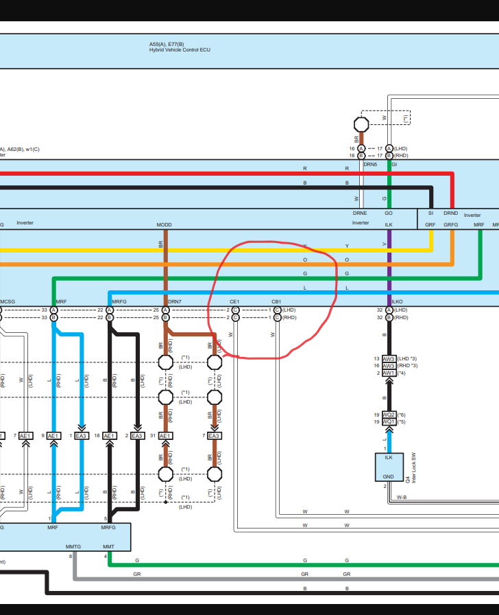

But, if its possible here are a couple requests for the video,
1. would it be possible to show a wiring diagram for the 450H VCU. (I'm using the one that one of the members put together but I not sure if its 100% correct)
2. how to program the ESP8266. i don't recall seeing this part in the prius programing video
3. fix the issue with web interface. (MG2 stuck at 9000rpm)
4. sequence of operation (what state the inputs need to be in so the VCU can control the inverter, IN1, IN2, Brake Light Switch, Throttle1, Throttle2,) and anything else that you could think of that might prevent inverter to operate)
5. explain the purpose of the following pins (HSDN, GI, ILKO, CE1, CB1 on the inverter) You mentioned some of these are not required but what do we do with them?
Unused pins just ignore. Tape them up and forget about them. The only one that may be of use is HSDN (Hybrid Shuntdown). Pulling this to 12v I seem to remember shuts down the inverter but leaves the comms running.

This should be covered in the wiki?
HSDN - high voltage shutdown - pull to 12v to shut down the inverter power stage, pull to ground or leave connected to use the inverter.
GI - engine speed from the GS450h combustion engine. Not used.
ILKI / ILKO - interlock signal for the various covers over high voltage components in the GS450h (fuse, service plug, etc). These signals are sent to the HVECU in the GS450h, they are not used by the inverter.
CE1, CB1 - these do not exist. I'm not sure what you're talking about. Maybe they are on the Camry inverter?

I was pretty sure that these weren't required for the VCU or Inverter but, I was running out of options trying to figure out why the transmission wasn't turning.CE1, CB1 - these do not exist. I'm not sure what you're talking about. Maybe they are on the Camry inverter?
I just doubled checked the wiki and did not see this info there.This should be covered in the wiki?
So...I vote "YES" to have this info added.
Image was taken from the GS450H Wiki

Can I get a WOOT WOOT!
After LOTS of trail and error finally got the transmissions to do "Spiny Things"!
Lot of wiring connections because I did not have any part of the wire harness which at the time when I bought the inverter and trans, I didn't think it was a big deal, man I was wrong on that one. And I'm an electrician.
Also a big hurtle for me was trying to figure out the programing part of this whole deal, especially the firmware change. (Arduinos, STM32's, Sketches, libraries, com ports, yada, yada, yada.
My head is still spinning!
Special thanks Damien for your latest Video,
here is a short clip.
