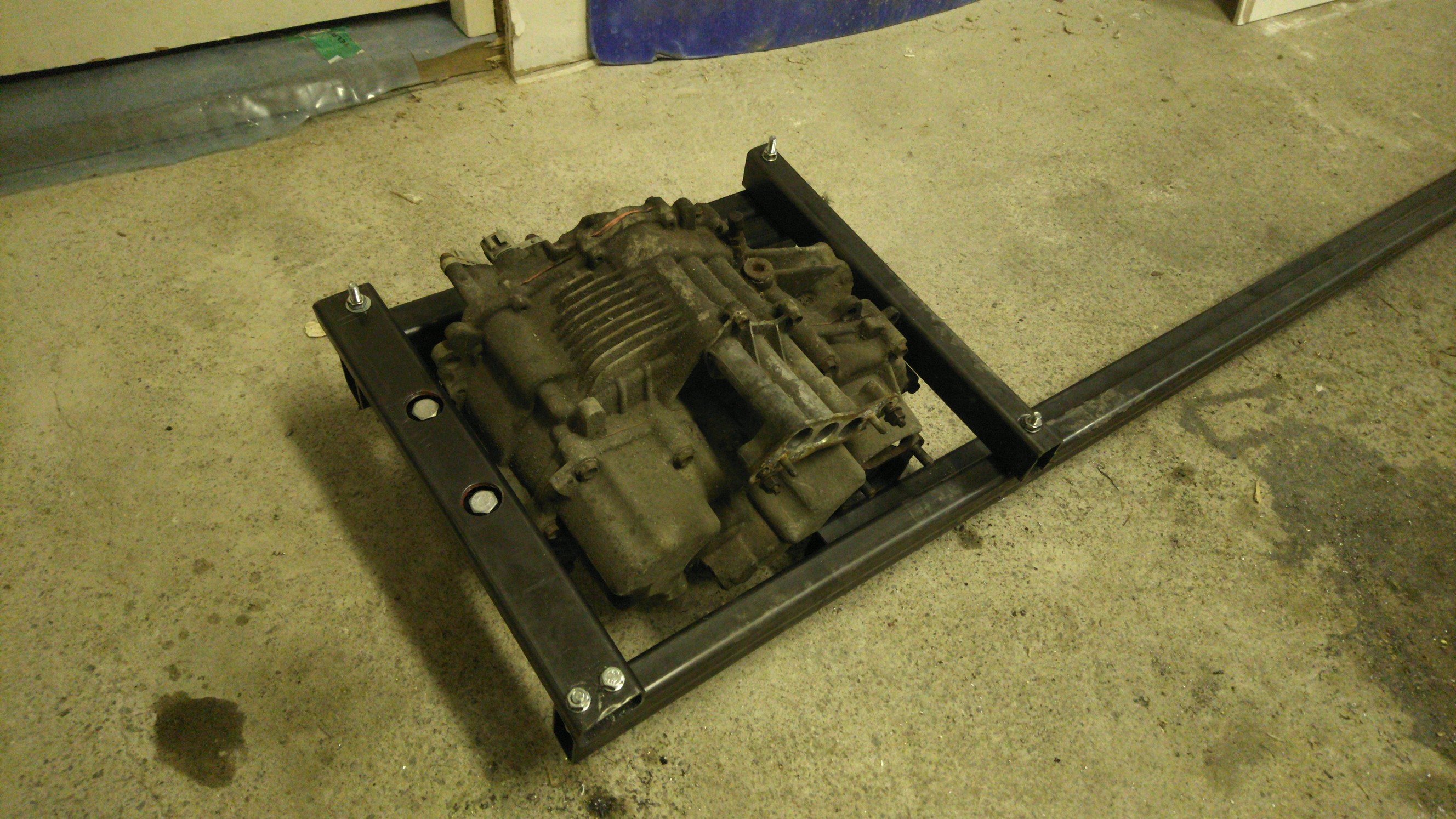

Rate my chances of staying alive operating this standstill torque testing device...
EDIT: Just a 12V supply and a laptop away from SCIENCE :mrgreen:

So far I'm not dead, and the jig stayed intact, which is already better than expected.
I made some measurements increasing the current in steps, but then got oscillation at higher current and my scale went all wonky. I need to log some stuff and see if udc goes below udcmin or something. Maybe I'll also get a cheap digital scale, those probably stand more abuse than these fiddly mechanical things.
Anyway, this is what I got so far. The current is simply throtcur*potnom. I haven't checked whether the inverter is reading correct current values compared to a clamp meter so you should assume it's probably wrong. On the other hand, I'm assuming the force measurements and calculated torques are somewhat accurate. Probably a good idea for me to check Iq and Id also, the inverter shouldn't be using much Id in this case.
You can extrapolate from these values that to make the published 900Nm torque, it would take 391A. And I need to go above that in order to learn what I want to know.

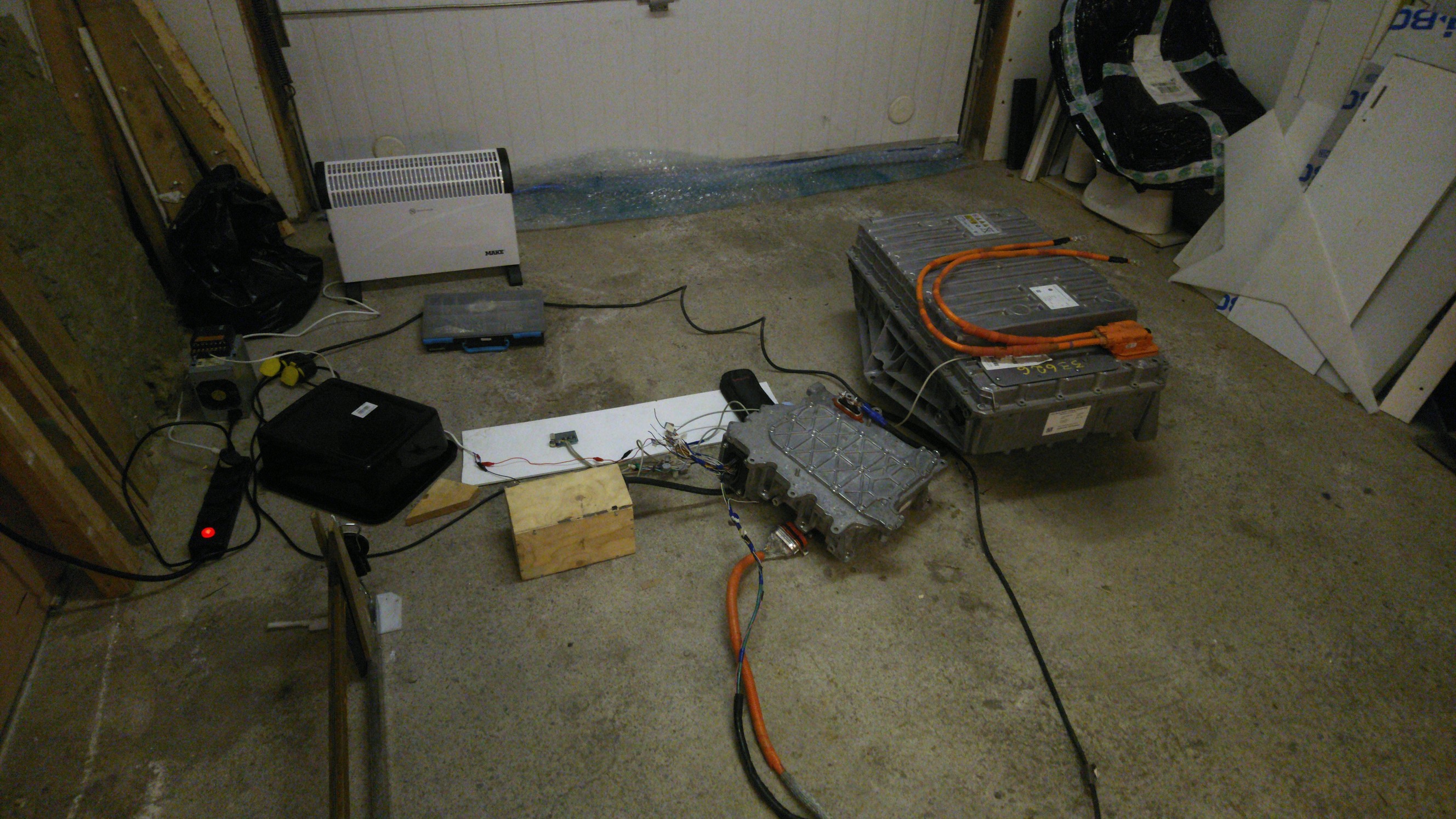

Skipped the isolation transformer, now I'm limited by my 10A fuses and 10A mains circuits. Still, got some more measuring done.
My goal is to get to the point where the graph is no more linear. So far it's straight as a nail. At the highest measuring point about 2.3kW seems to be used.
EDIT: I'm thinking I might need to double the torque and current to get to the non-linear region. To achieve that I probably need to quadruple the power, that is about 9kW and the Leaf inverter wants that at under 500V. I'll need to rig up a HV battery.

We have positive HV battery arrivement. 80kW @ 360V should be more than enough to either destroy everything or give me the results I want.

I increased idcmax up to 40 and this is the result.
I think there's like 35A going into the inverter at maybe 335V at the maximum point which would be around 12kW. At the end the MGR did feel slightly warm to my extremely cold hands, meaning maybe its temperature increased from 0°C to 20°C or something, so the total of maybe 60 seconds of maybe an average of 5kW definitely were turning into heat.
So this proves the MGR will output 1200Nm at the axle, given a total phase current of around 650A.
The "bang for amp" did decrease after 800Nm, but the graph isn't getting flat. I think I need to crank up idcmax even more. Obviously there's no way it can produce these torques for more than a couple of minutes without literally melting, but sometimes that's all the time you need.
EDIT: Graphed rough power values
