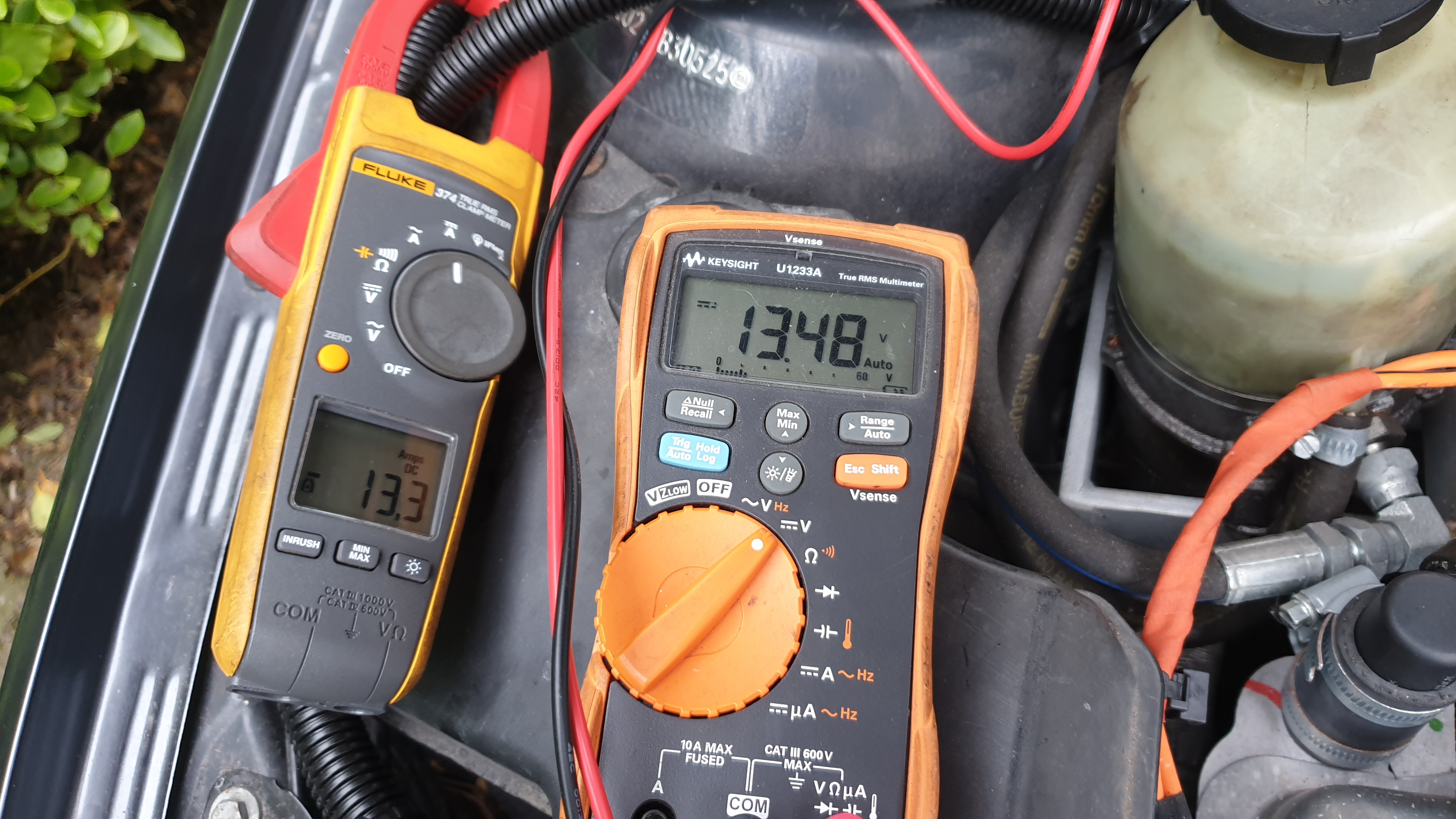

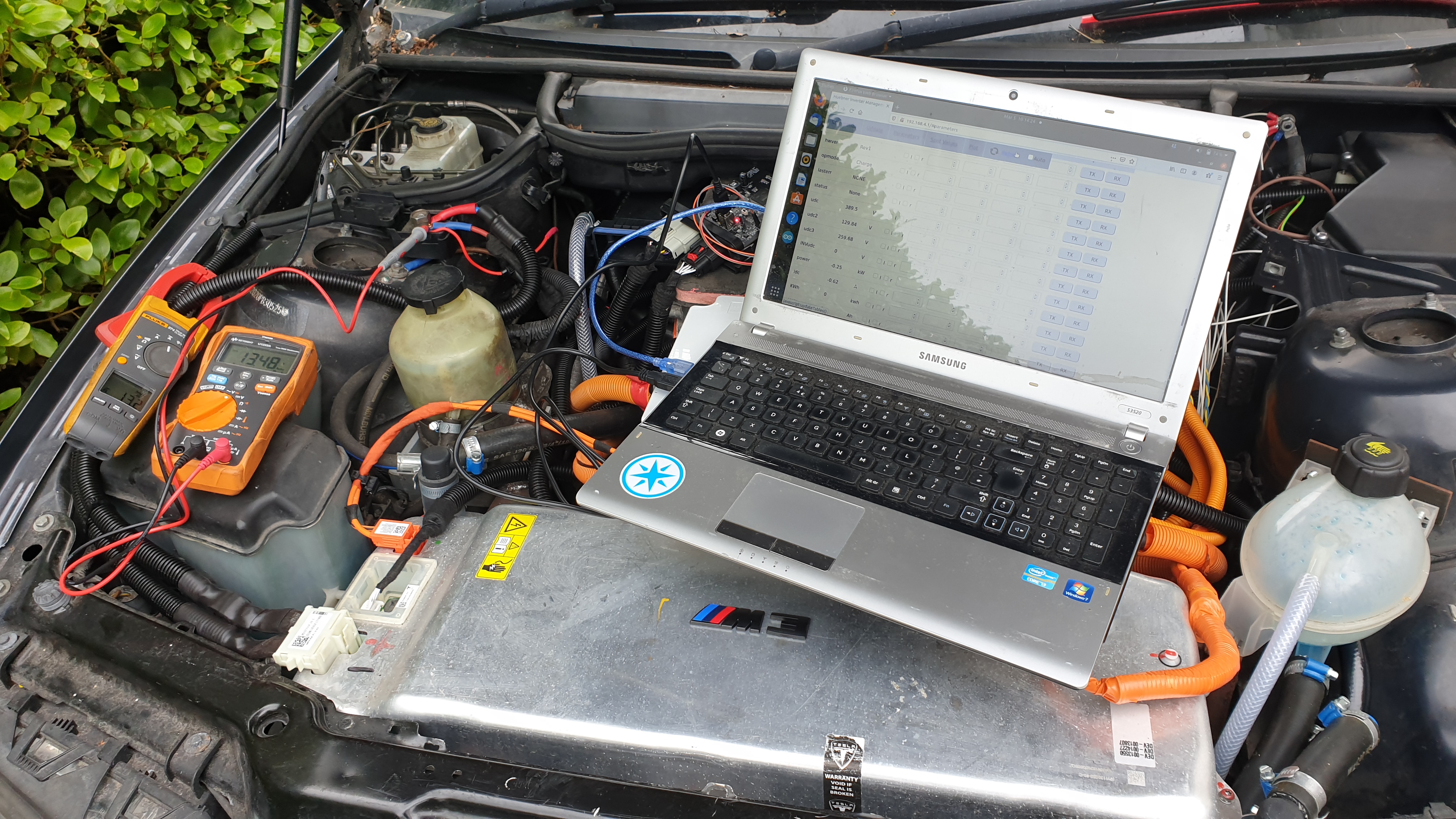

Well, Finally back to the pcs. Got it fully wired in to the E46 with the controller today. Now the fun part:)
- Posts: 3661
- Has thanked: 10 times
- Been thanked: 335 times
Re: Tesla Model 3 Charger
So some good news on the pcs. DCDC stage is up and running in the E46. Work on the charge side progresses well. Killing off errors and getting closer...

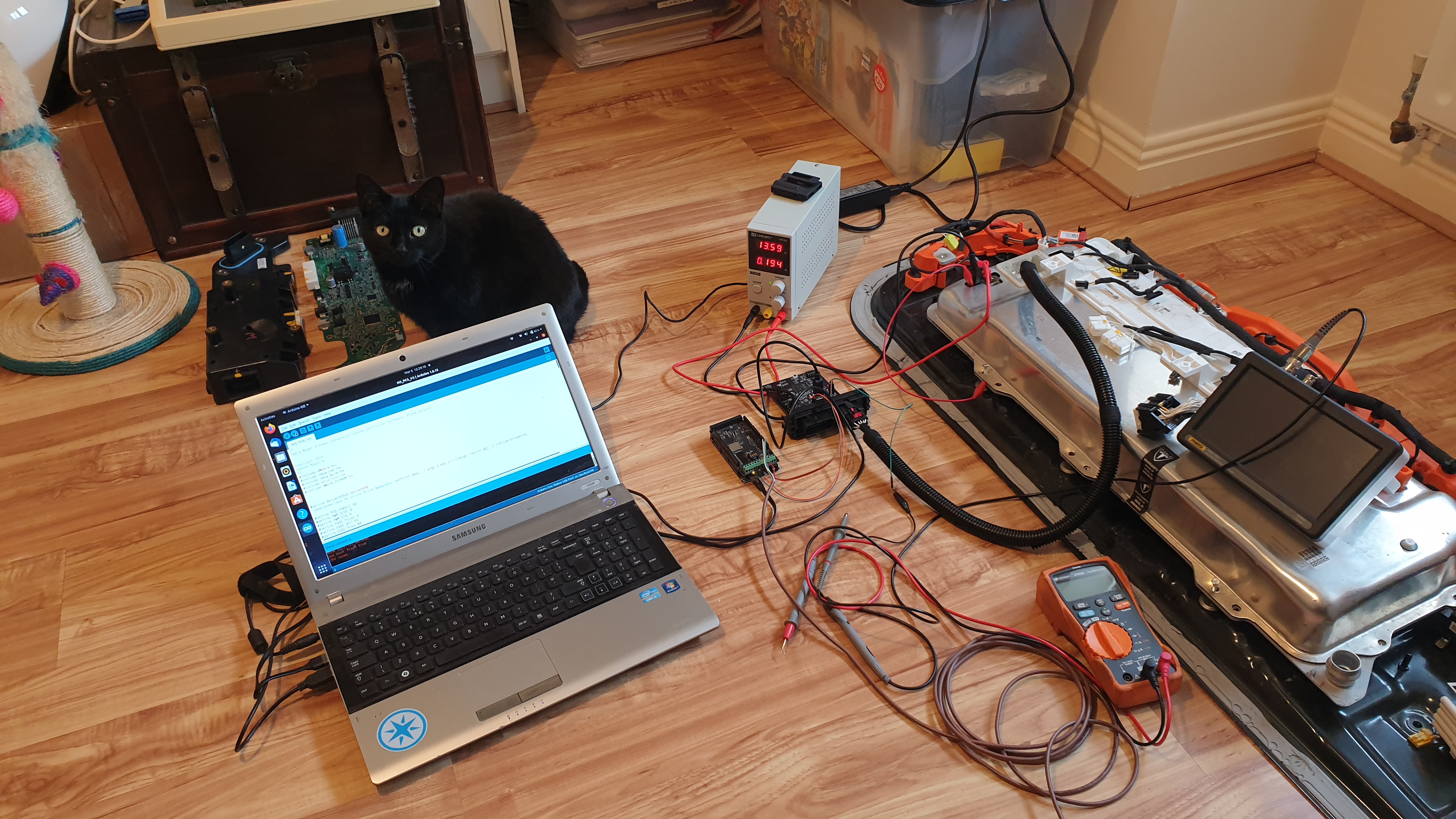

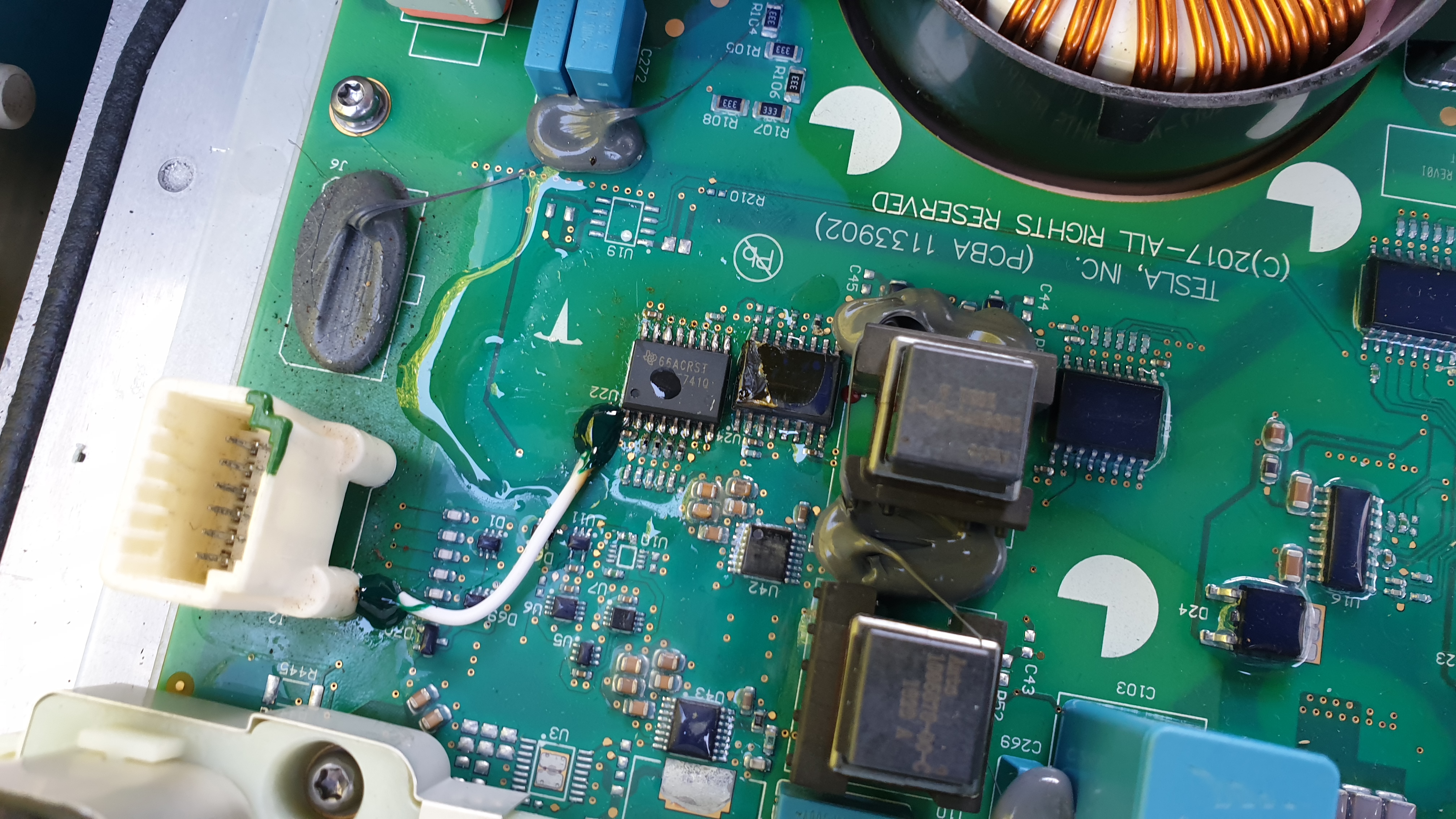

Well this was fun. Did some software work on the eu pcs in my nice warm indoors and decided today to test it out on the us version in the E46. No can responses. Got the cover off and did some investigating. Yep you guessed it. ISO7741 blown, again. Luckily I had a spare so swapped it out on the car (tour de force) and can comms re established. Not that I would ever dare to critisise the big T but just what exactly was wrong with a can transciever Elon???
But its oookay because the good news is we can now set the target voltage for the DCDC and enable/disable at will. Tested working on both us and eu version. From what I can see I'm one error away from firing up the charger...

And now have the precharge from 12v function working:)
Great progress, what is the reason why the digital isolator broke? Is it fed via external current and got a little sad when you fed it with 12v instead of 5v? =)
Have you seen any major differences on the eu / us version, apart from the feed of course

No idea why the isolator failed this time. Please see my earlier videos for indepth look at the pcs internals.

Major piece of PCS progress. Charger function now up and running:) Working the kinks out of the can messages and I still can't tell my left shift from my right shift as demonstrated by the 12v reading! Due to my evse only supplying 32amps on single phase I can't push the US version in the E46 to full 10kw just yet but I'll rig a temp 50amp supply just to prove it can be done.
Right now its using the prototype V1 pcs controller. As the firmware uses quite a bit of the work done by Matt and myself on the Model 3 charge port I'm not opensourcing at this time until we reach an agreement. Likewise I'm not sure on what direction to take on the hardware : standalone controller , integrate into m3 charge port / ccs controller , integrate into zombieverter vcu , integrate into gen3 controller etc.
Anyway, I will be doing a video soon showing the workings and describing the hardware side of things etc.
