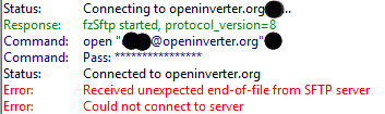

Hmm there are a few plug-ins that need updating I was going to do it but my SFTP access not working anymore.
