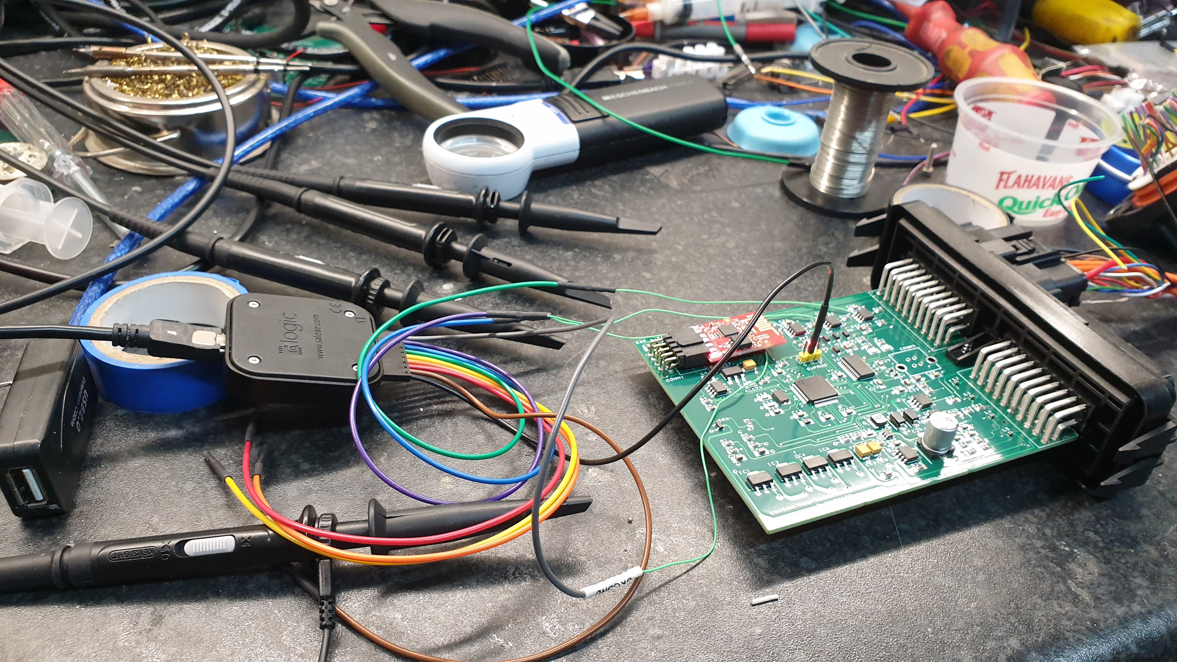

Ok sports fans we have some progress. Dug my second GS450H gearbox and inverter out of hibernation , undid the mods to the logic board that I had done during reverse engineering and wired up a bench setup.
1)At very low torque input it works perfectly. Output shaft spins nice and smoothly and we get steady speed feedback on the wifi.
2)Once torque demand is increased the motor becomes very jerky. Its almost like the inverter looses sync, resets, sees a torque demand, pumps power into the motor then trips out. rinse and repeat.
3)Tested on 30v 2 amps psu, 60v 5amp psu and 160v battery. All the same.
4)Connected up my Saleae logic and did 3 captures : idle, smooth slow running and faster rough running. Attached in the zip.
Going to see If I can spot anything in the analyser captures.

Ok I have an idea of what's going on. Pouring over the analyser data shows that in idle we are spitting out the standard htmdata frame correctly, in slow and easy we are sending a correct torque request to mg2 but none to mg1 for some reason. In higher throttle setting we are wrapping around numbers and making a mess of the data. I wonder is this a result of using dma. It is a 32 bit micro so I wonder is it treating the data like that in memory and then dumping what it thinks is correct out to the usart. Or it could be a Damien moment.........

I've been looking at the SAM Code V's this new code also. I was wondering if we were telling the inverter to re-init. There is a flag called inv_status and it was being used along with the MTH_data byte 1 to determine if the inverter requires initialization. It was also been used due to how the sequencing was being programmed.
In state 1 we could look at changing:-
if(mth_data[1]!=0)
inv_status--;
To
if(inv_status != 0 && mth_data[1]!=0)
inv_status--;
This will make sure this number doesn't wrap around.
Or you could use the new "statusInv" flag to see if the inverter is correctly online, also we can read this from the web-interface.
So in state 1 you could change:-
if(inv_status==0){ }
To
if(statusInv==0){ }
Dilbert

Thats handy.
Also your DMA ISRs don't do anything meaningful right now. No need to disable DMA after the transfer, it won't do anything anyway once it runs out of data. So if you're not planning to add anything, just disable interrupts.
Posts: 4000
Been thanked: 1114 times
Ok, in these two lines we take a 16 bit int with a possible value from -3500 to 3500 where 0 represents 0 torque:
	htm_data[26]=(mg2_torque)&0xFF; //positive is forward
	htm_data[27]=((mg2_torque)>>8);
As I understand this, we and with 0xff to chop off the 8 msb bits so htm_data[26] should contain the lsb 8 bits of the torque value? But, are we still trying to stuff a 16 bit number into an 8 bit register or does the compiler understand this and just use the lsb 8 bits?
Likewise in the next line an 8 bit right shift now brings the msb 8 bits into the lsb field for htm_data[27] but are we overstuffing the register? I am seeing data in the htm byte 28 with high throttle settings on the analyser captures which should not be there as best as I can tell....
Posts: 4000
High throttle bytes 26,27 and 28 :
0x00
0x70
0x01
Low throttle :
0x00
0x25
0x00
mdrobnak
Posts: 692
Post by mdrobnak »
26th is fine... 27... potentially undefined?
I'd do the same thing:
htm_data[26]=(mg2_torque) &0xFF; //positive is forward
htm_data[27]=((mg2_torque)>>8) & 0xFF;
Try that.
