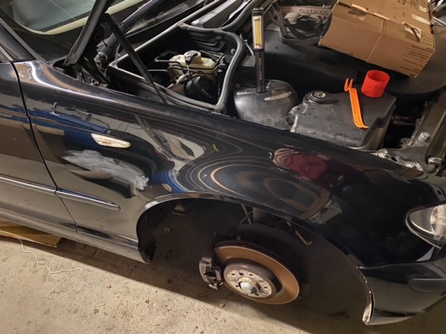

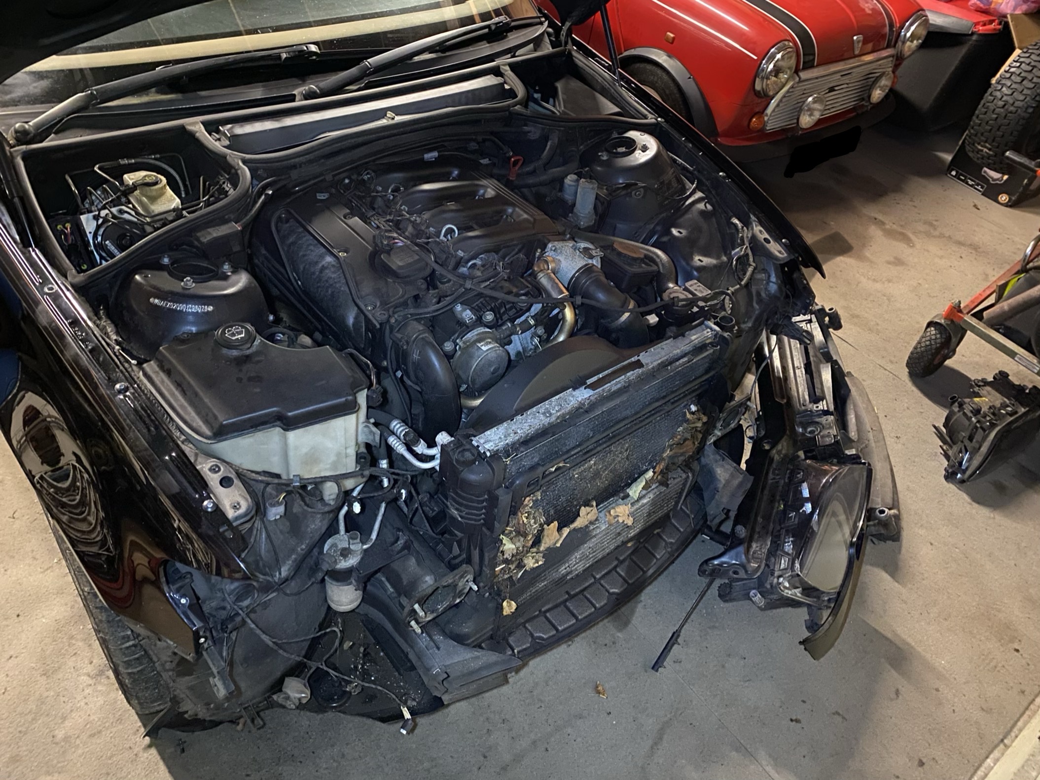

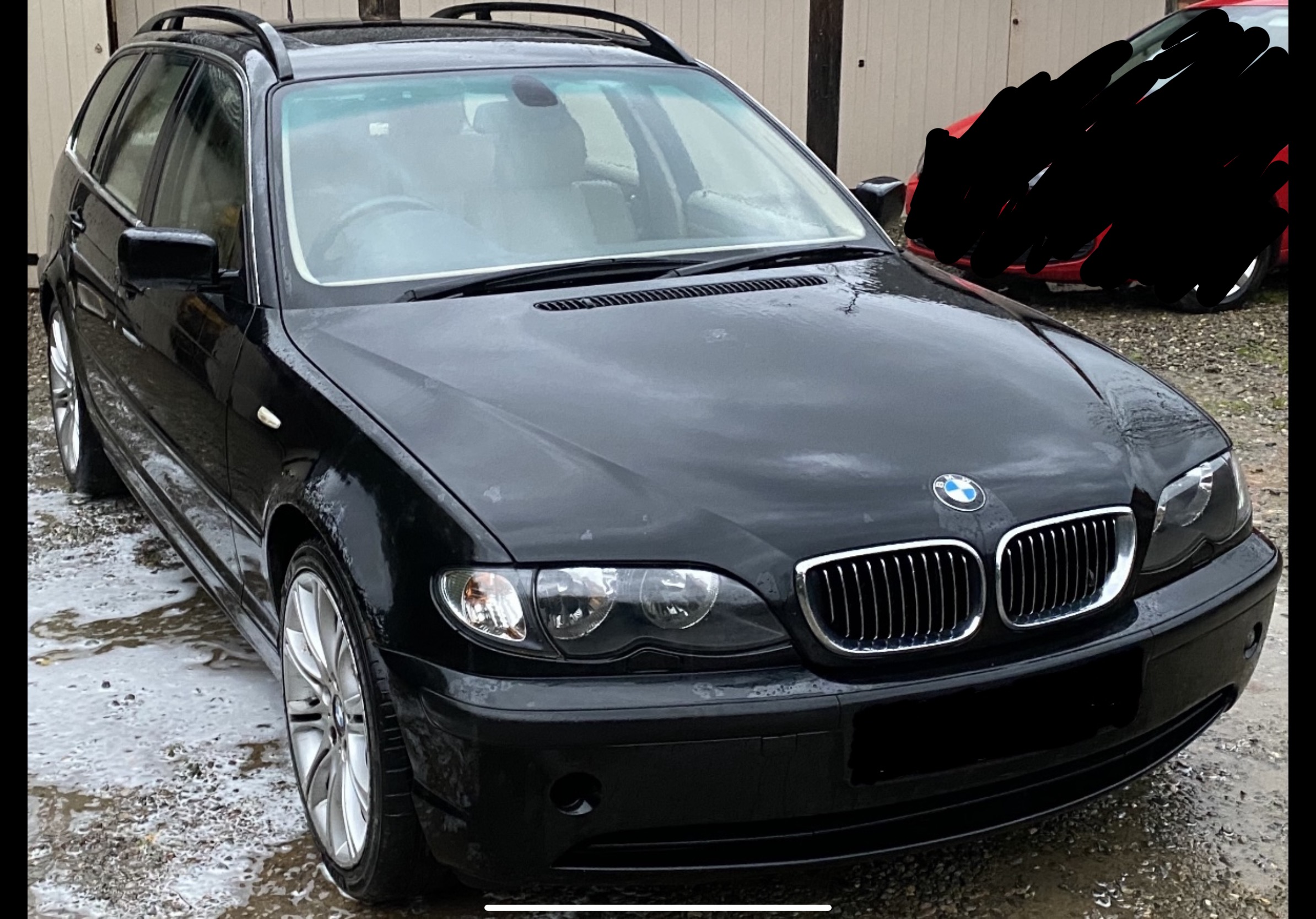

Recently picked up a 2003 E46 Touring 330D to convert.
The car in question
The car in question
It’s been a family daily driver for the last 240k miles so some touching up is needed, mainly the classic E46 rusty front arches, and a good clean. Still got a rear arch replacement to weld in. Also fitted an android touchscreen.

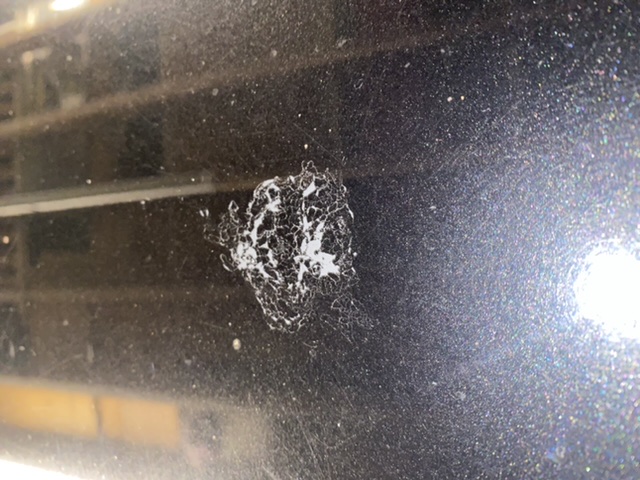

New arch
New arch
Gonna have my best try at the paintwork too as it doesn’t look so good

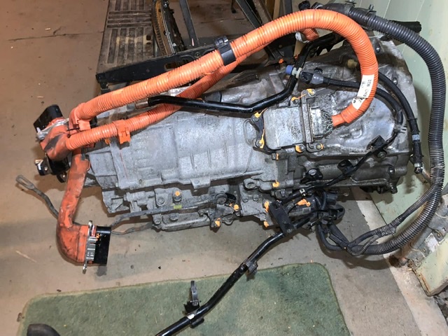

Will be using the GS450H gearbox that arrived a few days ago, will be buying a controller kit soon to get to some testing :D

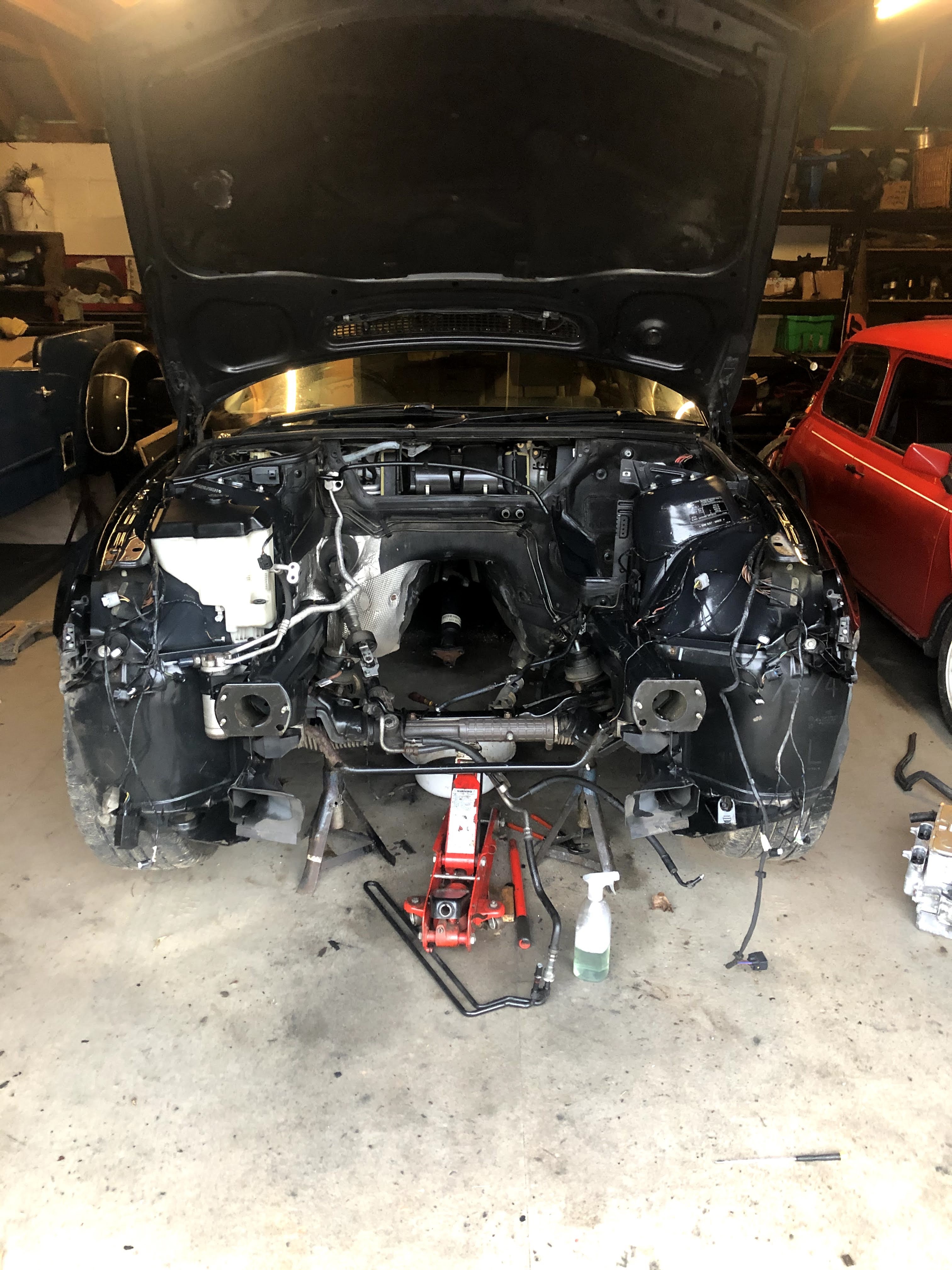

Car polished and now front end removed.
Need to finish some CAN recordings before I remove the radiator and then the dinosaur :)

Update time:
The engine and gearbox have now been deleted
Replaced the oil pump bearings and ended up having to drill out the Philips screws which had seized up, will replace them with the Allen bolts used in oil pumps on later cars.
- Fuel tank removal next, then onto test fitting the gearbox.

Update:
VCM board arrived, along with my ZeroEV gear selector, all wired up and reads drive, neutral and reverse.
Then hijacked throttle signals from the old ECU connector loom and calibrated after installing the new easy to use software
Then went about hooking up my mg1 and mg2 resolvers (assuming that MG1 is the resolver connector nearest the bell-housing end of the gearbox as that's where mg1 is)
Also connected up the communication cables from VCU to Inverter.
Applied what I thought was 12 volts from a car battery but was actually 9 volts and I got a little bit of movement for about 1/4 of a revolution in each forward and reverse before it conked out and wouldn't give me any more
Tomorrow going to try again with higher voltage.
(Side note, the negative terminal for the DC bus into the inverter is nearest the water hose point right )

You really need about 24v as a min to get it turning

Tried just now with 24v and it’s doing the same thing, it giggles a quarter of a rotation and then won’t continue, I can see it trying to turn

Also blew a 45A fuse at the same time so it’s drawing nearly 1kw
Posts: 4000
Been thanked: 1114 times
Re: E46 Touring Project Engine Delete
Sounds like a resolver wiring issue.
edit : can you spin the tailshaft by hand to confirm its not in park?

Jack Bauer wrote: Sun Jan 31, 2021 9:10 am Sounds like a resolver wiring issue.
Yes, I've tried it in a few different gears to no prevail.
Just noticed my MG1 and MG2 stator temps are over 100c so certainly sounds like a resolver issue

Got it spinning! Turns out it was the resolvers, I read my wiring diagram wrong and only used 5/8 of the connectors for each resolver, so I connected the ones I missed and it now spins!

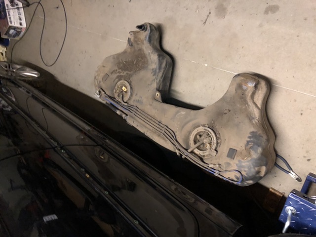

Fuel tank is now removed, space should be big enough for a model 3 PCS, planning to reuse the Fuel filler tube to the tank area as a housing for HV cables from the charge port
This weekend’s tasks are to replace the inverter connector which I’ve already started and then seat it correctly with water tight seal, then start to lift the gearbox into place and measure up for mount fabrication.

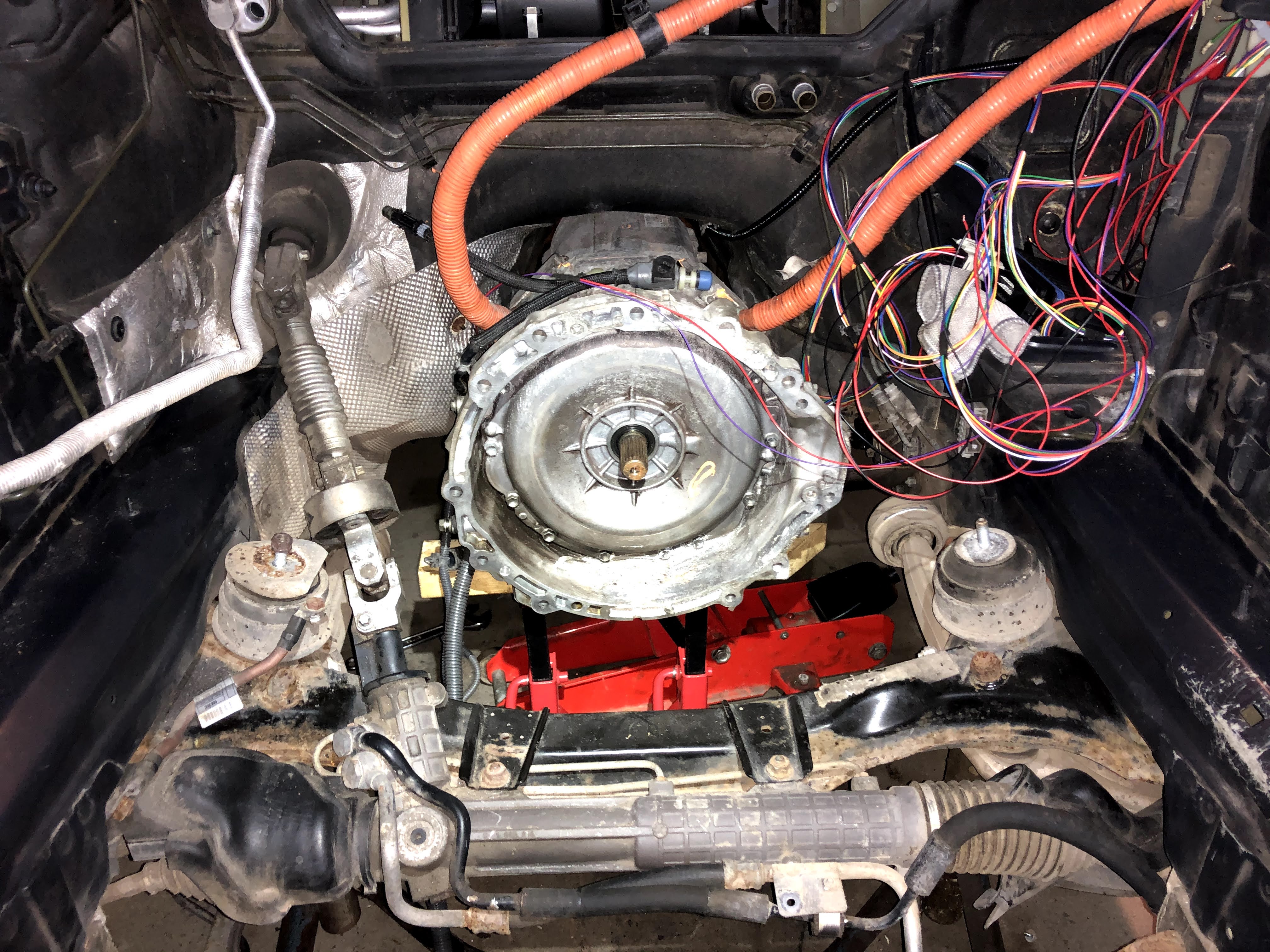

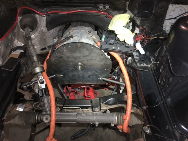

Gearbox lined up ready for mount fabrication
If anyone has a pointers / tips for mountain fabrication, it would be appreciated

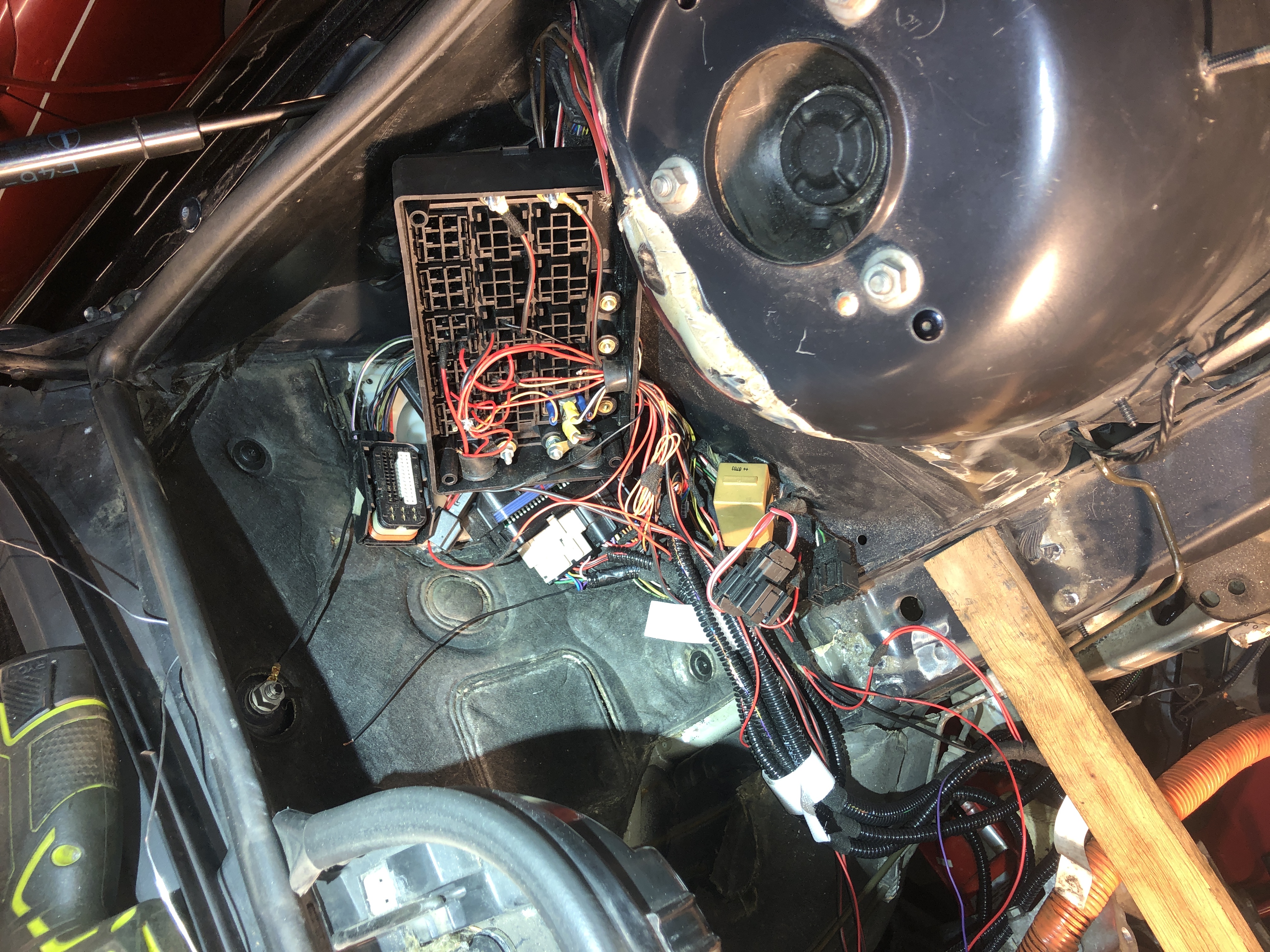

Quick update:
Original ECU compartment now removed, allowing easier access to mount gearbox mounts etc

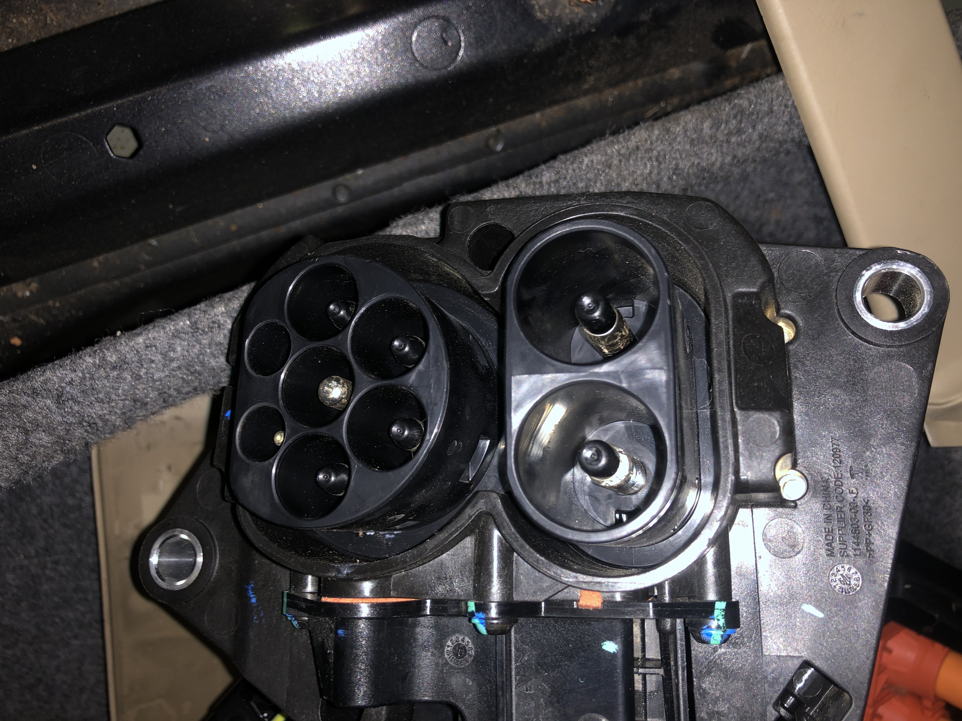

Also picked up a model 3 charging port (with model 3 PCS, charging ECU and leaf chademo port on the way as i want both ccs and chademo) readying for the controller board soon to come out.
Going to try to force the AC pins down the fuel filler as the Much larger DC pins have no chance of fitting

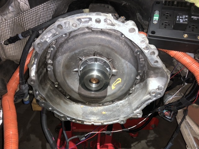

Little more progress on the engine delete project:
Made an adaptor plate for my adaptor plate, which locks the spline to my adaptor plate..... still needs to be welded but it is raised inwards from the bell housing to get a good grip on the spline and will be able to handle more than enough torque, speaking of which, made some torque reaction bars.
Also welded up a rear gearbox mounting bar with rubber mounts between them
Job for this week is to weld up the front cross bar which will take most of the front gearbox weight, should have my M3 PCS and CHAdeMO Port arriving too, also going to order a Brake vacuum Pump (either Hella UP28 or UP32, or the ZeroEV kit but they won’t say which pump they sell in their kit), and hopefully my PS pump cables will be ready soon

Post by streber »
How did you connect the transmission to the driveshaft?
I have one of each and was going to have a driveline shop combine them once I have final measurements.
Domt177
Posts: 228
Location: West Midlands, UK
Been thanked: 13 times
Post by Domt177 »

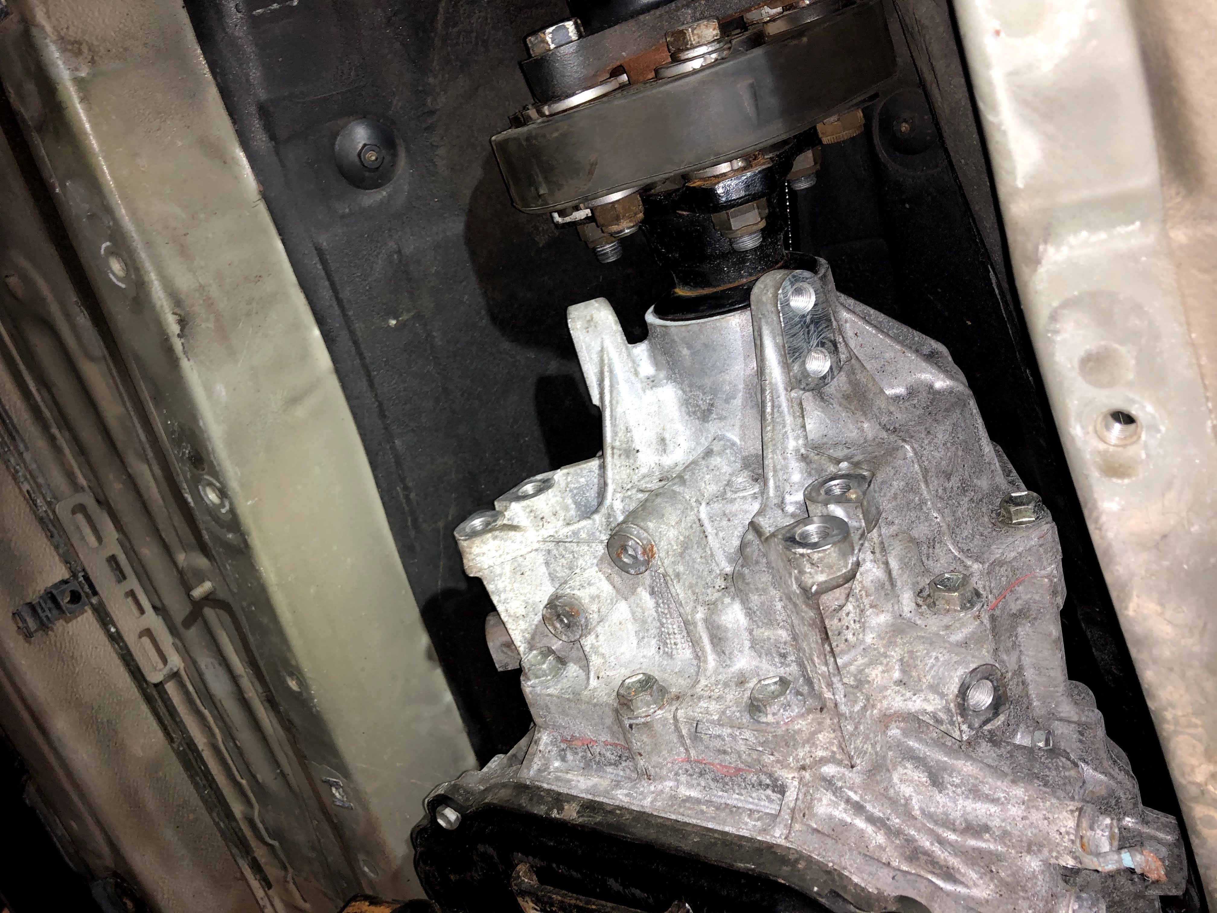

streber wrote: Thu Mar 18, 2021 11:18 pm How did you connect the transmission to the driveshaft?
I got lucky and managed to use the original rubber adaptor from the BMW gearbox, it bolted right up to the Lexus gearbox
