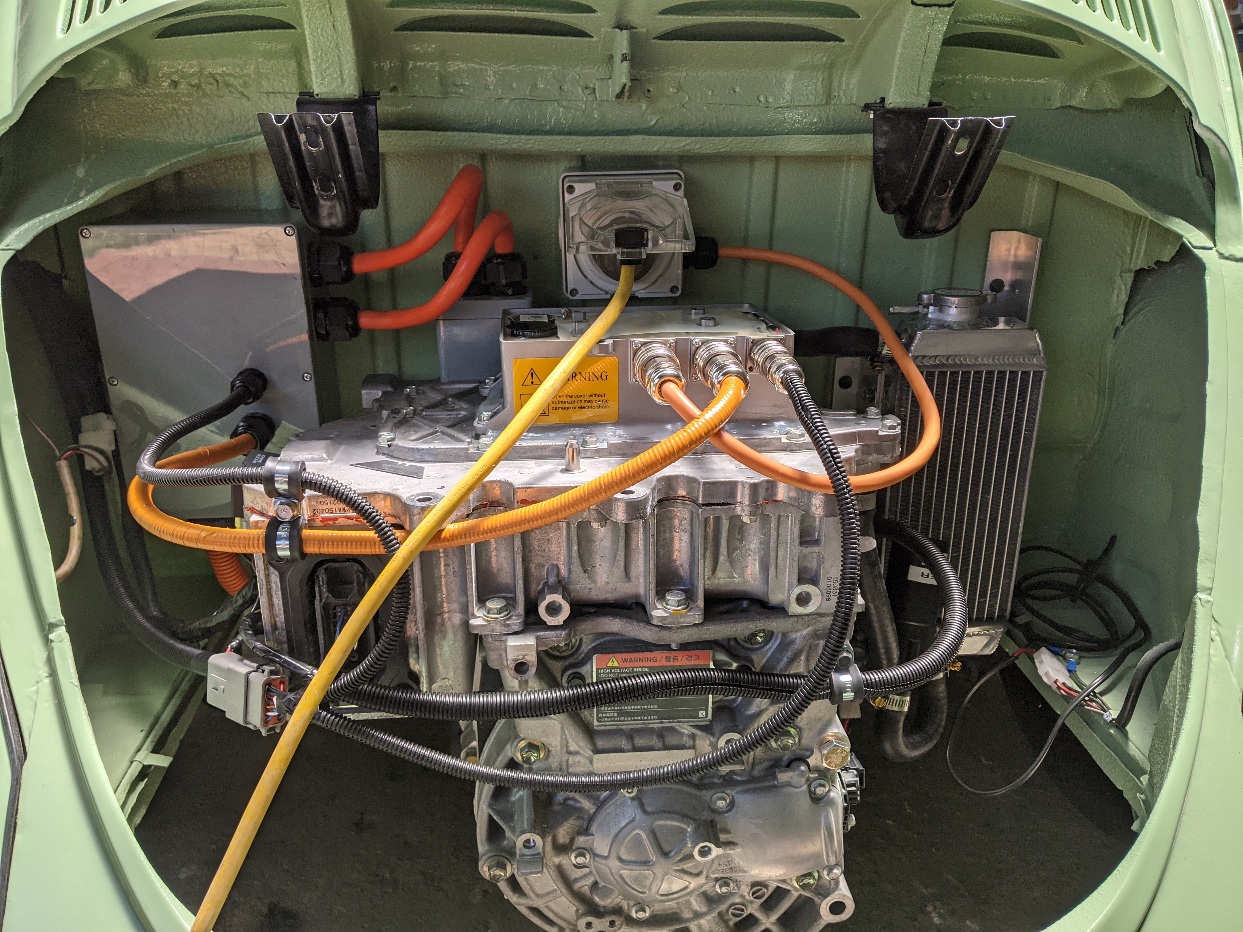

Spent a bit more time on the beetle this weekend, wired in the 240v charge inlet and interlock to prevent driveway, and plumbed in a small radiator to keep the whole lot cool. Just have to secure some of the wiring and i'm all finished in there.

Looks super tidy.
Just one note, it looks like the pump sucks cold water from the radiator, put it through the motor then the inverter. Normally you would reverse that as the motor produces more waste heat than the inverter. Also the motor can tolerate higher temps. Maybe not so relevant in cold climate but Australia, hmm

Thanks for the feedback Johannes, I'll have a look at changing that.
