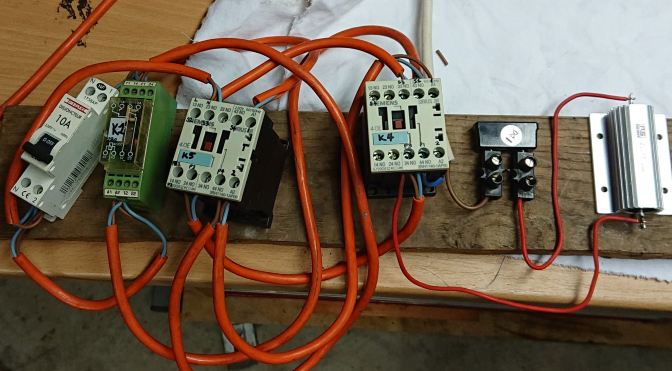

Contacters arrive to day, if all goes well thanks to COVID. I plan to remove jumper I put in place to HV Bus BEFORE trying out the charging process.

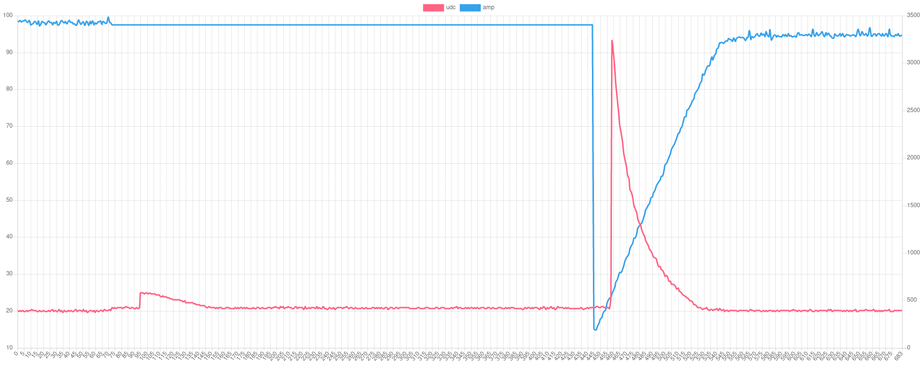

So, I got my wire harness back today and immediately went testing (video maybe later). The most exciting finding is that function of the CSDN pin - Pin 29 of the inverter. So when it is left floating (or grounded?) the converter is ON. When CPWM is HIGH, the LOW side IGBT is on, when CPWM is LOW the HIGH side IGBT is on. When CSDN is HIGH both IGBTs are OFF.
So:
So right now the charging sequence looks like described above, maybe future versions of the control board should have the ability to control CSDN as well.
It is now a matter of finding a good time to activate the converter so that it doesn't boost so much. 12V to 90V sounds not so bad but what about 200V to 1kV - lets not. Toyota engineers will probably just click at us but lets not force them to
So:
- I pulled high CSDN and CPWM, the latter via a 500R resistor
- I connected a 12V battery to the orange DC input and 20V to two phases of MG1.
- I started BOOST mode (always use boost mode with this converter)
- 1s later I disconnected CSDN

That's very interesting. Does that mean that the potential max voltage the inverter can practically charge is now more than 320vdc rectified from 240vac?

Thanks for tesing Johu.I will have to go over that set-up from modified wiki diagram in First post. Am almost done wiring up relays on the bench, and was going to go connect it up to inverter....whew!
I was going to modify the 12v supply line to DCSW Signal - K2/1 (DC Main Relay) connected to K5/P4. Basically allow to close Main DC Contacter with AC Contacter.
Now looking at the plot you posted, would some sort of Precharge help, until PI Controller kicks in? I have a few 65Ohm/100W resistors...

Will get to that next.
Resistors wouldn't help here, will think about it further soon

Looking at my sketch in the first post, I'll rework the schema as per your findings along with my relay logic set-up. I'm thinking:
1 - CSDN and CPWM (470R) pulled HIGH (12V) when switching on Adapter Board & Inverter
2 - Precharge and Main contactor sequences as usual - AC and DC BUS at the same time (IGBT's OFF = no link between AC and DC)
3 - Switch to BOOST MODE - PI conroller controls charging (parameter protocole to set up & verify BEFORE) I understand Current IN is controlled.
4 - CSDN pulled LOW (disconnect) via 1 sec time delay relay - Problem of ramping up HV to potential 1KV to be solved first
5 - End of Charge Cycle (or charge plug disconnect), CSDN to be pulled HIGH first. (I'm thinking micro contactor on the plug that is actioned before removal)
I'll update the diagram in first post to make sense.....Thanks again for the Update. "Happy 12v time delay relays hunting

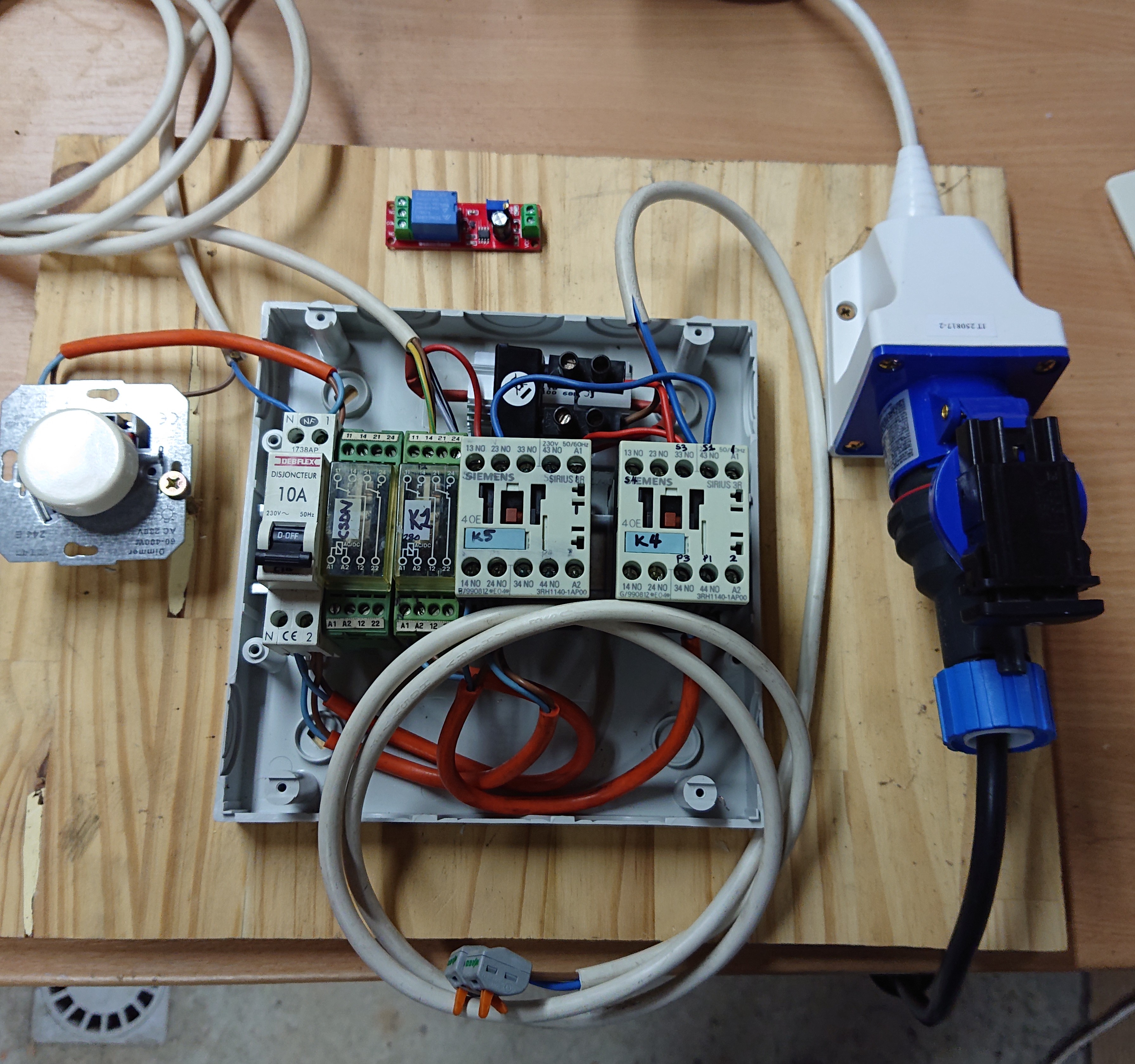

Revised ChaDemo Prius Gen2 logic under way. I think I worked out a way to switch CSDN to HIGH before shut down of inverter.
Got me some delay relays, and will wire that up over next few days.
Light resistance will be home made ramp up voltage system once Boost mode is ON. (to solve over voltage spike)
Will write up diagram if it all works out....
Basically, AC will go through precharge and main relay sequence with DC BUS whilst CSDN is HIGH.
5 seconds later, CSDN pulled LOW ('disconnect).
AC ramped up to 230v with Variable Light Switch.
CSDN pulled high via microswitch before shut down....

That would be great, we're making progress. I'll try to implement what we have so far and manually ramp up voltage once in Boost mode.
The microswitch on the connector plug is the only way I see forward at the moment for pulling CSDN High before shut-down. Hope to try it out in next few days.
