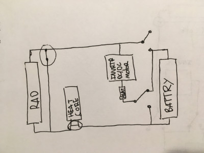

- Bratitude
- Posts: 1156
- Location: Canada
- Has thanked: 246 times
- Been thanked: 469 times
Re: Leaf engine/inverter coolant temperatures
With A couple valves you can very easily switch from a series coolent loop to a parallel loop.
I’m trying to maximize as much energy efficiency as possible. so any “waste” heat, I’d like to use if I need it. Ether heating the batteries, or the cabin.
A very crude but simple drawing of the basic loop.
