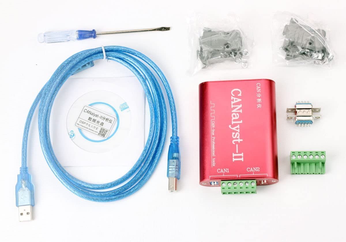

A PC laptop with dock station like Thinkpad X210
A USB CAN tool like Canalyst II, driver and software in english
https://www.hklrf.com/CANalyst-II-USB-t ... _5071.html

I just pulled the trigger on this CANalyst-II USB to CAN Analyzer CAN-Bus Converter Adapter Support ZLGCANpro on AMAZON for $84 bucks, so I will observe and reportarber333 wrote: ↑Mon Nov 09, 2020 9:04 amA USB CAN tool like Canalyst II, driver and software in english
based on these Reviews how could I say No?

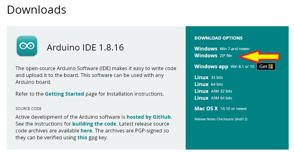

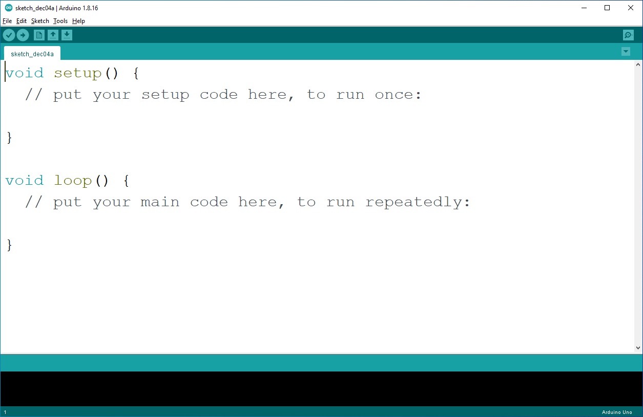

and my vote goes for Arduino IDE download it, learn it, love it!
Arduino is two things:
1. cheap small hardware (which costs money)
----1a small circuit boards with microcontrollers on them
----1b small "adapter" boards which sit on top of 1a above and extend their capabilities, these are called "shields"
2. software called IDE which you can download for free
IDE stands for Integrated Development Environment it is a free software download that I say is like a Notepad on steroids, it allows you to write C or C++ code without you realizing you are actually doing it, then it compiles it for you from human readable words to machine code (Assembler maybe) and then you upload it to their hardware, one of many many different small circuit boards that fit in the palm of your hand
Code written in Arduino is called a "Sketch" because they are Italian and don't know any better, ha ha
But why? Why do I need this stuff? I don't know how to program, I just want to convert an old car to electric?
if you want to go on the cheap spending tens of dollars on tools and utilities instead of hundreds of dollars, you may be required to "roll your own" solutions if you know what I mean, this may require buying Chinese knock of gizmos, doo dads, this and thats and then downloading other peoples code to make the stuff work, often times that code is written in Arduinoese but will require some tweaking some changes here and there, so the sooner you face the missing Libraries wrath of Arduino the better, ha ha

Dont forget, software is a separate link inside my other post. First install the driver, then the software. Then run english version of program.Gregski wrote: ↑Fri Mar 04, 2022 5:06 amI just pulled the trigger on this CANalyst-II USB to CAN Analyzer CAN-Bus Converter Adapter Support ZLGCANpro on AMAZON for $84 bucks, so I will observe and reportarber333 wrote: ↑Mon Nov 09, 2020 9:04 amA USB CAN tool like Canalyst II, driver and software in english
