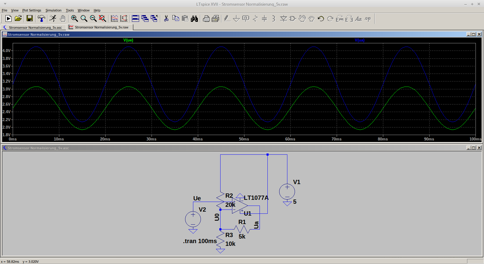

Now, I have a "white" BMS here that is lacking its current sensor. Since the supply to the sensor is 5V I assumed 2.5V to be 0A. But it's not. I connected a Tamura L01Z400S05 (400A range) and the LBC reported -102A. So I connected my calibration source and found the LBC to read 0A at 3.166V. At 2.5V it reports -100A and at 3.83V it reports +100A. So 6.6 mV/A.
So to use the Tamura 400A sensor one would need to convert the offset to 3.166V and the gain from 3.75 mV/A to 6.66 mV/A (gain 1.776)
EDIT: here's what you would need:
