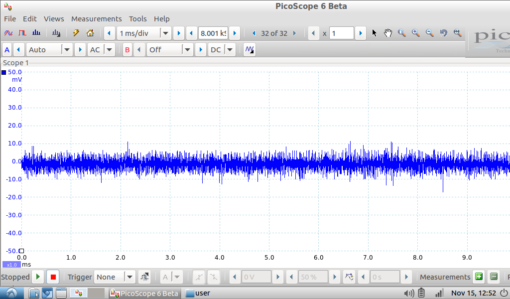

Re: Large jitter on angle in resolver and sincos mode
I think I have found the source of the spikes!!!
It wasn't the LED but it led me to it.
Look at this, blue is resolver exciter signal and red is the disturbing pin. And now, blue is resolver feedback sine input (R31) and red is the disturbing pin. And finally the timing between disturbance spikes. This is measured at R85 which is the output of STM32 pin 56 or PB4. This pin is pulled up to 3,3V with a 10k resistor (R85).
Question now is what the SW is doing to create the disturbance and how can it be stoped.
The LED runs at 100ms. This signal I found runs at 102ms and is out of sync with the LED.
This is how I first found it. Blue is LED at STM side and red is resolver exciter output pin. Observe the variation in amplitude at 3ms after negative flank on LED. A couple frames later. Observe the variation of amplitude on both signals before negative flank on LED. It might be some other pin causing this but that is defintly the spike. It has the same shape and length as the spikes seen in angle.
Ok, now I have found it!
Yes, Johannes, you are right. It is comming from the 3,3V rail and yes, it is the WiFi-module that is the root cause!! Well spoted!!
I'm sorry, I tried to measure the 3,3V before but with the wrong settings on the oscilloscope I didn't find anything. With the right settings it's easy to spot.
I'm able to dampen the effect with a hefty input RC-filter for the WiFi module using 2,7ohm/1000uF. I can still see spikes in angle, but with a lot less amplitude. Spikes now below +-1 degree.
However this might be a problem on all boards using the Olimex module?
I own 3pc of this module and I tested all three. Two of them are programmed with the interface and the last one is "empty" as delivered from Olimex. All three causes the ripple on the 3,3V power line.
Or do I have a bad 3,3V regulator?
I'm thinking otherwise it might be a good idea to have a separate 3,3V regulator for the WiFi-module.
Yes, that is also why I suspect that the 3,3V regulator on my board might not be 100%. I'll test swithcing it out when possible.Jack Bauer wrote: ↑Sat Oct 17, 2020 8:44 am I'll certainly add that filtering to the next run of boards. That said I'm running motors here with that board design AND the V1d has 2 wifi modules.
Damien, if you make a new run of boards, there is some room for improvement regarding routing in the PCB in the bottom right corner. If you wan't, I can send a more detailed description?
It's the same behavior with a module not loaded with SW so something in bootloader or similar.
Did a current measurement or more specific, measured the voltage drop over a 5,1ohm series resistor.
Programmed module Unprogrammed module Current increases 100% during spike, from ~80mA to ~160mA! Longer duration on programmed module.
The current might be a bit on the high side for the 3,3V regulator as it also supplied the STM32. 200mA max and 150mA continious for a sot23 (250mW/(5V-3,3V))=150mA.
I will test with a new regulator and also add a LC-filter. The RC-filter is what I had at home for the moment. It will be ok for now.
Started by measuring 3,3V current draw (voltage drope over a 1ohm resistor) of the board excluding the WiFi-module.
Just below 120mA. So with the load of the WiFi-module the 3,3V regulator has to work hard.
So I patched in an separate 3,3V regulator to power the WiFi-module, and now the spikes are gone from the angle plot. I also discovered another source of disturbance, the CAN tranceiver. When running the board alone the tranceiver sends out messages every 550us as it never receives reply. So when probeing C43, or VDDA, the result is 30mV pk-pk ripple. In normal case this will only be seen every 100ms (or 10ms) when messages are sent out. This will also have a negative effect on all ADC measurements so I plan to swap out the present 3,3V CAN-tranceiver for a MCP2562-E/SN. This MCP tranceiver can be powered from 5V for all power requiring stuff and then has a separate I/O-supply that allows 3,3V to be used for the low current I/O (Rx, Tx pin). Will report back when this is tested but will take some time as I have to wait for component delivery.

Finally I have replaced the CAN-tranciver to a MCP2562-E/SN with 5V supply and I/O running at 3,3V
VDDA with old CAN tranciver. VDDA with MCP2562. Now I can't find any periodic disturbances on VDDA so I call this done.

Wow, thats actually rather surprising! So you go from 30mV or 1% jitter (assuming 3V resolver amplitude) to maybe 10mV or 0.3%. I mean either will work but it still looks better
- bexander
- Posts: 897
- Has thanked: 78 times
- Been thanked: 102 times
In normal case the VDDA would make a dip and rise every 100ms when a CAN message is sent. When I run the board on the bench there is no reply on CAN and the transceiver repatedly sends messages causing the continious triangle wave.
This voltage dip on VDDA causes spikes in ADC measurements.
Now the dips caused by WiFi-moule and CAN transceiver are removed. I have not checked in car yet as I'm doing a bettery change as well as motor/inverter change so it takes some time before I can test resolver and current feedback for hopefully no spikes.
For future logic board designs it might be a good idea to consider using a 3,0V shunt voltage precision reference supplied from the 3,3V bus, to supply the VDDA. This will require HW adjustments on resolver signals (to keep the below 3,0V) and maybe current and voltage feedback as well but should give a solid supply to VDDA.
