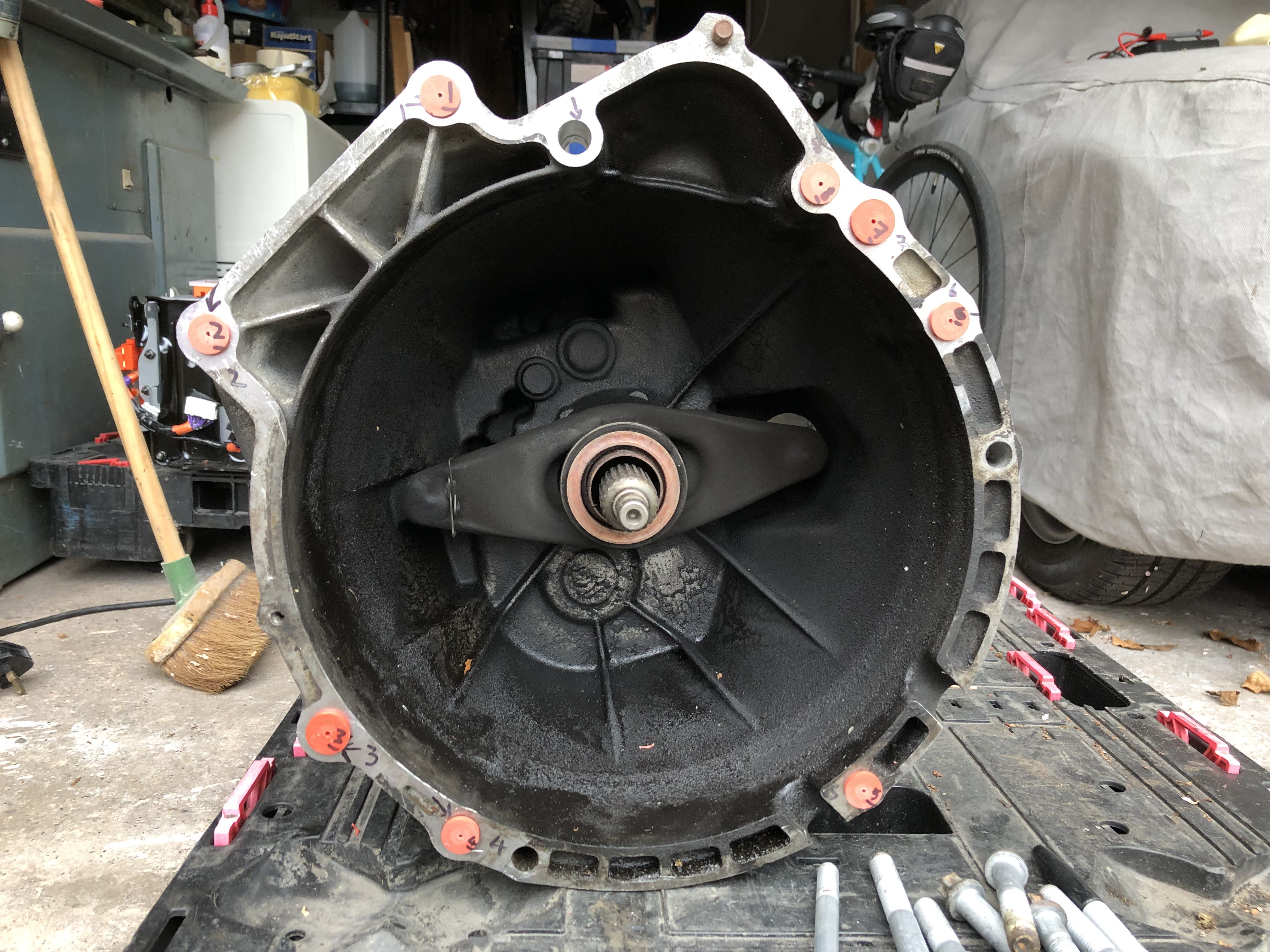

Not wanting to be outdone by Mr Bauer, I finally got the engine and gearbox out of my E46 coupe.
Here's the engine coming out and the hole that's left over:
I started thinking about how to measure the flange on the gearbox. I decided to make some plugs with a small hole in the centre to measure to. Here's the gearbox with its protective layer of oil. No wonder the clutch juddered!
Here's the same gearbox cleaned up:
Next up, get the motor mounted up and get the inverter sorted!

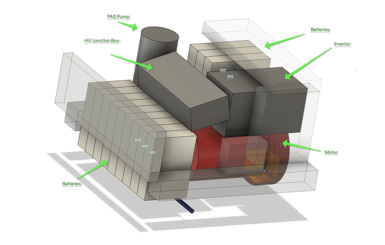

I think the next thing is to build up the HV Junction Box and where to fit it. Had to resort to a bit of CAD:
The slightly opaque parts represent the engine bay components.
Time to order some bits and hope the rain holds off for long enough to get the welder out!
