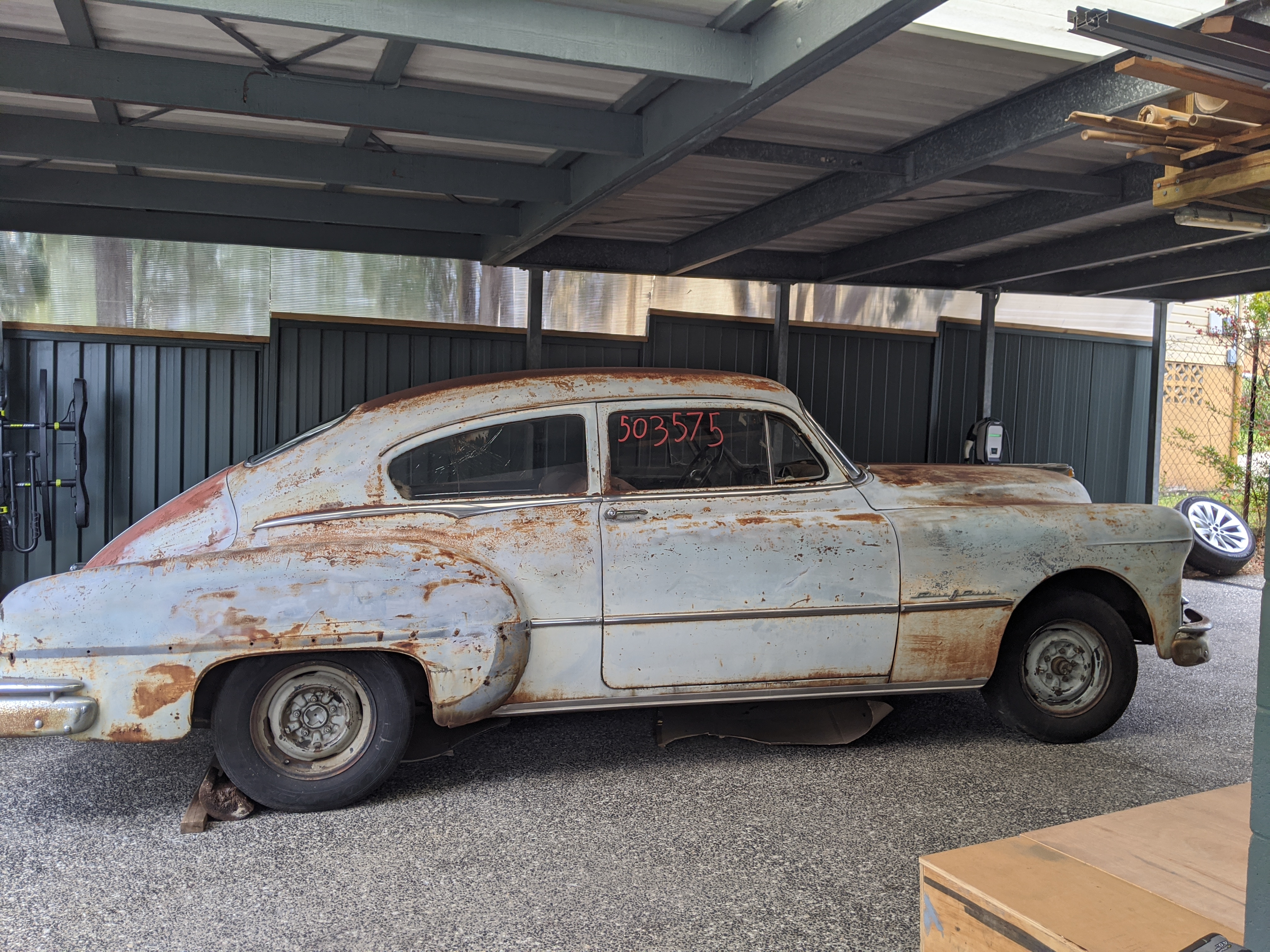

and waiting the wings for a conversion sometime down the track is my long term restoration project - '49 Pontiac fastback.
