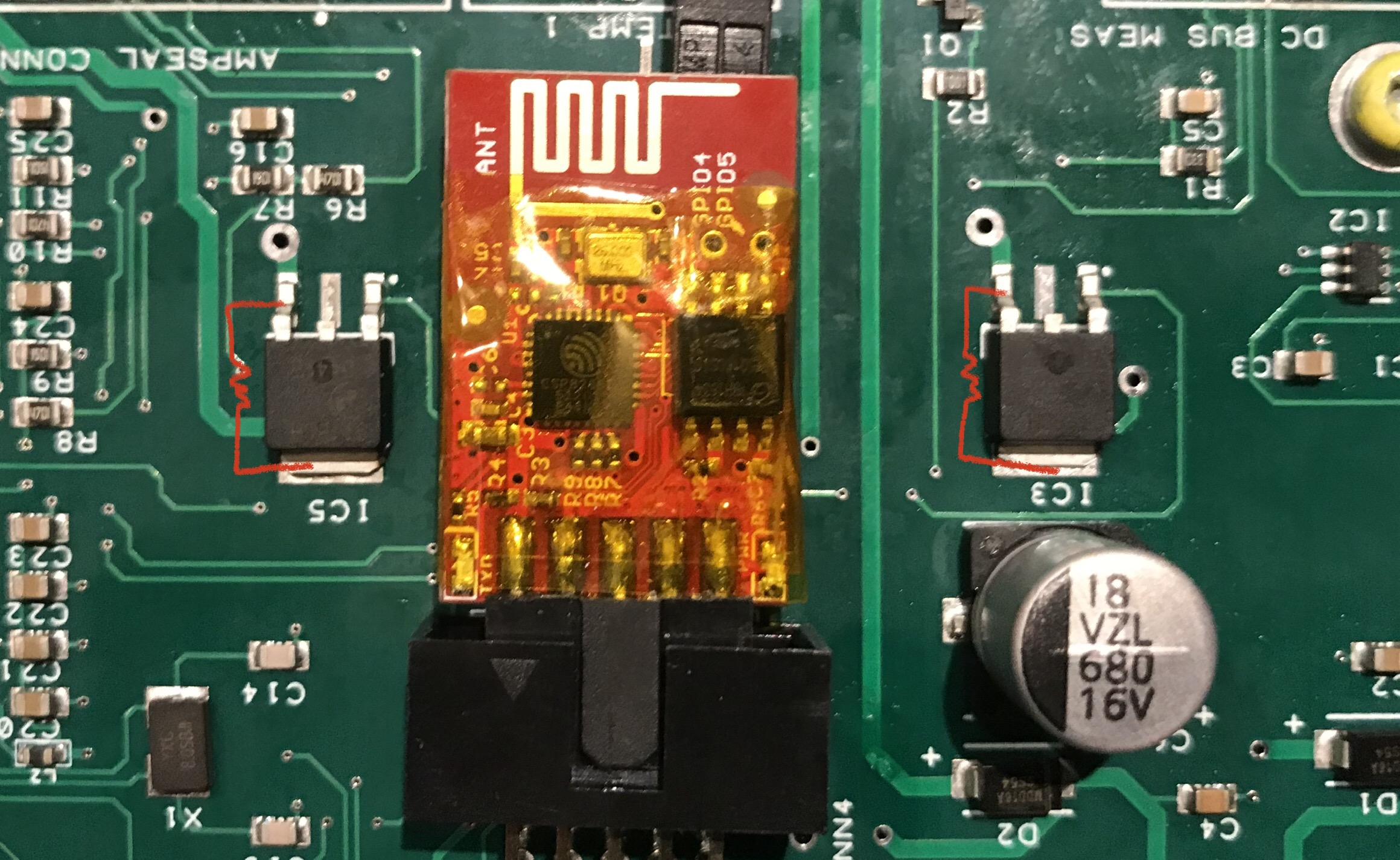

I'm having an interesting issue with the states of the contactors. When I power the system up it appears that all of the contactors are energized simultaneously for a moment, then upon start signal the positive is energized only briefly before opening again. I've made a video to illustrate this and added LEDs to the contactor's power lines to visually see when they're being energized.
- Green is on the negative contactor, which is energized always when the key is on.
- Yellow is Positive Contactor
- Red (on the wall mounted contactor box) is precharge
Has anyone seen this or have any ideas how to troubleshoot further? Thanks!

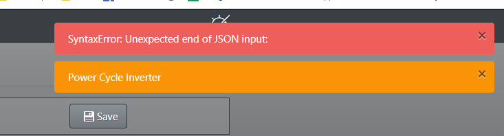

I haven't been able to get that far yet to configure parameters, I also see this error message. When I go to snapshot.php I see that it's an empty array { "" }.. I attempted to restore parameters from the forum but keep getting the same error. This is the first time setup for this system. Voltage of the HV battery is 368V

You need to be able to access the web interface before trying to run the motor. I would suggest trying another device.
Re: Contactor woes with LDU board

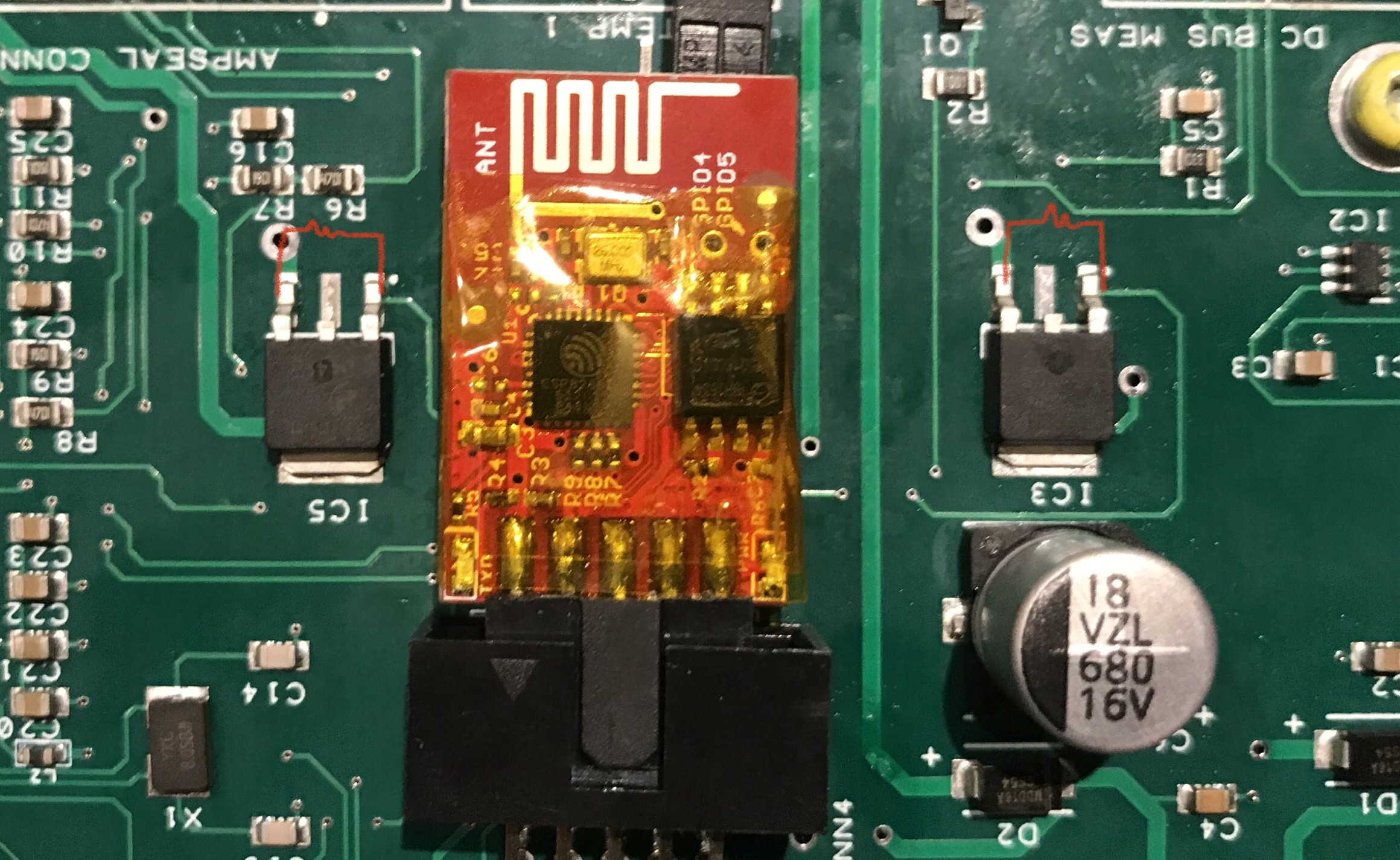

I can access the web interface. That’s where the screenshot of the “Power cycle inverter” and json error is coming from. I feel like I’m missing something fundamental. I coaxed the esp8266 module to work by building from source and uploading with Arduino, then uploaded spiffs. I was then able to log in, is there additional configuration I’m missing?

Not possible to just connect to the inverter over WiFi, open your browser and enter the IP 192.168.4.1 ?
You can then login.

Power up sequence looks ok on the control board. Gate drive board I have no experience. I'm assuming the red LEDs signal under voltage as you power down.
I assume the contactor click in the background are what you are talking about. Looks like they briefly engage while in boot loader. Can you try mounting a 1-10k resistor across the output FETs (gate to source, i.e. the two actual pins)? Maybe they creep on for some reason.
EDIT:
The positive dropping out must be caused by some other post-start error, like desat or overcurrent - possibly spurious. Let us know the error memory and if you keep having problems with the wifi interface consider using the less beautiful one: https://github.com/jsphuebner/esp8266-web-interface
EDIT:

No, between the two pins
Hey, that stopped the positive contactor from kicking in at boot
Now just need to get it to stay on after key switch

Great. Yes some STMs develop minor damage (static discharge damage) of the output circuitry causing stuff to creep on when the pin isn't explicitly driven low.
I edited my other post, in case you missed it:

I spent some time searching the forum for others with overcurrent errors and reading the Wiki to make sure I wasn't missing something obvious. Came across the troubleshooting page for LDU board and followed the steps to diagnose there.
When measuring the two test points adjacent to R45 and R58 (no HV, Idle, no start signal), I'm getting approx 1.64V and 1.63V
I set udcsw to 0, saved parameters (actually wouldn't take, I had to edit the previously downloaded JSON and upload to get it to set) and get Overcurrent when I attempt to start. The page indicates this is likely a failure of the inverter, so I tested this by installing the LDU board in another known good inverter and had the same result. Both of these inverters were working fine on the bench previously.
Are there any other measurements I can take on the board to ensure it's in proper working condition?

On the paper I included with the board you will find the pin mapping. Check that all 6 fault pins on the "IGBT DRIVERS" header are high and check for cold solder joins on the connector.
EDIT: you can also check directly at IC10: Pins 1-6 and pin 11 must be high, pin 8 must be low.
Regarding your the boot time contactor click there is now also a software fix: viewtopic.php?f=7&t=1119

At IC10 I have the following:
1,2: ~5V
3: 3.82V
4: .7V <--
5,6: ~5V
8: ~5V
11: ~5V <--
Looks like 4 and 11 are not as expected.
1,2: ~5V
3: 3.82V
4: .7V <--
5,6: ~5V
8: ~5V
11: ~5V <--
- Posts: 6711
- Has thanked: 368 times
- Been thanked: 1541 times
Ok, Pin 4 is "FAULTHC" so high side of the third IGBT module either signals a fault or has a bad connection. Consequently pin 8 is high because not all inputs to the NAND tree are high.
