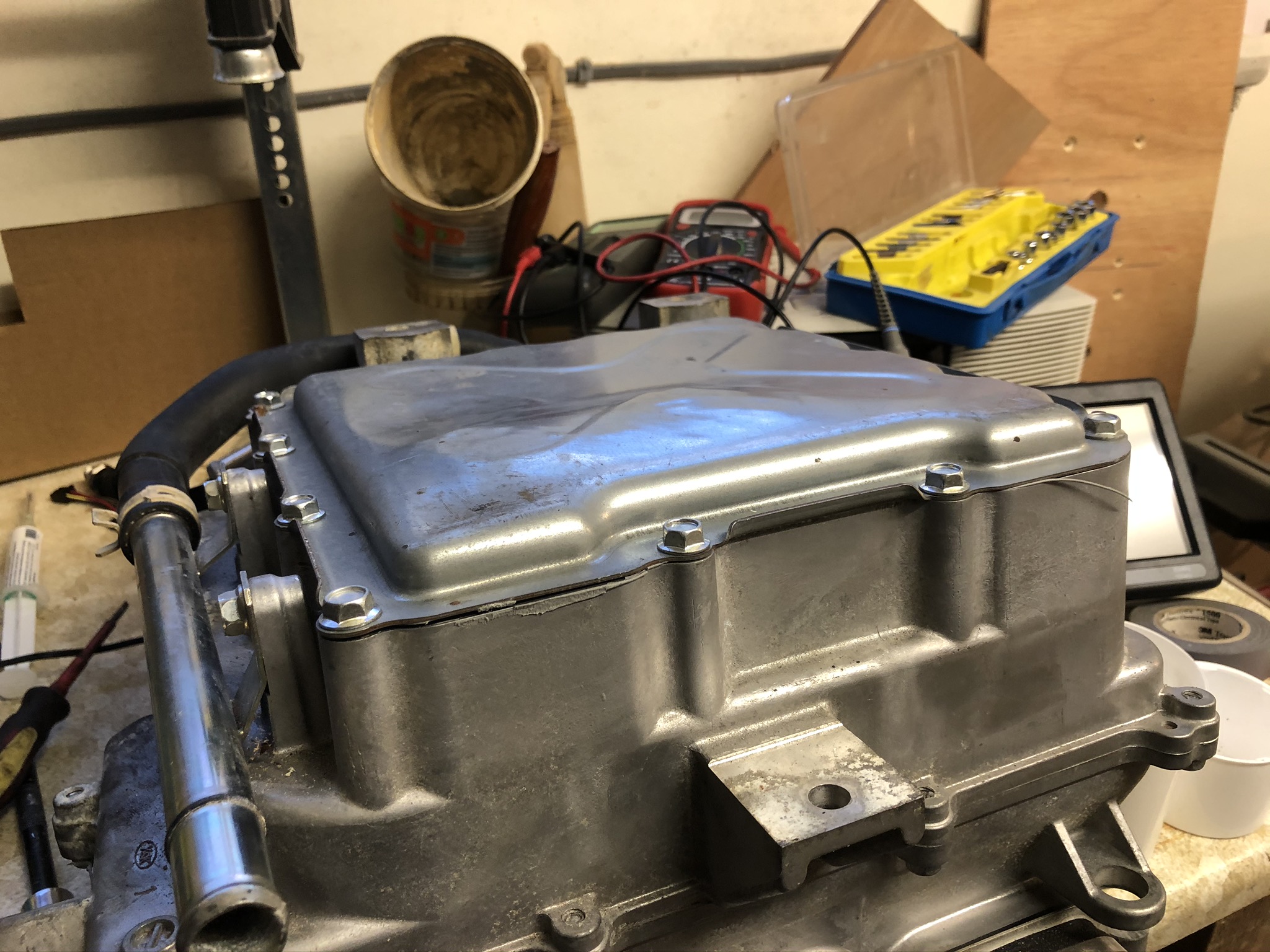

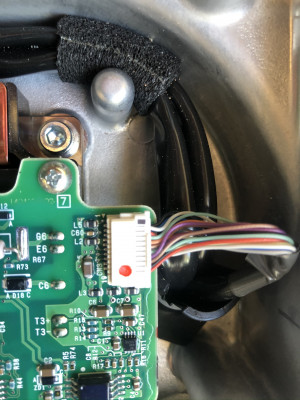

In case anyone else is looking to do the same as I am doing here is what I have found out stripping down the front inverter to replace the logic board:

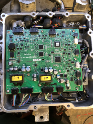

Here is the logic board, easy to see how the board is split into distinct sections for the motor and generator.

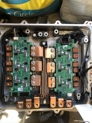

Here are the IGBT driver boards, as far as I can tell these boards are identical to each other and also to the board in the rear inverter. It is worth noting that they are reliant on power from the SMPS transformers mounted to the logic board to power the IGBT side of the A34JT opto couplers. Each board has three heatsink thermistors and a C87AT opto voltage sense.

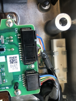

This pair of conectors provides the 22v floating power from the transformers for firing the IGBT gates, 12 wires: a pair for each IGBT.

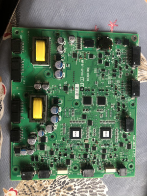

This is the 20 pin connector for the optically isolated side containing the PWMs, temp sense, voltage sense, UVLO, FAULT (desat), 5v+, 15v+ and ground.

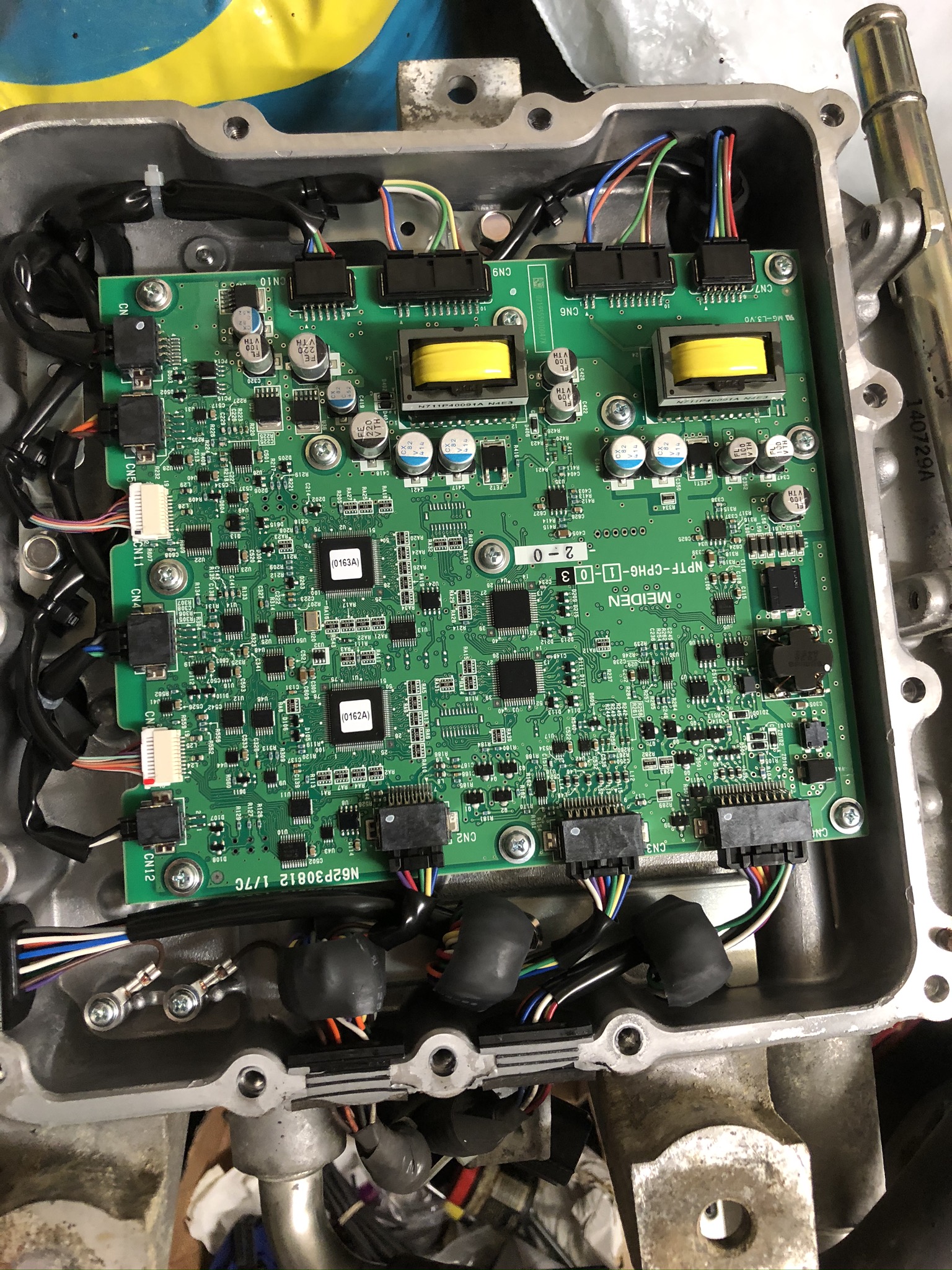

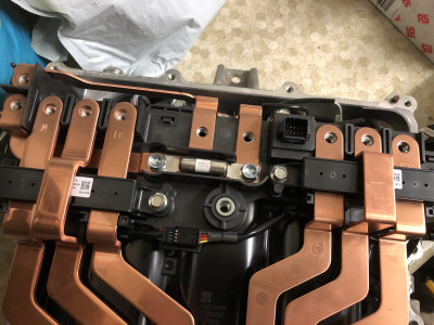

Here you can just about see the Nipon/Nicera current sensors, 2 phases monitored per motor. From what I can tell so far they are four wire: 5v+, 0v, sensor 1, sensor 2 with 2.5v on the output lines denoting 0 amps.
I have done a spreadsheet with all the pinouts for the logic boards and driver boards and how they might map to a V3 main board but I will post that in the morning...

Really nice! I have rear inverter with me and i can crosscheck your findings with my setup.
It seems this power section will go nicely with either Huebner or Lebowski brain.

Can you get the P/N for IGBT module? That can show us what front drive is capable of. I will see the same for the rear drive...

Very similar to Volt inverter power stage. I bet the real limit to Outlander is not motor but batteries.

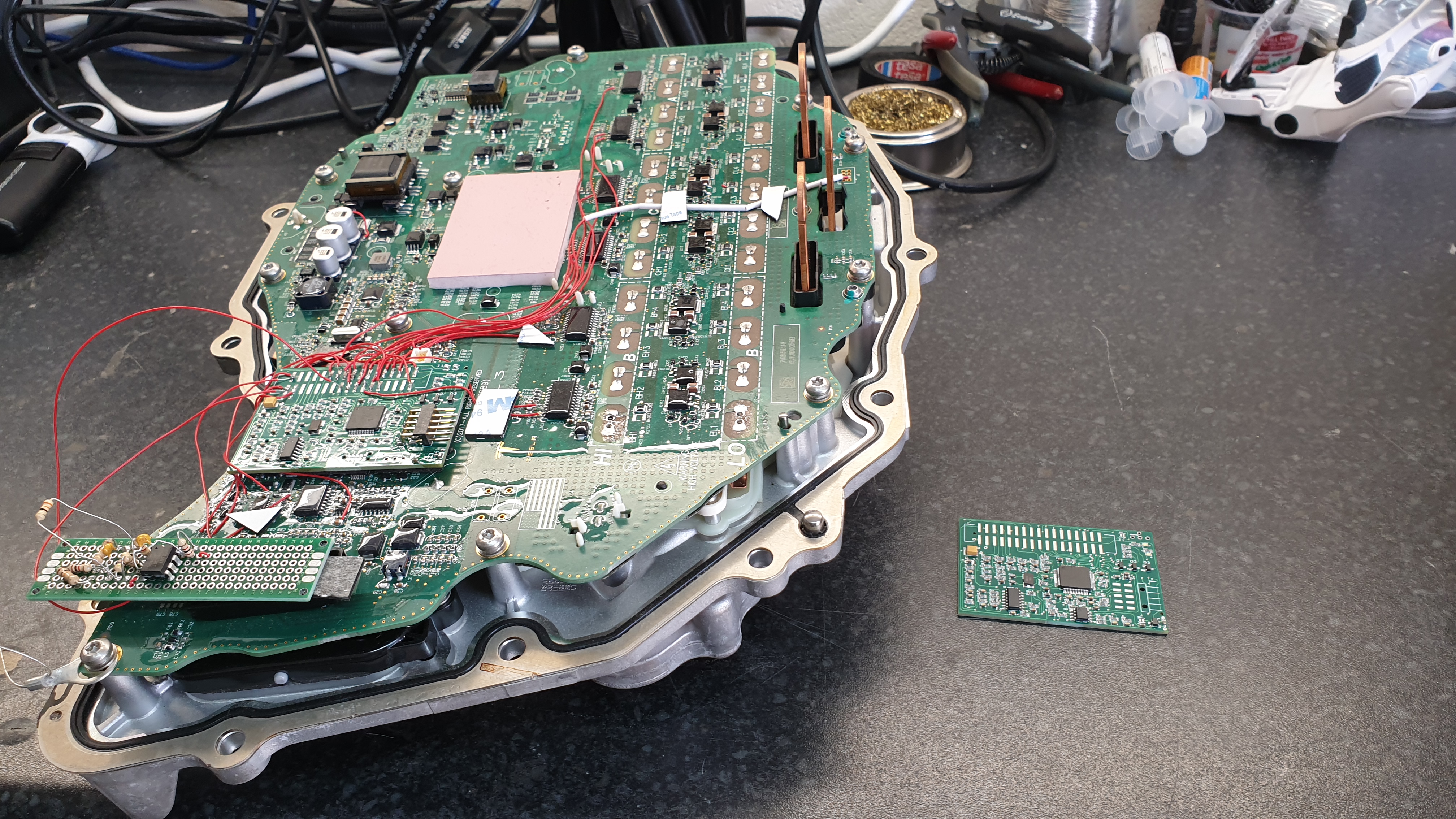

I am hopeful the stock inverter and stock board will purely run on canbus commands well above the stock torque and power ratings on the outander.
The i-miev evolution 2&3 used stock imiev inverter and a seperate board sending canbus commands and they both ran 300nm torque and between
100-112.5kw power on each motor.
Fairly sure the phev outlander rally car used some custom controls too.
Once i have my battery finished i can begin testing, but im fairly sure the inverter is dumb and just works off given canbus commands like the earlier i-miev model.
I do have a v3.0 board if this is not the case, i will use it piggybacked off the stock board , so the igbt get the correct voltages and v3.0 board just gets current sense/voltage sense, resolver, motor temp and igbt control.
Everything else will be done through canbus.

Really excellent, I would be very interested to know where it would max out on the stock board. It seems several people have the stock system working with a CAN VCU but have problems with throttle mapping. The only draw back with the front inverter is that you can’t spin the generator motor backwards via CAN command (or so I’ve been told) to protect the engine from reverse rotation.
I am in the process of mounting the 2x v3 boards as you say piggybacked. Looks like I will have to create a spacer for the bottom cover plate to create extra room for the v3 boards to sit with enough clearance inside the case.

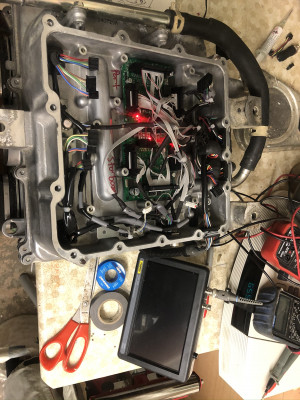

So, a bit of an update and some more information.
The V3 boards are in and working as much as they can be without being connected to a motor. The next few days will hopefully see them spinning a propellor. Damien sent me two of the model 3 modboards which I thought would be perfect but in the end getting the resolver exciter to work with the resolver to digital chip was proving tricky and leading towards needing another external signal converter board so I ended up modifying the inverter case to allow the Hubner boards to fit.
Original logic board fitted back on top on spacers. Only mild clearancing of the cover plate to clear the transformers....

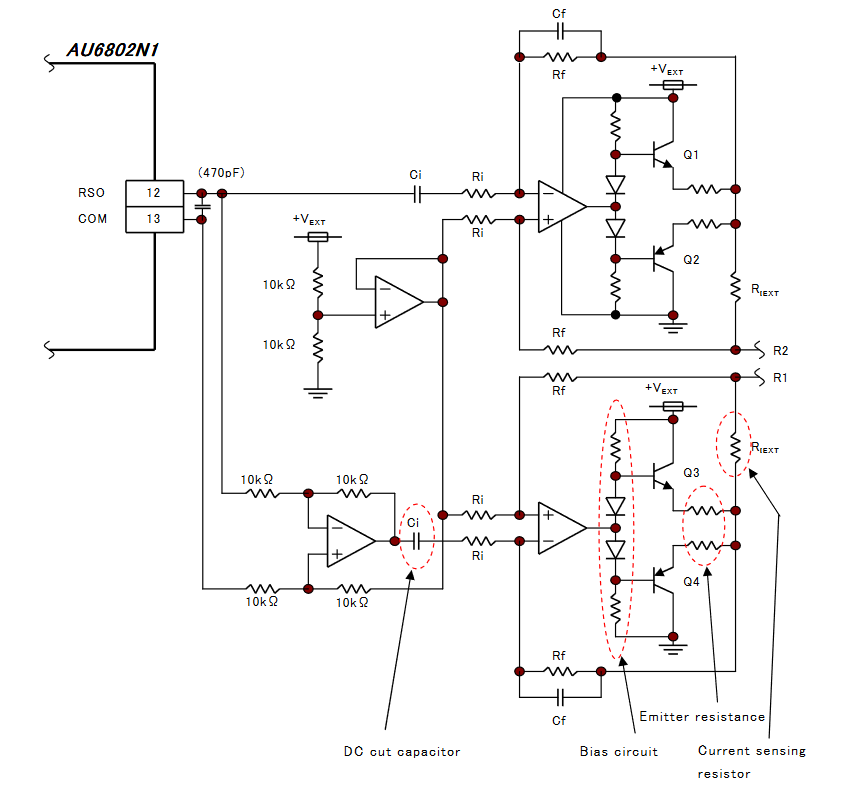

Now, things I have found out about the Meiden logic board:
It uses a resolver to digital converter, Tamagawa AU6802N1, this drives a resolver excitor ciruict using 4 transistors driven by a set of op-amps. The sine-cosine is then fed back into the chip, converted into a digital position and sent to the main MCU via seriel. The main MCU is a Renesas R5F7147FPV.
In a previous post I mentioned that there is a connector on the board, CN1, which I couldnt find a function for. I have now found that it it a RS232 programming conector for both of the Renesas chips.
1. Boot mode, feed 5v to pull MD1 (pin 76) to ground - Drive motor MCU
2. RS232 Tx - Drive motor MCU TXD1 (pin 65)
3. GND
4. RS232 Rx - Generator motor MCU RXD1 (pin 66)
5. Boot mode, feed 5v to pull MD1 (pin 76) to ground - Generator motor MCU
6. GND
7. RS232 Rx - Drive motor MCU RXD1 (pin 66)
8. RS232 Tx - Generator motor MCU TXD1 (pin 65)
The loom from this plug on the logic board leads up to a connector accesible from the cover plate over the phase cables so gives access to full programing of the original logic board without disasembling the whole inverter. There is a flash programing tool on Renesas' website that seems like it could be used for this. When I have more time I will have a play with this.
