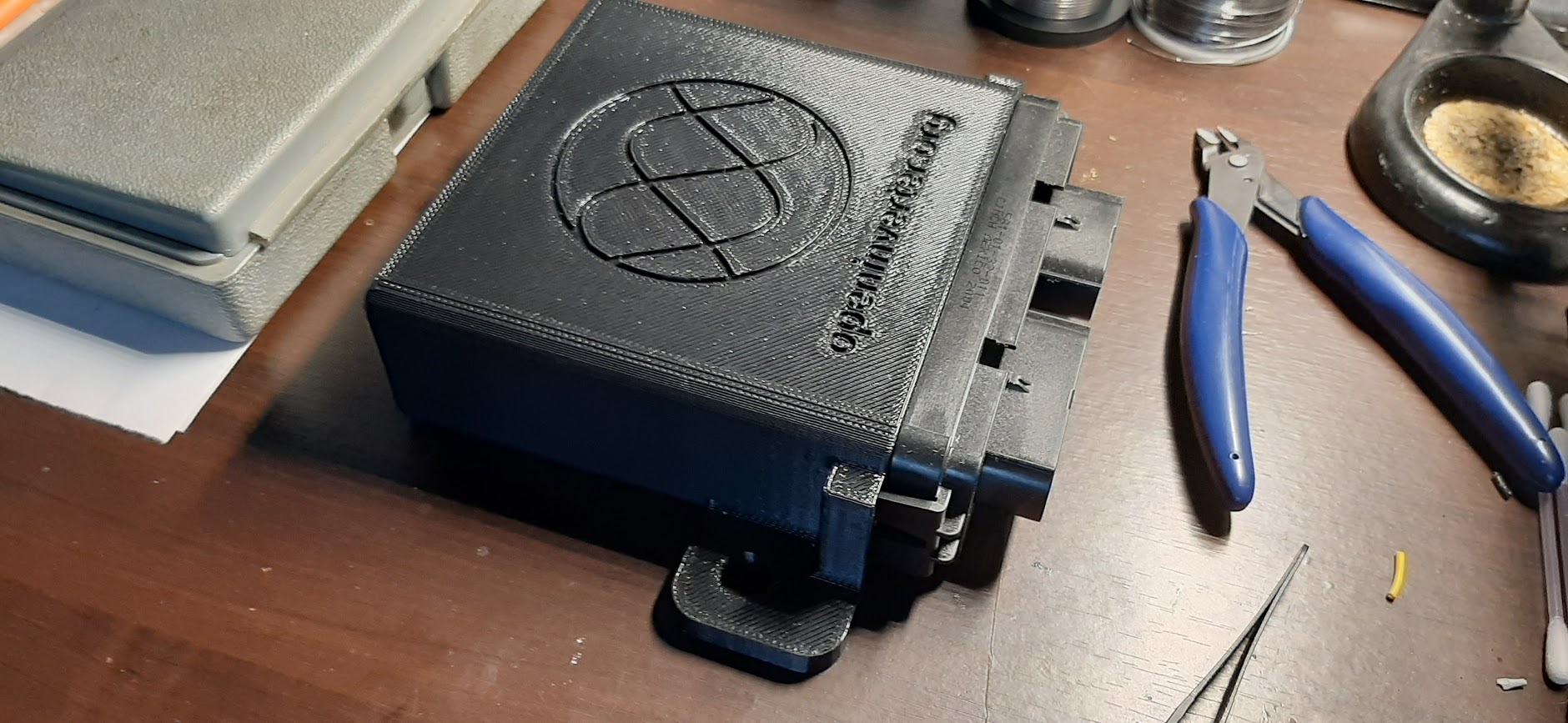

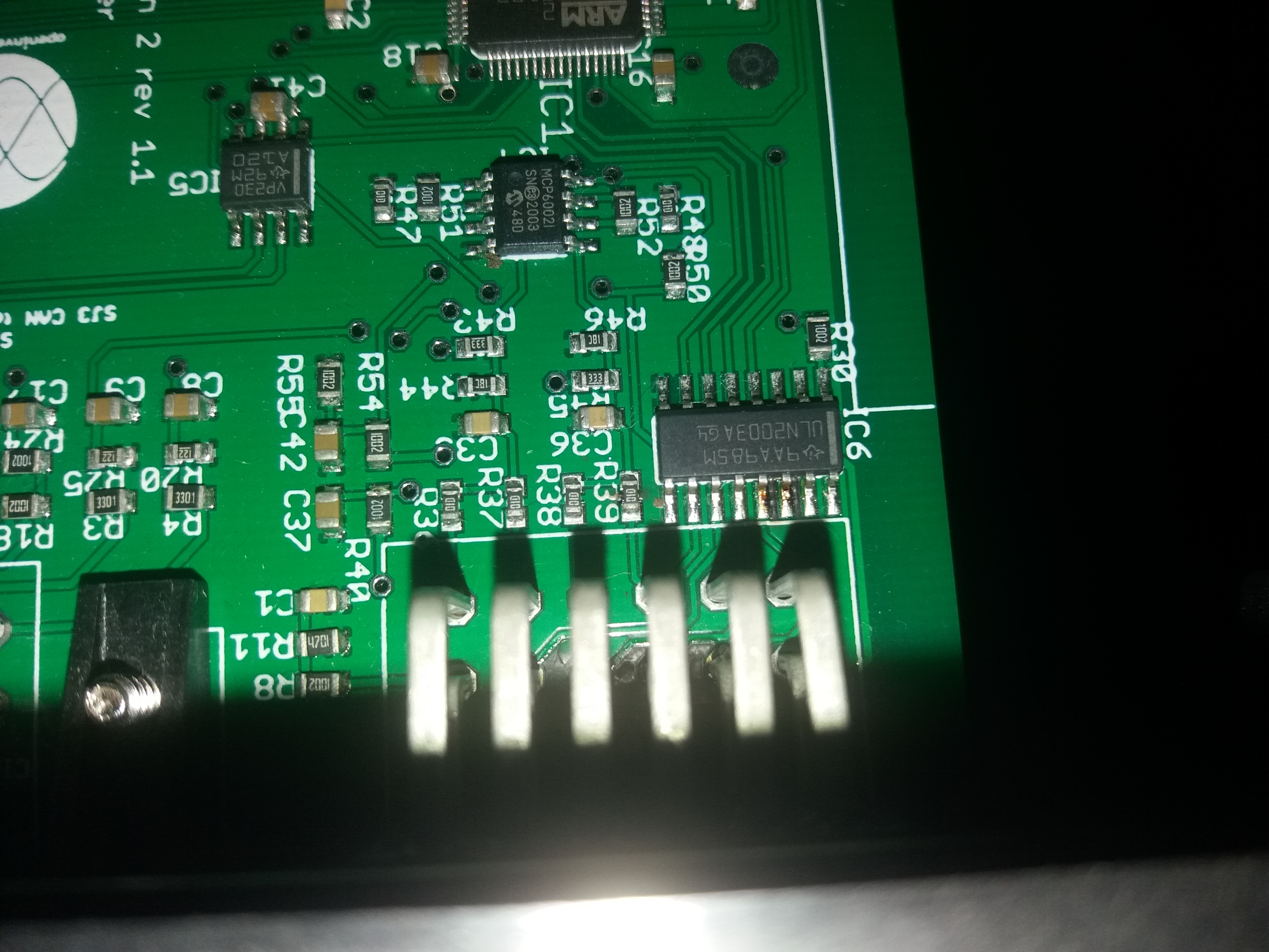

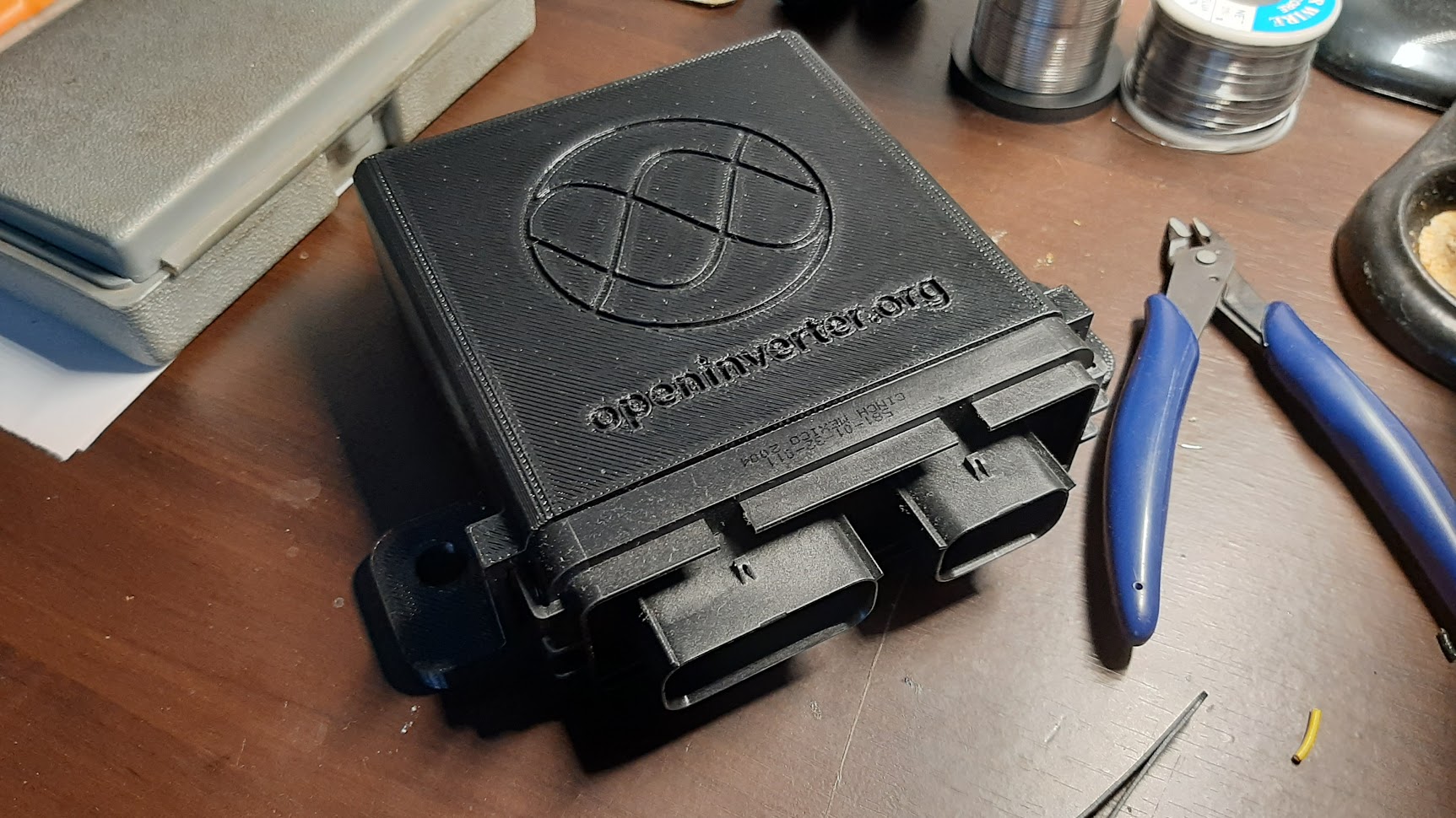

- konstantin8818
- Posts: 290
- Location: Minsk, Belarus
- Has thanked: 2 times
- Been thanked: 10 times
Damien's box of goodies, which he sent me, contained Johu's gen2 board, but there was no modice case included...
So I desided to make my own... and it fits perfectly even with WiFi module: My goal was to make it from clear transparent plastic, but for some reason maker convinced me that it won't be transparent because of wall thickness, so I made it from ABS.
For those who want to make it as well:

I took delivery of a replacement inverter on Friday and have been setting it up over the weekend.
It works, but I'm having some trouble getting my Siemens 1pv5135 to spin in manual mode.
Any help very much appreciated.
My setup:
- Siemens 1pv5135 AC induction motor
- Gen2 prius inverter + vcu
- 48v HV battery
- 60 watt filament bulb as demonstrated in FOC tuning vid
- 12v battery
What I've observed when 12v connected:
- Inverter powers on successfully and a low volume high frequency whine can be heard from it.
- All VCU LEDs behave as expected
What I've observed when HV connected through 60 watt bulb:
- NO precharge flash (since the bulb only lights dimly when connected to HV independently of the inverter, and there is no precharge error in "run" or manual mode, is this lack of precharge bulb flash due to the relatively low HV source?).
- In manual mode when changing the values of fslipspnt and ampnom the frequency of the noise the inverter makes changes.
- When ampnom value is >~60 the bulb glows dimly
- When fslipspnt value is >~100 the bulb glows dimly
- Spot values for udc, idc, il1, il2, imax, uac, il1rms, il2rms all change when I adjust the values for ampnom and fslipspnt.

- I have a damaged ULN2003 driver that needs to be replaced. In the same mess up where I damaged my original Gen 2 inverter the driver took some heat (see picture attached). Unfortunately I don't have a scope to validate this as Woody was able to.
Any help greatly appreciated.

| Siemens 1PV5135 Motor | Gen 2 Toyota Prius Inverter + OI Control Board | 24 kwh Renault Zoe battery |

Given current is being drawn from HV source (bulb glows in other lightbulb test), and no activity seems to be coming from the MG2 output, I think my next move should be as follows:
- Read more about what might be causing PWM signals not to be generated/reach MG2 terminal
- Replace the ULN2003AD driver IC that is visibly damaged
Doesn't this sound reasonable to anybody with more experience, and is there anything I might be overlooking?
Thanks,
Hugh

Thanks Zookeeper.ZooKeeper wrote: ↑Mon Oct 05, 2020 9:57 pm Hugh,
I am absolutely NOT an authority here.... but, it seems like the voltage is less than suggested in the FOC tuning video and that may be causing some issue. I had similar experience, except that I did not hear any PWM "whine" and to this day the only thing I can figure is that the original pinout map had the PWM outputs shifted by one terminal: MUU, MVU, MVW are 28, 29 & 30 of the VCU respectively and CPWM is 31 (not pin 28).
Once that was resolved, it was off to the races.
EDIT: I have a few of those ICs in the drawer if you need it![]()
Since I'm using an ACIM, I don't need to use the FOC tuning and from what I understand 48v should be enough to turn over the Siemens.
By doing the lightbulb test (unsuccessfully), I think I've verified the problem is "upstream" of the motor, so to speak.
Thanks for the offer of the IC
Before I resolder that though, I'll tear down the circuit again this weekend and rebuild from first principles to be sure everything is correct.
At the same time I'll try to understand why I'm hearing the whine but not getting any movement from the motor or flashing from the bulbs.
Perhaps not all phases are working, but one is. I need better understanding anyway!
EDIT: If you could specify which version of the IC you used that would be very helpful! Seem to be a few options here: https://ie.rs-online.com/web/cp/0858196 ... 03AD&sra=p

Thanks Bexander! Yes, I've tied forward to 12v positive and it's appearing as so in spot values.bexander wrote: ↑Tue Oct 06, 2020 6:03 pmHave you selected a direction? (Forward or reverse).hugow93 wrote: ↑Mon Oct 05, 2020 8:42 pm Thanks for the suggestions Retro and Isaac.
Here's how it went down today:
- get opmode: 2.00 - Manual mode is being correctly selected
- Reducing fweak to 10 and increasing ampnom - No movement from motor, inverter still make sound as expected
- Increasing boost to maximum value - No movement from motor
- Lightbulb delta - No flashing from bulbs (increased boost and one flashed momentarily but could not replicate afterwards. Mildly concerned I may have screwed something up by doing that)
Thanks,
Hugh

I bought every type DigiKey had in stock :Ohugow93 wrote: ↑Tue Oct 06, 2020 9:31 pm EDIT: If you could specify which version of the IC you used that would be very helpful! Seem to be a few options here: https://ie.rs-online.com/web/cp/0858196 ... 03AD&sra=p
The only one I know is "wrong" is the ULN2003AIPWR, wrong form factor
Edit: If you hear PWM, the VCU is signaling the inverter from my experience. When I was not getting any inverter output, I also could not hear any PWM.
