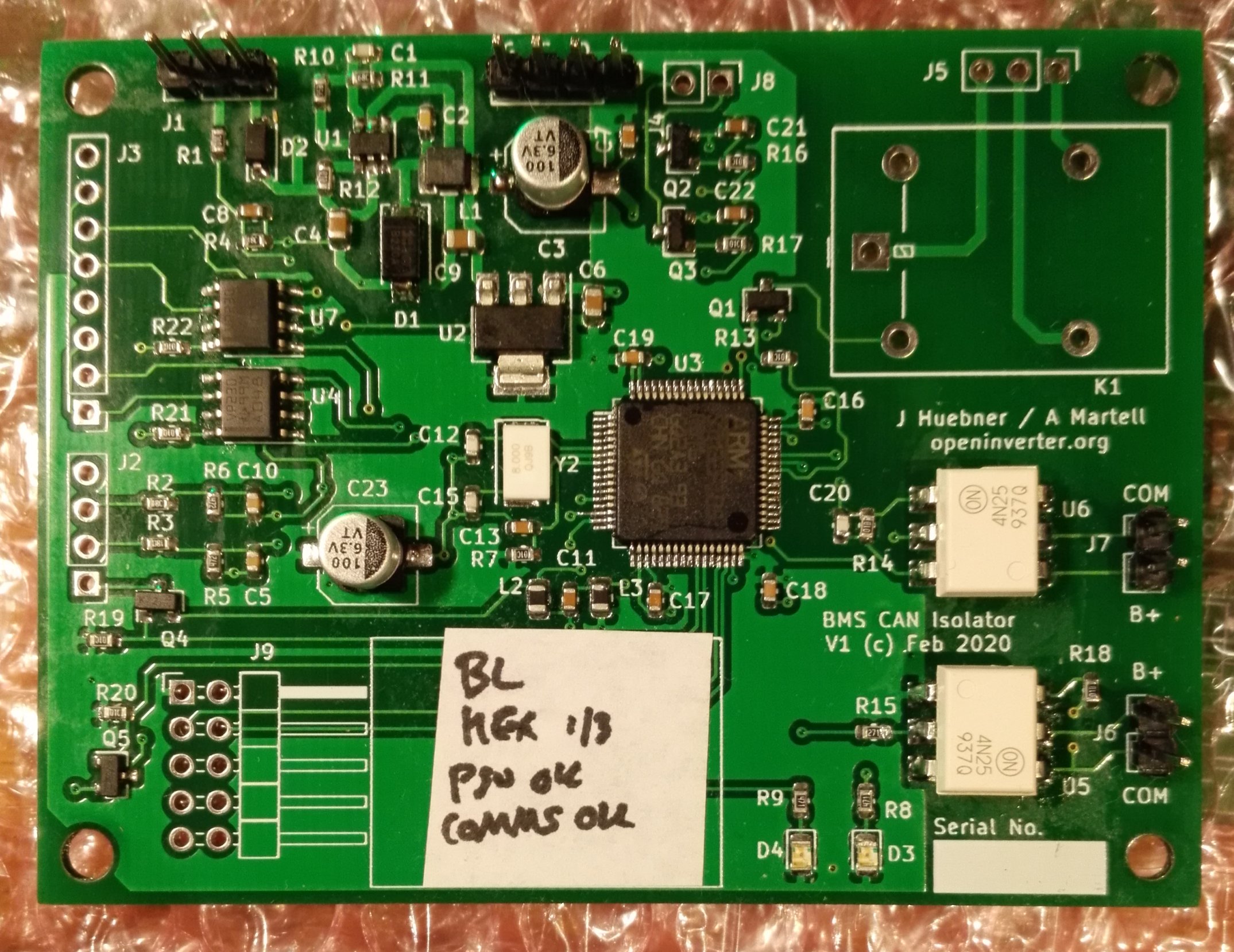

The new BMS master boards are ready, thanks to Andy (=sonachan1)
He did layout and assembly.
I'm getting 10 more from JLC, hopefully they arrive before I go on holiday this Thursday.
2 lessons learned:
- BOOT0 needs to be grounded, otherwise reset doesn't work (processor ends up in factory boot loader)
- The STM32F105RBT6 has a flash page size of 2kb as opposed to 1kb in the STM32F103RBT6 -> need to change boot loader, parameter saving and wifi module update function
2 lessons learned:

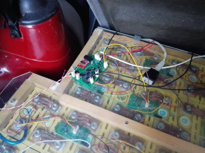

Finally I got to work on the BMS again. I connected it to the 99 cells in the back and also connected fuel gauge, charger (inverter) and a current sensor. All works a treat.
I will build the system up fully with another master unit in the front that acts as a slave to the master unit in the back. Communication is via CAN. With that done I will extend the software to execute more BMS functions.

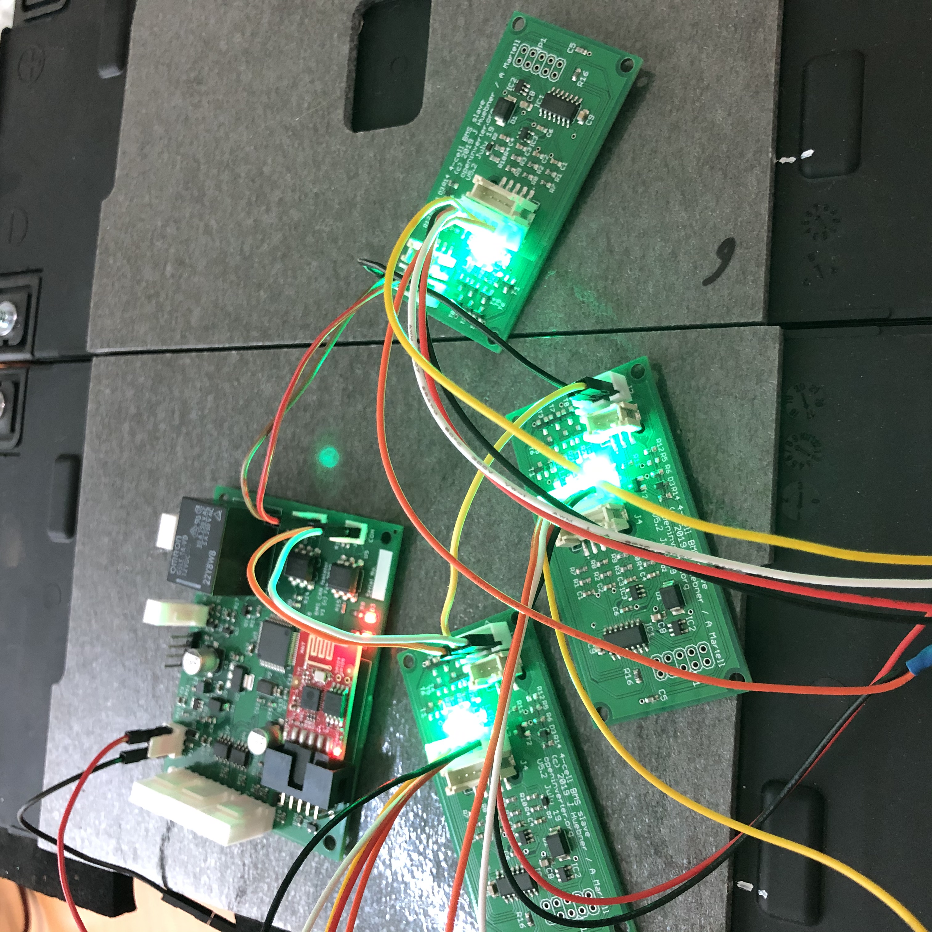

Re: 4-channel BMS with daisychain bus
So, I hooked up some cells for testing. Firmware 0.22B, slaveboard led:s are looping, opmode WaitAddr and that's about it. No voltages shows up. I have a strong feeling I forgot something. Is there supposed to be a jumper on the first slave?
Edit: R12 moved to R5 on the first board and connected to J6 on the master board.
