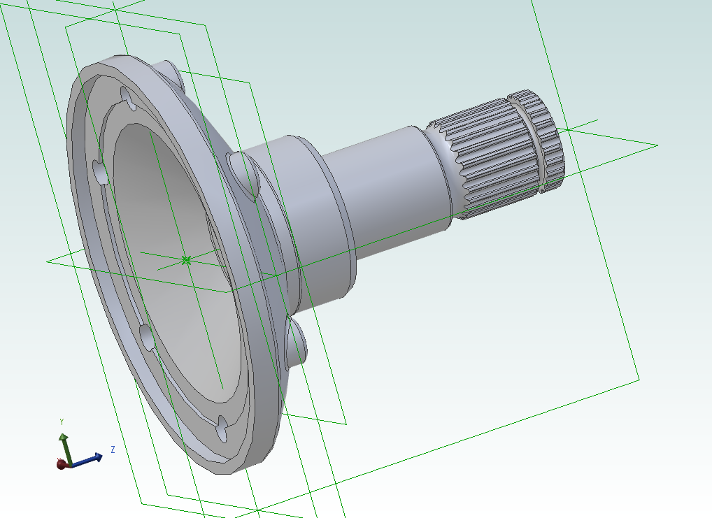

Wonder if I could get some assistance with a couple dimensions for the RS axle stub shaft? (The long one) I’m just finishing up my adapters but I didnt have a stock right side to measure. Primarily looking for the diameters of the steps after the spline. First one should be 27mm dia. Also need the offset from the very end of the splines to the diameter changes. Greatly appreciated!

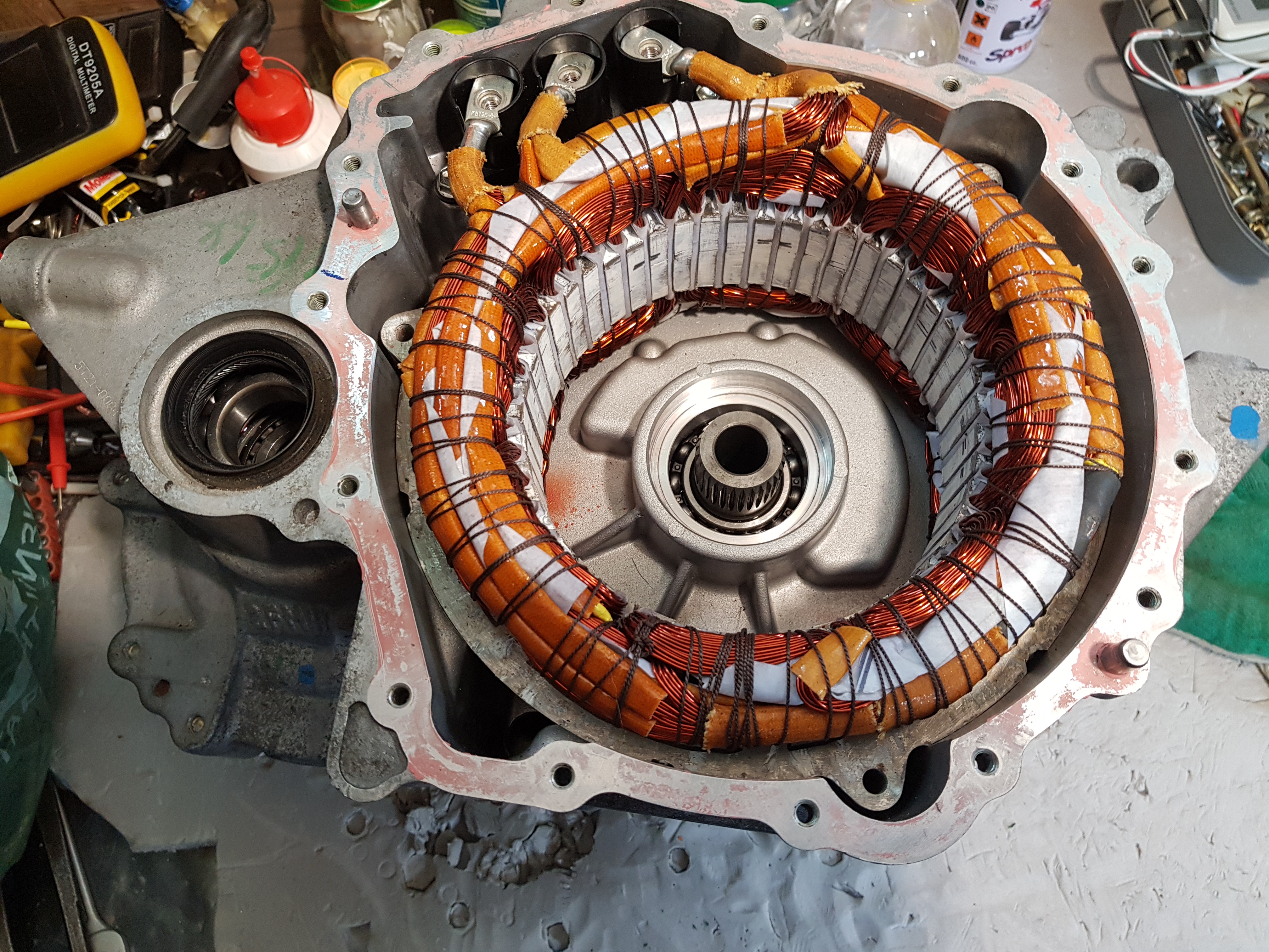

I`ve rewinded MGR from 42 to 10 turns and got 60 rpm/V. With 150V now give arround 9000 rpm.
Initially it was 12 rpm/V.
My project is Electro-Tigra https://electrotransport.ru/ussr/index. ... 5.0#topmsg

Re: Toyota MGR Rear Traction Transaxle
Did you take any photos of this process? I've rewound ebike motors but not considered anything as big as this.
I was trying to design an adapter plate wich could be bolted to MGR output flange on one end and to BMW CV housing on the other end. Almost immidietly realised that it is impossible, or adapter plate must be thic and over complicated.
So I see two ways: cut MGR flange and weld BMW flange to it. Not cheap procedure but the most tidy one. The other option is cheap, yet rely on your welding skill, and this is to make as Damied did - cut schafts in the middle and weld them using metal sleeves.
I'm now going Damien's way.

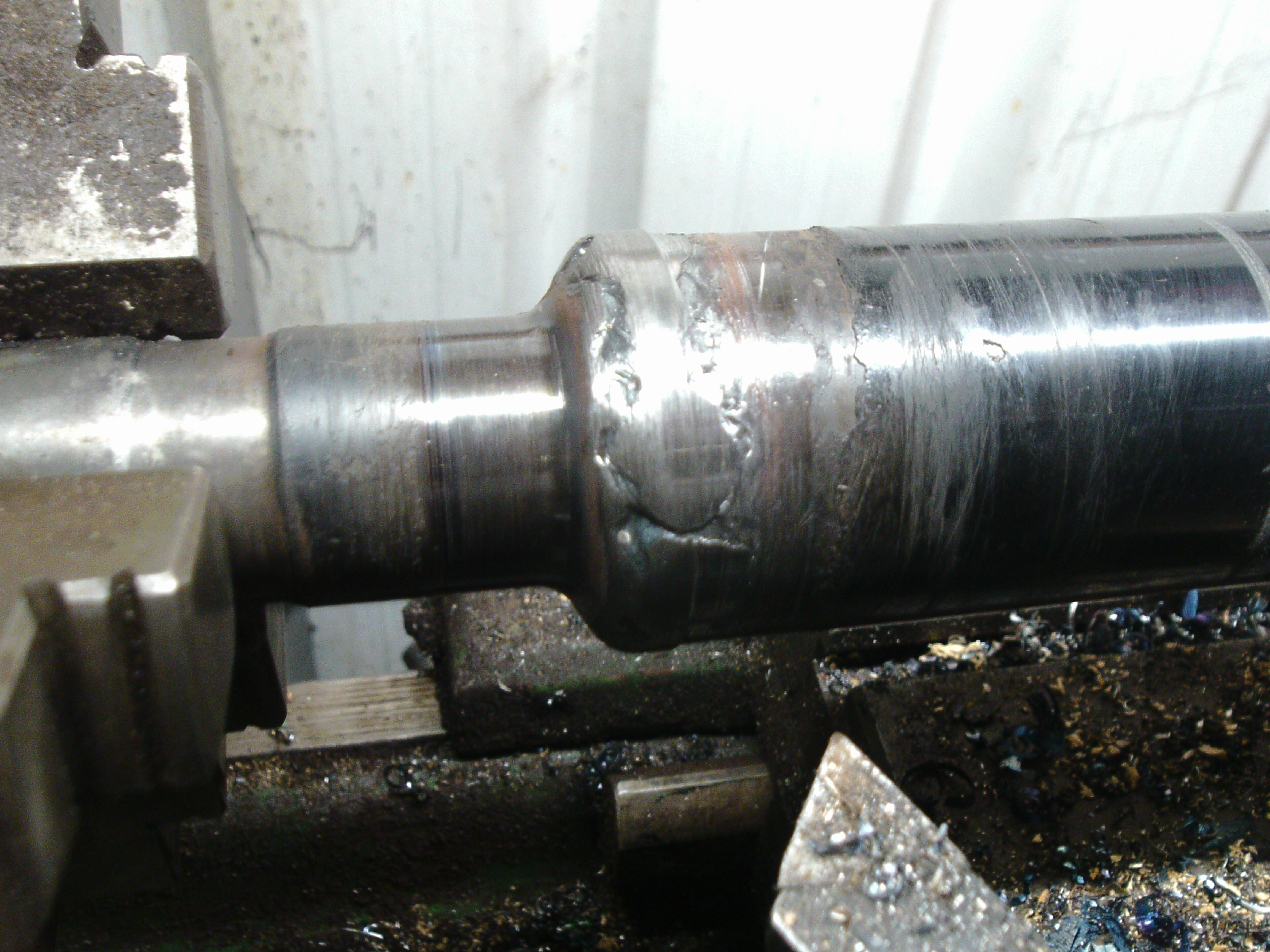

This sort of thing is not beyond the hobbyist if you have access to a lathe.
You could weld a plate to the MGR flange and then turn it to the dimensions of the BMW CV joint so it would just bolt on.
I did this for the last bike project I made using VW CV joints and it worked very well.
I've also welded a shaft for the same project with a little bit more finesse than Damien probably only because I've got a lathe in my tool kit
I did buy high tensile rods for this job.
The modified flange is in the left of the photo.
Modified flange and shaft. Been in constant daily use for 4 years.
What is the PCD of the BMW flange?konstantin8818 wrote: ↑Fri Nov 06, 2020 4:24 pm I was trying to design an adapter plate wich could be bolted to MGR output flange on one end and to BMW CV housing on the other end. Almost immidietly realised that it is impossible, or adapter plate must be thic and over complicated.
Here is how I did to adapt MGR to small VW flange. Maybe you can do something similar?
viewtopic.php?f=11&t=912#p14765
viewtopic.php?f=11&t=912#p16959
- konstantin8818
- Posts: 290
- Location: Minsk, Belarus
- Has thanked: 2 times
- Been thanked: 10 times
It's 80,1mm.
Unfortunately for now I haven't got my own lathe. Flange I've designed was pretty similar to yours. Lathe operator said it would be expensive one. To cut MGR flange and weld BMW one to it would be cheaper, yet the most cheap way was to buy two drive schafts from Lexus and to make two sleeves.
Not so much a photos.
I forget to do it all the time
You can see more about my project, but russian only here - https://electrotransport.ru/ussr/index. ... 5.0#topmsg

I'd like to go a bit over 30mph, my fabrication skills aren't up to the job of splicing it into the existing axle (Nevermind the unsprung weight) and I don't fancy shelling out for a new motor just yet.
Options I'm considering are:
1 - Hack the casing apart, take a shaft straight off the motor then find a way to keep it cool and stop it pissing oil everywhere.
2 - Lose the casing and make a new one for just the motor
3 - Rewind the motor for silly speed and hope the gears can take it
4 - Accept defeat, use this as a test motor and swap for something more suitable when I've got the rest of the build worked out
Can anyone familiar with the MGR guts offer any words of wisdom?
