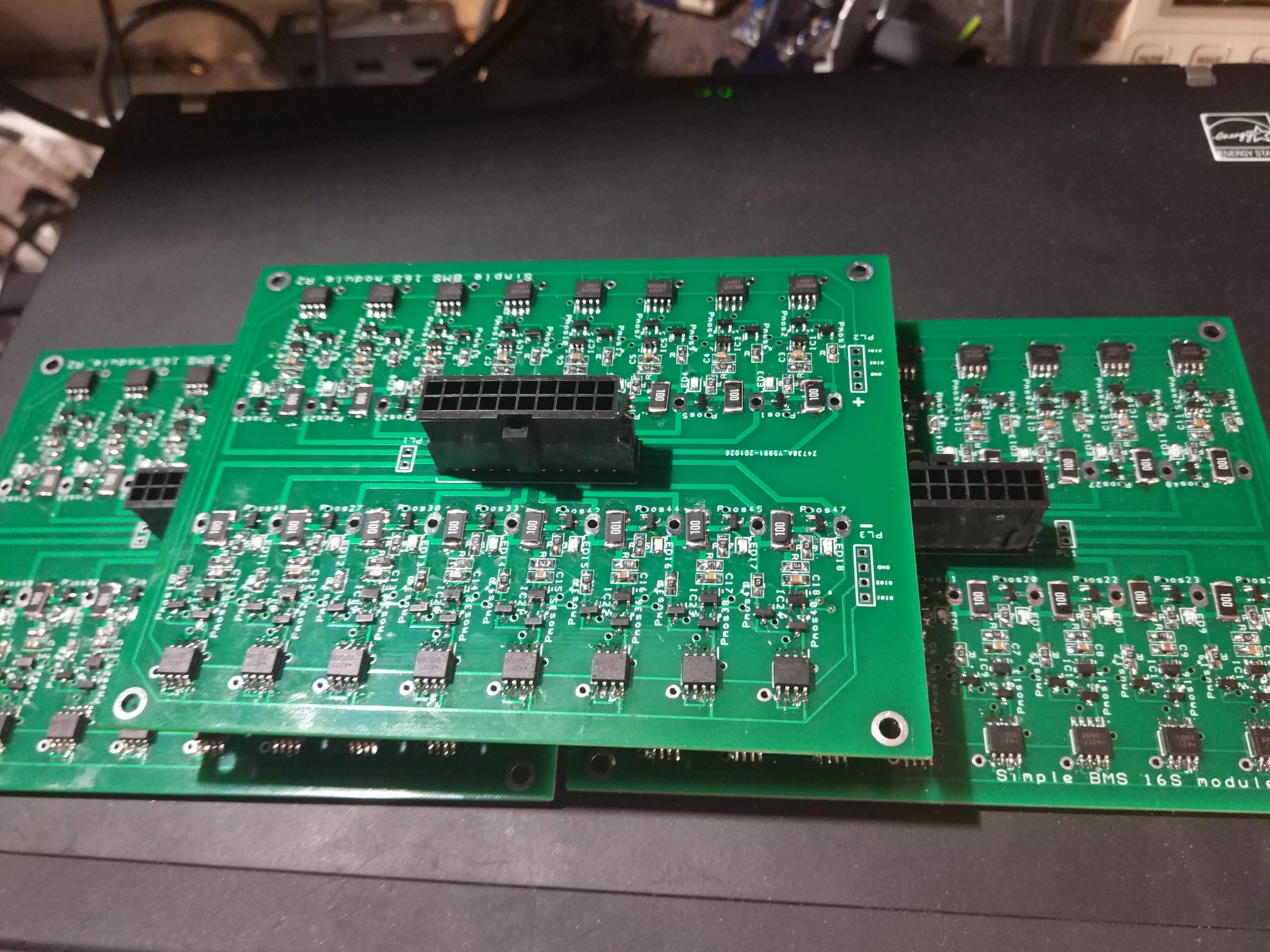

Here i have completed first 3 PCBs of 16S BMS.
I really like the Molex minifit connector. Much tidier than my previous connectors.
Optocouplers work in with daisy chain and OR circuit in the end. Whichever of the sensors will announce overvoltage first opto will close and pull its pin to GND.
Pin holes on the left are used to connect 8th cell - line to 9th cell + line. Saves one wire in case of 16S pack. If i would join two 8S packs i would need another sense + wire to start another chain.

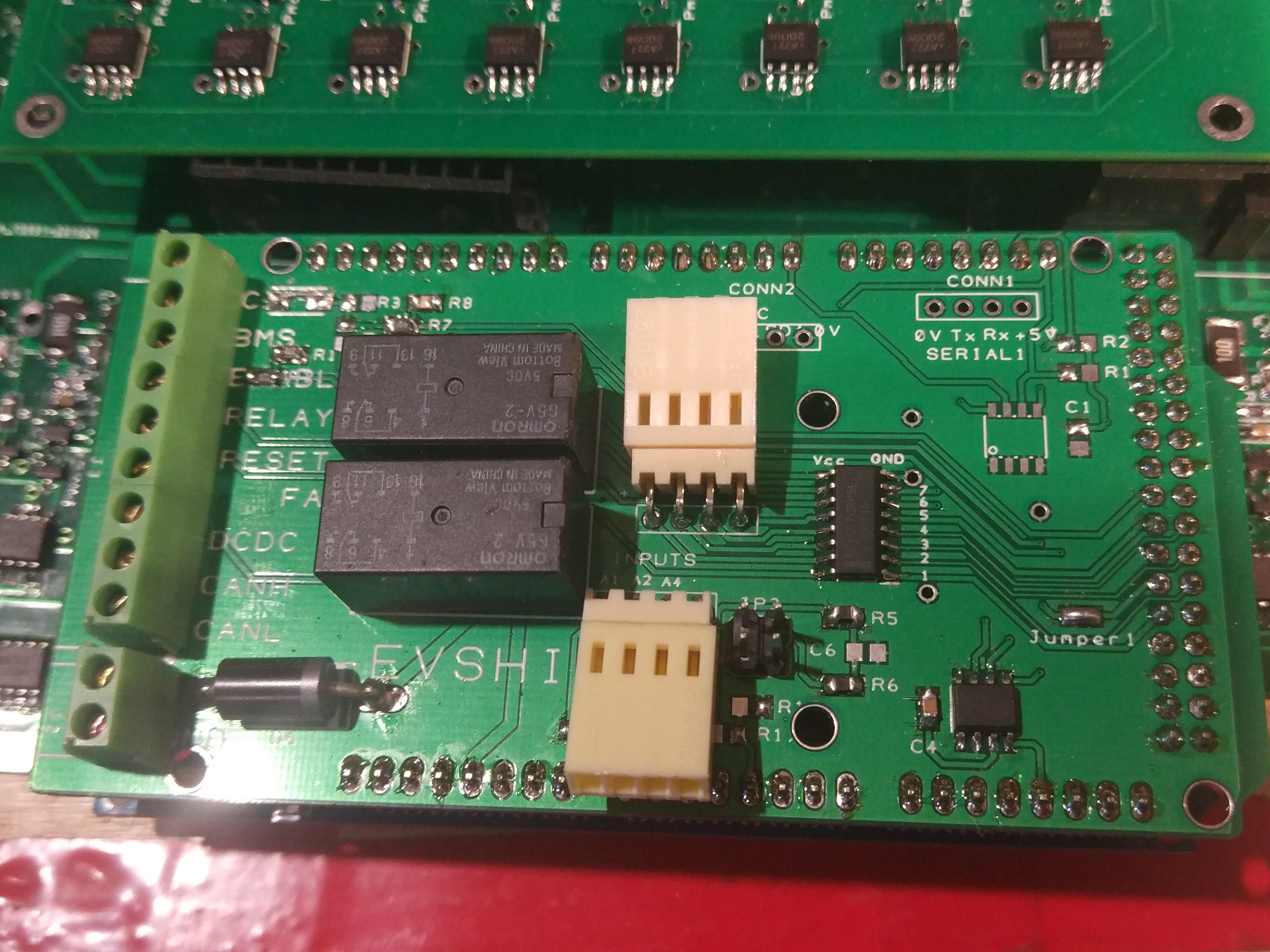

I decided to adapt Arduino DUE circuit i am using to control DCDC and Charger to also act as my BMS master. This way i can either stop charging or disable car traction if my cells will go too low. I will use the same output that i use to disable traction while charging. No special circuit needed, just additional input configured with pullup.

I installed 16S modules in a car and connected them with daisy chain.
BMS chips have two cmos outputs which are triggered when high/low limits are reached.
At this time i use main chip to turn on two PNP transistors which in turn activate 2 channel optocoupler. All optos have connected CH1 and CH2 transistors in parallel to corresponding lines. Then there is also GND line. 3 wires go from module to module and finally to whatever controler one would use to signal charger or drive status inside the car. I choose Arduino DUE.
Ch1 is connected to BMS input with internal pullup
Ch2 is connected to Enable input with internal pullup
GND is connected to car GND.
When HIGH alarm is activated it pulls Ch1 opto channel to GND which in turn pulls the BMS pin LOW and DUE knows BMS is activated. It then changes chargers CAN signal and turns Cp relay off.
When LOW alarm is activated it pulls Ch2 opto channel to GND which in turn pulls the Enable pin LOW and DUE knows to signal inverter to pull emergency relay and/or light warning LED.
I simulated single cell to make sure everything works. I used the last board in series and connected everything in the chain with my test cable. I connected my power supply and simulated 4.25V per cell to turn on HV alarm. Ch1 turned on and charger stopped. It kept balansing until cell reached 4.15V and then allowed charger to turn on again - check!
Then i simulated 2.8V per cell to get the car to trip my energency relay/button. Car immediately turned inverter torque off. All systems were operational. When i let voltage up to 3.1V chip released LV alarm and let me operate inverter.
Let me remind you those values are terminal values and i consider having battery there requiring a maintenance action or at least some system inspection.
I have designed my BMS boards to read voltage directly and chose chips acordingly - S-8211CAM. If you want to use a different values or have different margine you may add resistor divider in front of S8211 chip to lower the sensed value. But i must remind you to calculate the gap from HV to LV so both values are in correct span.
