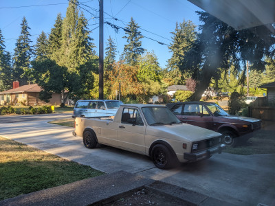

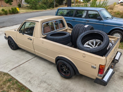

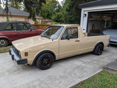

Hi! My name is Andrew and I thought i'd make a short introduction since i've been lurking for a bit now.
I went to Western Washington University's Vehicle Research Institute, where I helped create this carbon-monocoque 100mpg+ car. I was mostly responsible for transplanting a Honda Insight hybrid system into this mid-engine science project. So, DIY EVing is not completely foreign to me, but I've not ever gone beyond forklift level technology. Today I work as a BEV Power Electronics Manager for a Global HD Truck OEM.
On to the project -
I'm a bit of a VW fanboy and much prefer the MK1 and MK3 platforms. Since the ID3 will not be sold in North America, I have to take things into my own hands.

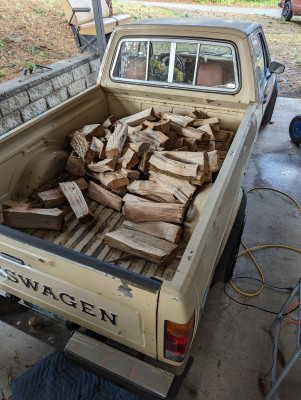

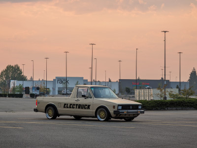

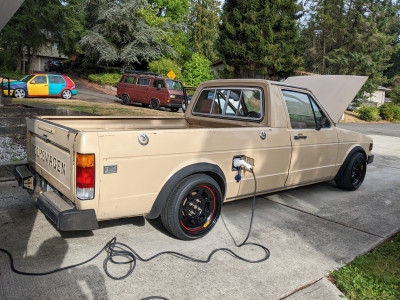

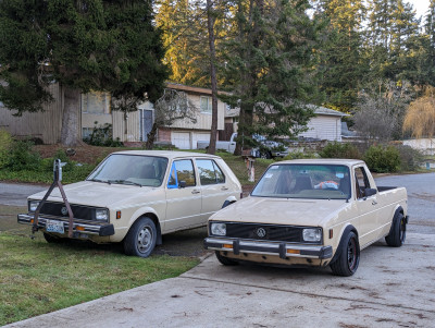

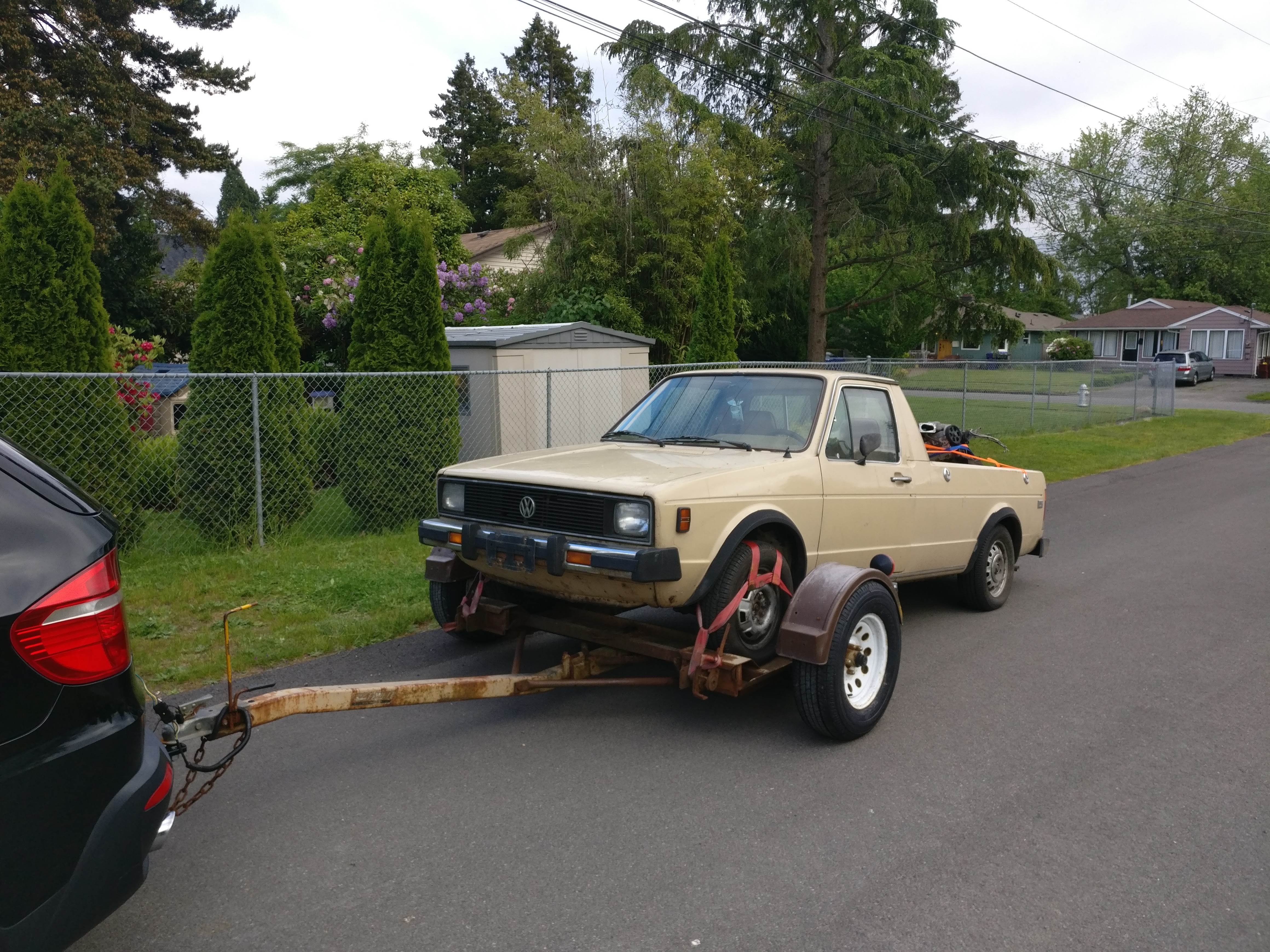

The project I'll be documenting in this thread is the Leaf-ification of my 1980 Rabbit Pickup, aka "Caddy" outside of NA. I'm hoping this leads to the electrification of my other MK1 VWs in the future, and maybe even my Golf Harlequin??

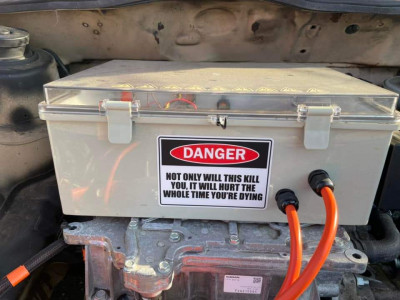

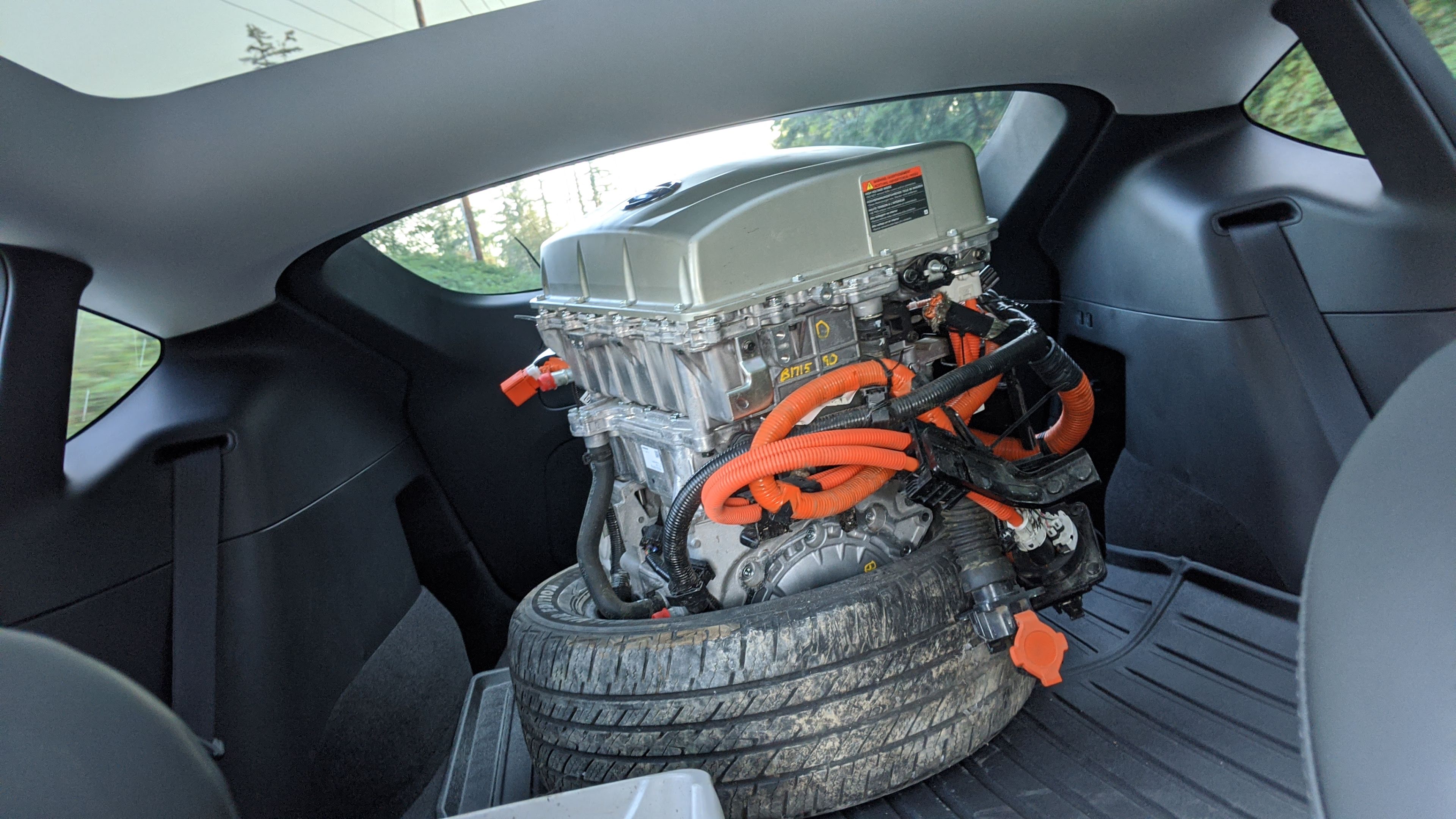

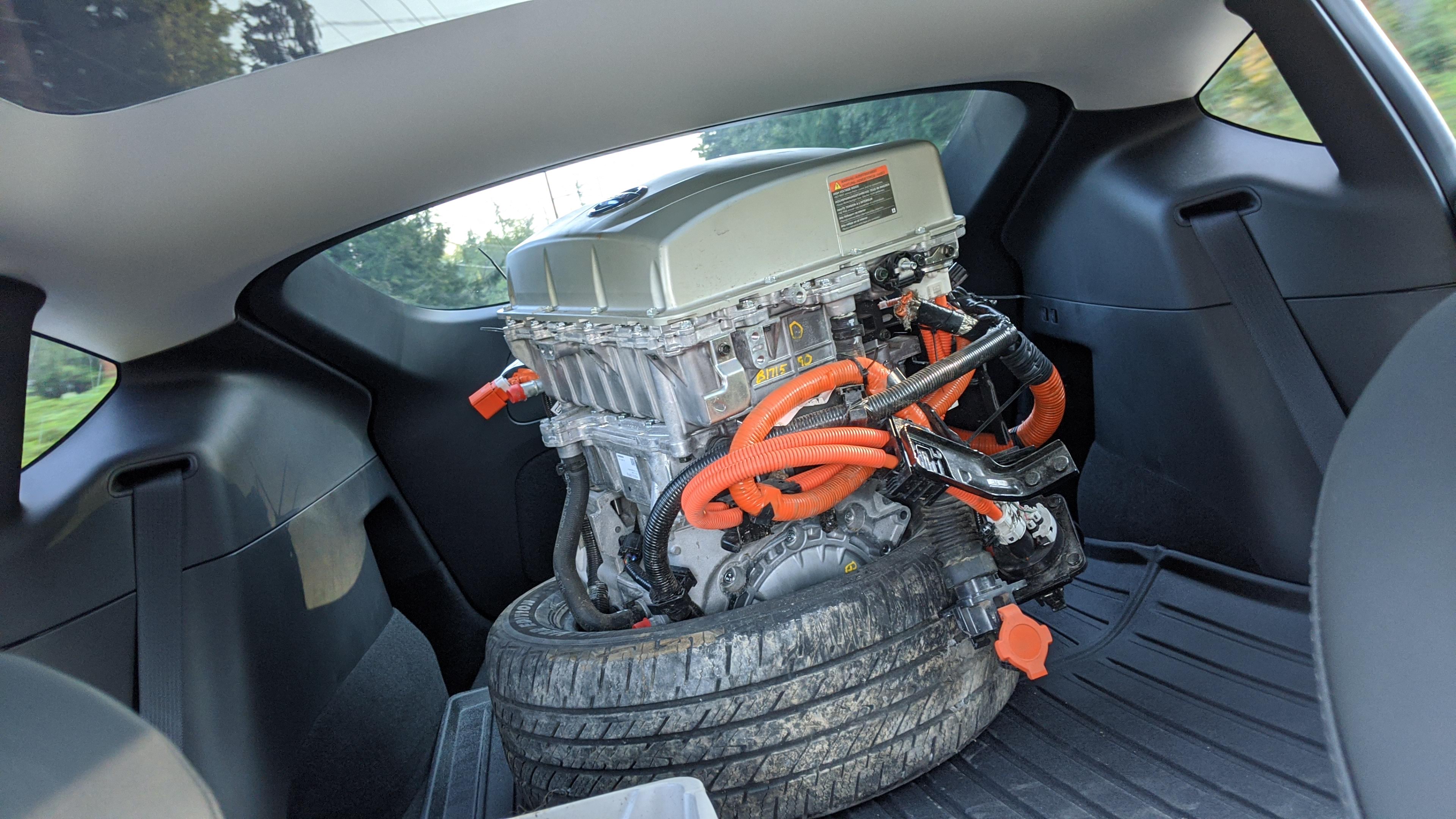

The truck: The Powertrain (in the back of my Model Y): My clown car:
On to the project -

Awesome project, mini trucks I think are a great conversion platform. small and light, tons of battery space, and suspension to support.
there a yellow patina caddy in the bushes down the road from me... I’m eyeing it for a next conversion.
Interested to see how you go about yours!
what is your plan/ goal for the truck?

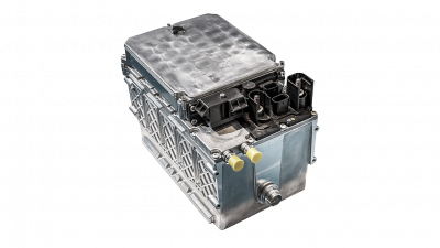

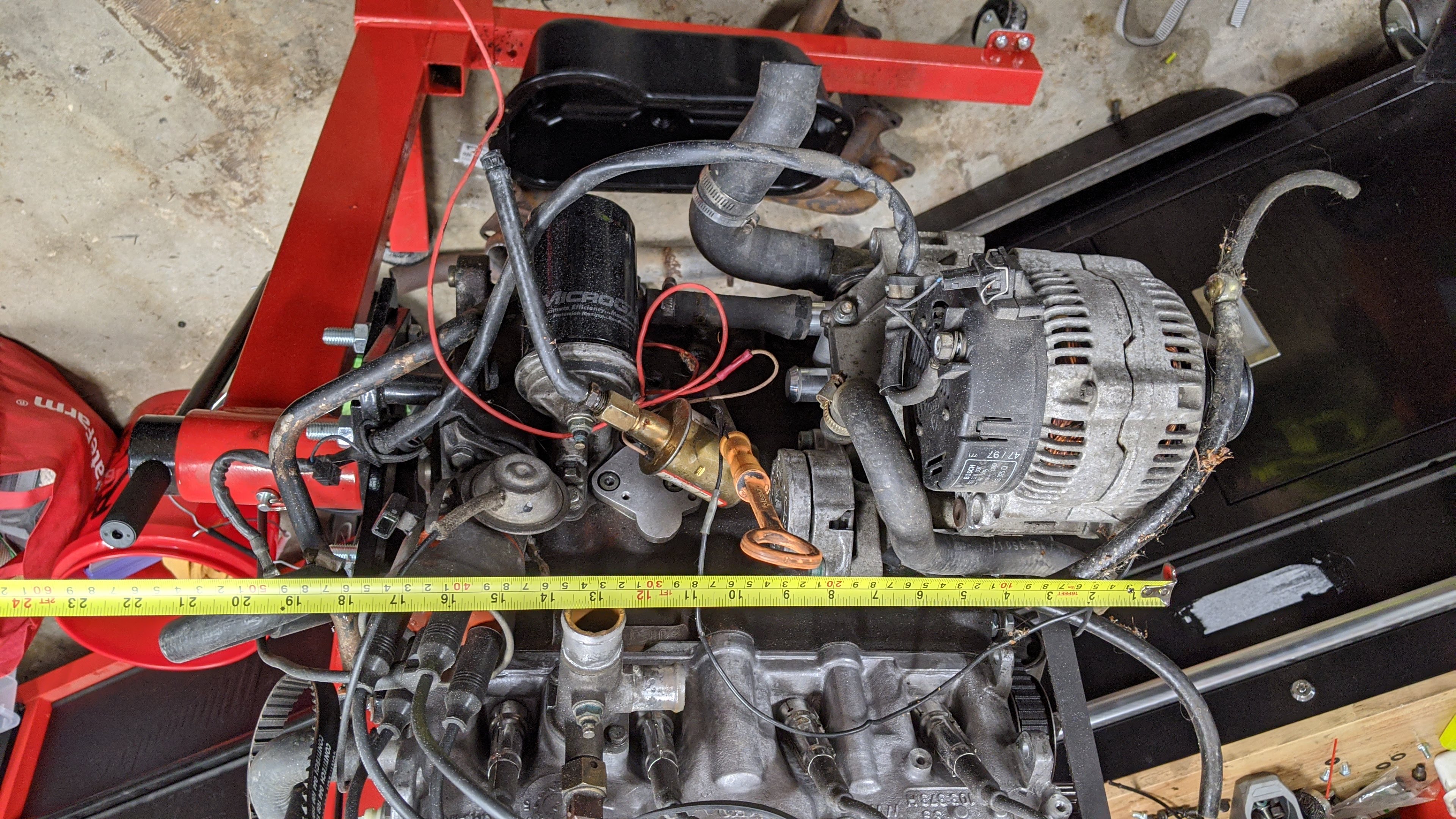

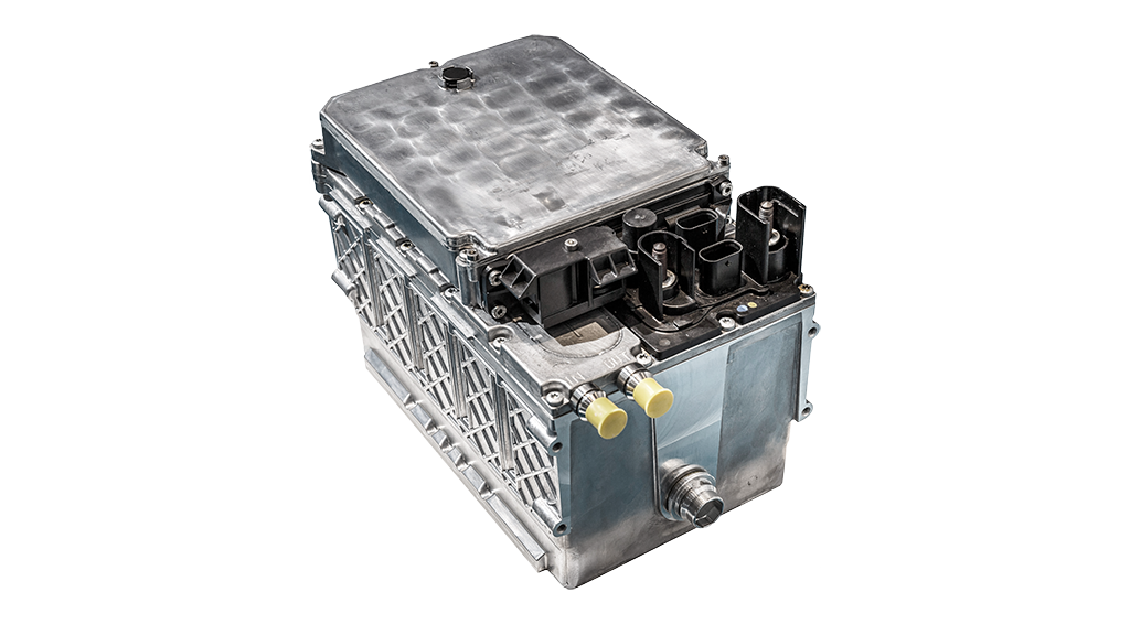

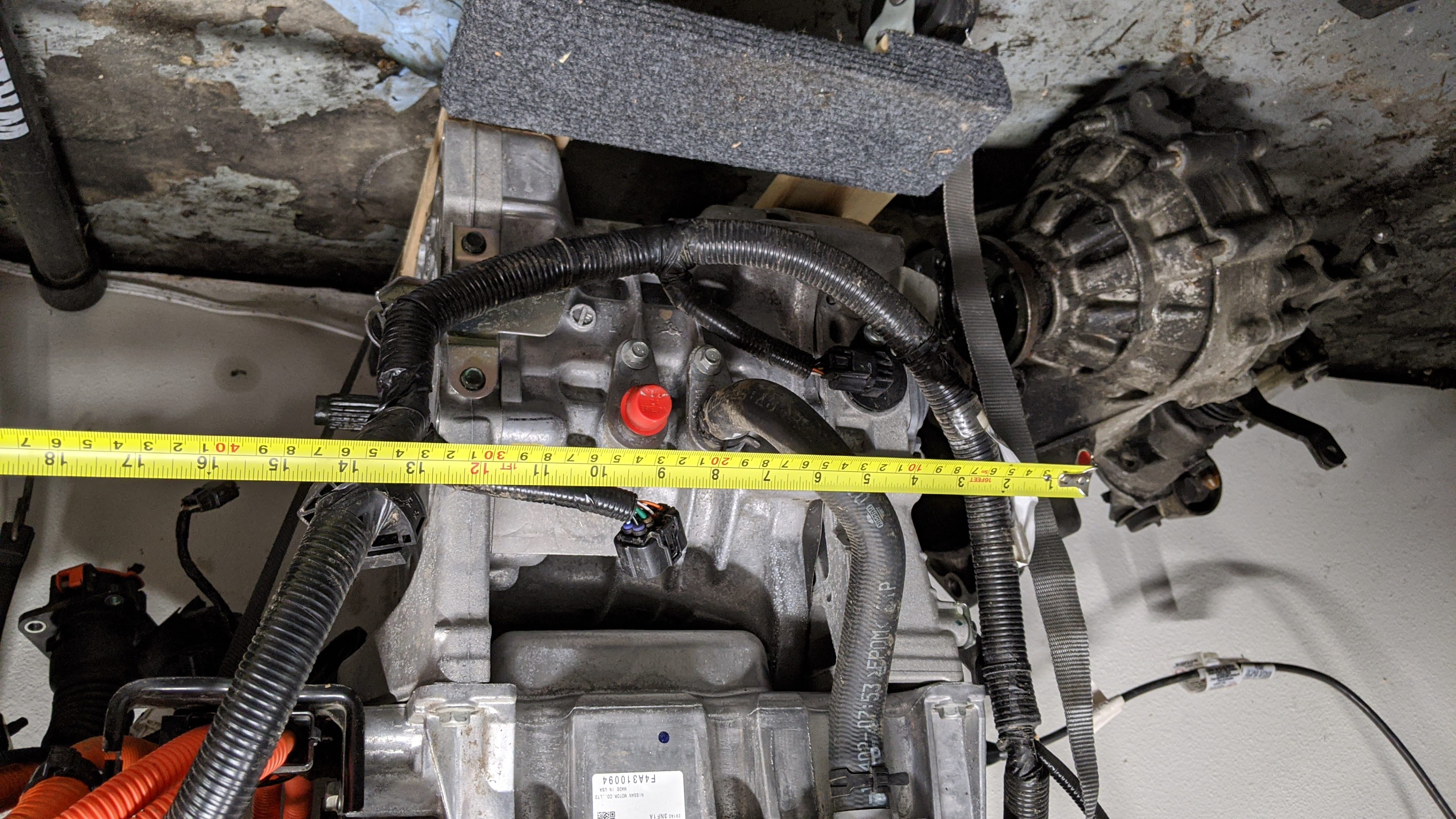

here is the length of a basic watercooled VW inline 4 on a stand in my garage:
here is the Leaf PDM:
The leaf motor is much shorter. This is the part that has to fit between the rails so it's mostly what matters. The Power Electronics atop the motor are a bit wider at 500mm or so. in the end, the transverse width of this package will be less than original.

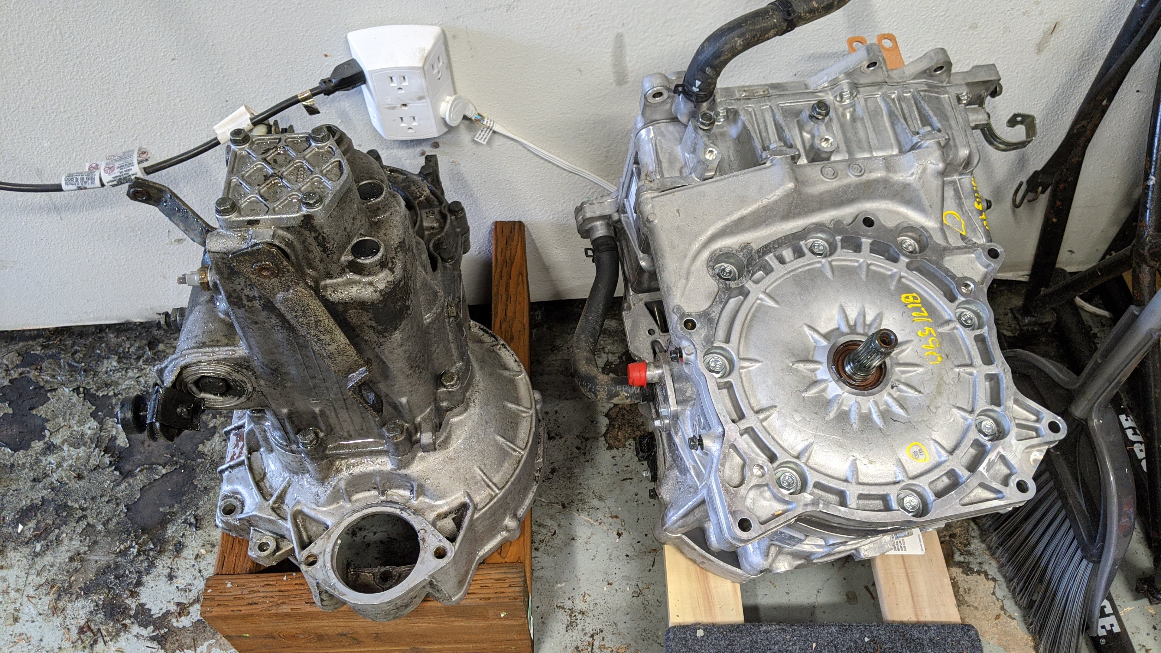

obligatory Leaf PDM disassembly pic:

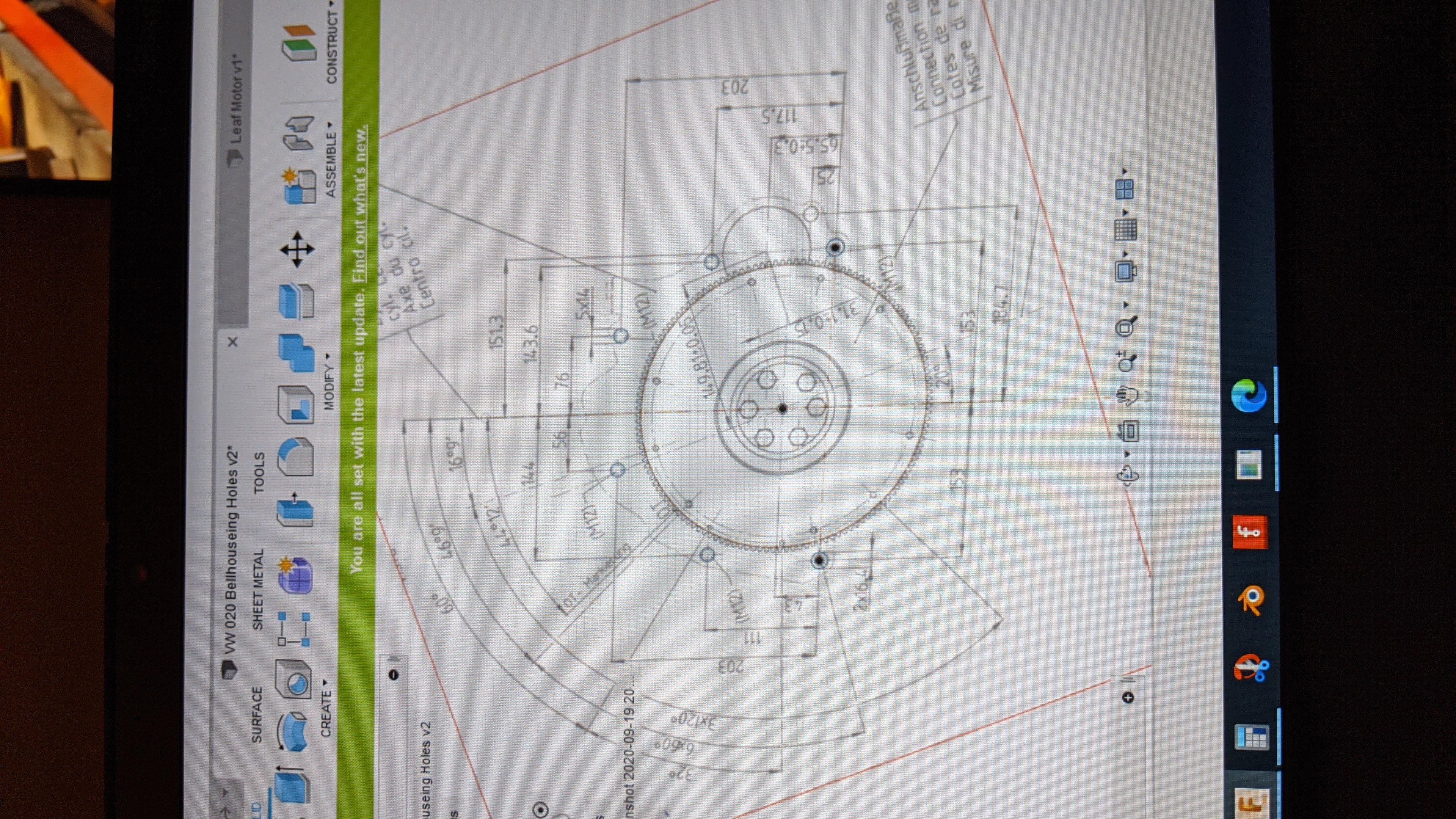

Now, on to modelling up an adapter. Does anyone have a drawing or model of the Gen 2 Leaf motor mounting holes?
As well, I have a Geo Tracker clutch friction disc in the mail for the motor output that i will be cannibalizing.
- vwbrady
- Posts: 248
- Joined: Mon Dec 16, 2019 1:18 am
- Location: Seattle, WA
- Has thanked: 5 times
- Been thanked: 18 times
Re: Project VW Cadd-ev

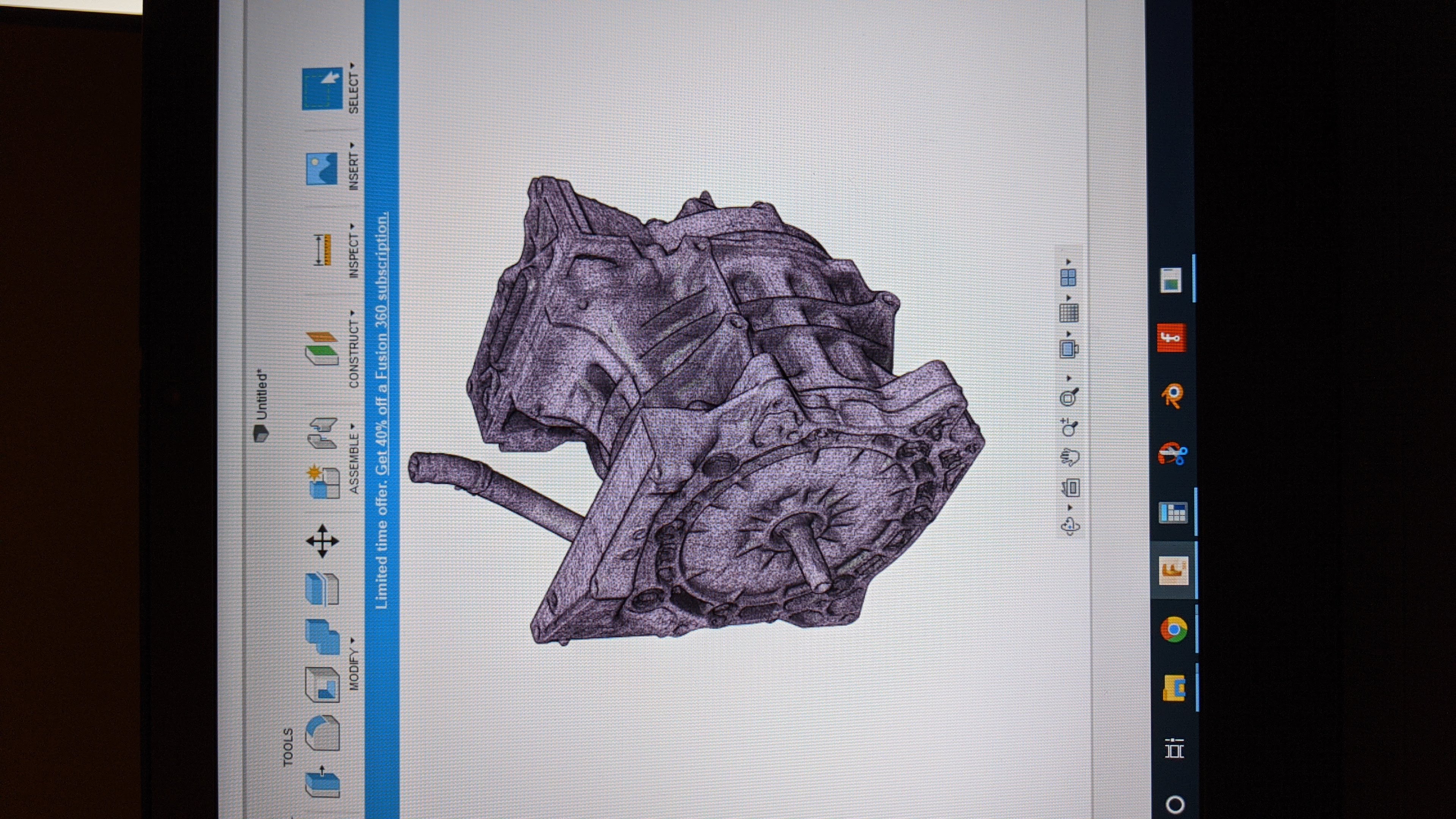

Found a 3d scan of a Leaf motor online. Need to figure out how to scale it to real life dimensions and the definition isn't great, but it's cool to see!
Also found a pdf of a VW I4 engine with the trans mounting pattern.
I'll likely only model and CNC the VW side, then do the Leaf pattern by hand. I'm already thinking i'll need to space the trans away from the motor a good bit since the bell housing is a bit taller than the leaf motor will allow. We'll see.

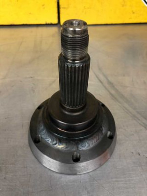

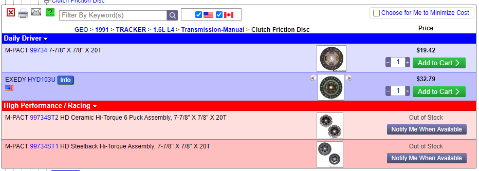

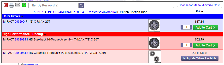

Early 90s Geo Tracker friction disc arrived. Not a great fit. It is a 7/8" 20 tooth spline.
The fiat discs others use, i don't think i have easy access to in the US.

You can get Suzuki Samurai disk splines. Arlin said they are a bit tighter fit than Fiat.

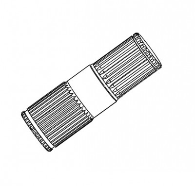

So, the Samurai disc shows the same spline dimensions as the Tracker. I'll order the samurai disc and check it out with hopes that their descriptions aren't really precise.
Geo Tracker:
Samurai:

I think we should make a sticky post in the forum. I'm through all this. I have videos on youtube. And you can read it in my threat (Toyota GT86).
NONE of them are really a good fit. The best fit is the volvo clutch disc. Everything else won't work for a long time in my opinion.
Usually there should be absolutely no play, as on a original gearbox and clutch plate or as on the leaf spline with the leaf gearbox part.
I was at a local CNC shop with the Leaf Gearbox Spline to copy it. I will get an offer next week. If it is reasonable i will order 50pc of the adapter splines and weld them into Rotex GS38 couplers

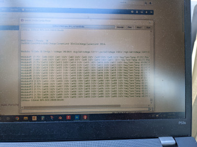

I've got my batteries on order from www.batteryhookup.com and a spline adapter from Bratitude (I had tried 4 clutch friction discs already).
I decided to go with 6x Mercedes 48V (L09-1) mild hybrid modules due to their small size + individual packaging and decent capacity of 880Wh. These will be easy to locate in various location, only requiring bracket fabrication.
$113/kWh isn't bad at all
I will need to remove the integrated 48/12v converter and BMS and then somehow add a Nissan Leaf BMS onto the 96 individual cells. With a about 5kWh, my goal is clearly not range.

turns out there is a mistake in the listing for the batteries. they are 12S modules but they mentioned you need 6 to reach 350V, which doesn't add up. so it turns out i'll actually be using 8 modules which gets me about 7kWh. or somewhere around 35mi of range (@200Wh/mi), which is good for me.RetroZero wrote: ↑Tue Oct 20, 2020 4:24 am Are the 5kwh due to total weight of the build or budget?
You are planning on using a Leaf setup. Could you post another picture of original gearbox. Trying to see if a Gen2 transaxle could work before purchasing Mk1 cabriolet... Apparently it might have to be turned around due to knocking up against radiator. Thanks
I'm using the original 4spd VW 020 transaxle, that comes in every FWD 4cyl VW up to ≈1997. I have AL plate coming from 3dhubs for the Leaf motor and the VW transaxle. I should be mocking this up at some point during Q1 2021

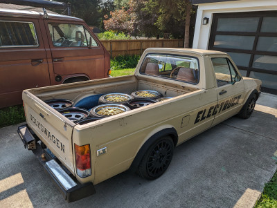

there are TONS of wrecked Leafs in the US. Batteries are hard to come by cheap due to DIY powerwall people but the PDMs, if you find a high volume + low educated wrecker, are plentiful. I think i mentioned this somewhere else, use www.car-part.com and search "engine assembly"
