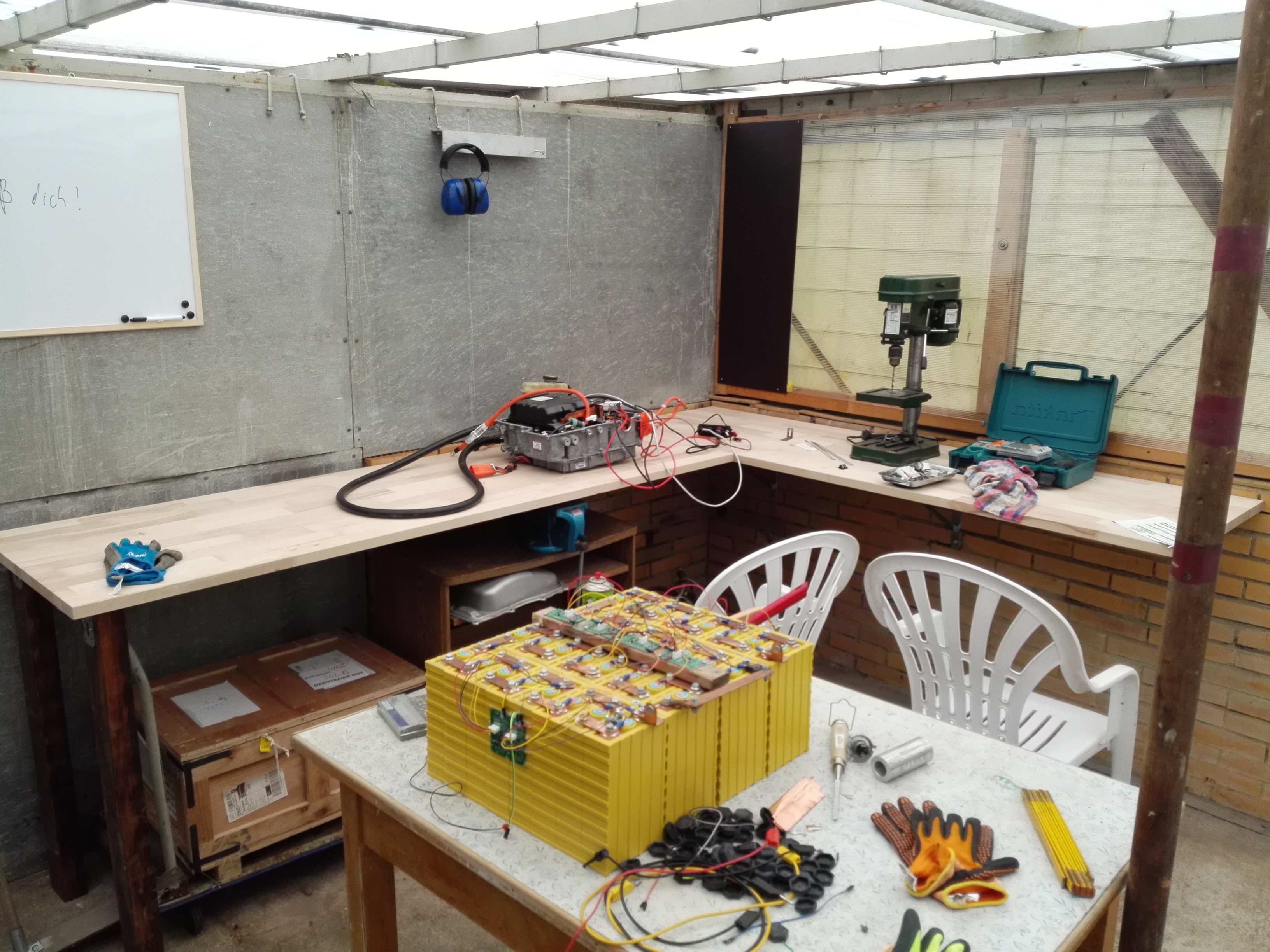

I cleaned up the shed today to be able to do some more development work there.
First thing I want to equip myself with would be a Prius transaxle. A quick search on ebay revealed prices starting above 600€ and shooting up to 1500€. I thought they were like 100€? Please enlighten me.
Also thinking what other unhacked motor/inverter combination to get. The Renault Zoe is the most sold EV to my knowledge, so how about it? Any suggestion what could spawn on scrapyards in the near future?
