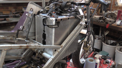

BMW modules trial fitted to modified Freccia frame.

Nice. Interesting to know that they clear the narrow bit near the headstock - that was looking very tight on my measurements!

They won't clear the engine subframe.

Oh wow, they fit very well between the chassis bars.

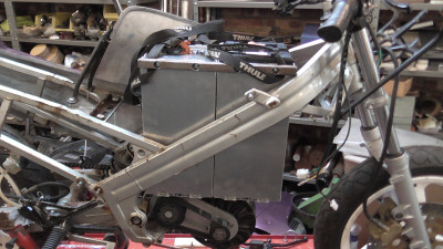

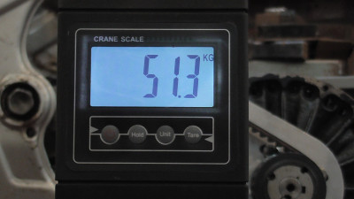

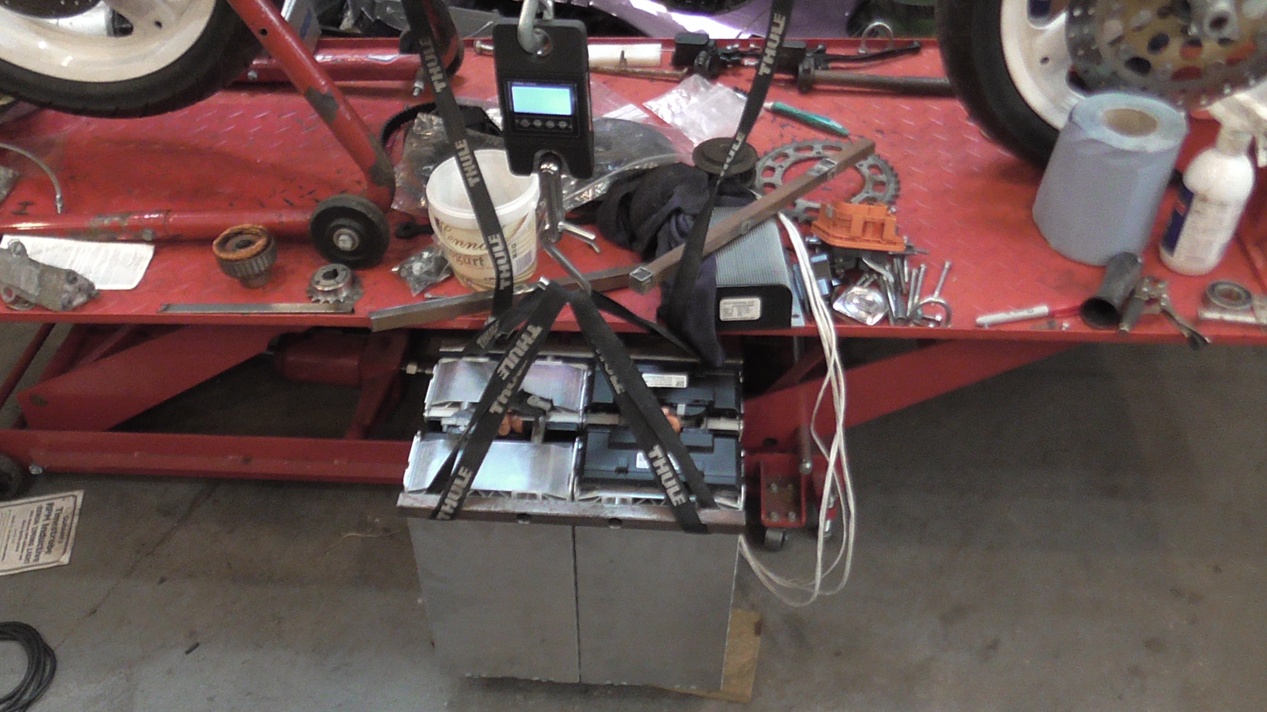

It's sort-of on hold at the moment until I can get more workshop space. I managed to get 12.5kWh / 60kg in the frame with enough space for the rest of the bits (boy is it tight!). Paul Compton is totally right about the lack of space in these things.

Cool, nice packaging, never thought of stacking at an angle - probably because the hub motor makes that bit easier.
