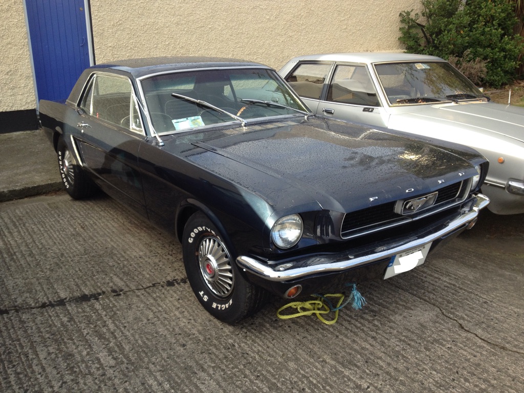

Kicking off a thread on my project. A few years back I bought myself a 1965 Ford Mustang. Here it is the day after I bought it. You can still see the rope attached from where a friend very generously helped me tow it home. There was just a minor issue with the distributor. I've had it running on and off. But there are issues that need attention - water leaking in and rusting things up. It needs a fair amount of restoration work. The cowls need to be replaced, there are a few small holes in the floorpan, and there is some bubbling paint on one of the doors.

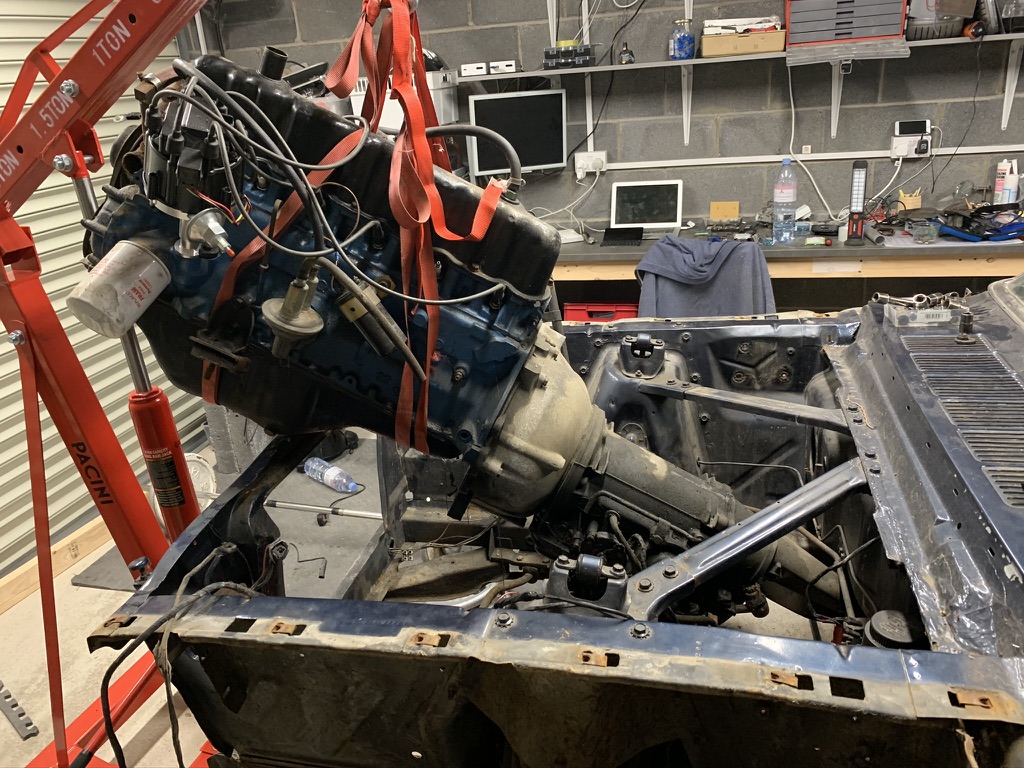

The original plan was to rebuild the 200ci inline 6 cylinder engine it came with, but I've decided to turn it into an EV instead.

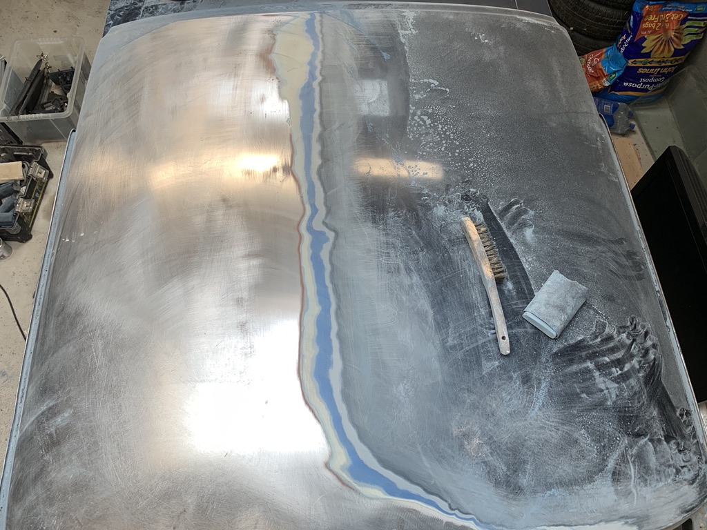

I've more or less stripped it back to the bare frame. I'm grinding off all of the paint right now. After that will come bodywork repairs.

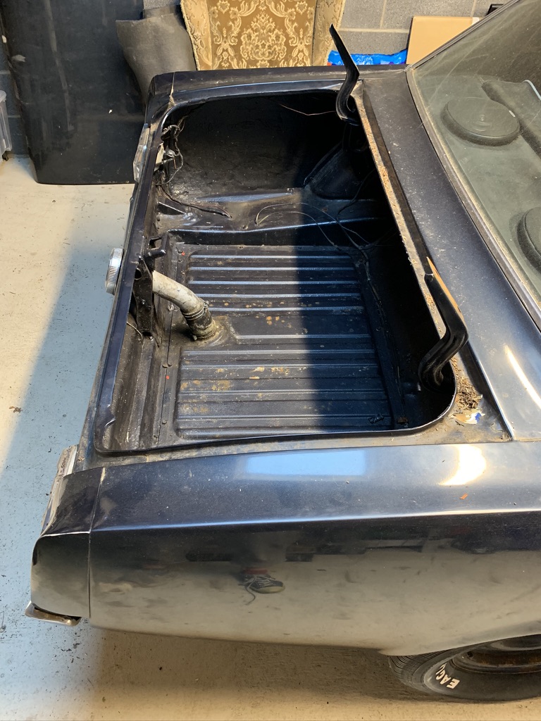

Lots of room in the boot as well. In particular, there's a space that's approx 400x300x1100mm behind the back seats. It's sort of dead space that doesn't really take away from the boot space. I have one of the BMW 'saddlebag' 9.5kWh packs on the way. The plan is to start out with this small pack and get everything working. All going well, I'll invest in a bigger pack.
I'd love to keep the original filler cap location and put the charge port there.

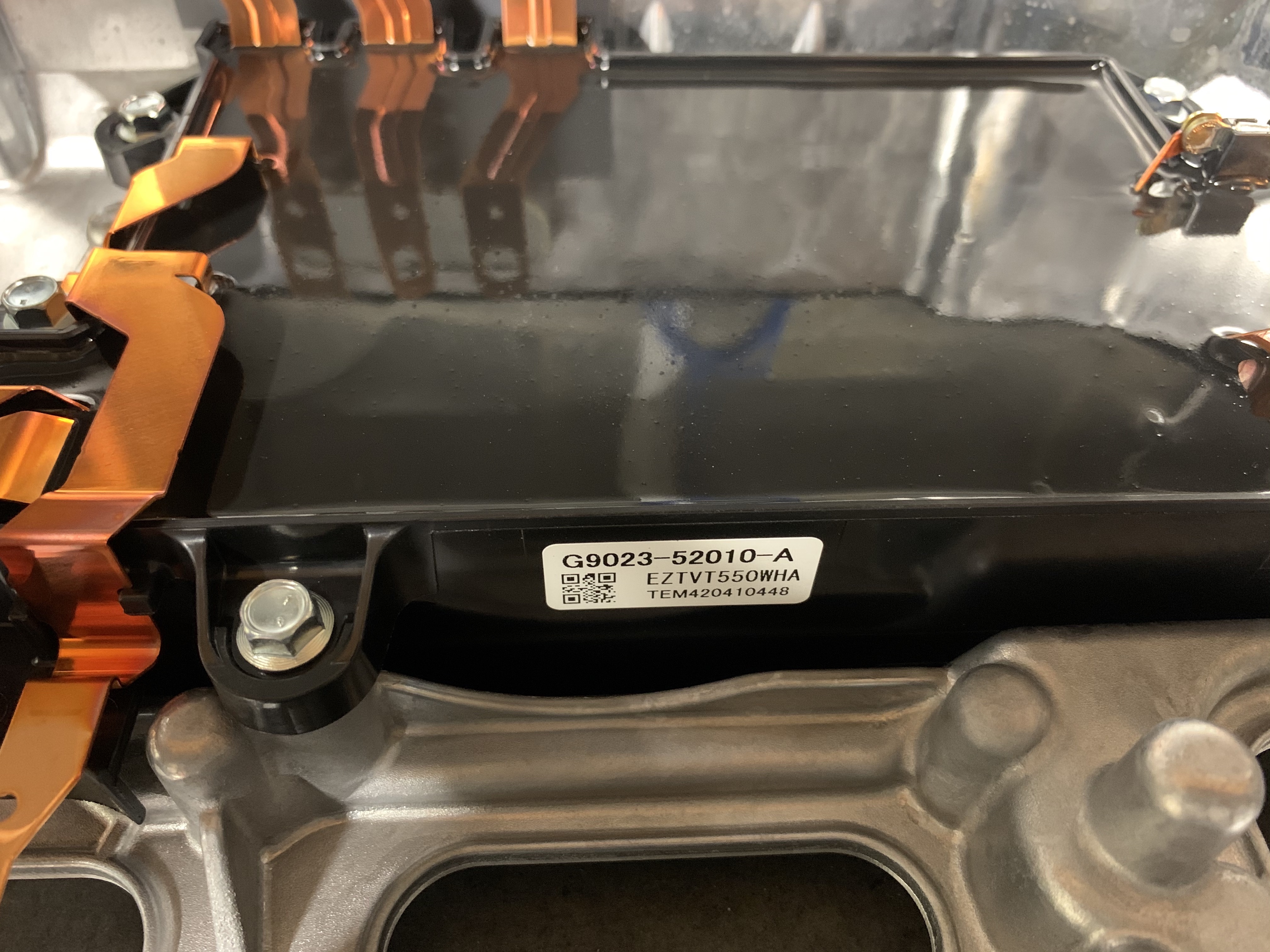

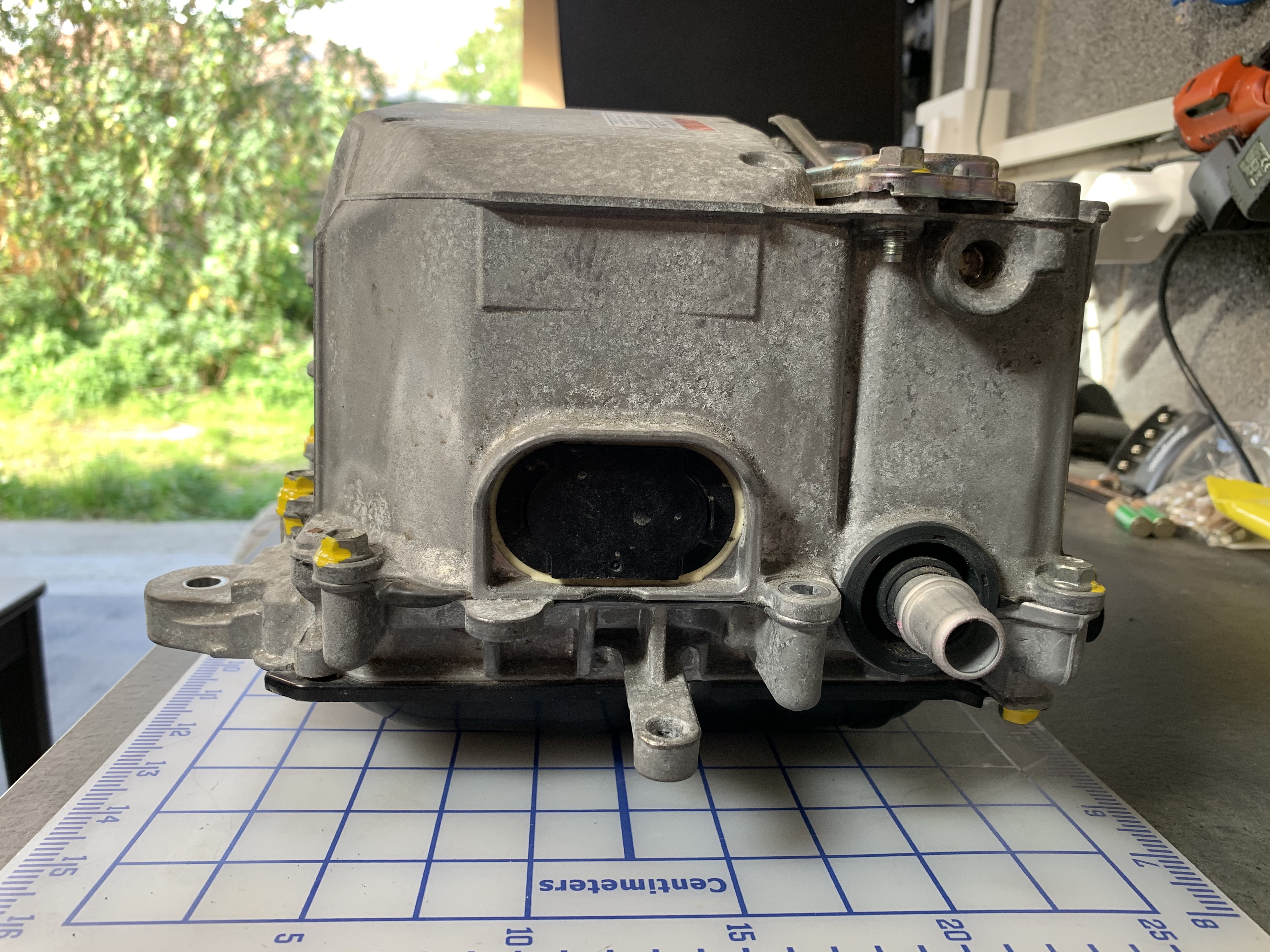

I got my hands on an inverter last week and finally got it open this evening. I wasn't paying very close attention and only realised that it was from a Prius Aqua (or Prius C). But, now, having cracked it open, and consulted the wiki it looks to have the same board numbers as the Yaris.
Top badge : G9200-52030
Side badge : G9201-52011
Small/top board : F1759-52010 04 (154mm long)
Big/bottom board : F1789-52010

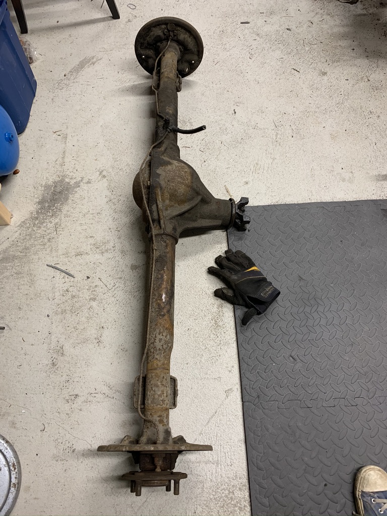

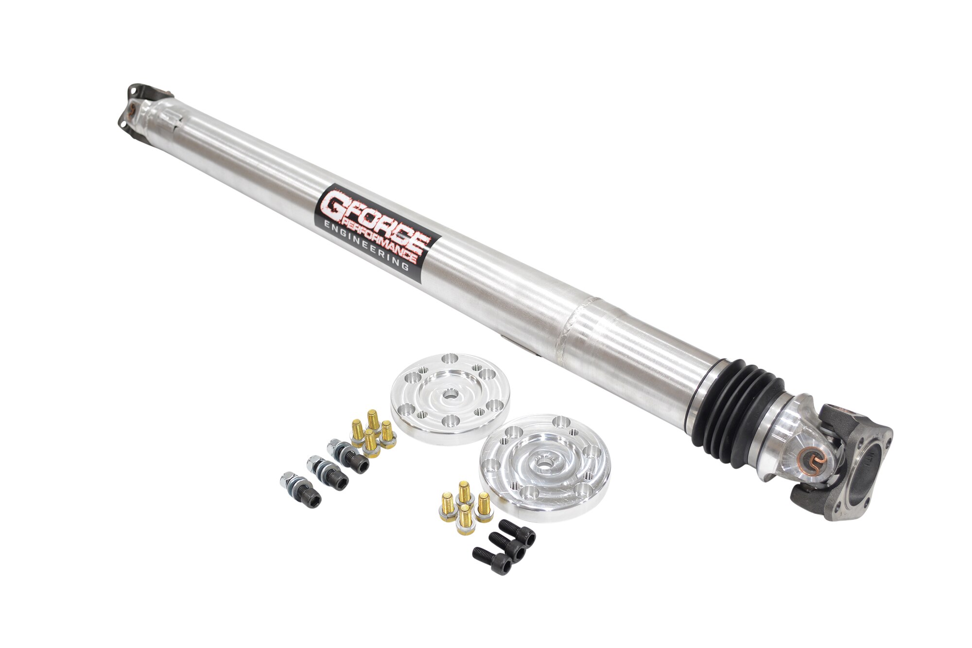

Do you have any idea how you're going to join the gs450h transmission to rear axle. My car had a slip joint joining the transmission to the prop shaft. I presume this is standard on Mustangs. So, you can't just make up an adapter to fit to the U joint at the transmission end - the prop shaft won't be able to 'breathe' as the suspension moves. You could make a new adapter that fits the gs450h on one end and has a slip joint on the other. This might push the gs450h transmission forward into the engine bay a bit more than you'd like though.
The other option is to use the prop shaft from a gs450h and make an adapter to join it to the diff.
Also, what rear end do you have in your Mustang? 8in, 9in?

Re: 1965 Ford Mustang
I bought an adapter to convert the 3 bolt flange to a standard u-joint. You can then get your stock driveshaft modified (or buy a new one) with the slip yoke on the driveshaft.chrskly wrote: ↑Thu Sep 17, 2020 9:35 pmCool!EVPanda wrote: ↑Thu Sep 17, 2020 3:33 pm Im doing the exact same conversion to my '65 mustang. Im using a 2014 spark battery though that might change. Just a heads up, you're going to have to cut the transmission tunnel to make the gs450h transmission fit, as it is massive compared to the original one.
The 3 bolt flange to a standard u-joint was what I had planned to use as well. My mustang is/was a 289 auto. I am fairly certain I have the 8in rear end. My plan was to get a 8.8 rear end out of a ford explorer and cut it down to fit. There are tutorials online. This would give me rear disk breaks as well as Traction-Lok.

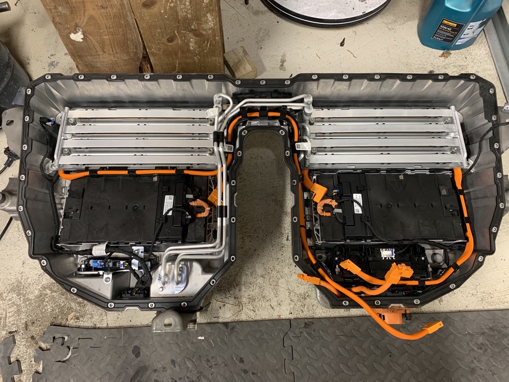

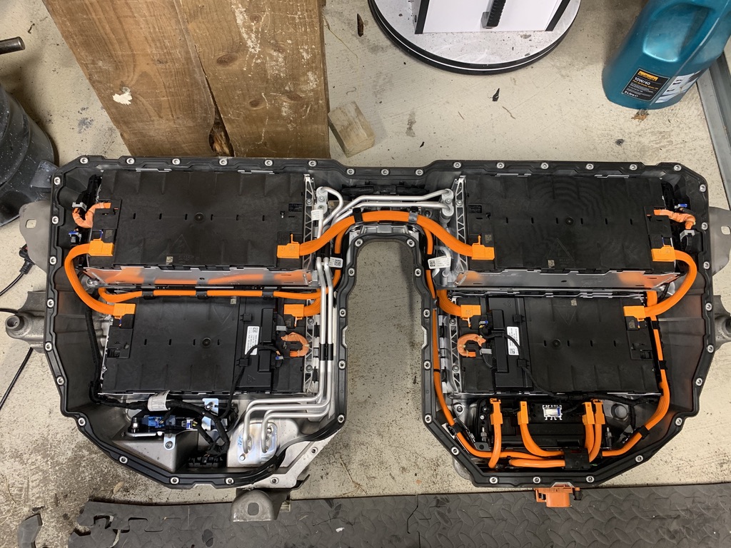

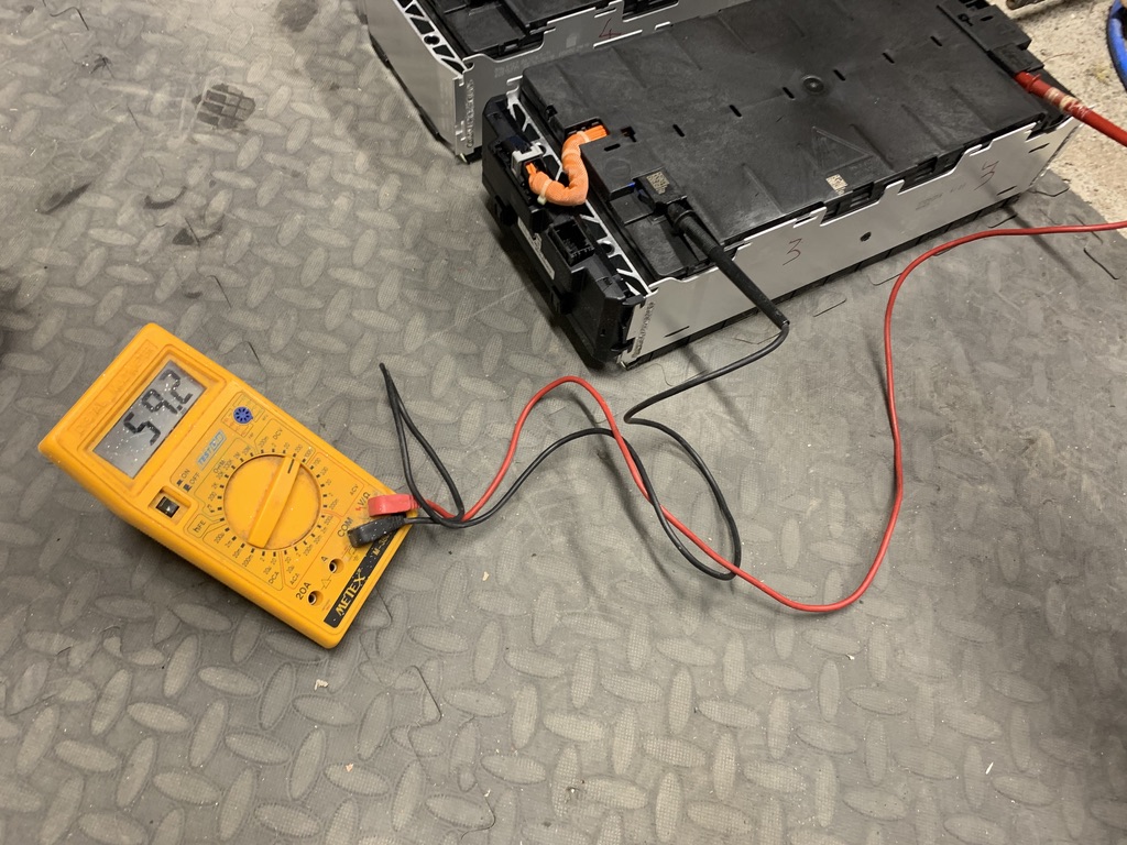

I'm now in possession of one of the BMW saddle-bag packs. ~9kWh capacity.
My Auris/Yaris board from Damien has arrived. So, I have some soldering to do.

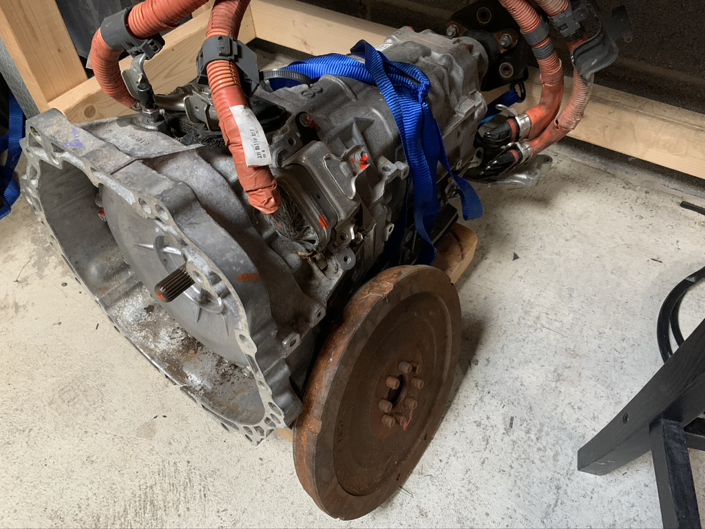

I've also acquired the CVT from a 2015 Lexus GS300h. I'm taking a bit of a gamble on this. These have no external oil pump, so I have to figure out how the oil pump is set up internally. I'll be opening this up over the weekend.
I've also got myself some Kilovac contactors, some precharge resistors, a BMW accelerator pedal, and some fuses. So, all the bits are coming together.Christian

I've been busy spilling transmission fluid all over the place today. To have a look at what's going on inside this GS300h CVT
L210 thread for a bit more info on that. I've not quite decided whether to run MG1 and MG2, or to do charging with the inverter. I'm leaning slightly toward using MG1+MG2 for more muscle

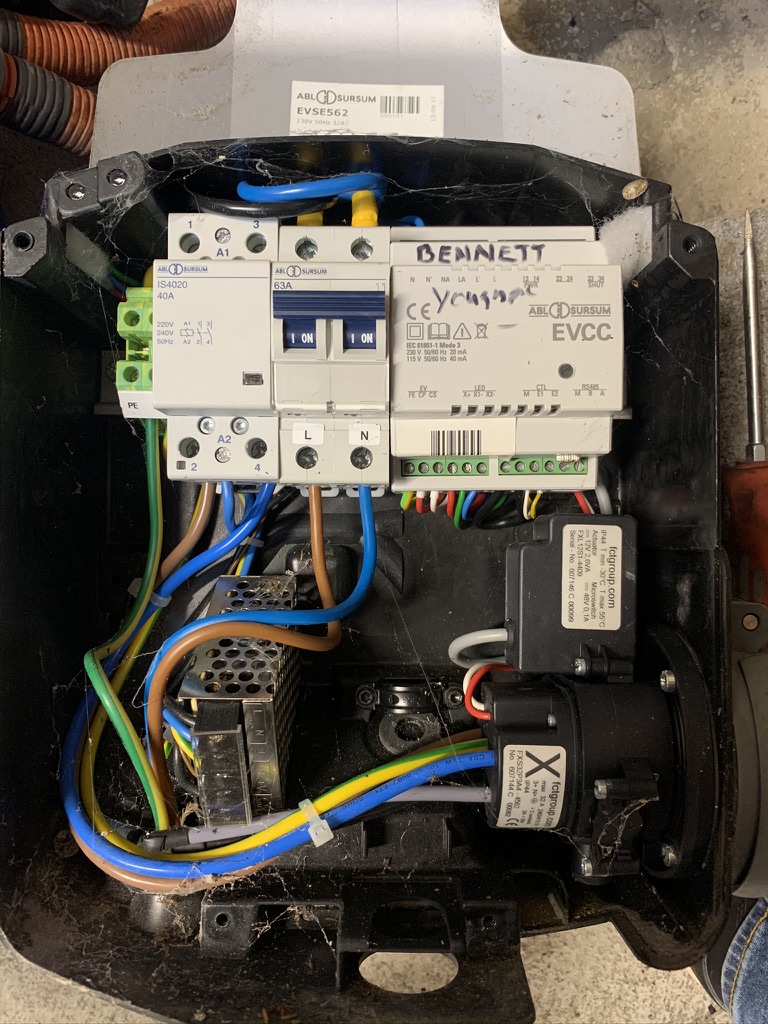

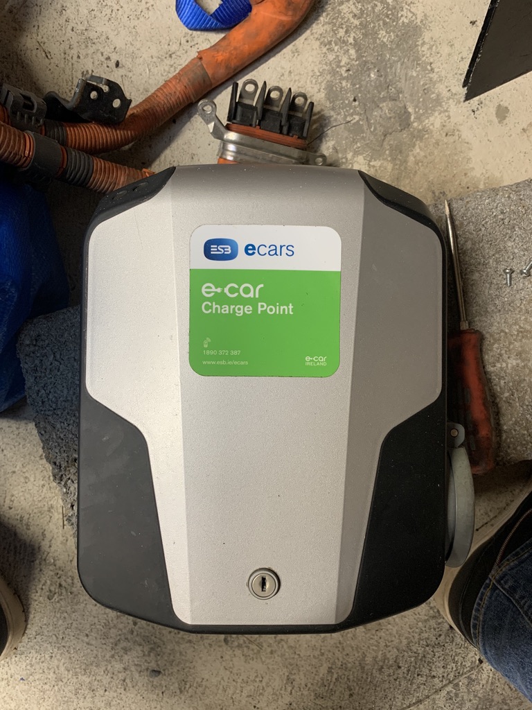

I also bought this wall charger thing secondhand on a whim. It's an ABL EVSE562. Apparently it's 3.7kw. It didn't come with a key, but 5 minutes with the lock pick kit and I had it open Single phase only, of course - it's a domestic unit.
Inside it has:
I need to think it over a bit more and check my logic, but it looks like I can use this CVT. Check out the I started to solder my inverter board from evbmw, but chickened out. My soldering iron is crap, and the solder I had on hand was crappier, so, rather than screw up at this relatively early hurdle, I got a local phone repair place to do the soldering for me. Buuuuut, it looks like the little 50 pin connector is on backwards. That one is on me though. I had started to solder this connector on before bottling it. So the guy just followed my lead. Anyway, looking at the plug I'm thinking of just taking a scalpel and shaving off the little notch pieces. The plug/socket seem otherwise symmetrical and there are catches on the side to hold it in place. So, it looks like it will be OK.
Inside it has:
- 63A MCB
- ABL IS4020 - looks to be a contractor. Here is the 4 pole version
- ABL EVCC 16A, mode 3. This lines up with the 3.7kw rating provided by the seller. Although, I see some suggestions online that it can be re-flashed to do 32A.
- A little circuit board in a shielded cage.
- Type 2 port on the side
- Lots of dead bugs

Did some more puzzling over the GS300h CVT today, see the L210 thread for more info.
Also started breaking down the BMW battery pack.
