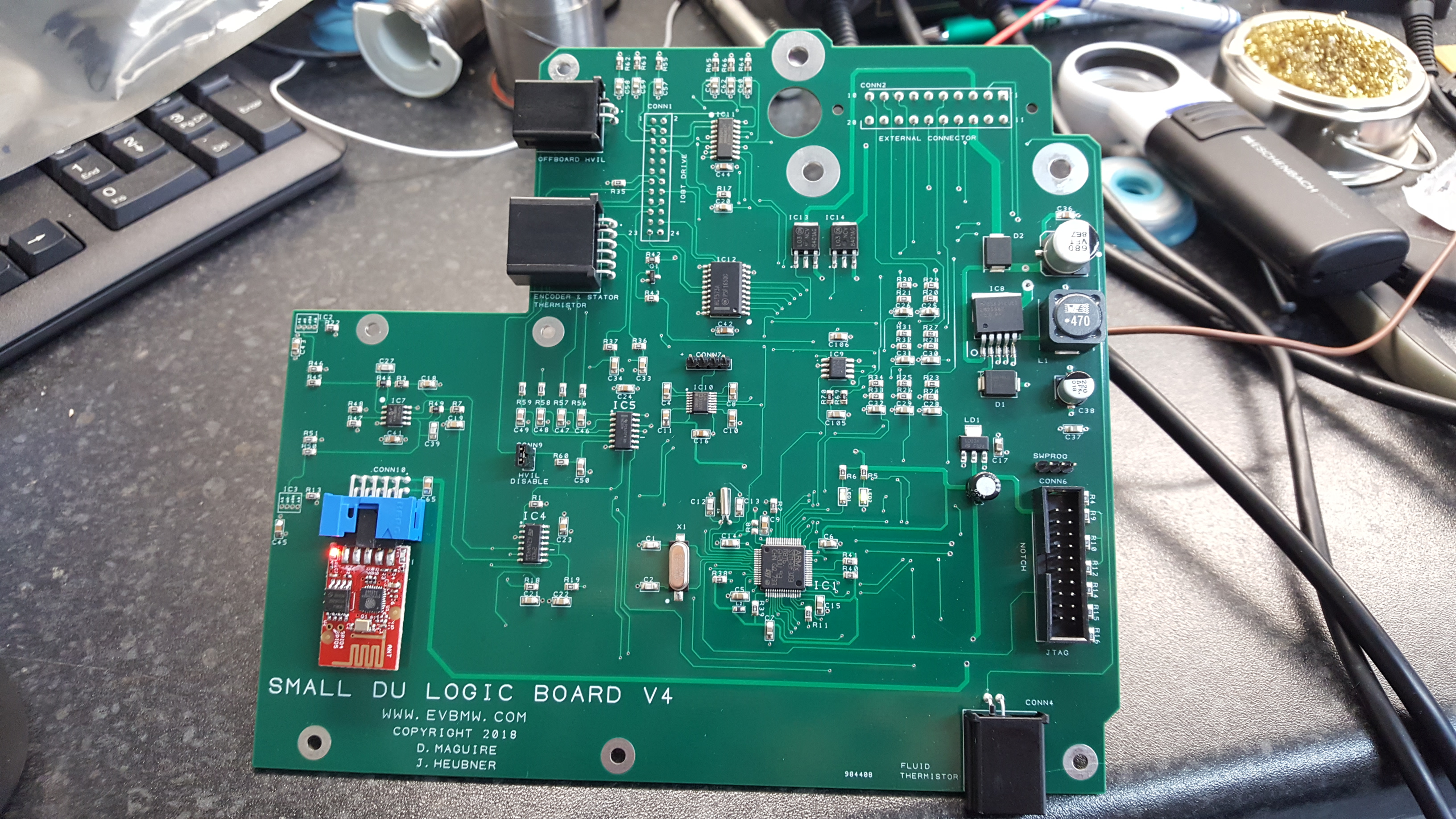

Setting up a support thread for the open source small drive unit control board.
Built and Tested boards available from the webshop :
https://openinverter.org/shop/index.php ... duct_id=62

I'm still working on the 944 conversion. I need to put some regen (as the brakes are 1982 standard) and to help with the consuption.
So the setup was : E46 throtle pedal wired to Pot1 and pot mode set as single regen.
I would expect some regen as i let of the throttle (with regen parameters set to default values) but i didn't get any.
So i thought that i needed a second pot for the regen (or a redondant one) so i've put the pot1 signal to pot2 aswell.
Changed the default values of pot2min and pot2max to be the same as potmin and pot max, and still no regen
so i reversed the values pot2min and pot2max and still no regen.
So i moved the values of potmin, pot2min, potmax and pot2max up and down and still nothing.
So what am i doing wrong ?

- Posts: 3563
- Been thanked: 87 times
Re: Tesla Small Drive Unit Support Thread
Please download and post your parameter file.
- Posts: 78
- Location: France
Here you go
- params(2).json
- (1.29 KiB) Downloaded 192 times
- Posts: 3563
try this :
"brknompedal": -20,
"brkpedalramp": 5,
"brknom": 30,
"brkmax": 15,
"brkrampstr": 10,
"brkout": -50,
The one thing I spotted is a negative sign on brkmax.
"brknompedal": -20,
"brkpedalramp": 5,
"brknom": 30,
"brkmax": 15,
"brkrampstr": 10,
"brkout": -50,

If regen does not apear make sure 'speedkp' is not set to '0' this does interfere with regen, might be fixed but on most cars this fixed the absence of regen.
- Posts: 78
- Location: France
Thanks a lot guys, it worked !
It appears that the bug with 'speedkp' is not fixed. I did put it to 1 and it worked perfectly. The car is totaly different now.
- Posts: 3563
Excellent Even I didn't know about that.
