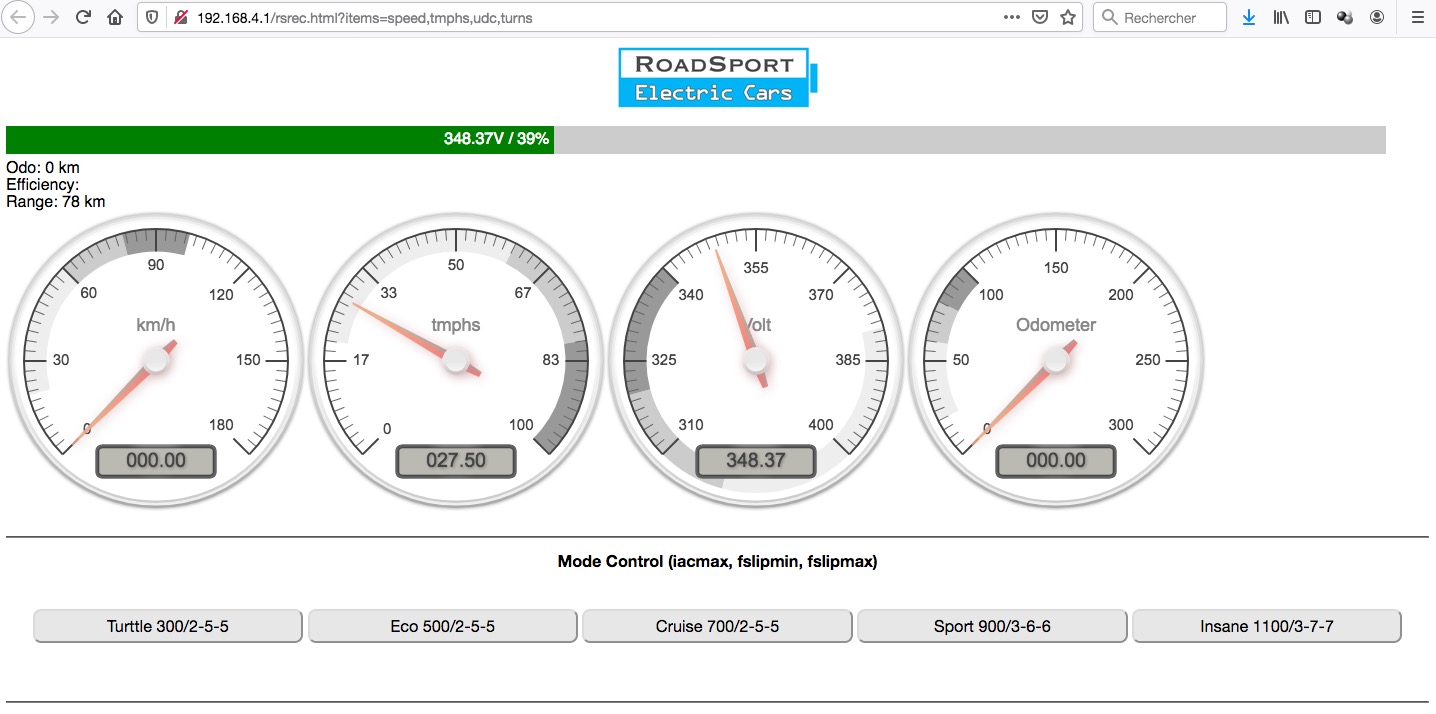

Hello Johannes,
is it possible to update and/or upload other files to the esp8266.
I'm thinking of an enhanced "gauges.html" with custom buttons for drive modes and regen modes. And a SOC bargraph as well instead of the udc gauge.

ManuFromParis
Posts: 34
Joined: Sat Feb 15, 2020 6:34 pm
Location: Near Paris
Re: Gauge Update
Post by ManuFromParis »
dima wrote: Thu Sep 03, 2020 1:23 am
ManuFromParis wrote: Tue Sep 01, 2020 8:20 pm Thanks, I'm now going to go crazy !
:D
If interested there is already a good "crazy" starting point here -> https://github.com/dimecho/Open-Inverter-Dashboard
Thanks, I am waiting for custom CAN gauges, so meanwhile I had a draft written, to display main data and shortcut buttons to modify several parameters at once.
It's now uploaded, with customized copies of gauges.js and inverter.js
Basic but efficient display. Odo is based on "turns" but this value still needs to be tuned to real distances. At least I'll have computed data on efficiency (or battery discharge VS actual distance since start)
I am also working on an more elaborated algorithm to compute the remaining range in km, based on a sample of SOCs values during several runs.
To proceed on this algorithm, I shall need a way to store text values in a file. Anyone knows how that could be achieved ?
Maybe I can use this logging stream, emulating Johannes' log js script :
viewtopic.php?f=5&t=127#p1048
