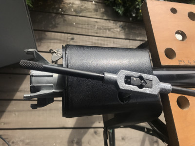

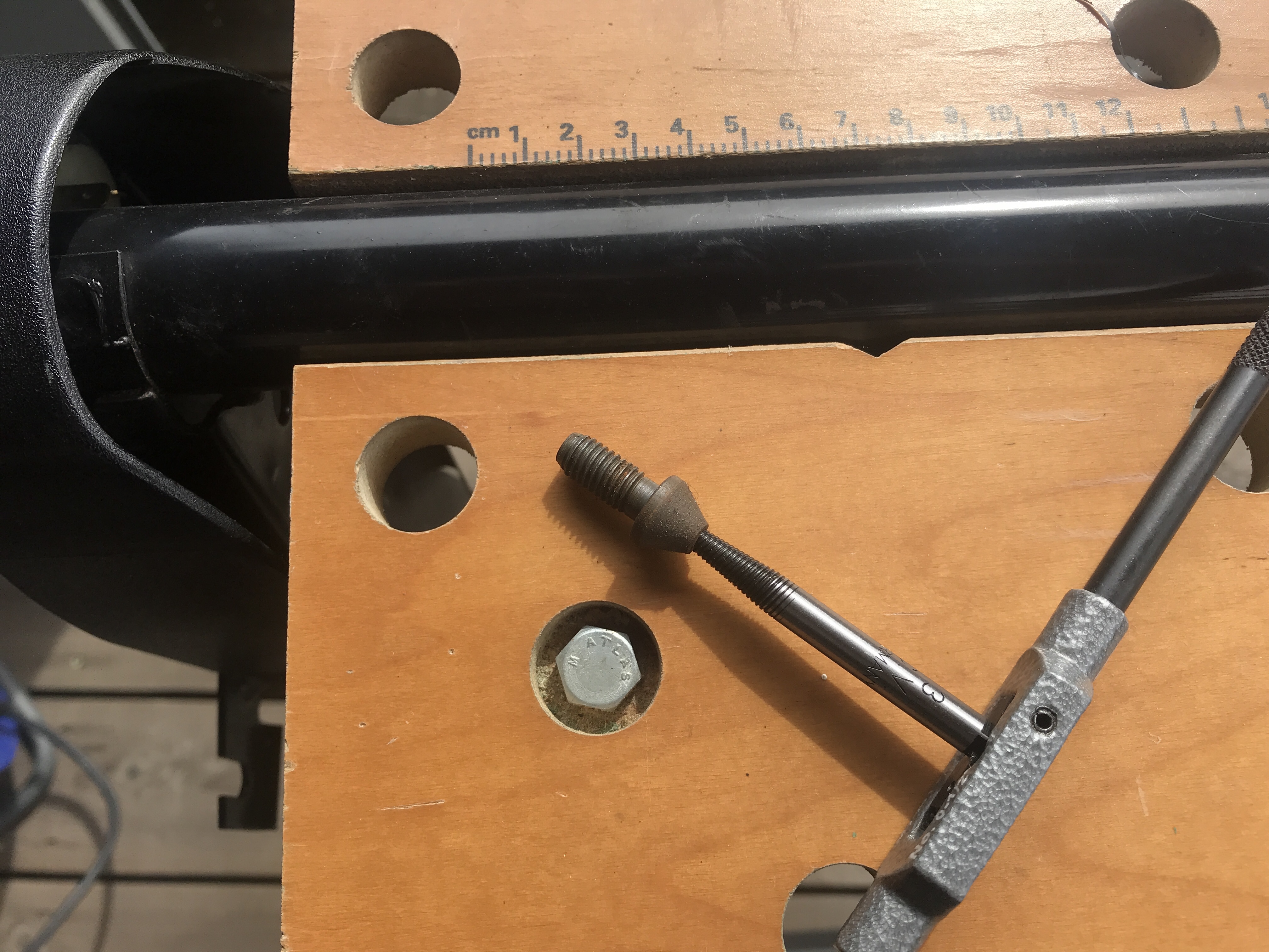

So I removed the ignition barrel on Tuesday with the extra excitement of having to remove the airbag - to be able to remove the steering wheel - to be able to remove wiper and indicator switch - to be able to remove the steering assembly ECU - to be able to remove the ignition barrel
Found some good youtube videos on that. Of course the ignition barrel is bolted on with screws that sheer of their head when mounted to make it harder to remove. But with a fresh chisel they can be given the initial turn and then come out easily.
Of course the official key cylinder removal technique doesn't work: turn the key like 80% and then get in there with a paper clip. Well if the key only turns 30%... I used a cutting disk instead.
So now I'm waiting for the new ignition barrel, put the original key cylinder in that and put everything back together. With normal screws!

I have one of those headless screws on my T2. I bought a set of "easy-out" extractors this week... Wish me luck.

A rare example of an EZ-out actually working!
Left handed drill bits are much less likely to snap off and make the extraction even harder.

Yes bought one of these tools as well but before it arrived here I had the screws out with the chisel. Which is good, because my Makita doesn't quite fit in the confined space.

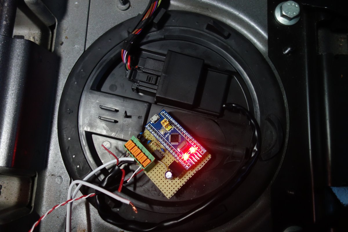

Now as temperatures swing a lot between morning and afternoon I found a small issue with the way I operate the fuel gauge. Basically it is run with 2 NPN transistors that simulate a varying resistance. When they both simulate, say 50 Ohms the gauge is in the middle. If one simulates 25 and the other 75 Ohms it would be at 25%. The gauge cluster expects some 100 Ohms total and there is an adaption channel to set this up to 130 Ohms. In other words, it is a bit sensitive when total resistances deviates from 100 Ohm.
And thats exactly what happens when the temperature of the transistors changes
So say you calibrate this to work at 10°C ambient the gauge will detect a value out of range at like 30 or 40°C ambient and will not move! I faintly remember this is usually solved with some 10 Ohm resistor between emitter and GND. Would this work here? the chain is like STM32 PWM -> 10k -> 1u to GND -> transistor base.
Or otherwise I could vary the two relevant parameters with temperature...
I had similar problems with gauges.
I solved it with using the original driver electronics, it should come from a microprocessor or something similar.
Maybe 5V/3.3V PWM

Do you have a schematic of the fuel level sender connected to the cluster? Is the sender a 100 ohm pot with one end and the wiper connected to the cluster (2 wires)?
- Been thanked: 1918 times
The "gas tank measuring thing" is just a pot. The wiper is grounded and the two ends are connected to the gauge cluster.
The pot is connected to a controller and that controller is connected to the gauge cluster. I'm thinking all it used to do was switching the fuel pump on and off. See attachment.

It sounds like you need some feedback to measure the current each transistor draws and correct your pulse width to compensate. The gauge expects to see a certain currrent range depending on the resistance. You could use a small resistor on the emitter like you say, to measure the current. There is a downside that this gives a minimum effective resistance (when the transistor is on 100% of the time) of say 10 ohms, so your gauge will never read completely full or empty.
Yes will try that. I described a bit wrong. In fact the middle duty cycle is 1250/4096 and 1.8 digits are added for each % SoC. So minimum value is 1250-50*1,8 and max is 1340 digits accordingly. So full on PWM isn't nearly needed. I hope the negative feedback of the emitter resistor is sufficient for compensation. Higher current -> higher voltage drop accross resistor -> higher emitter voltage -> lower base-emitter voltage.DaveH wrote: ↑Wed Sep 02, 2020 1:15 pm It sounds like you need some feedback to measure the current each transistor draws and correct your pulse width to compensate. The gauge expects to see a certain currrent range depending on the resistance. You could use a small resistor on the emitter like you say, to measure the current. There is a downside that this gives a minimum effective resistance (when the transistor is on 100% of the time) of say 10 ohms, so your gauge will never read completely full or empty.
It's already there in the stm32-car project.

You might need to reduce your base resistor to get enough base current, but as long as the base is > 0.7V higher than the emitter when your PWM output is high, it will work.
