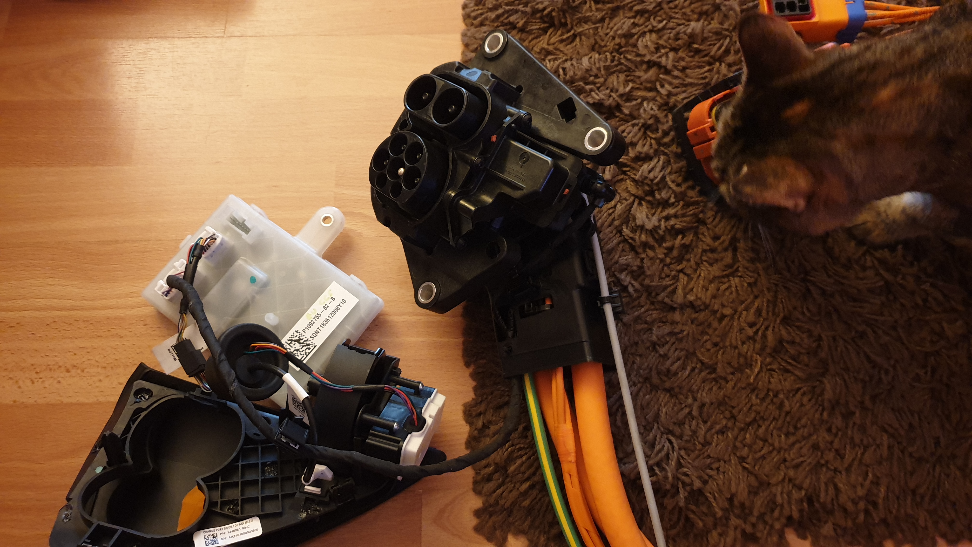

So it turns out that the single bolt holding in the CP ECU is really easy to remove.
So I did, and swapped the existing port / door with the eBay one. Because otherwise it's impossible to contort the assembly to fit in any way other than the correct way.
I did some tests with that and figure out this much:
* There's verification on voltages between the wall charger and the onboard charger - as it sits in "blinking blue" when it should switch to blinking green as the cable wasn't exactly connected to anything.
* It will sit in a "scheduled charge" mode just fine, so I'm going to try and reproduce that on the bench.
I also logged switching from scheduled charge to on-demand charge to see what it does. I also logged the car going to sleep (which required me to turn off bluetooth on my phone, ensure everything was closed, and turn off Teslafi), and then a wake-up about 30 minutes later.
I thought I had a cold-start solution on the bench, but when I refactored code to be less awful, not so much.
I can't wait to share a clip of my multimeter showing 120VAC on the end of the cable
-Matt

:: sigh ::
Great news and terrible news.
Great news: playback of such sessions does what I expect, and things go about their business.
Terrible news: this works only on the ECU from the car.
I haven't tried it yet, but I think I could get my Arduino code working with the ECU from the car.
Now I need to troll the Internet for other HV / Charge port bus logs. I just looked at Damien's github for the PCS..I think HVcon_onown_poweron_off.csv is the file I'm interested in, but I'm not 100% sure.
-Matt

On some non-charge port items:
Finally got all of the connectors in for the ISA shunt: I can definitely whip up a kit of connectors for $8 + shipping for those in the US. The place Jon sent me toward not only had the kit listed at $33, there was a "minimum order" of $35, and THEN $10 shipping on top of that. I think I can send via US mail for like $4 so..$12.
I also started on determining the wiring for the Volt BMS modules, like so: It's not entirely done yet, but it should allow me to wire up module 4 and see how that's going. I'll probably wire that up tomorrow.
Other than that, I took out both the 330 and the M3 recently, both desperately needed air in the tires.
I need to buy some more connectors of the 12 pin type as I bought 10 of each keying, and, well, I don't have enough for the 12 pin keying.
I'm also going to try and find the connectors for the charge port, mating connectors, an EEPROM...all sorts of fun stuff to play with.
I need to figure out the best way to wire up the batteries for testing.
So much to do.
-Matt

Wired the SimpBMS. Tom fixed the Coda charger issue. Yay.
But, it does not see any of the slave boards.
My floor matches my feelings.
-Matt
-Matt

Wait buddy, you only 1/3 way there. Power for the HV side is derrived from the HV side.....
- mdrobnak
- Posts: 692
- Been thanked: 5 times
Re: 2004 BMW 330 with SMG/SSG Gearbox
HAHA don't I feel dumb.
What's the 5V on them used for, then? Is there a most-positive pin line a most-negative pin, as well? Or just most-negative + cell 1-6/12?
I'll finish wiring up the first connector and try again.
-Matt
