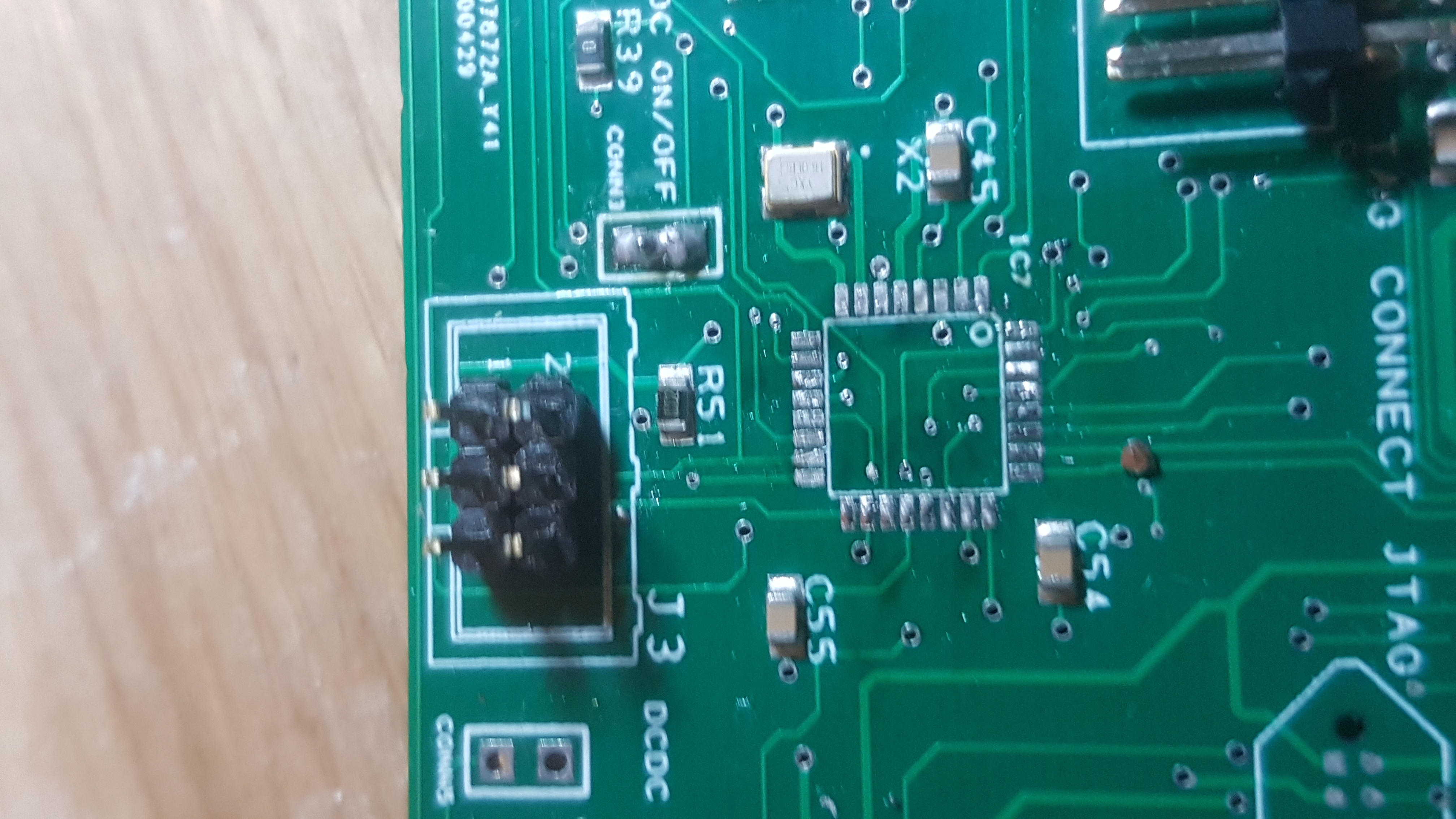

I'm still not having any joy programming the 328 via the ICSP header. @PatrykS did you say you had it working with USBasp and this board?
If anyone else has a minute I'd appreciate it if you could test it and see what you get. Do you at least get a device signature back when trying to program it with an Arduino or USBasp? I've tried it rewiring it and still get 0x000000.

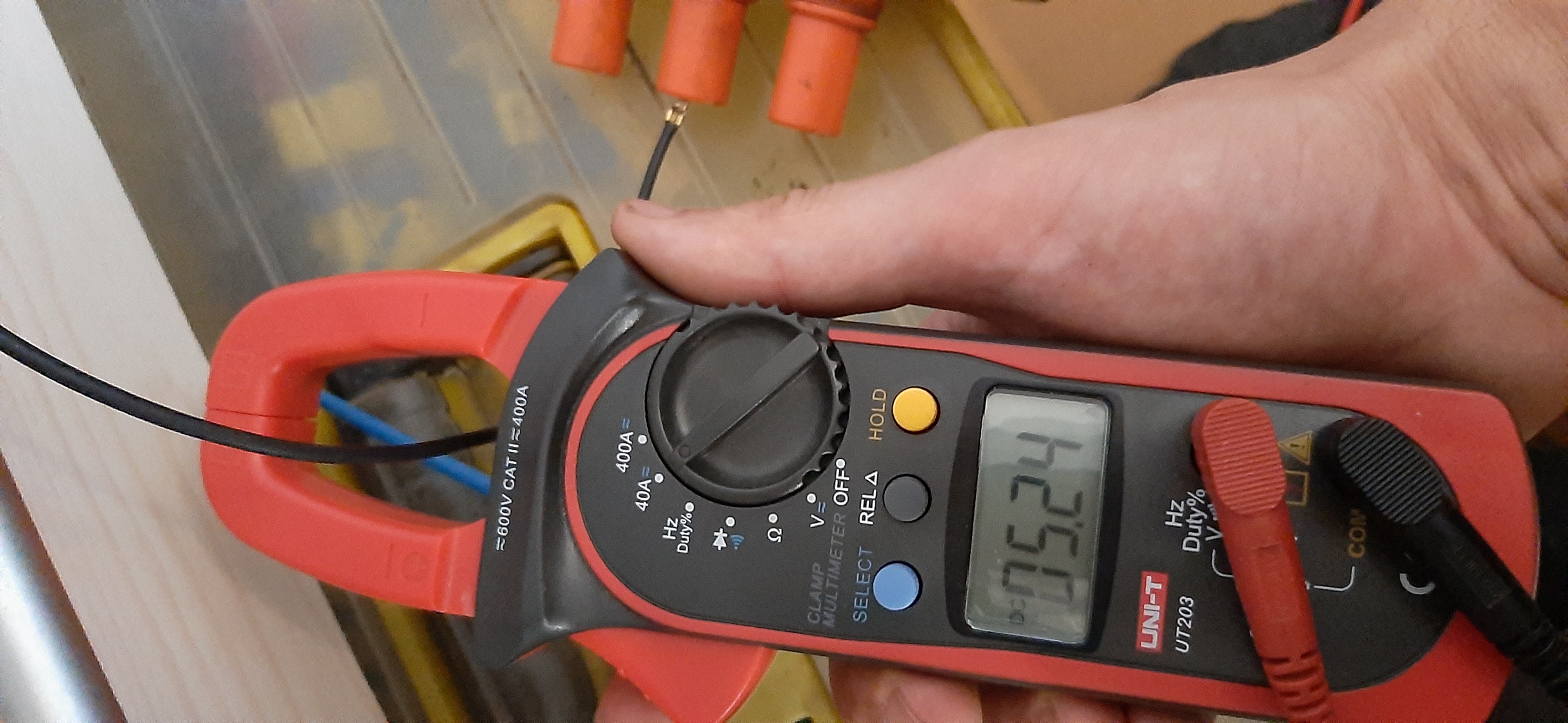

After testing smoked board with sine software to make sure it works, I've calibrated current sensors. Did it with power supply, 50w light bulb and clamp multimeter. Despite it is cheap multimeter, I guess mistake of ±0,5A is acceptable. The only thing that bothers me is those ±20A current peaks:
Could it be caused by light bulb or bad contact? Power supply is Eltek smps 1000, it is really accurate and sturdy, so current peaks are not caused by it.
il1 and il2 gain set to 3,59 in my case.
No, I used USBasp with another AVR boards (Arduino between others).bobby_come_lately wrote: ↑Sat Aug 08, 2020 6:31 amI'm still not having any joy programming the 328 via the ICSP header. @PatrykS did you say you had it working with USBasp and this board?

For me, on the Yaris board, my chinese USBasp worked right away with zero issues whatsoever. I think I programmed the Nano bootloader, but that shouldn't matter. You should definitely be getting back a valid device signature regardless of almost any parameters you can set in the Arduino IDE or avrdude. Have you checked continuity from each of the ISP connector pins to the atmega328 pins? Do you have correct voltage at the VCC pin? Is your USBasp able to program other boards?bobby_come_lately wrote: ↑Sat Aug 08, 2020 6:31 am I'm still not having any joy programming the 328 via the ICSP header. @PatrykS did you say you had it working with USBasp and this board?

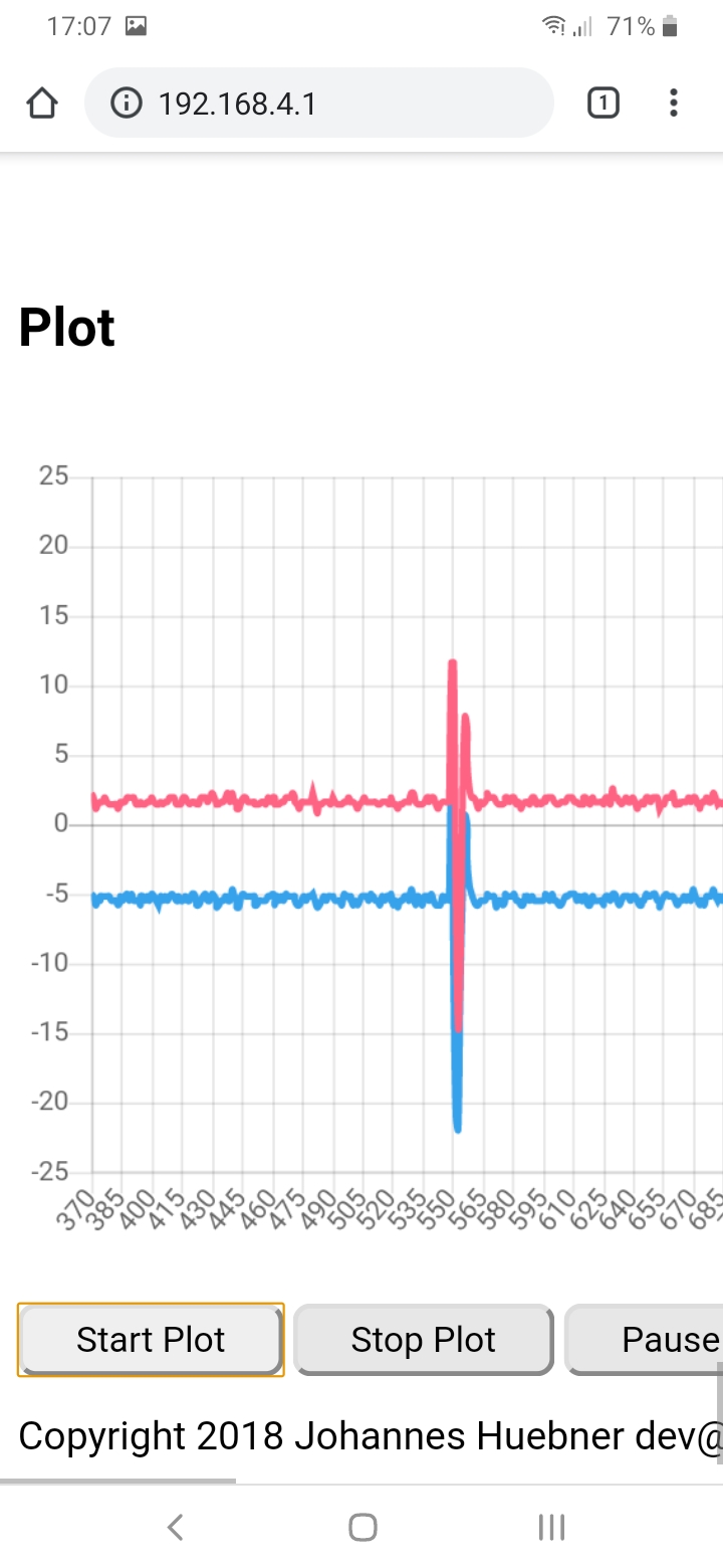

I've made first progerss with FOC software and Lexus MGR Q211.
MY PROCEDURE:
1)Calibrated il1, il2, udc.
2) Make sure resolver is set as "resolver", respolepairs i've sat as 1, and when turn output schaft by hand I've seen this picture: 2)Started inverter with push botton, chose forward direction, then pressed "manual mode" in web interface.
3)syncofs is 0, and started to add manualid, motor startedd to jitter, and started to somehow spin only with manualid at 70A
my battery can only provide 170A, does this mean that I have not reach rated_motor_current/2, or it has nothing common with my battery pack and only represent motor parameters? Who knows any info about Lexus MGR Q211?
QUESTION: what is considered as rated_motor_current? for Lexus RX400h MGR for example, as it is rated 50kW at maximum 650V.
So, anyway, MGR listens to gas pedal
It jitters, but spins.
It became more smooth when I've set polepairs and respolepaisr to 3... aand then Toyota engineers broke the party, they said it was too hot in there

The motor current is not the same as the battery current, at standstill or with low frequency the motor current is mutch higher than the battery current. You have a low voltage and hight current at the motor, as it works like a buck converter.
For the resolver of the MGR I used polpairs=4 and respolpairs=2 that should be the right value, it works althougt with polpairs=2 and respolpairs=1, then will be the revcounter wrong, but it works.
ManualID should be high if syncofs is OK, as told in the software setup. I expect 70A as rated motor current will be fine. As higher the manualid value to rotate the motor is, as nearer it is on the optimal point. With the right connection to the motor my value for syncofs was around 0 so it should be fine.
In the next step you should change manualid = 0.1 and test with a low value for manualiq.
