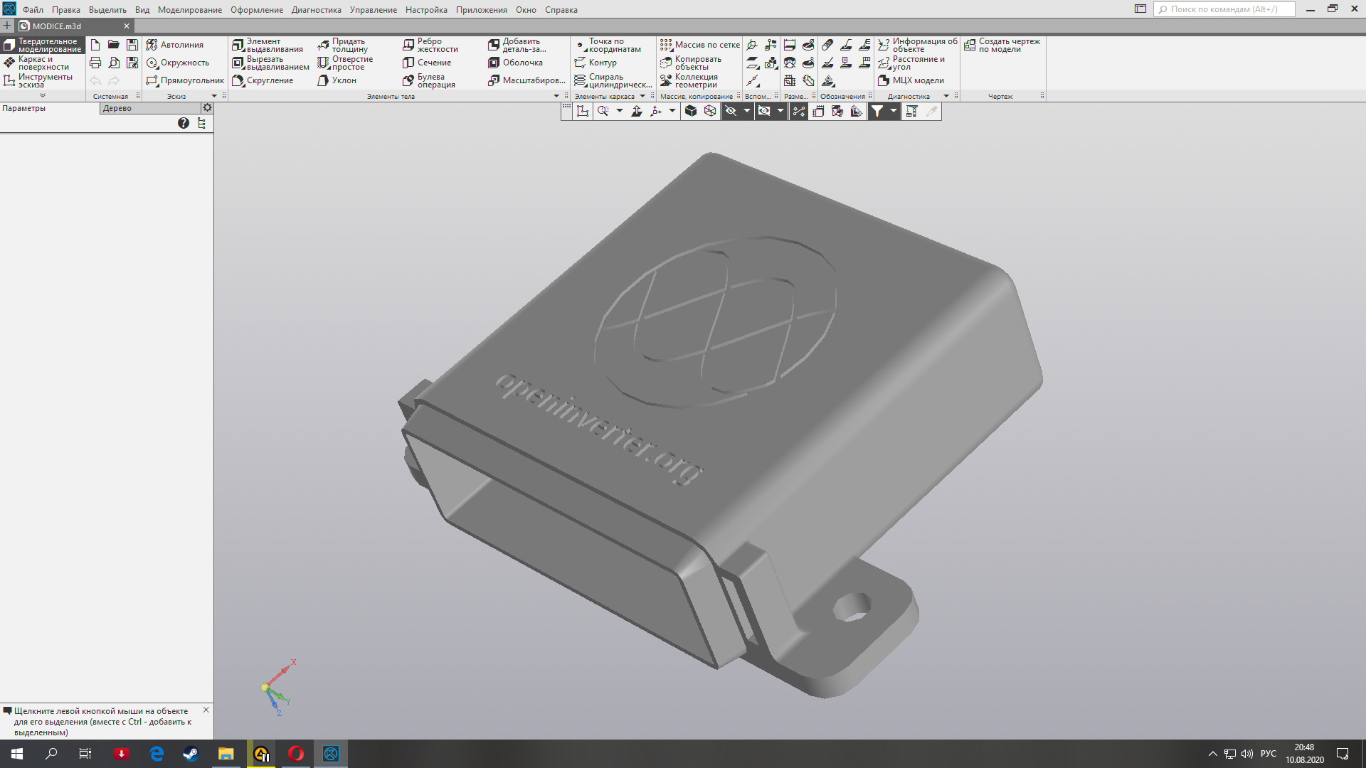

One kind sir sent me this board for further experiments
Set was a little incomplete, if I can say so. 12way connector was being found on RS components, but modice enclosure was not available.
So I designed my own. Will order 3D printing from transparent plastic as soon as this sh!tshow in Minsk is over...
