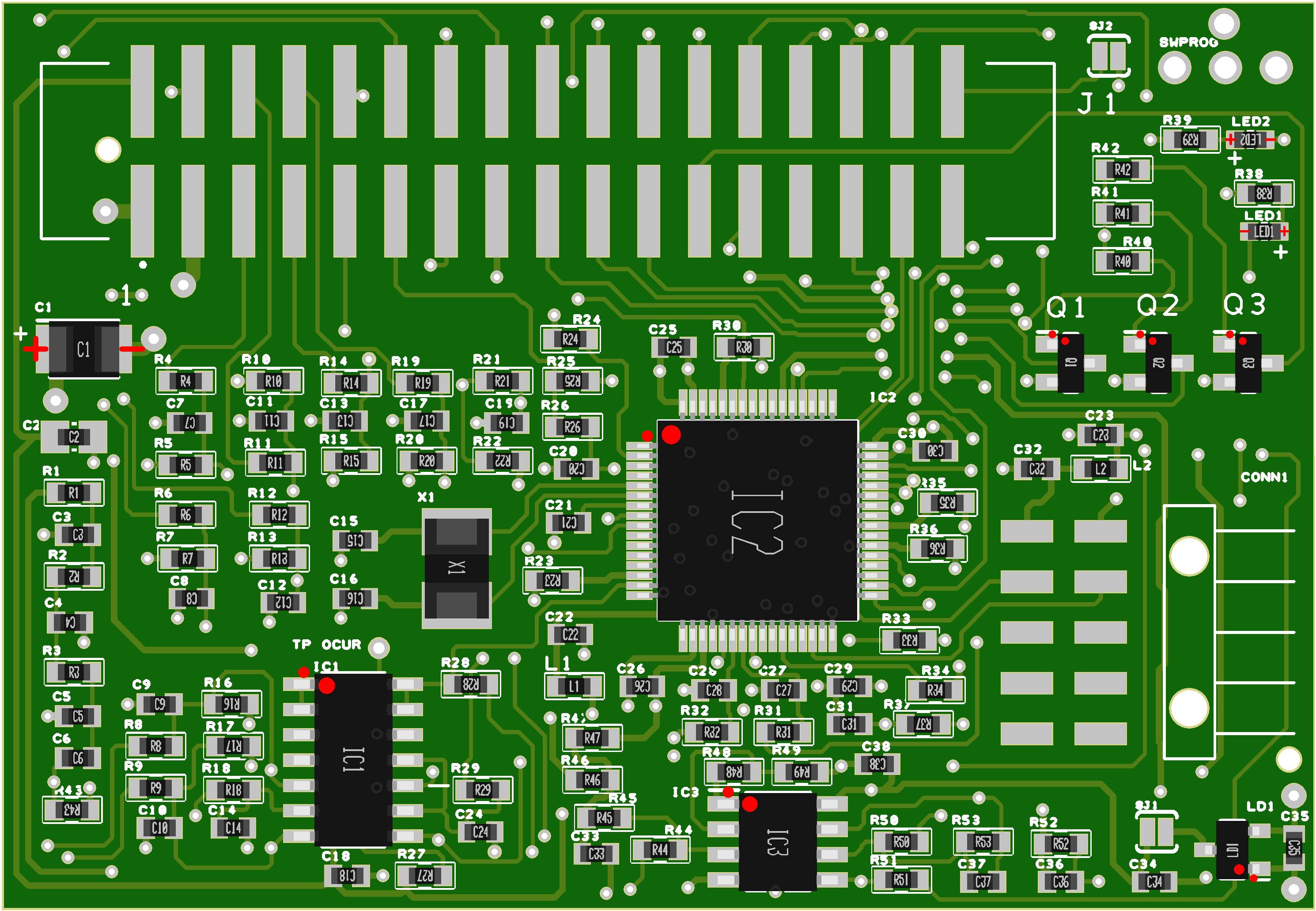

Of course you can have one:) Will be on sale soon all going well :
https://www.evbmw.com/index.php/evbmw-w ... u-modboard

Just arrived:)

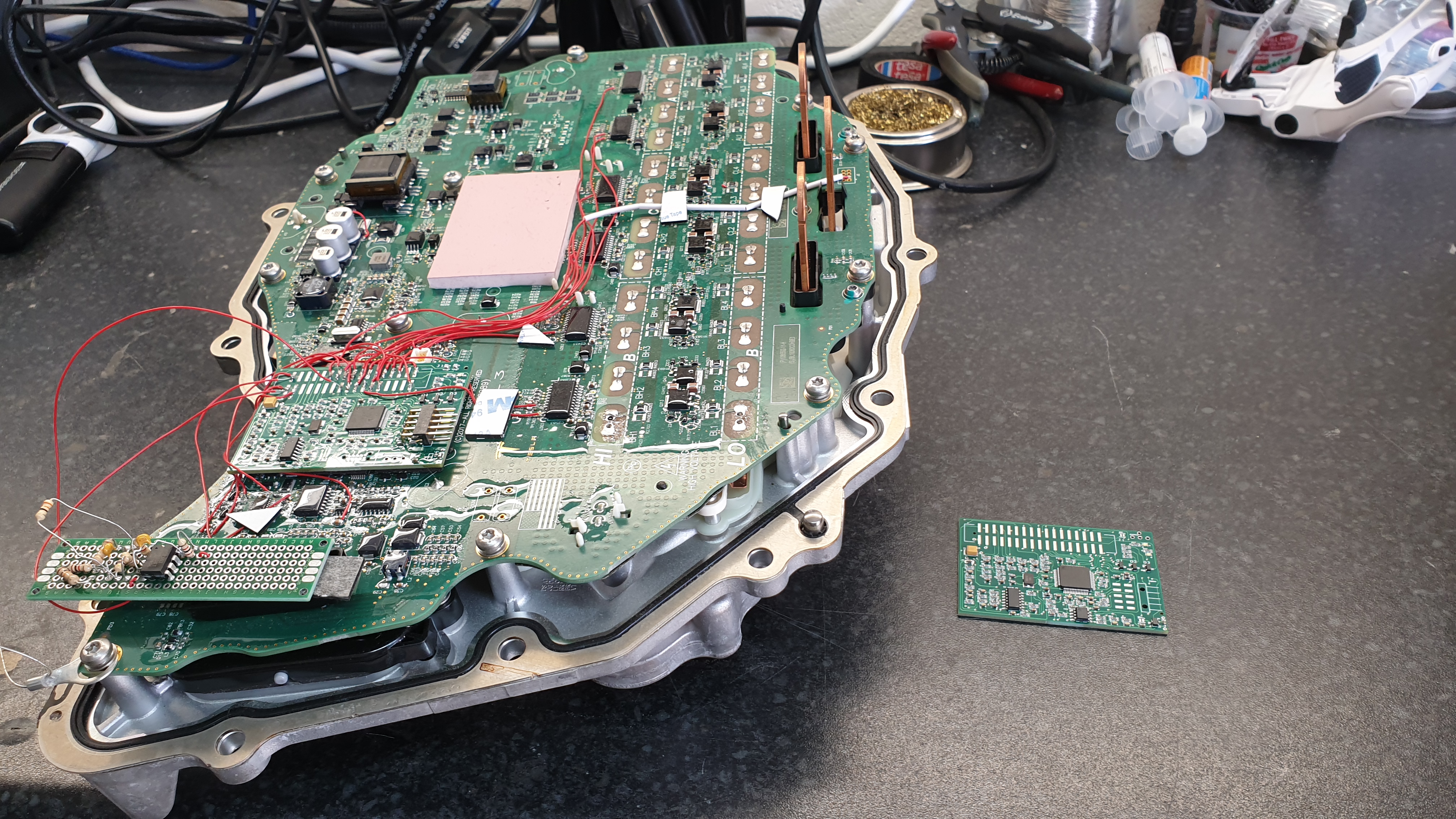

Finally back at the M3 rear du. Time to swap out the old V1 modboard for the V2 and see if we can run closed loop with the inverter back on the drive unit:)
Posts: 4000
Been thanked: 1117 times
Also since I've been away seems this guy has had some major success :)
Posts: 4000
Good news is the V2 modboard resolver circuit is working perfectly. We are now driving the original Tesla amp and reading back via their filter. BAd news is it seems my current sensor signs are flipped so no foc tuning today.
