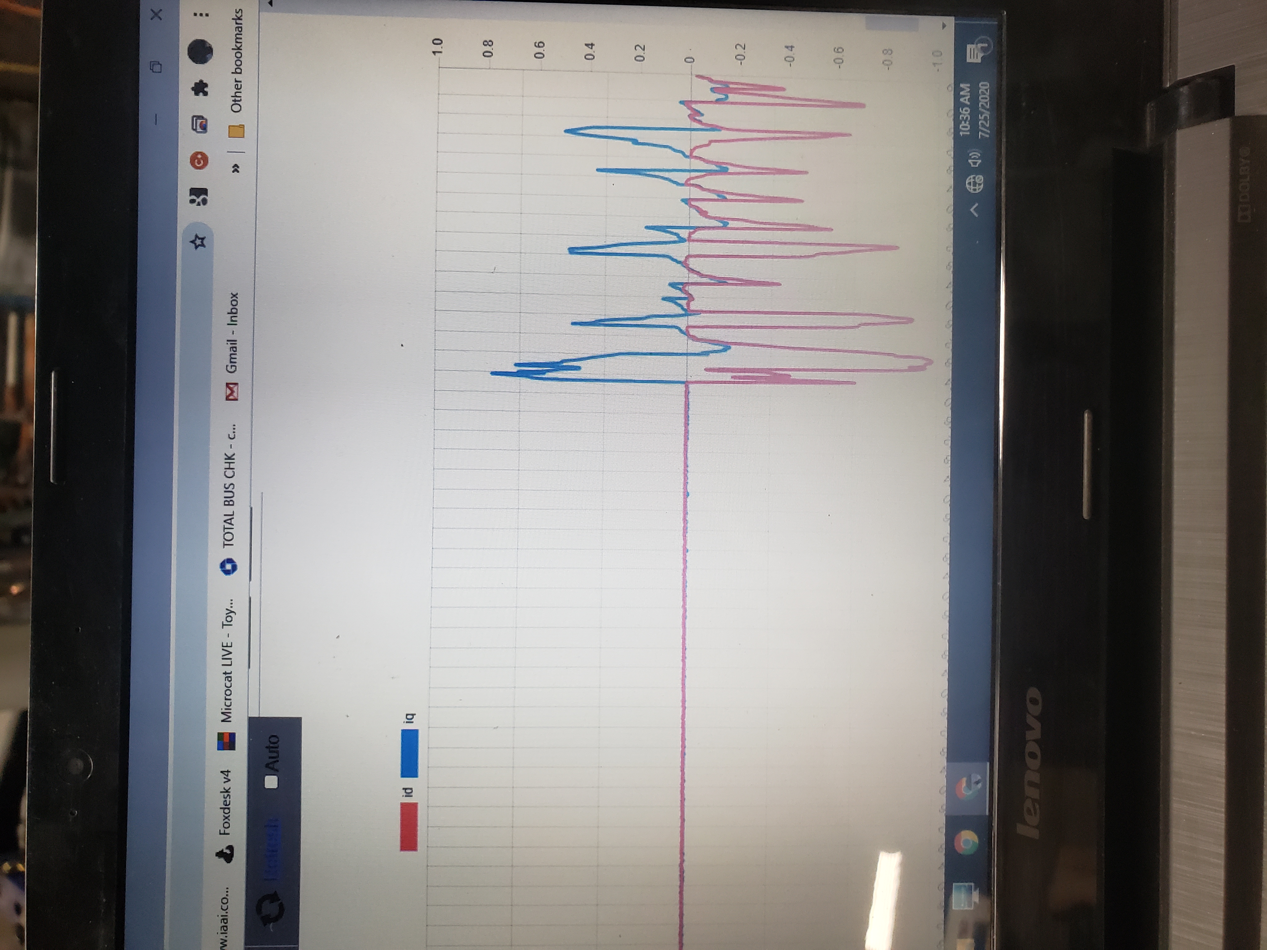

Post by imwoody36 »
this is id and iq when this was going on
for what it is worth
the priustoric boatcar guy

Do the wires with smoke coming off of them feel hot (measure with volts off, and caps discharged)?
Posts: 3661
Has thanked: 10 times
Been thanked: 335 times
Have you done the foc tuning procedure? If not you are probably causing id and iq to fight hence the heating.

I am struggling with the FOC tuning... actually melted what might have been an already damaged field winding.
another motor and im back to playing with throttle without manual inverter" on "mode.
should the current be in phase, out of phase, or 120 degrees apart for Il1 and il2

I don't have a Gen2 inverter, but when testing the pinswap function in FOC software I had a similar result if the polarity of the current measurement was wrong.
I think there is a contribution that in the first Gen2 boards there is an error with the polarity of the current measurement reversed and Johannes therefore introduced the parameter pinswap.
With the wrong polarity, the engine turned after starting even at maximum speed and could not be regulated, the lines also got hot.
In manual mode it should be possible to regulate the current, if the polarity is wrong you could not regulate the current, because the limit will not reach.

imwoody36, did you calibrate the current sensors?
imwoody36
Posts: 92
Joined: Fri May 01, 2020 2:20 pm
Location: Scottsburg Indiana
Post by imwoody36 »
Jack Bauer wrote: Mon Jul 27, 2020 6:55 am imwoody36, did you calibrate the current sensors?
um..no..how does one go about doing that?
this is the first time I have heard of that
