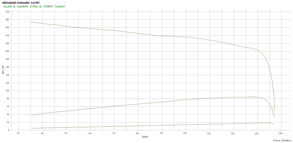

I've just had a closer look at this dyno graph tucked away in another thread here and it lists the torque as starting at 277nm and dropping to 195nm max ev speed of 135kph, 84mph. The rpm on this graph is clearly garbage and I've compensated for that using the standard issue wheel diameter and transaxle reduction gear to 277nm @ 1780rpm and 195nm @ 6870rpm. This is consistent with the max rpm of the motor of ~9000rpm and the max speed of the outlander listed as 110mph.
Not sure how seriously to take the torque readings from this source as they are selling a performance enhancing module and probably prone to exaggerating.
