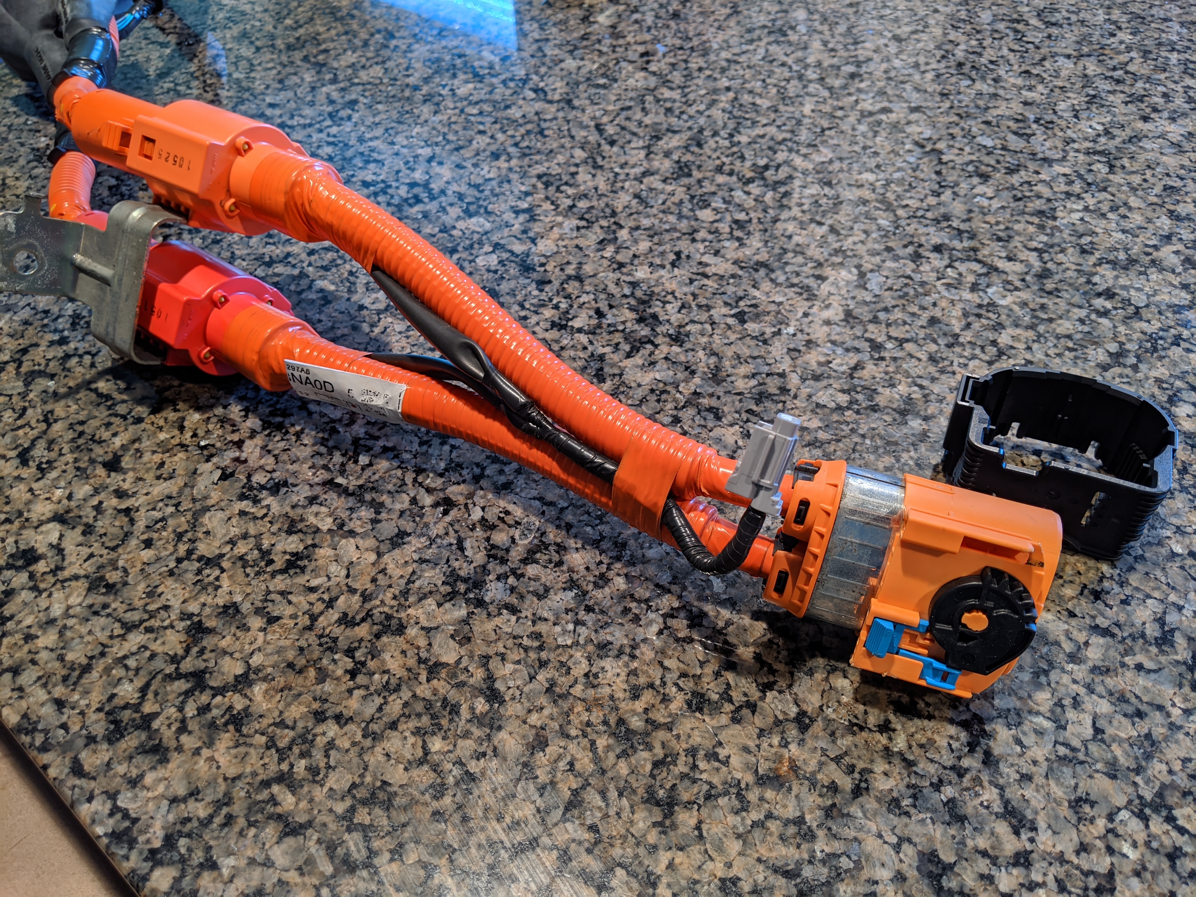

Other items of note:
I got the CHAdeMO port (along with a J1772 port) from a LEAF.
Seller must sell a bunch of electronics stuff given the amount of times the box was used already. :)
Packaged well.
Dirty as usual.
It got a little broken. You can also see the covering connector which pretty easily came off.
It cleaned up pretty well.
Part number.
I'm looking for the mating connector to this, so I can hook it up to the CHAdeMO cable...
As you can see it fits well enough for a 5 minute test session to log data. Need to figure out how to log the SWCAN side too. (Chademo, SWCAN, Car CAN all at the same time should prove to be fairly illuminating.)
I picked up a US spec charge port controller as well. Need to figure out what connectors to use.
Then it was my birthday on Sunday, so took Monday off and went to the Oregon coast. It was nice.

On the M3 CP ECU front...interesting little beast.
I have it powered up and being angry.
Attempting a replay of a CHAdeMO session ...not so great. It could be because there are no signals from the charge port wiring so it's like F off this isn't real.
Ordered a port + cover: https://www.ebay.com/itm/273925308022
Design is definitely different between S and 3, but in the SAE version (ie NA version) there's still some contactor fun that goes on in order to route the AC and DC to the right destination.
From my limited success so far, it does not seem to generate the fast charge ARBIDs I would have expected.
-Matt

Well if you call throwing bus resets every 5-10 seconds good news, sure. :D
Hopefully once I get the port hooked up it begins to be less angry.

Well, this won't help on the CCS front yet unfortunately. It's a US spec controller, which means no GreenPHY and therefore no CCS. I've got the physically huge Tesla to CHAdeMO adapter, and that's how I logged the session. This is on my Model 3 Performance. The thought here is that:
a) I already have something else using the Tesla connector
b) The port isn't that expensive (you need the cover though - it's part of the HVIL!)
c) I have the CHAdeMO adapter
d) A working CHAdeMO port was about the same price
So why not use a port that is only slightly larger than a J1772 and allows for fast charge as well? If I didn't have a Tesla, I'm not sure I'd go this route. I'd probably buy a CCS port even if I only had J1772 for the moment. (Meta observation: I've gone the way of Apple. Ugh.)
I have some theories as to what is needed to make it go. I also think that too much traffic throws it into a CAN overload mode, which it may or may not recover from. So to confirm things I probably need to hack into the car side connector on my car and see what ARBIDs are being sent to it.
Hopefully this will then allow movement on the CCS side (on that note, I sent a message to the store that had the EU spec controller, but never heard back :(), which I'll probably do on the M3 to validate assumptions.
On another note, anyone need a LEAF J1772 port and cable assembly? :)
-Matt

That's a good point, I should log Telsa AC (SWCAN) vs J1772 AC (Pilot signal only) and see how that differs on CAN data as well. I'd imagine it's a 1 bit change. They should go through very similar motions on the car side. (There's a Model 3 DBC available that has good info, but there's a LOT of IDs which don't exist in it.) I've never seen a car with more CAN data, which isn't surprising.
From a physical perspective, technically if you wanted you could just do the $40 J1772 -> Telsa adapter and you have straight up J1772. So that's still viable if someone wants to go down that road.
