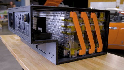

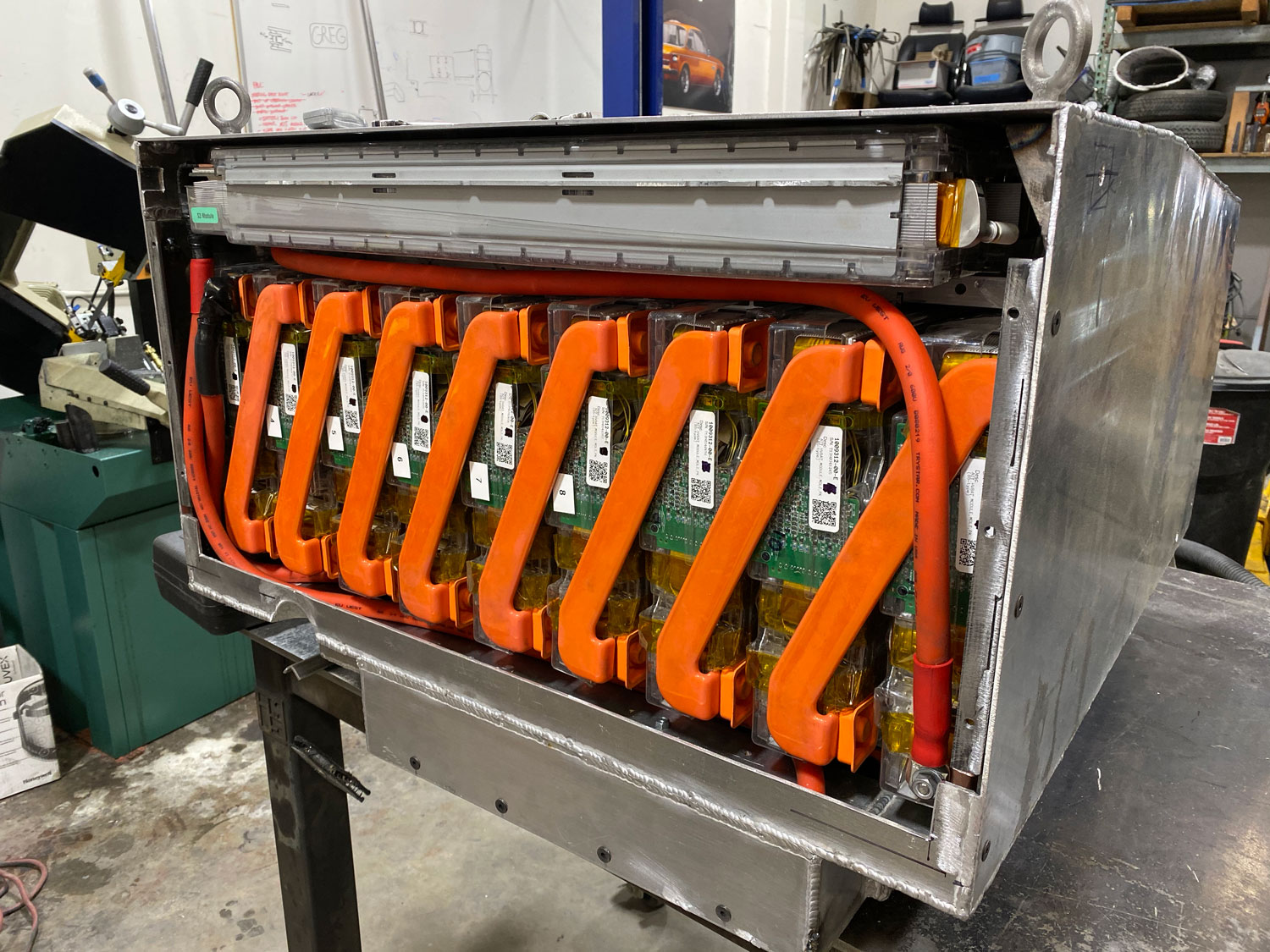

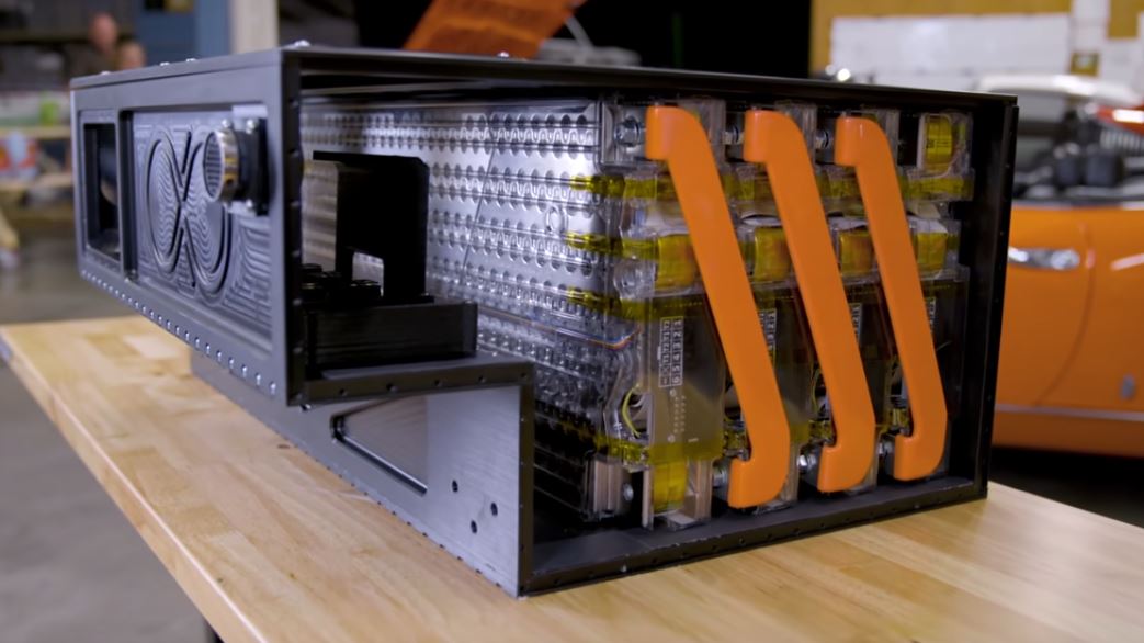

I'm designing my battery boxes, and I have seen the Tesla model s cells laid both horizontally as they come in the Tesla, and I have seen them standing on end.
Does anyone have any real world experience with standing them on end, and if there is any impact at all from a cooling perspective, or packaging for that matter. I'm thinking of standing them on end for my application, but don't want to make a bad mistake based only off some photos I may have seen on Instagram.

Jack at EVTV has stood Tesla Model S/X packs against the wall and not reported any issues
- Posts: 656
Re: Tesla Battery Boxes
Jack at EVTV has also charged a Renault/Nissan Fluenze pack without a BMS and burned down a warehouse
As long as the modules are mechanically sound there should be no issue.
With the old CALB and Thundersky LiFe cells you weren't supposed to orient the batteries sideways, but the 18650s should be totally fine.
