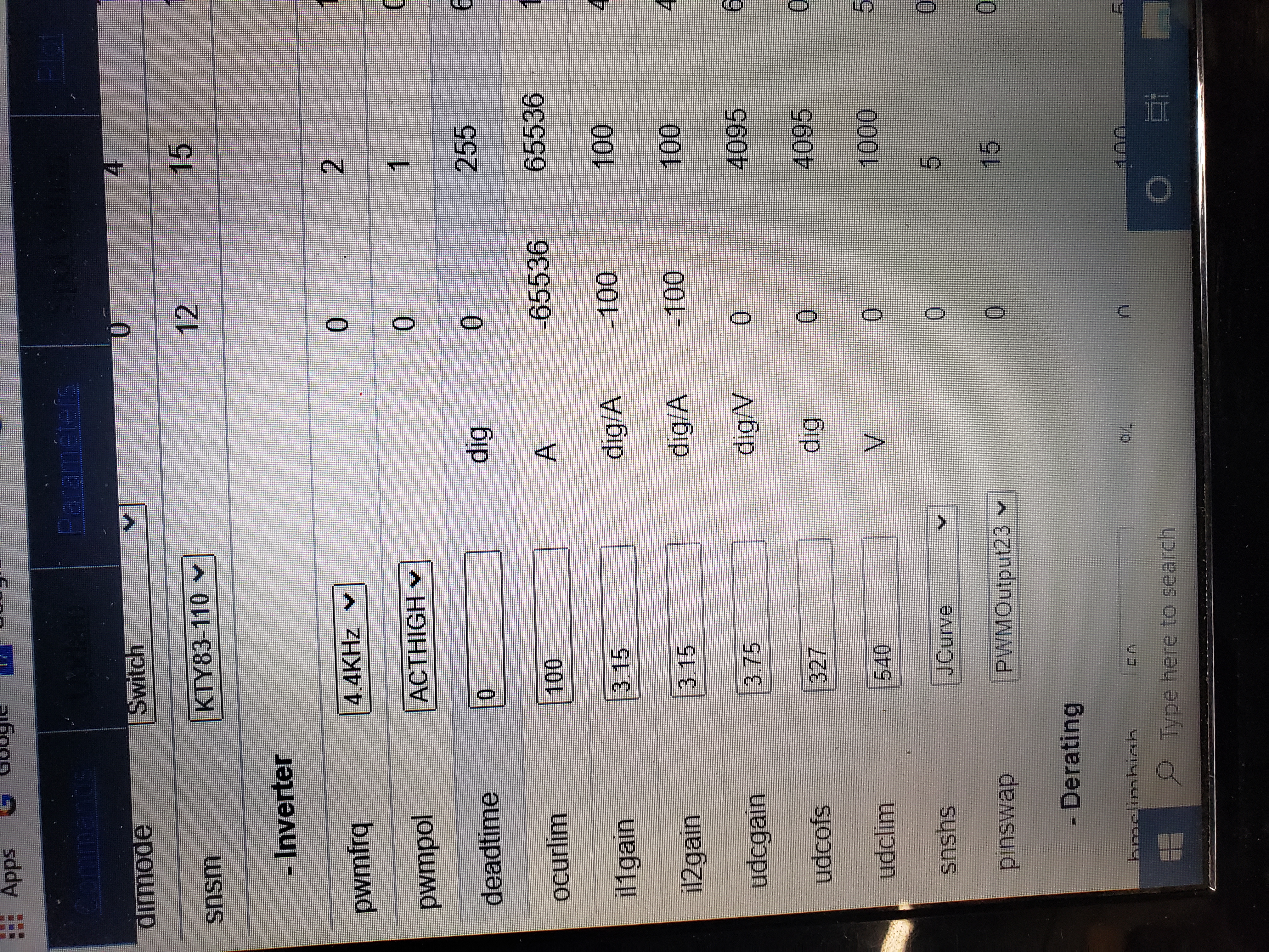

zookeeper, what do you make of this gen 2 setup?
https://openinverter.org/wiki/Configura ... 2_Inverter
I noticed these numbers
Toyota Prius Gen2 Inverter
Only inverter parameters
"pwmfrq": 2,
"pwmpol": 0,
"deadtime": 0,
"ocurlim": 100,
"minpulse": 1000,
"il1gain": 3.18,
"il2gain": 3.18,
"udcgain": 3.78,
"udcofs": 327,
"udclim": 540,
"snshs": 0
so... we seem to have 3 choices for pwmfrg on the webinterface drop down menu. does this mean that selection 2 is the one?
the priustoric boatcar guy
Been thanked: 1913 times
Yes, 4.4kHz.
You can see the translation from numbers to string here or by typing the "list" command in custom command

it seemed to get worse with the inverter parameters listed a few posts earlier but I left them as they are published by johu
I have tried different current and swapping phases in software.

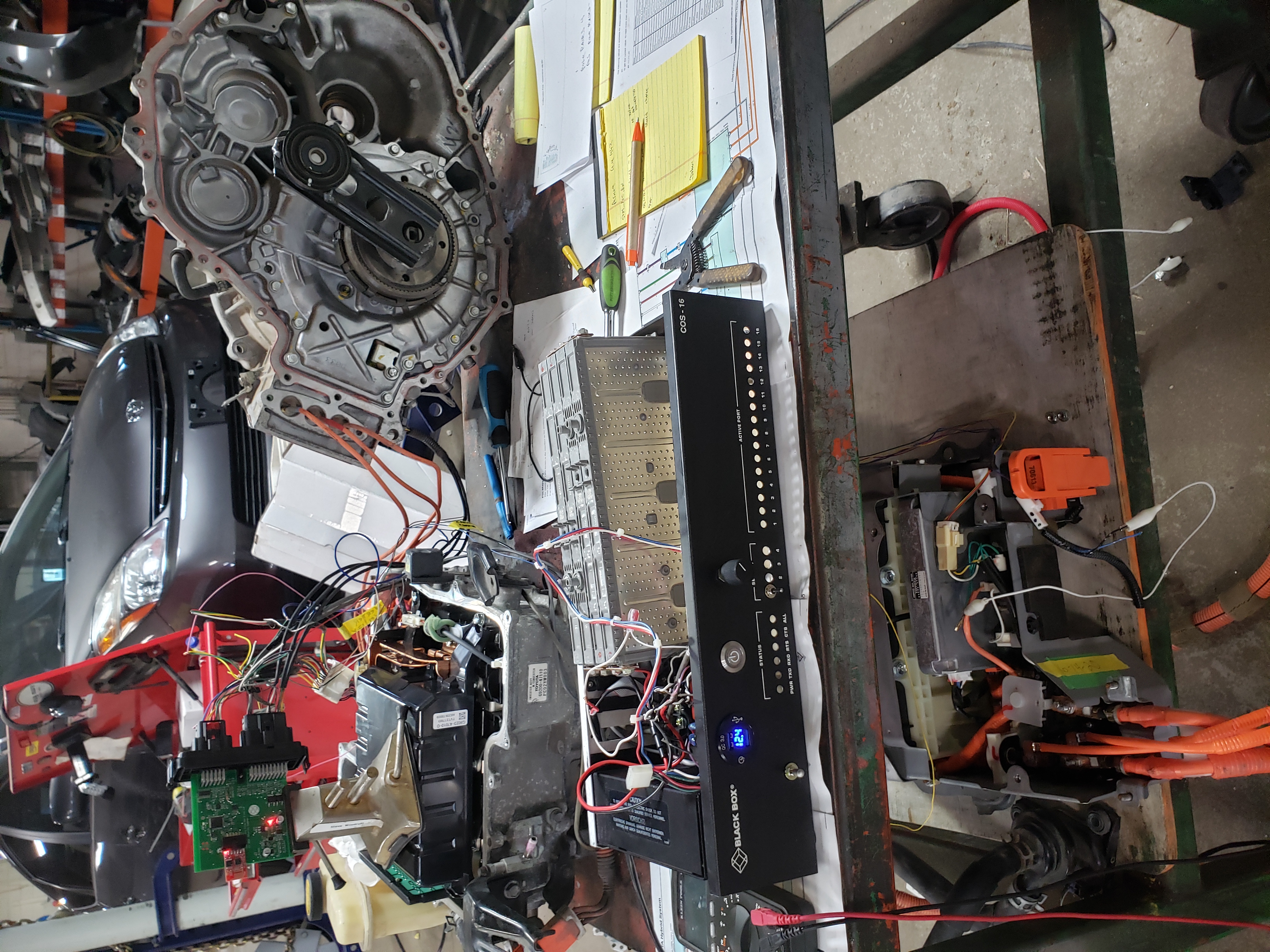

am using 220 vdc
also..zookeeper I saw your youtube , I suggest something more robust than toyota prismatic cells for the 12volt supply like I have here.

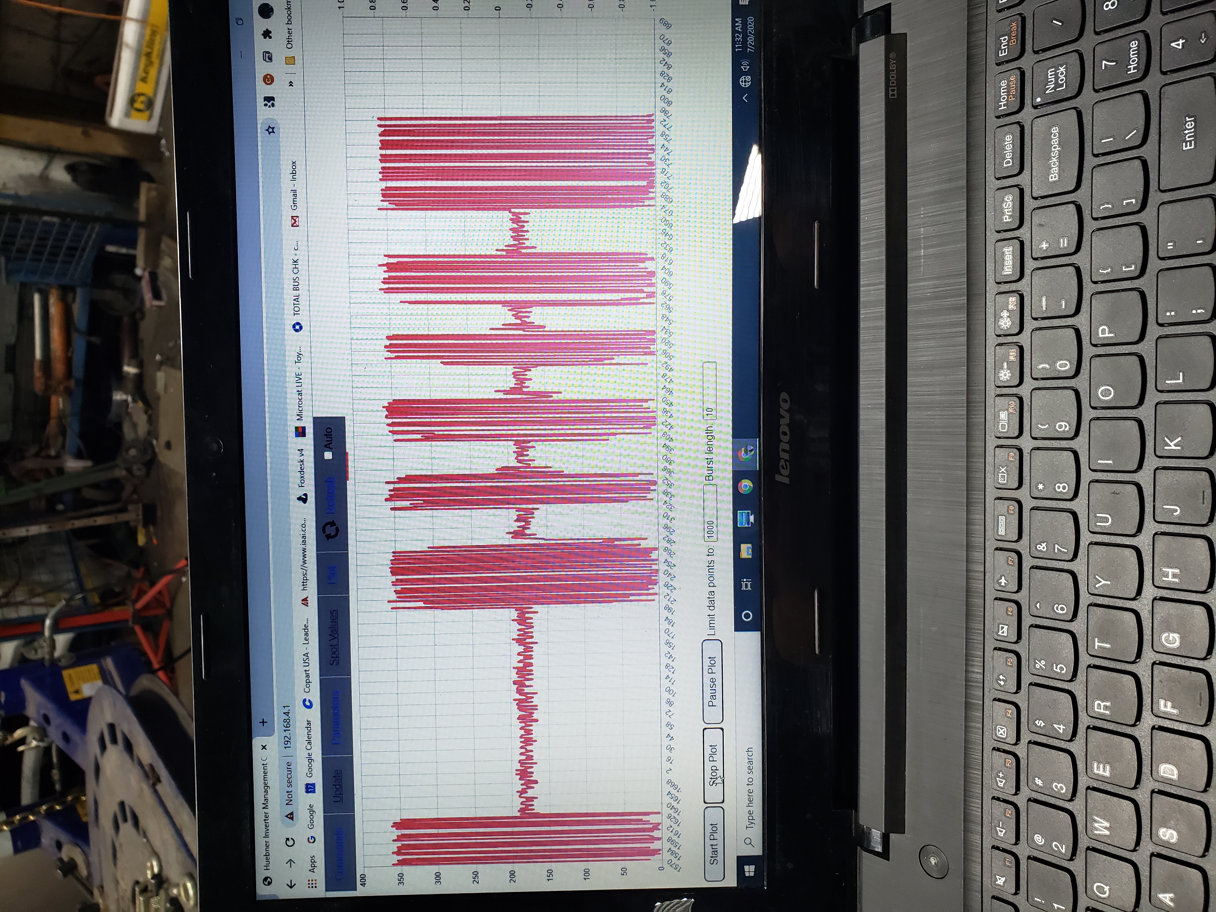

You need to be systematic about pole pairs, otherwise you are left with too many variables. Set both polepairs and respolepairs=1 and try to do a full motor revolution while plotting angle. How many times does angle go from 0 to 360?

okay set pole pairs to 1 and it appears to me that there are 6 zero crossings.see the photo
does that mean.....what?

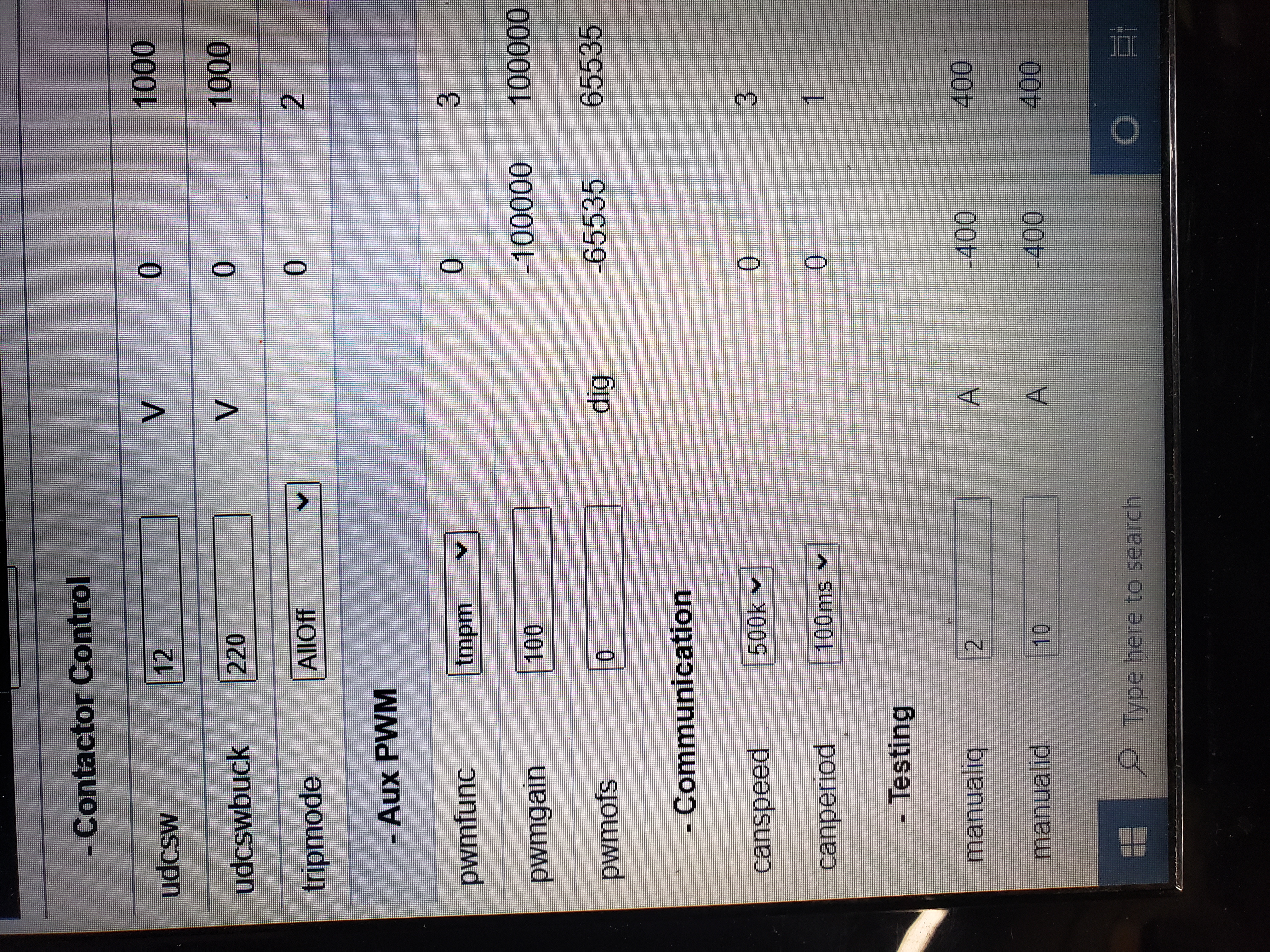

im using under 10 and usually under 3 for the manualID.

I notice that my angle plot is a modulated sine with 6 zero crossings in one revolution, but in Damiens youtube video at time 17:23 his is a nice sawtooth.
most information including the oak ridge report linked above and the youtube comments seem to agree there are 4 pole pairs for the prius mg2.
but I believe I saw damiens pole pairs was set to 2 and resolver set to 1 at time 21:37
these photos show that mg1 and mg2 resolvers are the same. I have just taken apart a gen2 transmission.
and you can also see there are 48 sections to the motor and 14 sections ( slots) to the resolver.
im wondering how 6 goes into 14....but both are divisible by 2 ( his pole pair setting.)
