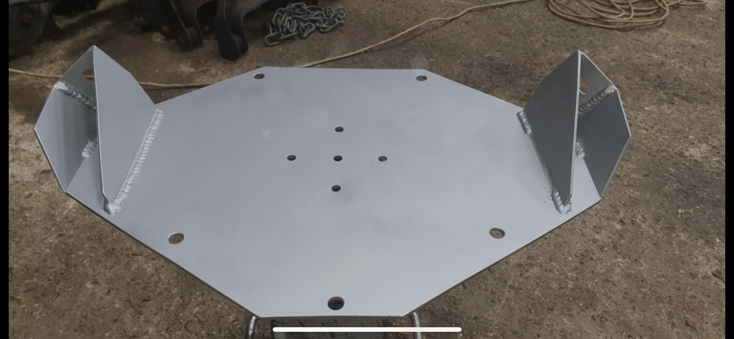

The gearbox fits like a glove and the car is now with a fabricator to create new mounting points, gearbox face incorporating the spline to lock the two motors, bracing underneath, and interface the prop shaft between the Lexus and Merc differential. I know my limitations...

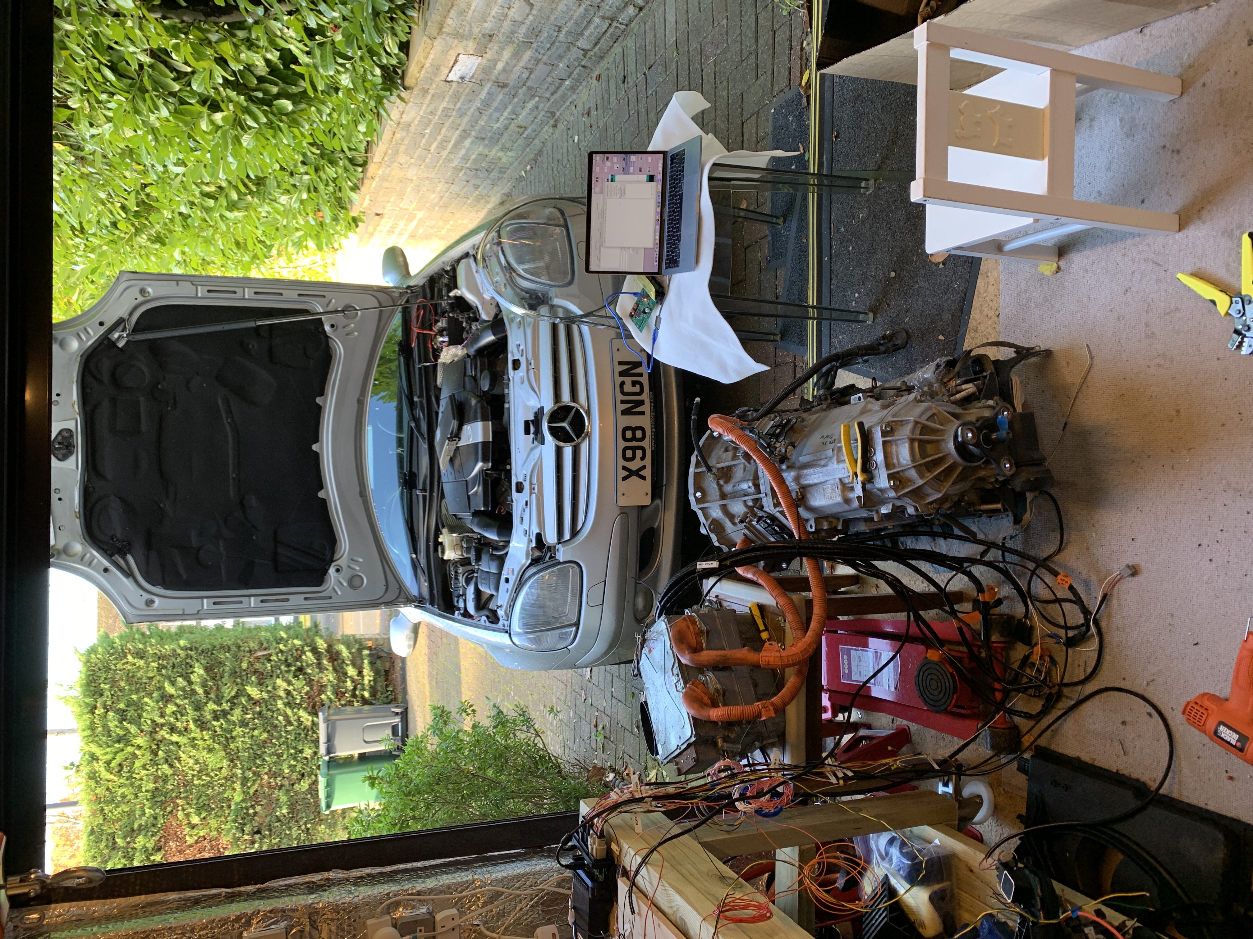

Given the car is currently away getting a makeover it was time to focus on the wiring and software side. It’s been a couple of days over a couple of weeks but I created a testing loom after finding some data interface connectors from a breaker, got 3 in total and distributed them to other participants. Thanks to the forum and Wiki pages I have sourced all the connectors, taught myself how to crimp Molex connectors to wire the project up for testing purposes. I purchased the VCU and brass connectors from EVBMW of course! Test batteries are 4 electric scooter batteries combined to deliver 50 volts, thanks to Steveknox for this idea.
I have been able to power up the VCU and browse to the WIFI gauges page.
Next challenge was to download Arduino software and fumble through getting GS450H_v7 uploaded and throttle pedal calibrated. It might look messy, but I have uploaded the v7 software and can see changing parameters via the serial monitor. Big thanks to James Brown (project-figleaf), again another participant for helping me navigate the installation and configuration of Arduino due board. Using Skype and screen sharing helps explaining parameters set much easier. I have documented this process and will post it soon as soon as its peer reviewed for accuracy.
Afternoon, I was able to get the Lexus GS450H gearbox spinning using V7 of the code and using a leaf pedal apply acceleration. Short video to follow. Next will be figuring out how to convince the software the gearbox is NOT in neutral.

Update: 10/7/2020
Car has returned from fabricators and I'm well impressed. Shout out to Zack @Anarchy_Kustomz for the professional looking work!! The gearbox isn't going anywhere.. Dropping the gearbox easily was one of the main requirement. Zach and I are working on costings if anyone wants a face plate (flat, no mounting wings) for the GS450H gearbox with holes drilled for bell housing and spindle, spacers for spindle, motor mounts and hardened nuts and bolts. I'll post that part under the classified section as well. Next is determining where everything can fit and work out battery box locations. Getting there...

jcwright45 wrote: Fri Jul 10, 2020 5:06 pm Zach and I are working on costings if anyone wants a face plate (flat, no mounting wings) for the GS450H gearbox with holes drilled for bell housing and spindle, spacers for spindle, motor mounts and hardened nuts and bolts.
I'd be interested in seeing pricing on these.

Post by jcwright45 »
Its been a while, so time to update the group. What's changed?
High Voltage cables have been installed
CANBus capture and hacking in progress
Nissan Leaf battery pack delivered, not dismantled as I want some stats from the BMS first if possible
GS450H gearbox, ATF fluid changed, fully wired up and reinstalled in the car. Pics to follow..
